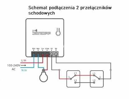

    I am carrying out an electrical installation (at my place) and have some doubts about the space in the box . I am using 60 kaiser black boxes with a depth of 66. sonoff mini modules for lighting control will be used. In the worst case I will have to the box
    power input - 3x1.5mm2
    power output to the nst switch - 3x1.5mm2
    lamp output 3x1.5mm2
    cable from the second switch (staircase) - 3 x 1.5mm2
    the Sonoff Mini module
    cables to connect the switch 2x1.5mm2 to the module
    Has anyone tried this configuration ? Alternatively what are the patents to increase the space .
    Maybe you have some photos of similar implementations. Thank you very much in advance for your advice.

    It's not likely that you'll be able to fit it in. I've put in similar modules at my place (I just don't know what kind of boxes I have) and it was a problem to fit. Although I have 2.5mm2 cables everywhere. I had to dismantle the module casing and put the board itself, covered with insulating tape, into the box. Otherwise there was no option for it to go in. Note that this module is 60mm diagonally so ideally the diameter of the can. The thickness is 2cm, leaving you 4.6cm to accommodate the cables and the physical switch (2cm).

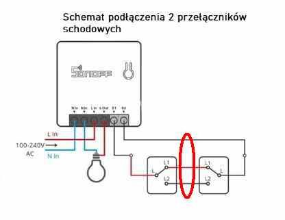

    Thanks for the feedback . I have questions .
    1. Which sonoff are you writing about ? I intend to use the Sonoff Mini R2 and the Sonoff Dual R3 . I don't see any speed there .
    2. How should the electrical connection look like . Should I connect as in the sonoff diagram shown below ? Or a different one ? Will 4 wires between the stair keys be enough ?
    3) I don't know much about the spacing of the boxes. Please clarify. I am using Kaiser deepening boxes . They are connected to each other. I have also bought a Kaiser electronics box in order to have space for cables and electronics.
