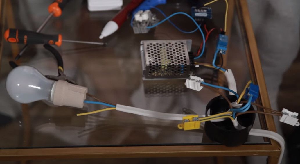

    I'm getting together to buy a sonofa mini and upload espeasy, but I can't find anywhere how to configure espeasy in sonofa(what devices to add and under what gpio) - I can only find for sonofa basic. Additionally, what is the wiring diagram of the sonofa to the programmer and will the programmer be ok? I am green in this subject so please help me a lot.

    Better at what? Everything. Mainly in that it is stable. Maybe a little more difficult to set up, but it works for months in contrast to espeasy, which I have the impression is becoming less and less stable since 2018. With Domoticz it works as well as with any other Smart Home system

    As a controller for lighting(I care about being able to control from domoticz and a physical button), but I've heard that sonofashes are on fire.

  • Safety: Open, mains-powered breadboards are unsafe; keep mains gear enclosed and strain-relieved. [Elektroda, khoam, post #18748000]
