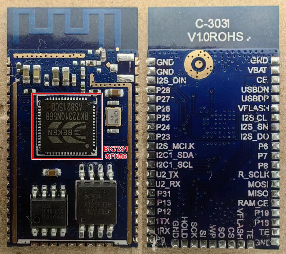

    Hello, I have a BK7231 module with a 56-pin BK7231 chip on it.
    Can I apply OBK to it?
    I tried but didn't succeed, thank you!
    The BK7231 module (C-3031) information:
    http://www.c-chip.com.cn/userfile/productPic/20181201111430.pdf

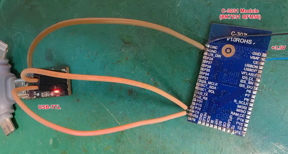

    Following the normal flashing steps,
    I connected Tx, Rx, Gnd to the USB-TTL device and provided an additional 3.3V power supply.
    Then, I turned off and on the power supply,

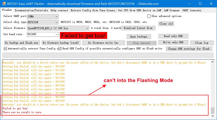

    But it has been unable to enter the flashing state.
    Using OpenBK7231T_App on BK7231 Chip of QFN56 C-3031 Module: Successful Application Guide

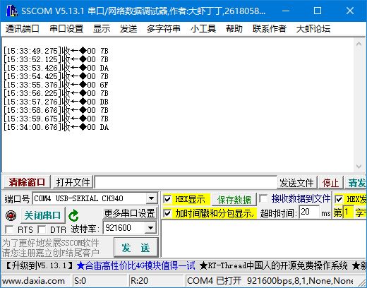

    Added after 15 [minutes]:
    When power off and on, the Uart2 prints those messages:

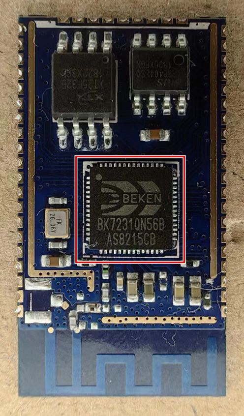

    SMD code is BK7231QN56B, does this belong to BK7231T or BK7231N?

    Interesting, a C-Chip BK7231Q chip module. Hadn't spotted this thread yet. You've probably realised by now Q is not supported ;)
