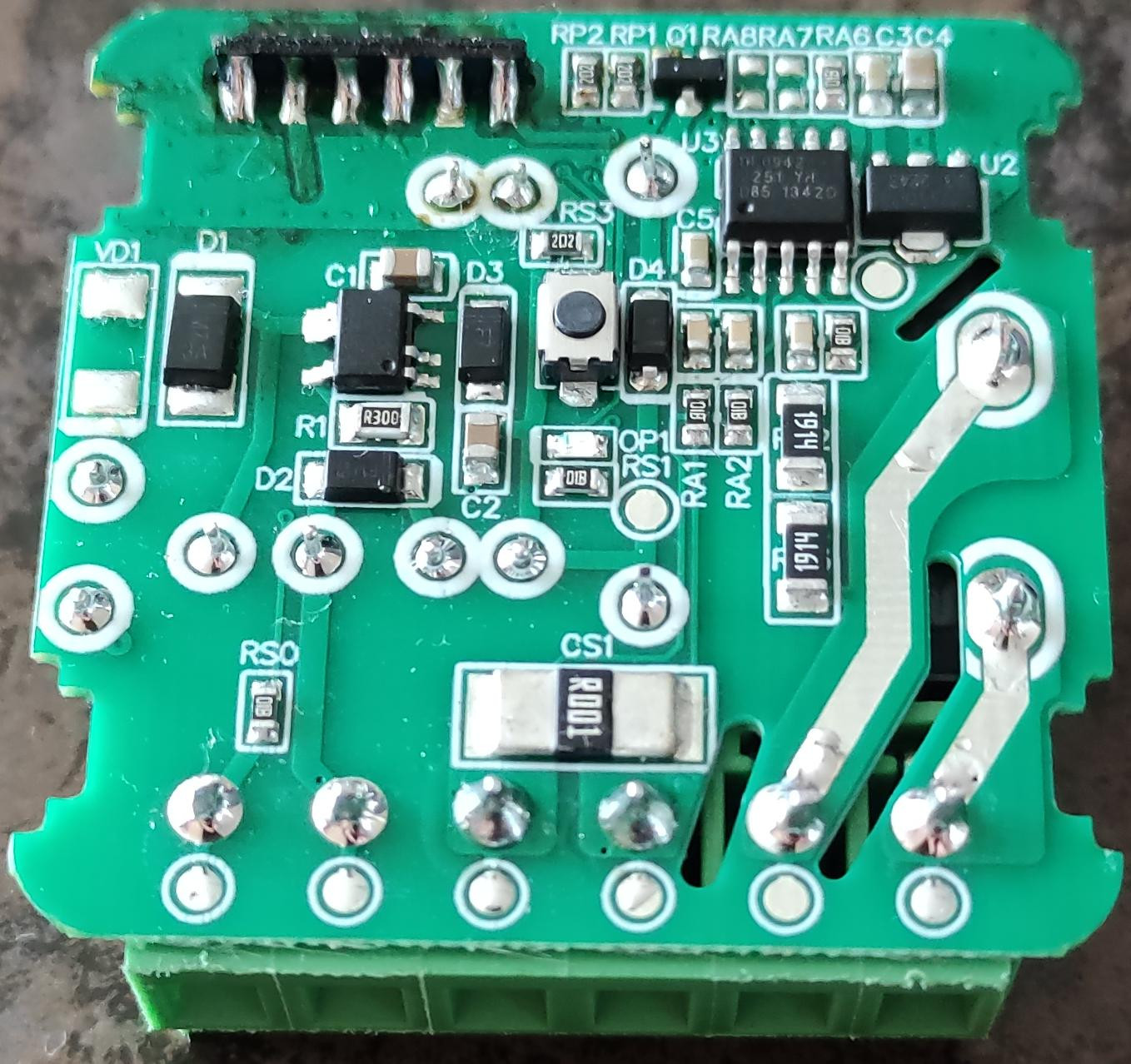

    Aubess 16 Power monitor I replaced the Tuye CB2S with a TYWE2S (ESP) (I remembered correctly) I uploaded Tasmote there and everything works , including current and power measurement, but to my happiness I lack only a working button.
    According to my conclusions Tuya had ( tacktswitch on the board ) a button under AD , the module TYWE2S also has AD on the same pin, but I do not know how to force Tasmote to recognize it and assign it to relay 1, maybe someone has figured it out or my conclusions are wrong and it is necessary / possible to do otherwise ?
    I corrected
    Add
    I have such a wonder I on the photo , I replaced the modules, I searched now and the next conclusions :
    The ADC pin is shorted to ground with tactswitch
    CB2S ADC pin
    8 ADC I/O ADC, which corresponds to P23 of the IC
    TYWE2S pin ADC
    8 ADC AI Same with module Silkscreen AD, ADC interface, a 10-bit-precision SAR ADC
    Pin AD can only be used as an ADC interface but cannot be used as a common IO interface. Once not used, it needs to be pulled up. As an ADC input interface, the input voltage range is 0 to 1.0 V.
    I can't find the information for mapping the TYWE2S ADC pin to the ESP pin , I don't know which GPIO on the Tasmot is the ADC pin on the TYWE2S

    przemsi_ele wrote:
    In a similar device
    Well, why don't you show yours and not "similar"?

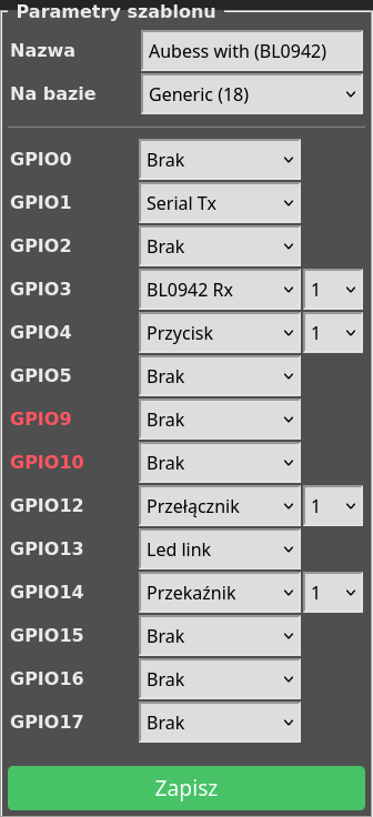

    GPIO Numbers from 0 to 65535 representing GPIO0 to GPIO5, GPIO09, GPIO10 and GPIO12 to GPIO16 and GPIO17 for A0 pin for ESP8266. ESP32 has more configurable GPIO's
    and also this
    Before Tasmota 9.1 used to configure the ADC type. In new templates this should be set to 0 and the analog pin should be configured on GPIO17
    I changed to the ADC button on GPIO17, but the thing was getting variations , switching on and off and not in some cycle but variously as if the ADC was going crazy, maybe the hardware does not fit.
    Help was not available, so I managed in another way , if anyone is interested.

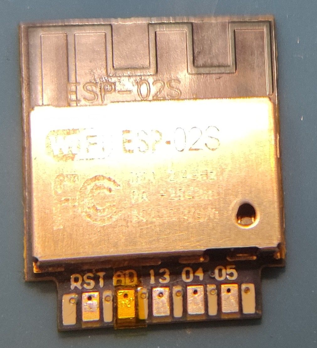

    After transplanting from CBU to TYWE-2S (ESP-02S) in AUBESS 16A + power monitor and uploading Tasmota, the button (tactswitch) on board did not work.
    Wi-Fi module ESP-02S with clearly visible pin labels and yellow kapton tape on the ADC pad.
    I soldered the ADC pads on the ESP-02S module with capton
    Close-up of a circuit board with electronic components, a soldered wire, and yellow Kapton tape covering part of the board.
    I did not solder the ADC pads of the module-board together.board
    I made a jumper with the ADC on the board with GPIO4 (not used)
    Screenshot of GPIO settings for the Aubess with (BL0942) device in Tasmota configuration.
    and the button works
