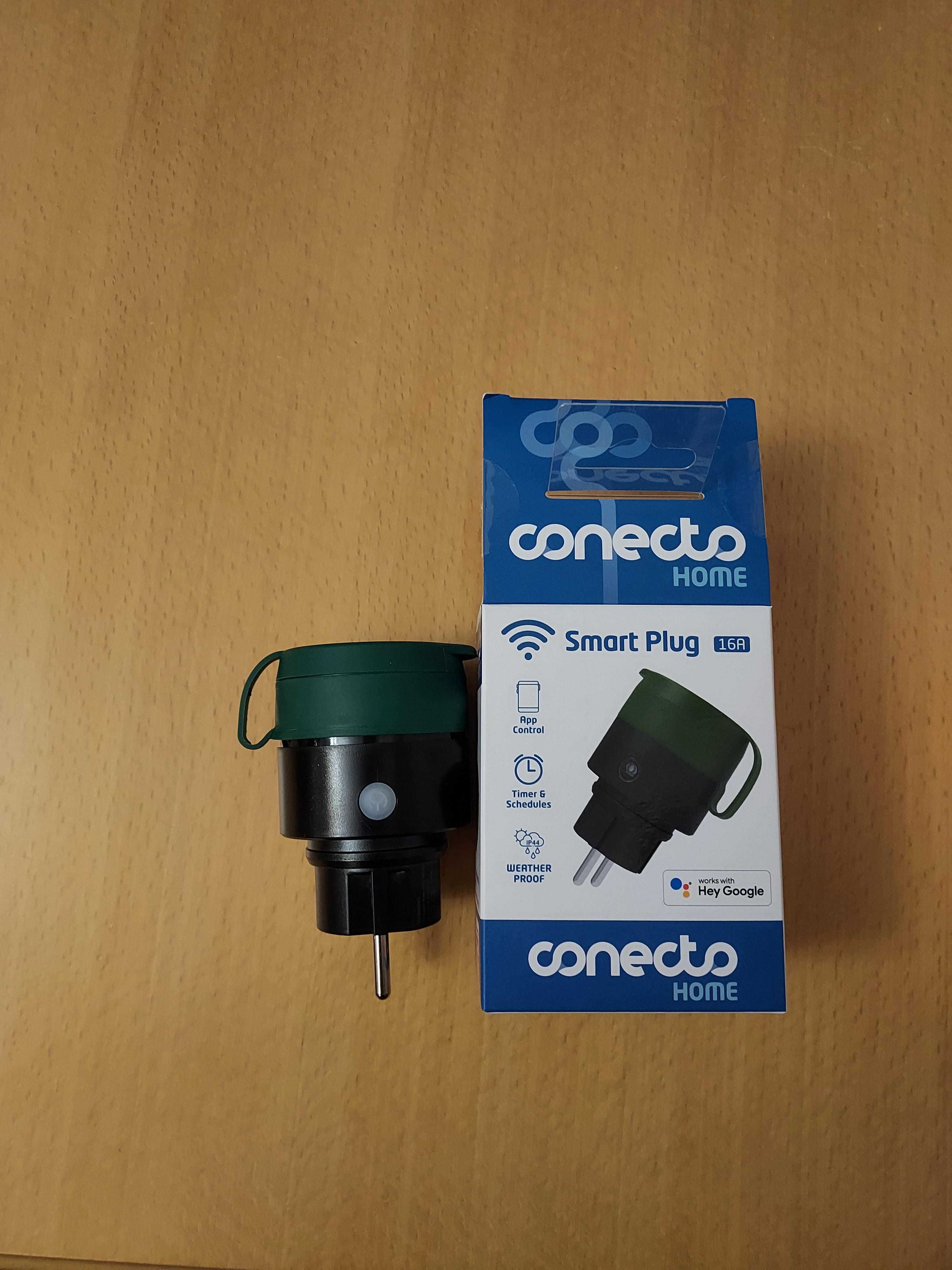

    I'll put some pictures here later, but Connecto Smart plug 1P (outdoor model) seems to have TYWE2S in it. It has ESP8285 MCU on it.

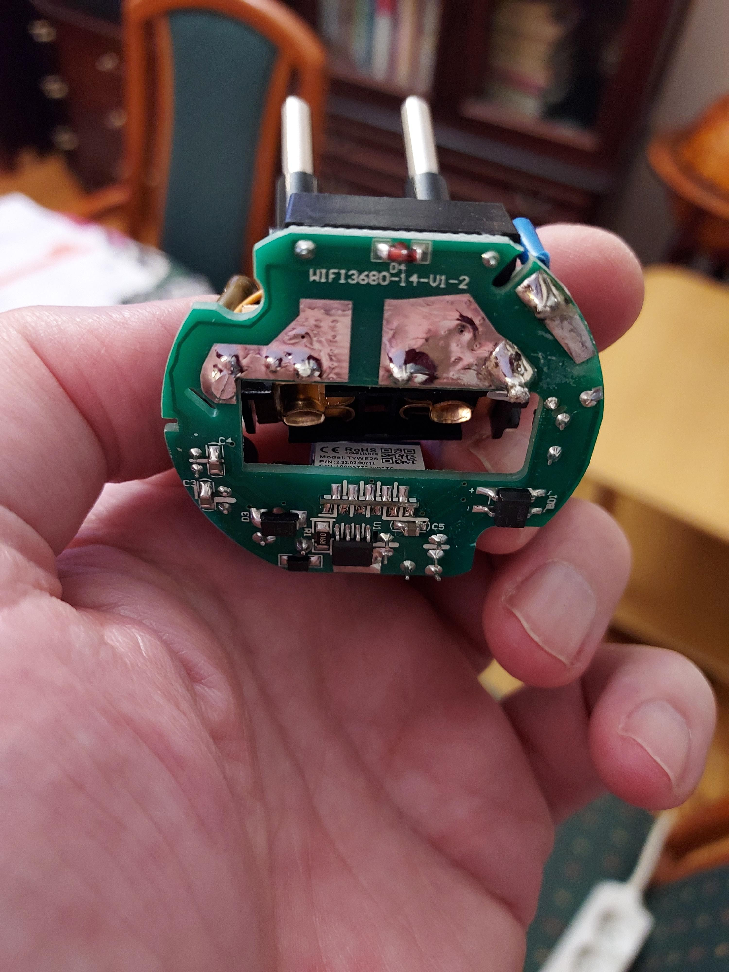

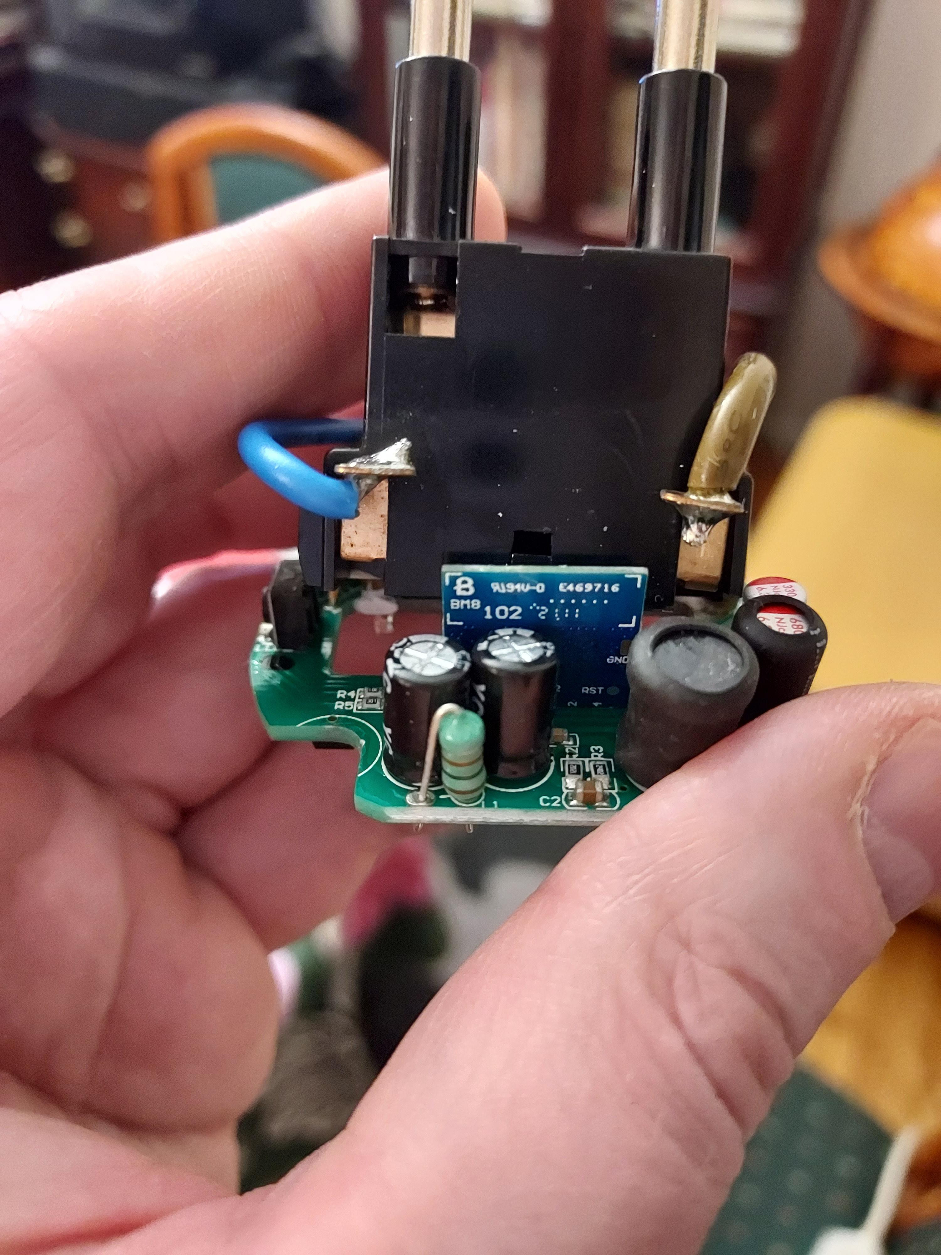

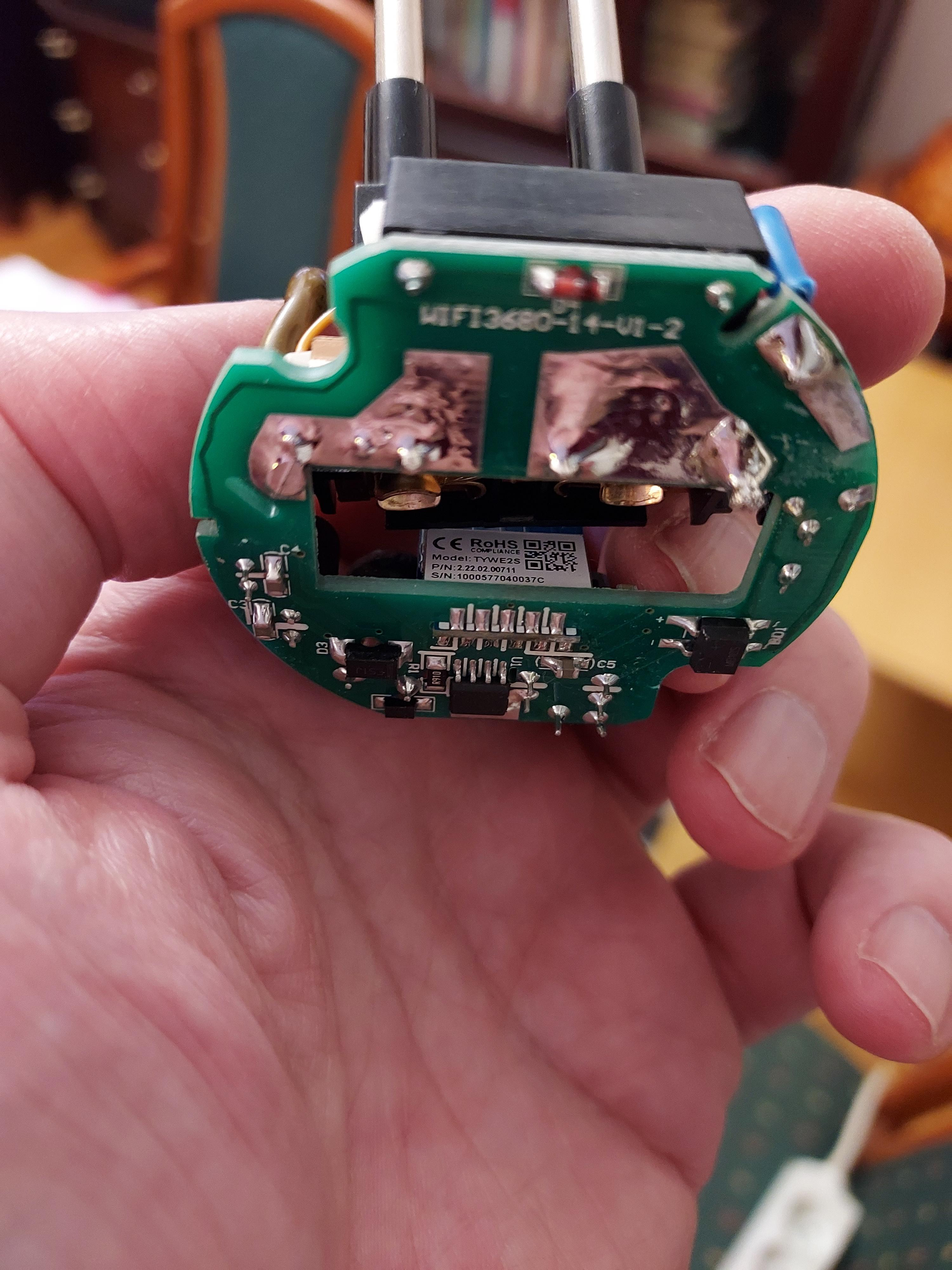

    Here are some pictures for you.
    I had to desolder the wifi module to have it flashed. Even then, grounding GPIO0 from the soldering pad did not work. I had to use a wire soldered on the "testpad".
    Flashing sonoff basic binary did put the relay alive from the web page without any settings modification. I'll try to find the LEDs as soon as I have more time for it. It has a green/red double-color LED on it. This pain in the ass took all day to flash. I don't have more time for it now.
