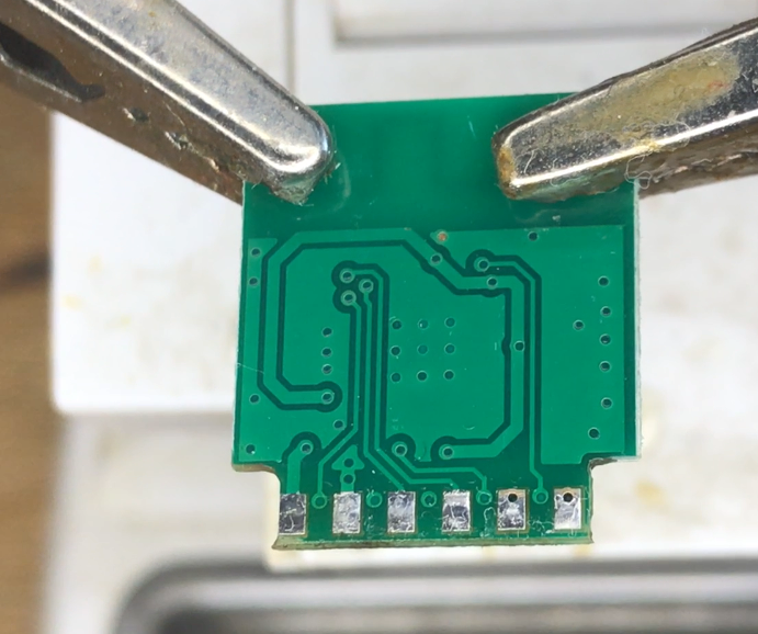

    My flashing procedure here is very simple - solder 3.3V, GND, RX, TX and GPIO0, attach GPIO0 to ground and then connect power. Module will boot into bootloader mode, so esptool.py can be used to flash it:
    esptool.py write_flash 0 tasmota.bin
    Then you will have to disconnect it from power, disconnect IO0 from GND, and power it again, so Tasmota can run.
    But recently I have received a strange variation of TYWE2S:
    TYWE2S without GPIO0? Alternative pinout and flashing Tasmota, ESP8285
    It was in a no-name power metering socket in a LSPA9 shape.
    After desoldering, I realized that it has no markings:
    So I have opened ESP8285 datasheet and wrote down the pinout, in hope to find GPIO0 easily accessible:
    The GPIO0 is in place of AD pin of old TYWE2S. This is new to me. It's good that it's still routed out.
    Remaining pads seem to match old TYWE2S. I don't know why Tuya made that change.
