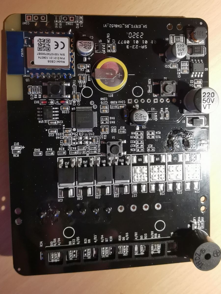

    It is a 4-channel controller that uses a Chinese ESP32 clone (BK7231N / CB3S PCB) which is tied to the Tuya cloud and unusable without an internet connection, which sucks. Here is a pic of the PCB:
    [CB3S/BK7231N] 4/6/8 channel WIFI Smart Garden irrigation controller with TuyaMCU template guided
    The Beken module communicates via serial to another MCU (aka TuyaMCU, Nation N32G452) via serial. I had to desolder the CB3S module and feed it with external 3.3V to flash openbeken because the TuyaMCU was disturbing the process. The process was easy using hot air, desoldering wire, and a bit of patience.
    After flashing openbeken, I resoldered the CB3S module to the main PCB and booted openbeken successfully. Connected to Wi-Fi using the GUI was easy. I used the TuyaMCU Analyzer (https://github.com/openshwprojects/TuyaMCUAnalyzer) to find the dpids and found that 101-104 were the four outputs.

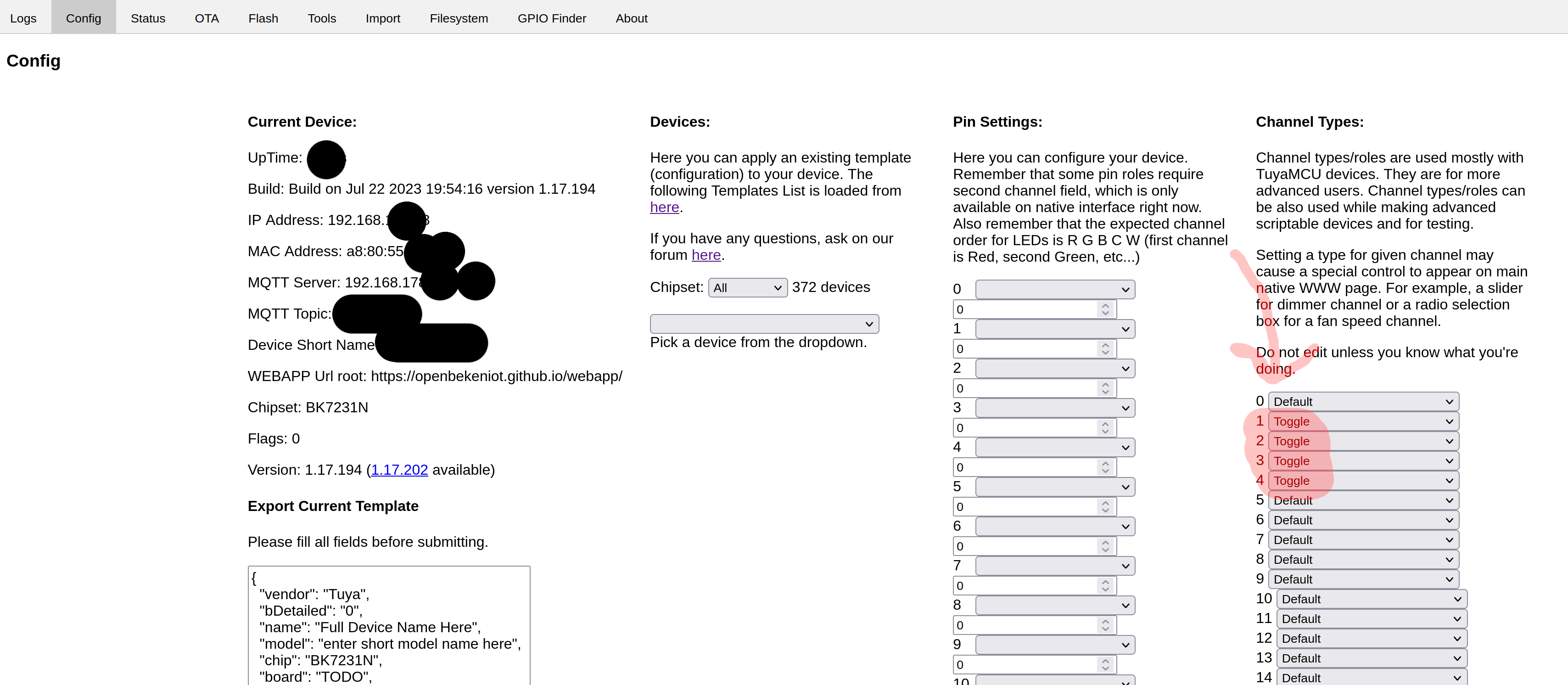

    Set the channels to toggle type:
    And integrate to Openhab via MQTT as seen in the YouTube videos.

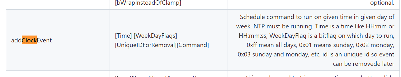

    That's something totally new to me, thank you for your presentation! I see you've also used repeating events to automatically stop the valves after given time. That's a good idea. But, btw, have you looked into clock events? They could be used to automatically start a given process at given time.

    Thank you for mentioning this! This could be interesting for indoor gardening usage and controller independent setups, but in my case, I want to make the decision if watering is necessary or not depending on the current weather/forecast as I am watering outdoors with it.
