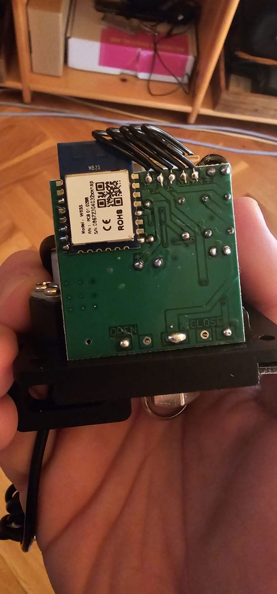

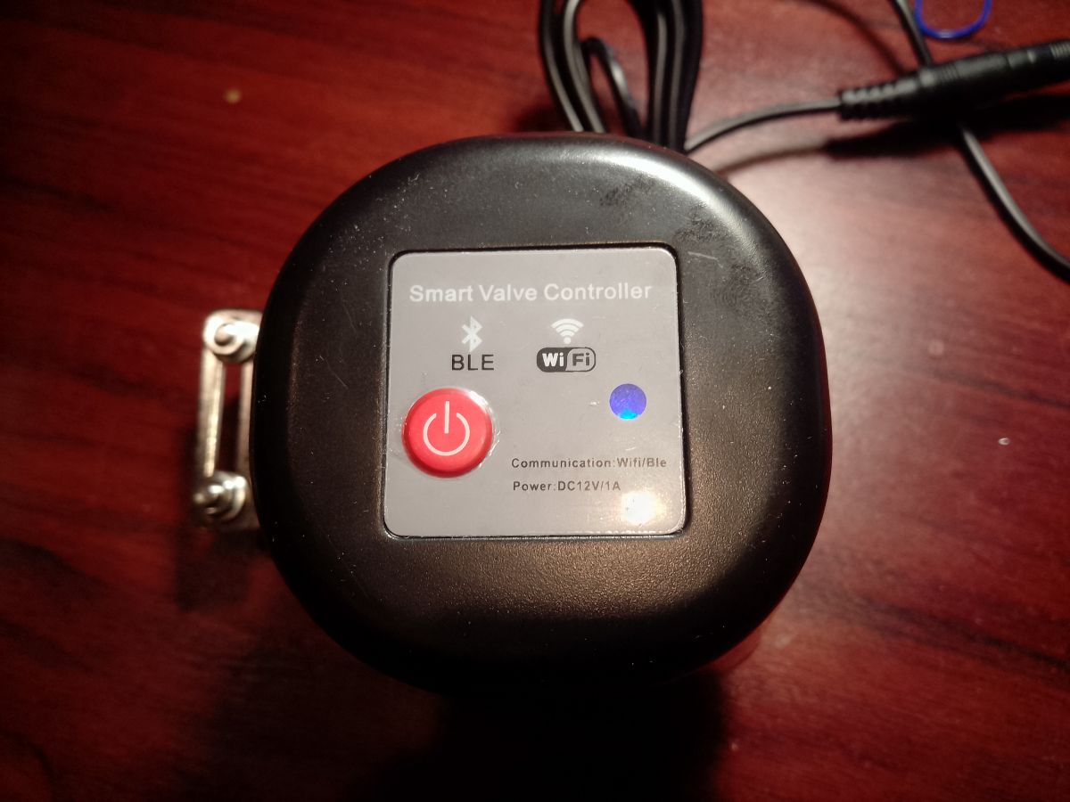

    In this post, I will share teardown of Tuya Smart Valve controller.
    [BK7231T][WB3S] Tuya Smart Valve Controller (water switch) [BK7231T][WB3S] Tuya Smart Valve Controller (water switch) [BK7231T][WB3S] Tuya Smart Valve Controller (water switch)

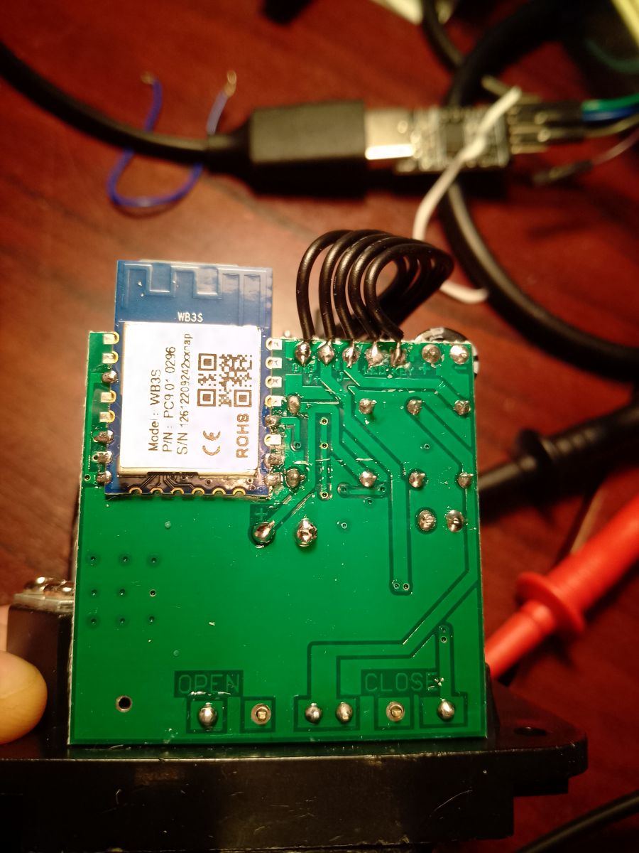

    These controllers come with different chips. I bought this one from aliexpress. It contains a chip wb3s.

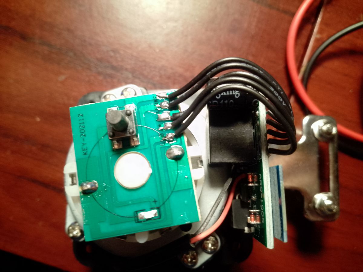

    For firmware, it is enough to remove one cover. Connecting to the chip is easy.
    I successfully flashed it with OpenBK7231T using usb-to-uart-3.3v and standard connection (TXD1, RXD1, GND, VCC and CEN for reset).

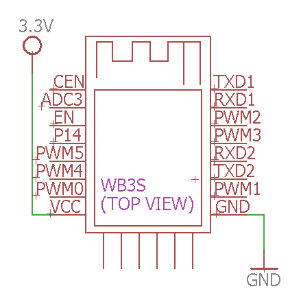

    The diagram below is a bottom view. When connecting, do not confuse left and right.
    Pins need to be configured like this:

    Thank you, this is most likely the first water valve controller on our forum, nice. If I may ask, what are you going to use it for?
    Yes, this is unfortunate, other modules have their drawing from top view and it may be confusing for beginners. At least I have my own drawing of WB3S, but not complete:

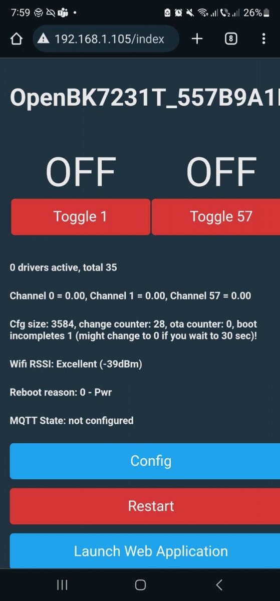

    Screenshot of OpenBK7231T interface with toggle options. So, I have not yet taken it out to test. I have it in my maintenance room attached to some water pipes. However the web interface disappeared and the only port open is 6668 which is used by Tuya. It still connects to the wifi, however I had that configured in both instances.
    I am sure i flashed it as I configured it to work with my home assistant, I scheduled on and off times and the interface was there. I then moved it from my computer to the maintenance room and tested for 1 month with success.
    During the winter (it is attached to a sprinkler system) I disconnected everything. I think it was 4 months and yesterday I restarted everything with the results above.
    I will disconnect it today and attempt to read the firmware, I will update this thread, however if there is no backup firmware this just gets stranger.
    If you have any ideas as to what i can check on it please feel free to tell me and I will post results.
    Edit:
    I followed the flash procedure, added the firmware in the flasher, tested everything, I had the interface, control of inputs and outputs, all functionality, so I say the flash was ok, also it survived multiple power cycles initially. I did not have it as an AP but rather it connected to my Wifi.
    (I have attached an image of the interface I was seeing)

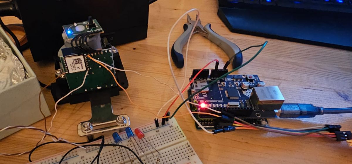

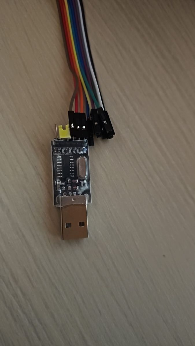

    I have not done OTA ever (if it's over the air). I will attach some other pictures I took on the day.
    I used the UART, powered the chip via Arduino and tested everything in the end.
    If there is anything I can extract via UART I will do so.
    Electronic circuit board with a communication module in hand. Electronic setup with Arduino connected via UART on a wooden table.
    And this is the UART not visible in the other image:
    USB-UART converter with attached colored wires on a table.
    Also it seems that it also lost the IP I had statically assigned (.105) so definitely not what I set. It is now DHCP.

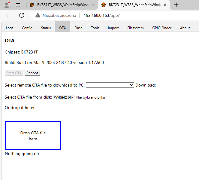

    I don't think you can do much more here. Providing me 2MB backup of your flash would also potentially leak your WiFI data to me. So instead, just for research purposes, let me know once you reflash OBK whether your OBK config was kept in the device. I think it should be.
    And then just do OTA here:
    OTA interface page for BK7231T with file upload feature.
    Feel free to ask if you have any futher questions or issues.

Three-step UART flashing guide?
  1. Solder or clip leads to VCC, GND, TX, RX, CEN on WB3S.
  2. With 3.3 V power applied, pull CEN low and run BKwriter to back up, then write OpenBeken image (≈2 min).
  3. Power-cycle; the module boots into AP mode for final setup [Elektroda, Rawbear, post #21387205]
