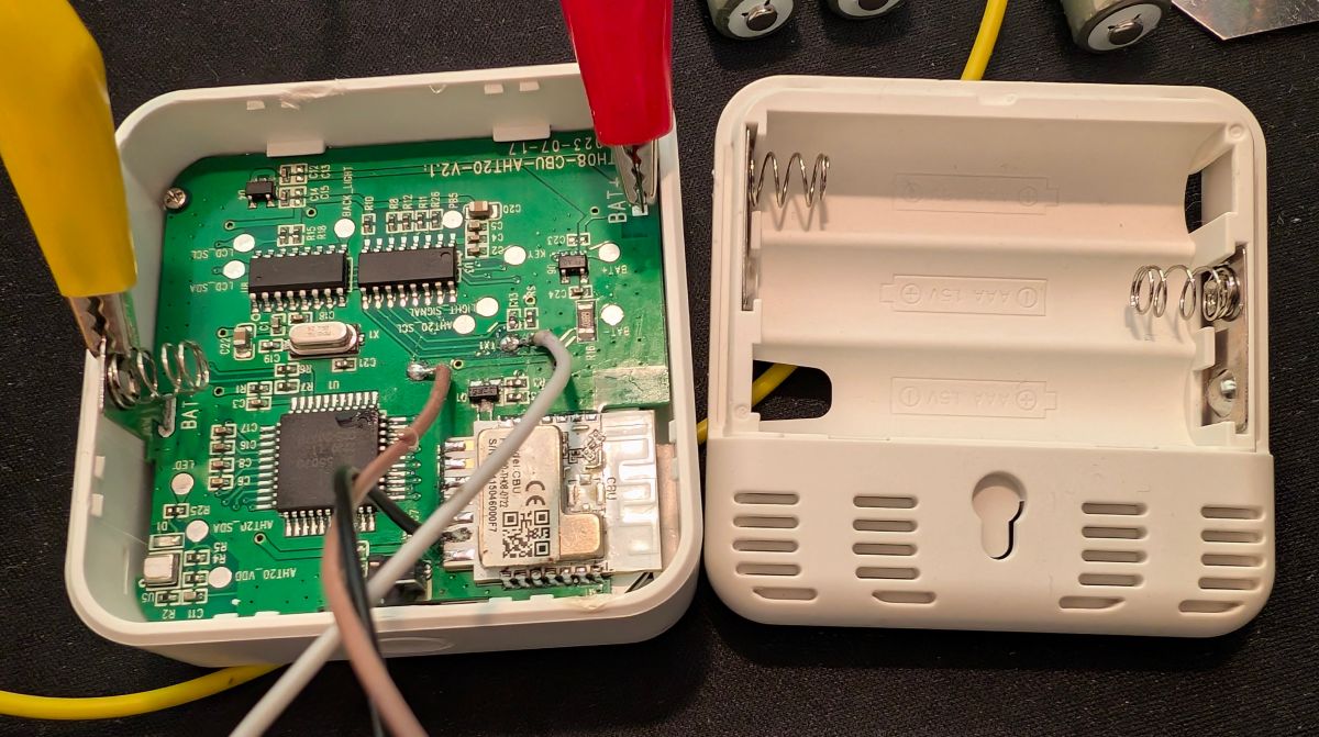

    Hi! I'm trying to run OpenBeken on this Tuya Wi-Fi smart thermometer hygrometer date/time. Since I've had it for quite a while I no longer have the original box to show.
    Opening it is not easy since the plastic housing is significantly stiff, but if you jam a thin metal tool into the bottom side and pry really hard it should open up.
    Some pictures of the device while I'm working on it:
    Smart Tuya Wi-Fi thermometer displaying date, temperature, and humidity. Interior of a disassembled Tuya Wi-Fi smart thermometer showing the PCB with a CBU (BK7231N) module and battery connectors.

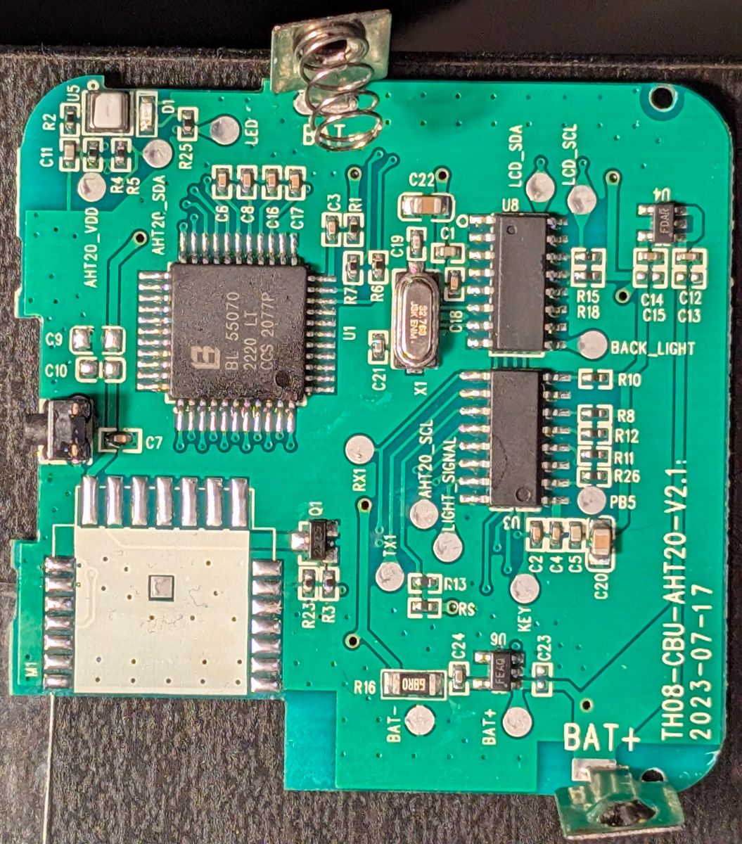

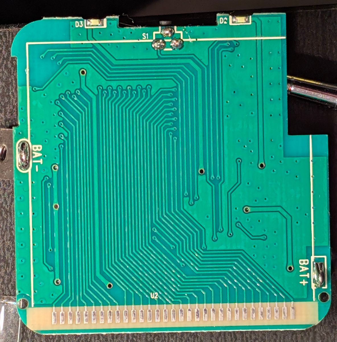

    High-res pictures of the PCB with the CBU module removed
    Close-up of the PCB of a Tuya Wi-Fi smart thermometer. Rear view of the PCB from a Tuya Wi-Fi smart thermometer.
    The module is a CBU (BK7231N), the config seems to be empty:

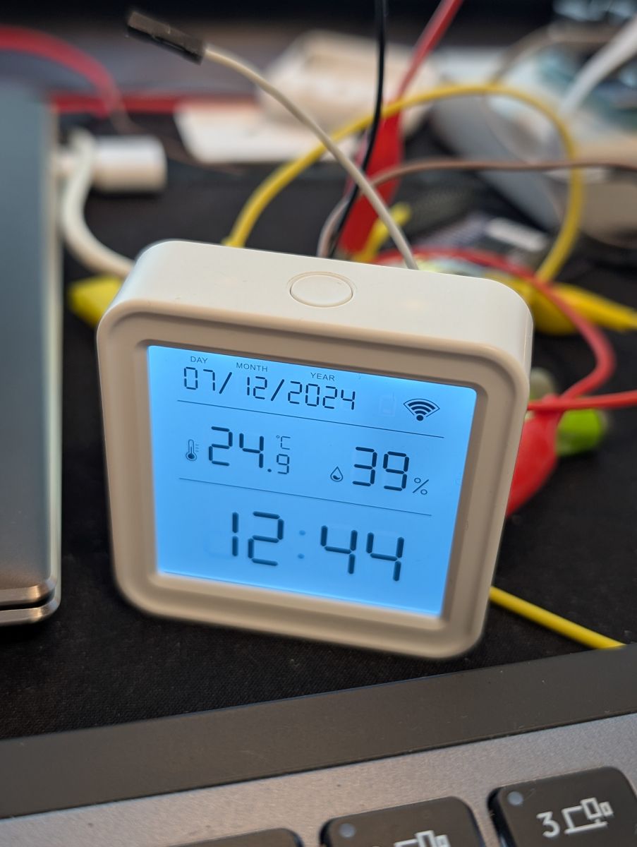

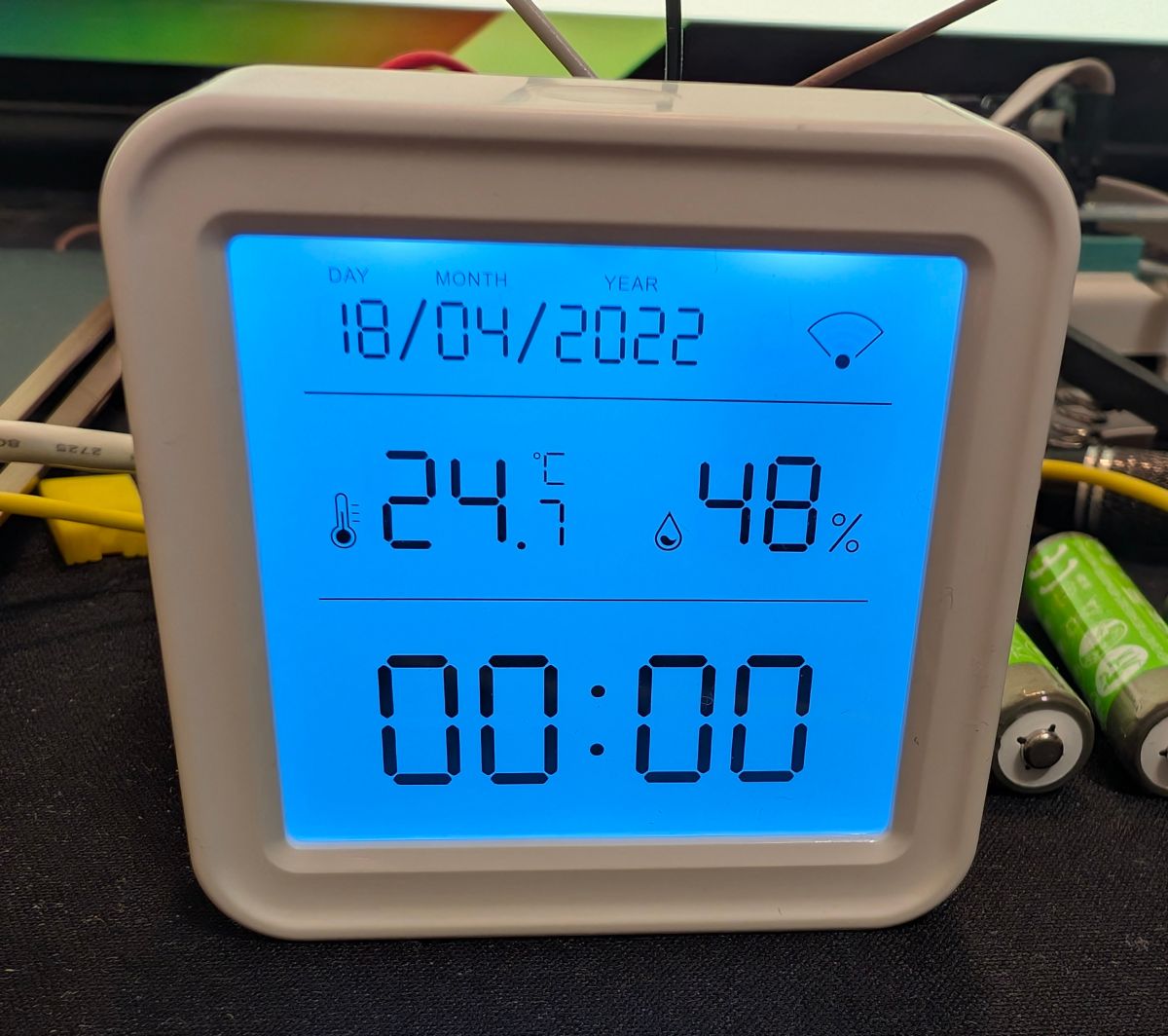

    After flashing OpenBeken (I had to desolder the CBU from the board to flash it, similarly to this other device), the display still works, but the time is not up to date. It looks like most of the board is controlled by TuyaMCU and the Beken chip only takes care of the wi-fi. Like other similar battery-powered devices it also shuts down Wi-Fi automatically unless I keep pushing the top button which wakes it up.
    I tried using this script from the similar device linked above:
    startDriver TuyaMCU
    startDriver NTP
    // dpID 1 is tempererature div 10
    setChannelType 1 temperature_div10
    // dpID 2 is % humidity
    setChannelType 2 Humidity
    but it didn't seem to work. Later I realized that the TuyaMCU is connected to UART2, so I enabled flag 26 "[UART] Use alternate UART for BL0942, CSE, TuyaMCU, etc" and that also didn't make a difference.
    I pulled out my logic analyzer and recorded the TuyaMCU communication, with and without the stock firmware. You can find the UART recordings from my logic analyzer attached (open them with Sigrok's PulseView, but it seems that OpenBeken isn't even trying to talk to the MCU.
    So that's where I got stuck, any ideas? Thank you!

  • TuyaMCU works on UART1 with channel mapping
    #8 21337008
    depau
    Posts: 6
    spin55 wrote:
    https://www.elektroda.com/rtvforum/topic4000657.html
    Thanks, I searched before but I could not find it!
    I managed to make it work. First of all I was wrong that TuyaMCU was on UART2, it was on UART1, so that definitely made me waste a lot of time. This script seems to do the trick:
    Thanks for your help![/code]
