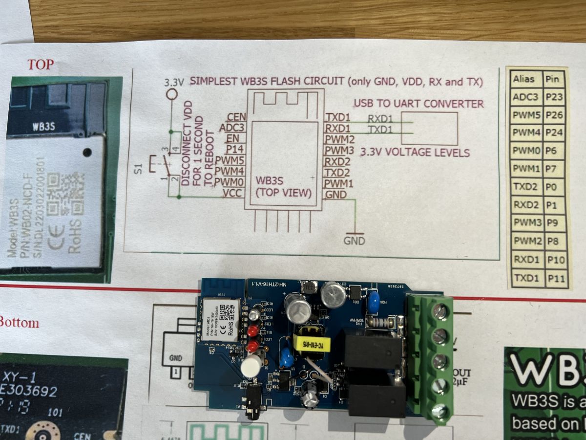

    Additional device view:
    Switch module with circuit board image and connection diagram. .

    Hello, in this case the device is built on WB3S - BK7231T, not ESP, so Tasmota will not upload.
    You can upload OpenBeken, which will give you basic compatibility with Tasmota protocols (some commands, JSON format, Tasmota Device Groups support) and equivalents of some of Tasmota's functionality (Home Assistant, scripts, etc).
    Flashing may not work due to something being connected to RX or TX, so as you wrote, you may need to cut the path. I would first recommend that you check exactly where this TX1 or RX1 (also TXD1/RXD1 in the screengrab, it's the same thing) is connected - do you have a multimeter?

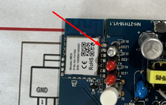

    Looking at the photo:
    Close-up of a PCB with a highlighted WB3S module.
    I have the impression that RXD1 is connected somewhere.
    But another question - when the flasher is waiting for "getting bus" do you do a power off/power on cycle? Do you disconnect and connect the power? This is the basics, if you don't do this it definitely won't work. The flasher must "catch" the BK7231 boot moment and only then can it upload the firmware.
    Here you have a video of WB3S programming:
    Additionally note - as of recently we have a new flasher:
    I also highly recommend making a copy of the original batch before uploading the new software. Read option in linked flasher .
    Additionally - how do you power this WB3S? I'd rather not recommend powering it from a USB to UART converter, although it depends what kind you have. The 3.3V LDO stabiliser there may not have enough current capacity. You need a robust 3.3V source.

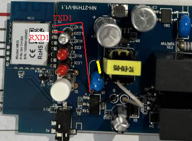

    kirol1
    Posts: 8
    During getting bus I short-circuit the Cen pin to GND.
    As a converter I use NodeMCU with a jumper between G with RST to skip the ESP8266 module.
    I have measured and Txd1 is connected to the blue capacitor (pin from the bottom). The Rxd1 pin is connected to the diode next to it (pin on the left).
    Is it theoretically sufficient that I disconnect the leg from the capacitor and the flashing should be successful? (Unplugging the leg marked in yellow)
    Connections between the TXD1 and RXD1 ports on the WB3S and NH-2TH16-V1.1 board
    PCB with WB3S module, capacitors, and connectors, with TXD1 and RXD1 pins highlighted. .

    #4 20697324
    Posts: 14771
    Rate: 12914
    I don't think TXD1 can be connected to the Y capacitor connecting the "hot" ground to the "cold" ground. There is no pad at TXD1. Maybe you inadvertently hooked the probe to the WB3S screen? The WB3S screen is at potential ground, so probing it to the leg of this capacitor should show 0 ohms.
    The CEN method is tricky, shorting the CEN to ground must take 0.25 seconds, I sometimes rub two contact wires together so it can catch. It is better to do a power off and power on cycle.
    Maybe disconnecting the diode from RXD1 will help, but also note what I wrote about CEN.

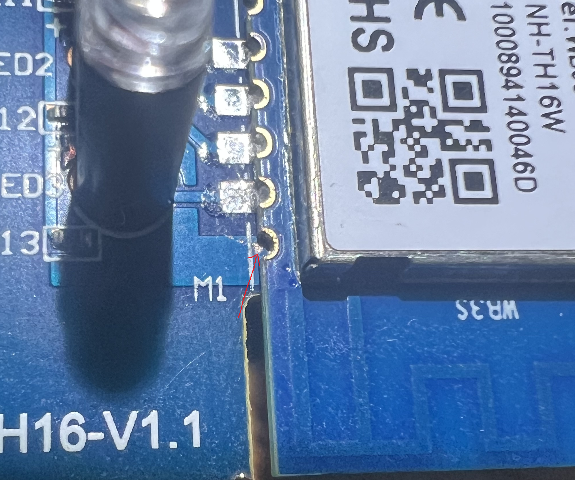

    #5 20697396
    kirol1
    Posts: 8
    From frequently applying the tester and leads, I made a slight abrasion on the laminate right next to the TXD1 contact and therefore the full connection I marked was coming out. After more careful application of the tester to the upper component no connections come out.
    I have shorted the laminate next to the TXD1 pin:
    Close-up of a circuit board with marked abrasion next to pin TXD1.
    During the first flashing I definitely had the TXD1 pin shorted to the laminate. I have just now attempted to flash by clearing this error and applying your advice about cutting power to the 3.3 volt pin instead of shorting CEN to GND. Unfortunately the flashing attempts remain at the same stage. Would it be easier to remove the diode or would I desolder the whole module with a heat gun ( I don't have hot air and I can set the heat gun to 300 or 500 degrees)?

    #6 20697419
    Posts: 14771
    Rate: 12914
    This is a bit bad, because now when you try to solder the pins to TXD1 the solder can also catch the board at the bottom and short out TXD1 to ground. You need to solder carefully. Although...
    How did you try to program as I don't see any solder marks on TXD1 and RXD1? Applying the wires is not a very reliable method, especially as the whole programming process takes a bit.
    Well, but okay, it doesn't change much. In summary:
    - solder (?) temporarily this LED from RXD1
    - when touching the wire to TXD1 (or soldering), touch only to TXD1, not to ground
    - start the flasher, switch off the power supply and connect it again
    In case of problems swap RX and TX with places.
    When switching off the power you are supposed to switch off only the power to the board itself with WB3S, you are not supposed to pull out the USB to UART converter completely from the USB, because then the COM port will disappear and the serial connection will break completely.

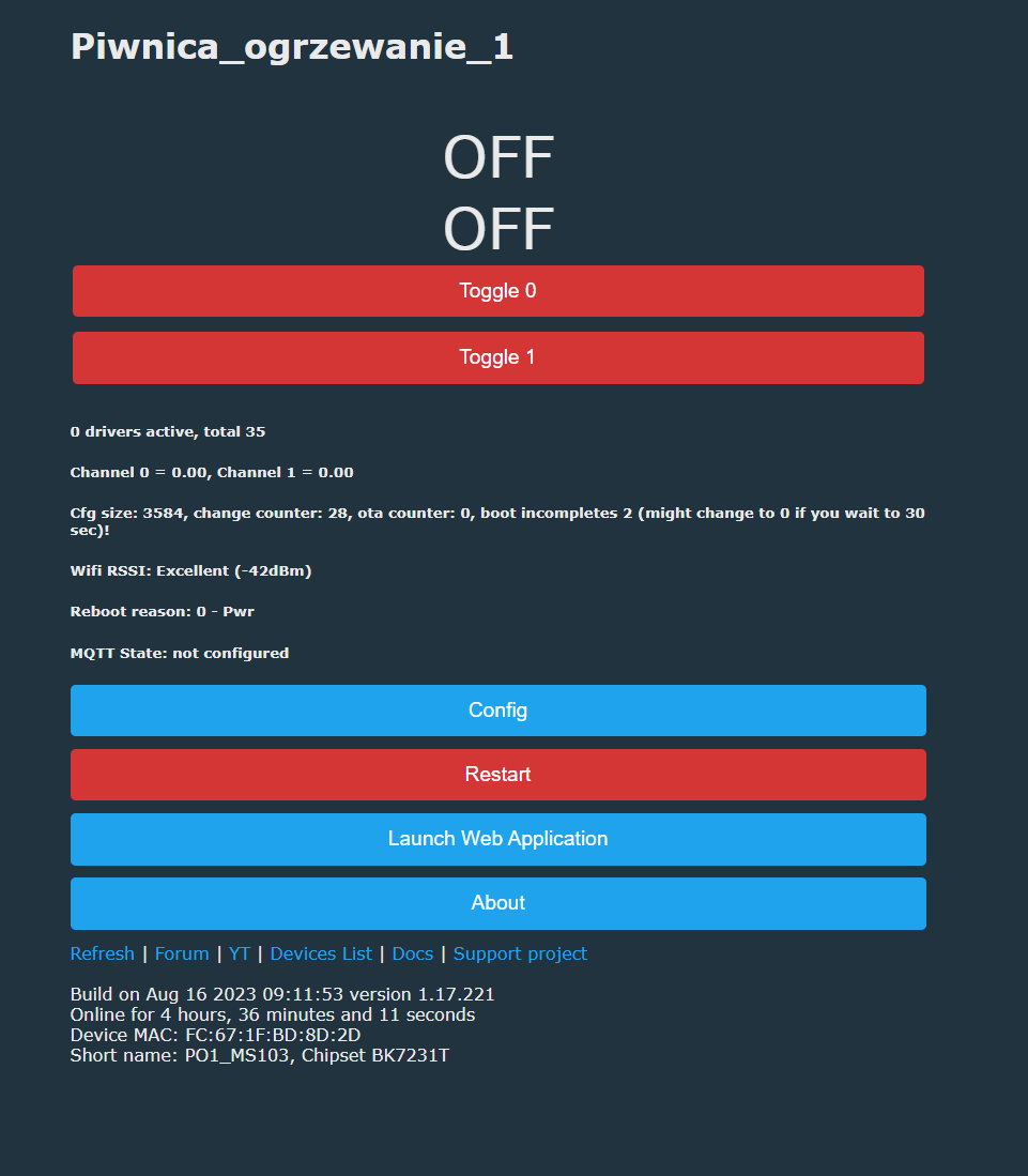

  • Remove pin 7 to disable 1-wire sensor input
    #12 20713500
    kirol1
    Posts: 8
    I have configured the pins according to this post https://www.elektroda.com/rtvforum/topic3966365.html
    Everything works very well excluding the one-wire protocol. I am impressed with the interface it is repaired clear and very comfortable to use. Responsiveness is excellent. I tried to poke around to get any digital reading from the DS18D20 but without any positive results.
    Configured device without temperature reading.
    WiFi device control panel with Toggle buttons and OFF status.
    PS at https://openbekeniot.github.io/webapp/devicesList.html
    The correct configuration is available (you have to remove pin 7 (temperature reading) from it):
