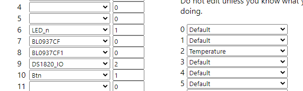

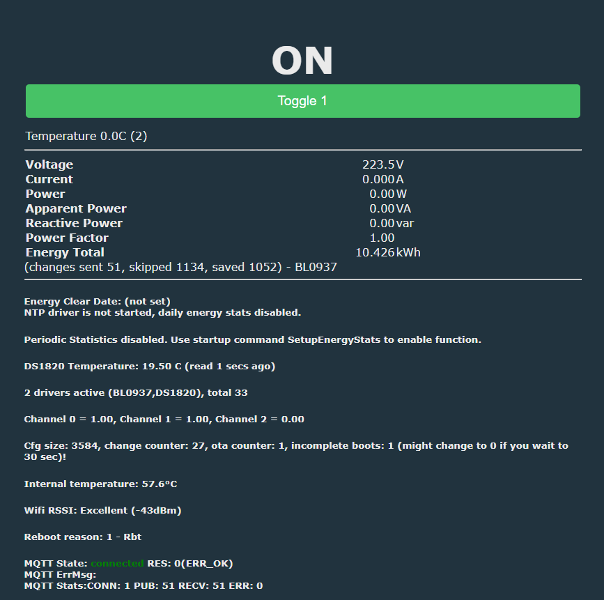

    >>21269846

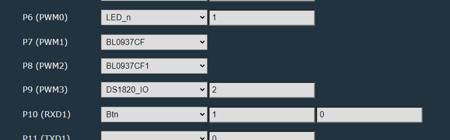

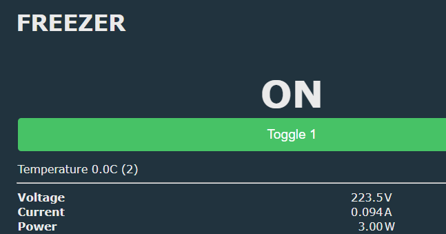

    I did use a different channel (2).
    On the main page of OpenBeken the temperature is indeed wrong also. It shows 0 degrees.
    Configuration channel settings list in OpenBeken showing settings for pins P6 to P11.
    OpenBeken home page displays freezer status with incorrect temperature reading of 0 degrees Celsius.
  • Set channel 2 to Temperature_div100 and publish DS1820 value

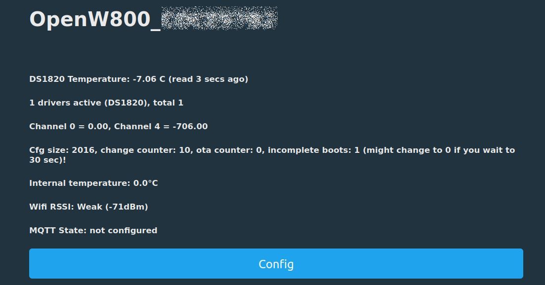

    I don't use HA, so I can only look into the "main page" atm.
    Just did a quick try here, and it seems o.k. (will take a deeper look this afternoon:

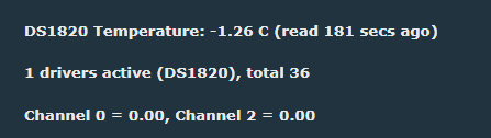

    OpenW800 status screen with temperature and WiFi signal data
    Added after 2 [hours] 59 [minutes]:
    O.k., tried here with a W800. This is one device without internal (CPU-)Temperature in GUI, it will allways schow "0" there.
    To get "Temperature" on the Main page, you will need to set this channel (2 in your config) to type "Temperature_div100" (in Web Application or as User command "setChannelType 2 Temperature_div100").
    The "temp" in MQTT is the internal CPU-Temperature (its 0.0 with my W800, too).

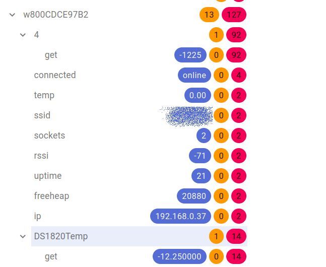

    In order to get the DS1820 value, you will need to publish the value:
    publishChannel 2
    will give the integer value of 100*temperature (so -20.81 will be -2081 there).
    Or you add a regular publishing of the float value (you might need to enable "#define ENABLE_EXPAND_CONSTANT 1" in the obk_config.h file for your platform to make "calculation" work):
    addRepeatingEvent 5 -1 publishFloat DS1820Temp $CH2/100
    This is how it looks here (with channel 4 for my DS1820):
    User interface showing details of device W800C0DCE97B2, including DS1820 temperature status.

    imvaloo
    >>21270035
    I tried to upgrade to the latest firmware because I saw there were some modifications to the DS1820 code, but it broke the readings for me, it was giving errors about the family. So I reverted back to the firmware that I used previously and that reported the temperature.
    I'm currently running 1.17.732.
    My device also reports internal temperature.
    I did set the Temperature to channel 2:
    Screenshot of device configuration settings.
    However on the home page it doesn't show on Channel 2, even though the temperature is reported under DS1820:
    Screenshot of the Antela smart plug user interface displaying power and temperature parameters.
    Thanks a lot for looking into this!

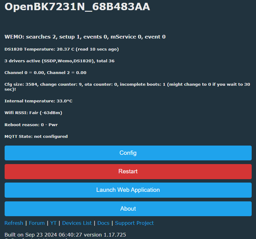

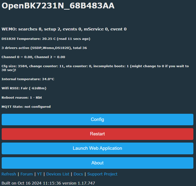

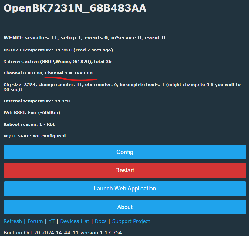

    just trying a few things on my own BK-N/DS1820 - P9/CH2 and a few builds. This particular DS1820 is a Maxim DS18B20 - A1 family - https://www.elektroda.com/rtvforum/topic4056286-30.html#21165112
    Screenshot of the OpenBK7231N user interface showing various device statistics.
    .747 - release before "Improve DS1820 driver (#1382) (ad816b7), closes #1382"
    Screenshot of the OpenBK7231N user interface displaying DS1820 sensor data and system information.
    then on latest build
    OpenBK7231N control screen displaying DS1820 temperature chart and configuration options.

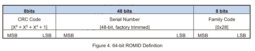

    And there might be another issue following the datasheet of Sensylink CT1820B
    64-bit ROMID definition including CRC code, serial number, and family code.
    the family is 0x28 here, too

    BK7231N SoC temperature reading shows 35.3°C. Display showing W600 SoC temperature as 0.0°C. Image showing BK7231T SoC temperature: 61.2°C LN882H SoC temperature: 24.2°C
    Display showing BL602 SoC temperature: 36.6°C. W800 SoC temperature indicator showing 0.0°C.
    Added after 10 [minutes]:
