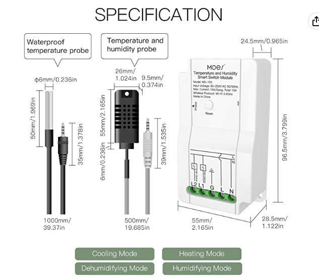

    MOES WiFi Smart Temperature and Humidity Switch Module MS-103
    MOES WiFi Smart Temperature and Humidity Switch Module MS-103 MOES WiFi Smart Temperature and Humidity Switch Module MS-103
    Core Model:WB3S

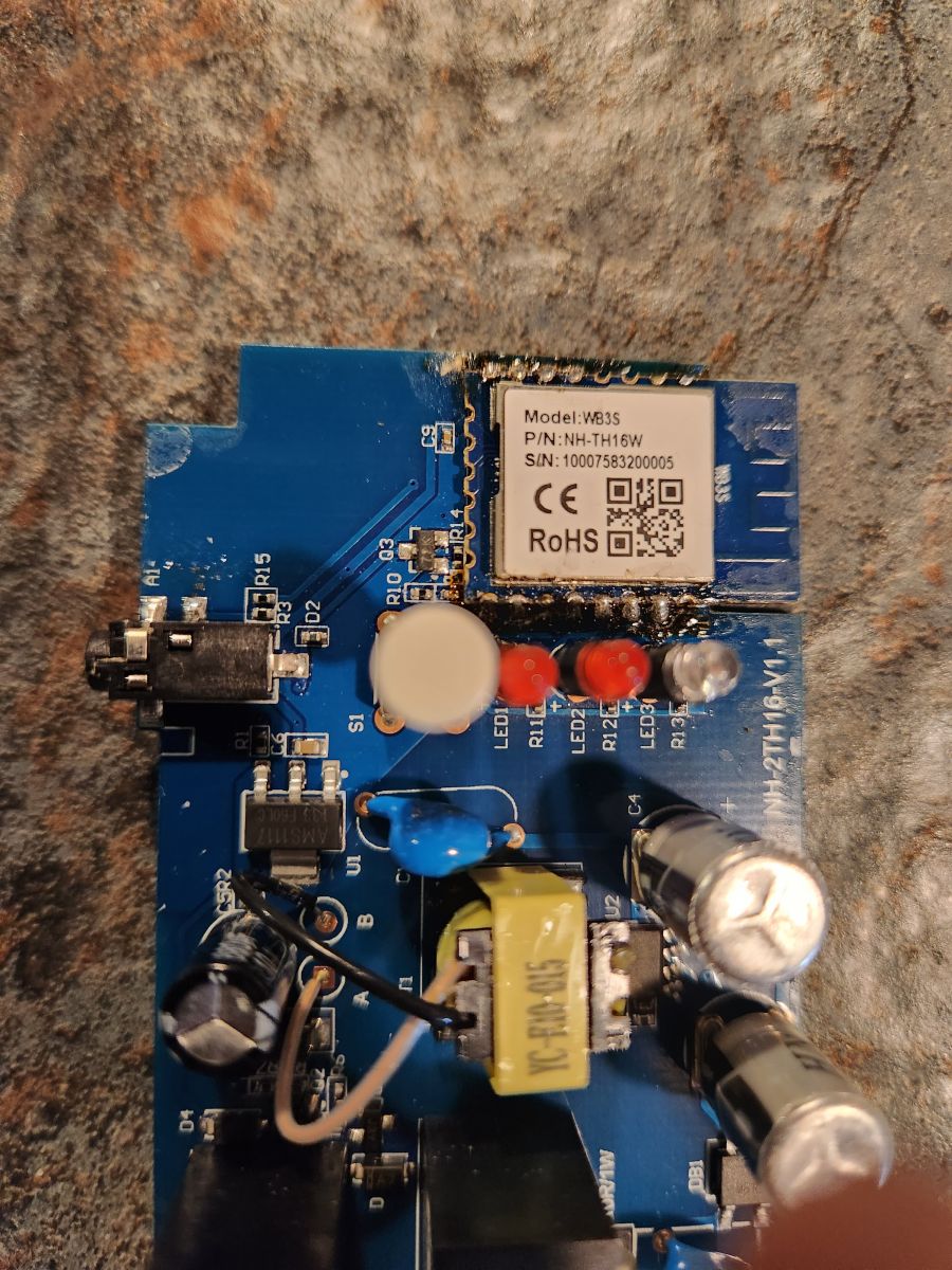

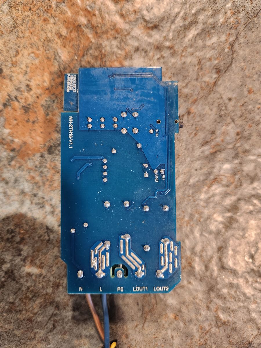

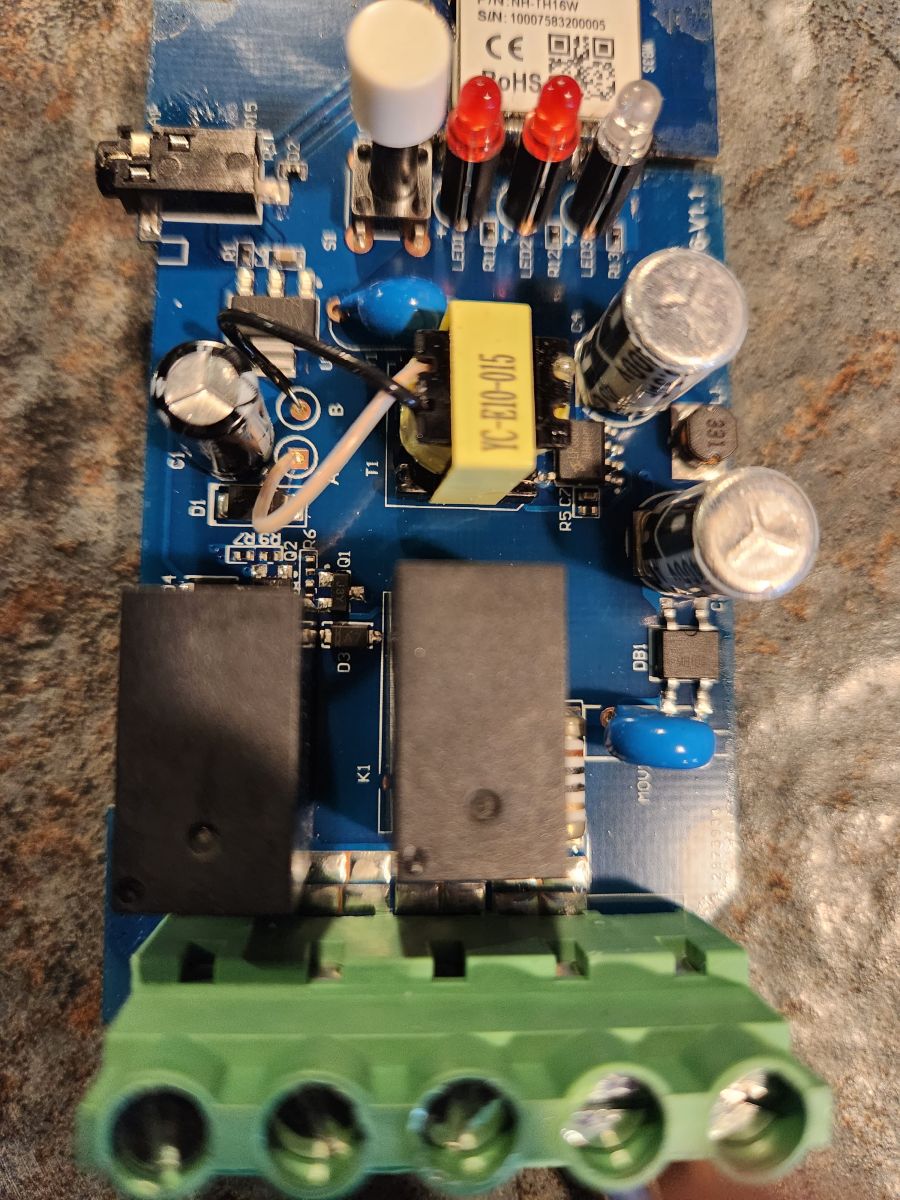

    This device has three LEDs, a button, and two relays, as well as a 1-Wire sensor interface that supports two types of sensors: the DS18D20 temperature sensor and the CHT8305 temperature and humidity sensor, both using a 1-Wire connection and not I2C. The button controls the on/off state of the two relays, and automatic temperature and humidity control can be set up using Tuya's Smart Life app, making it ideal for various temperature control scenarios. However, it should be noted that the maximum current for the relays is 10A, so the load device should not exceed this limit without taking appropriate measures. Currently, the only drawback of using the OpenBeken platform is that it does not support 1-Wire devices. Below are the GPIO definitions for the WB3S chip.
    “pins”: {
    “1”: “Btn;0”,
    “6”: “Rel;1”,
    “7”: “1-Wire;0”, #TO DS18D20 OR AM2301A
    “8”: “LED_n;1”,
    “9”: “LED_n;0”,
    “10”: “WifiLED_n;0”,
    “24”: “Rel;0”

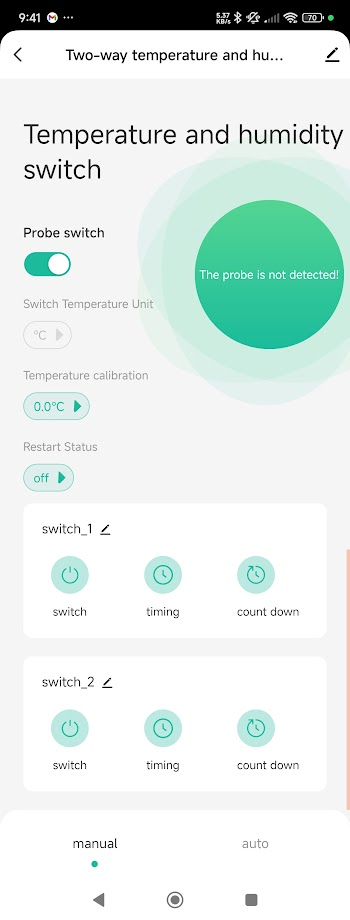

  • Firmware backup boot log from MS-103 device
    #7 21276199
    Posts: 5213
    Help: 446
    Rate: 914
    >>20502349

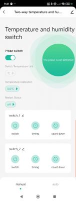

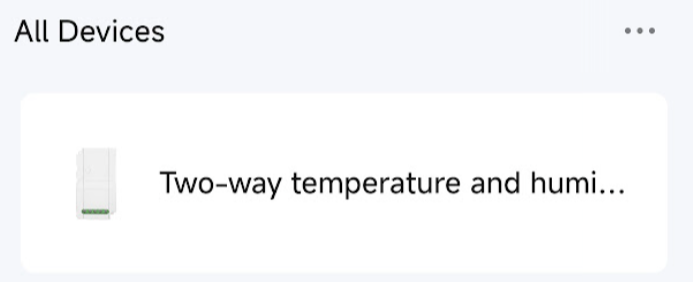

    a bit more info from the firmware backup of the MS-103 taken from a post on Cloudcutter Github. Sensors not present on test device flashed to.
    boot log
    extracted config data before pairing with Tuya app
    and after
    Device in Tuya app
    Two-way temperature and humidity device on the device list in the Tuya app.
    View of the Tuya app showing a temperature and humidity switch.
    • MS103_WB3S_1.2.8.bin (2 MB) You must be logged in to download this attachment.
