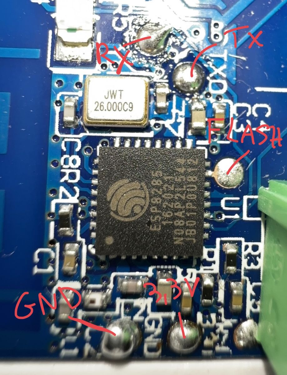

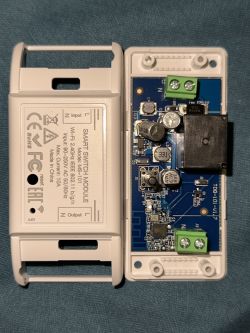

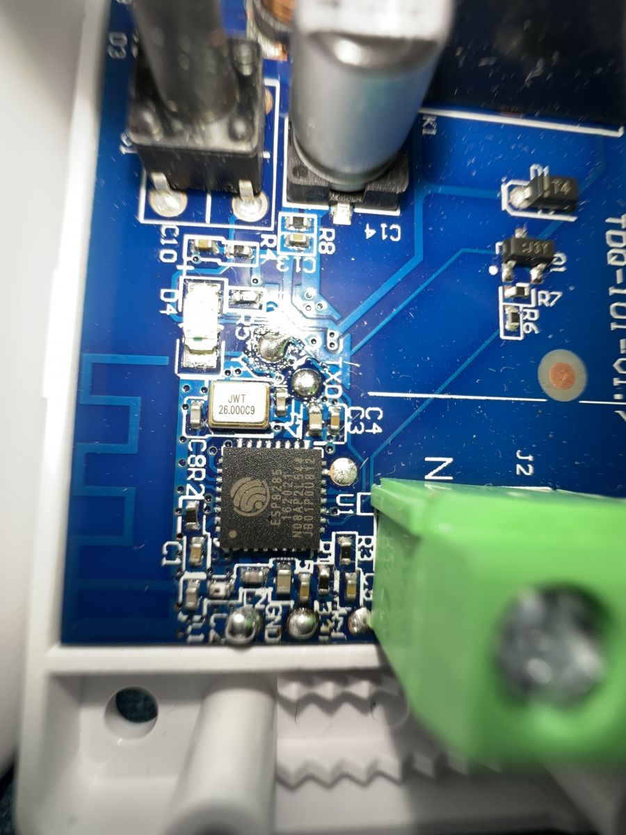

    A smart switch with an ESP8285 directly soldered to the PCB
    Tuya-convert doesn't work. I used the Tasmota web installer to flash the device
    Discussing ESP8285 10A MS-101 TDQ-101-U1-V1.7 Smart Switch: Tuya-Convert, Tasmota Flash, and Pinout Discussing ESP8285 10A MS-101 TDQ-101-U1-V1.7 Smart Switch: Tuya-Convert, Tasmota Flash, and Pinout Discussing ESP8285 10A MS-101 TDQ-101-U1-V1.7 Smart Switch: Tuya-Convert, Tasmota Flash, and Pinout
    Pinout:
    GPIO 5 LED
    GPIO 12 RELAY
    GPIO 13 BUTTON

    Overal quality of the switch seems very cheap, I can see only the fusible resistor protection of the input, but still, it should do the job. Have you managed to get the Tasmota template for that one?

    I just had the same device and realized... it has no LDO! BP2525 provides 3.3V directly, and relay is also for 3.3V. Interesting. @divadiow
    Here's flash backup: https://github.com/openshwprojects/FlashDumps/commit/e990c20d65816edfeb424e4befbda3631ea2257e

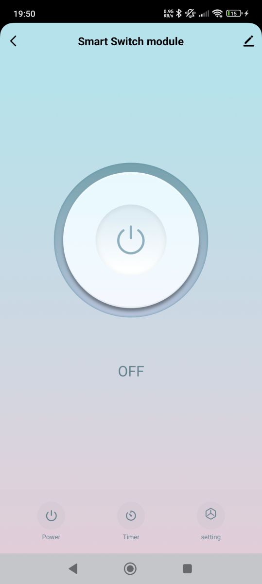

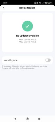

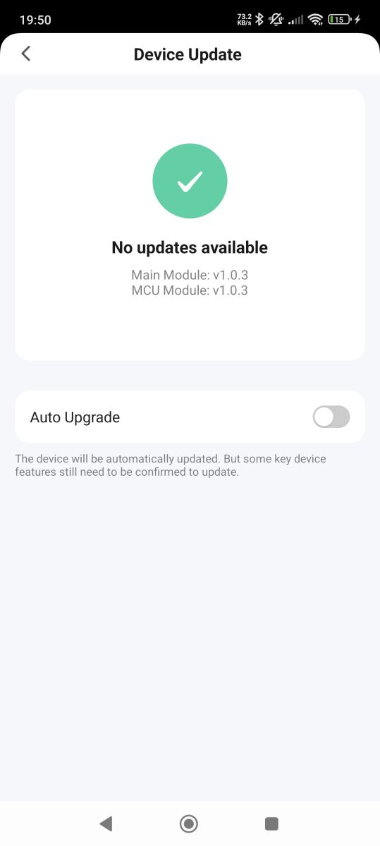

    I have flashed and paired. IO13/D7 to get into AP mode.
    Smart switch app screen with central power button set to OFF Device update screen with message No updates available displayed

    MCU module?
  • #8 21782562
    Posts: 5208
    Help: 446
    Rate: 914
    doesn't it always have both, if TuyaMCU it'll be different version
  • #9 21787165
    Posts: 14754
    Rate: 12875
    Is it? I didn't look there much, but at some point I assumed that for non-TuyaMCU devices, it will have only a single version string. I may be wrong.
