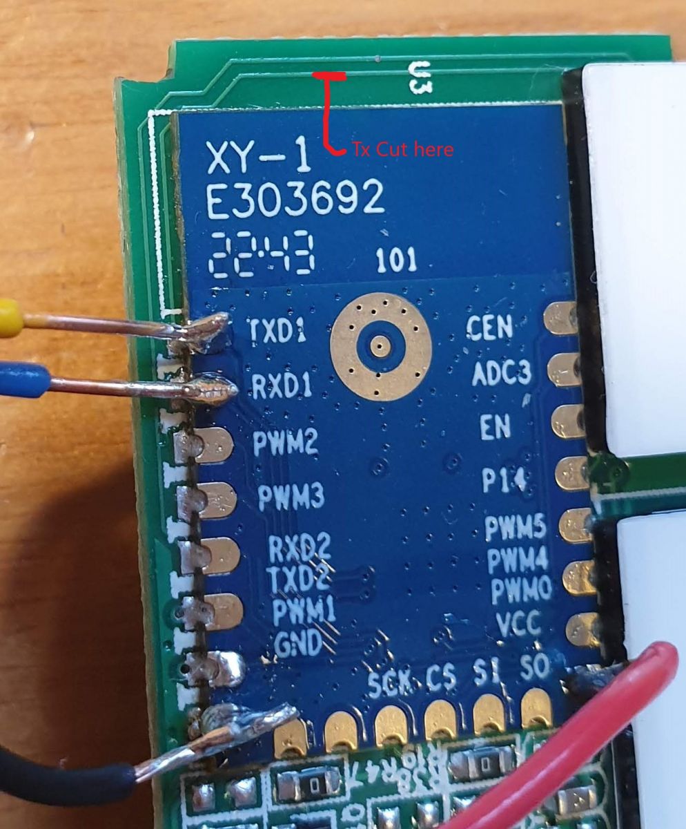

    Using the BekinWriterV1.60 to flash a Tuya WB3S board is not working - it just doesn't get going and reports Failed after the 15 seconds or so. I am disconnecting/reconnecting power, then grounding the CEN briefly (loose orange wire in pic) all within the 15 seconds. I have my USB to UART board set to 3v3 and all wires are directly soldered to the WB3S pads. I note your video on a similar board you desolder a 8 pin chip. In my case I have a 16 pin chip in that position and I'm not skilled enough to remove that! Is that the problem do you think? Is there anything else I could try? I have worked out the Button x3, LED x3 and Relay x2 outputs and was intending to add the device to your knowledge base, but little point if it cannot be flashed. Pictures below:- Flashing Tuya WB3S in Window Controller with BekinWriterV1.60 - Fail & 16-Pin Chip Removal Flashing Tuya WB3S in Window Controller with BekinWriterV1.60 - Fail & 16-Pin Chip Removal Flashing Tuya WB3S in Window Controller with BekinWriterV1.60 - Fail & 16-Pin Chip Removal Flashing Tuya WB3S in Window Controller with BekinWriterV1.60 - Fail & 16-Pin Chip Removal Any help would be great.

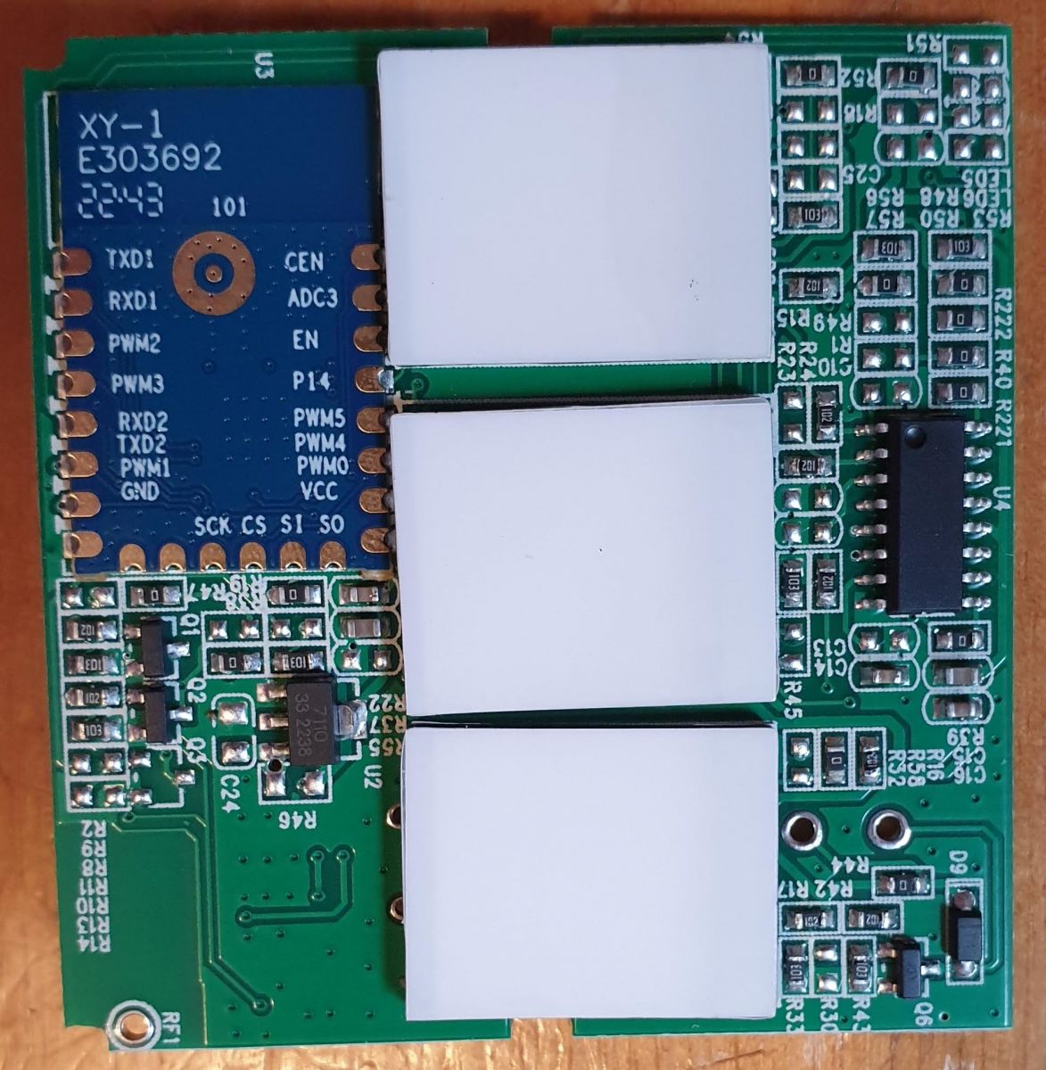

    Hello, can you check the RXD1/TXD1 pads of WB3S with multimeter and check if they are connected anywhere, maybe to SOIC chip?

    From what I can tell having probed it with an oscilloscope, the RXD1 is used as the input from one of the buttons, and the TXD1 is an output that drives a blue LED under one of the buttons. I'll try again with a proper 3v3 power supply on the VCC pad. Edit: - I've tried it now with a 3v3 lab supply to the VCC pad with a common ground and no difference regarding flashing. I also put a scope on the RXD1 pad and can see a repeating square ish wave while the 15s thing is going on. But the wave form is only going between 3v3 and about 2v8 (nowhere near ground). So my guess is there's some other circuitry keeping the voltage up and stopping the device receiving any input. I couldn't see a signal on the Tx but that's not surprising.
    We had a similar situation on video:
    https://youtu.be/Yb3zXtBdSnE?list=PLzbXEc2ebpH0CZDbczAXT94BuSGrd_GoM
    You must disconnect those devices from UART lines somehow. Cut the trace (and then fix it) or desolder the chip, etc...

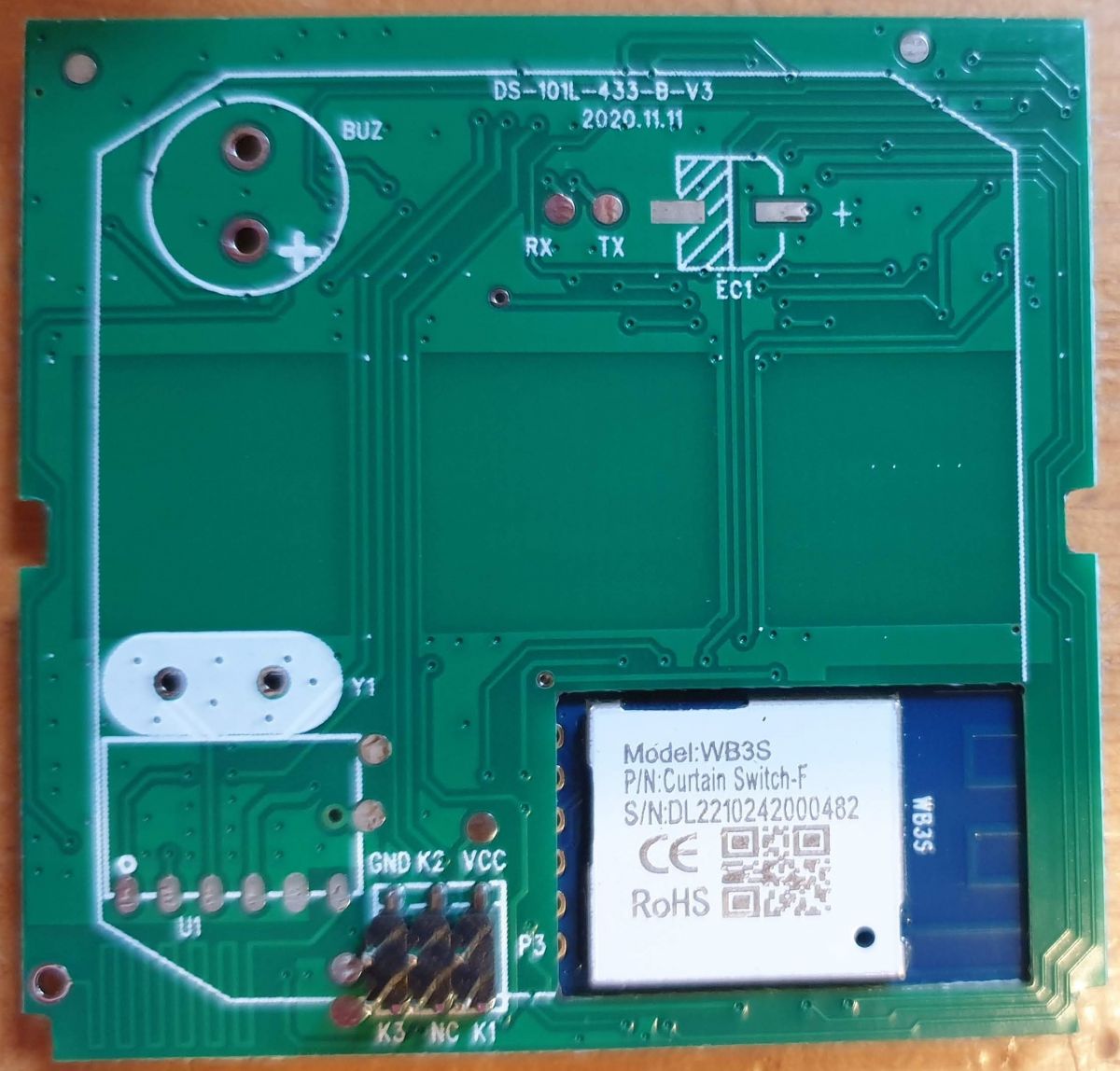

    OK Understood and thanks for helping. I've cut the 2 tracks in the positions indicated on the pictures. Checked with a multimeter. Flashing Tuya WB3S in Window Controller with BekinWriterV1.60 - Fail & 16-Pin Chip Removal Flashing Tuya WB3S in Window Controller with BekinWriterV1.60 - Fail & 16-Pin Chip Removal Now when I try to flash, when I power back on, the 15 second timer stops immediately and I get a failed message. On 1 occasion it said something about setting baud rate but still failed. Oscilloscope is now showing a signal on the Rx pin going 3v3 to ground. Here's my settings and the failed message: Flashing Tuya WB3S in Window Controller with BekinWriterV1.60 - Fail & 16-Pin Chip Removal I also tried the python program OpenBKT uartprogram but that fails too with the message 'Unprotect failed'. Also fyi, the board uses PWM3 and 0 for the 2 relays, PWM2 and 4 and RDX1 for the 3 buttons, and TXD1, PWM5 and PI4 for the blue LEDs under the buttons. does another of those prevent flashing?
