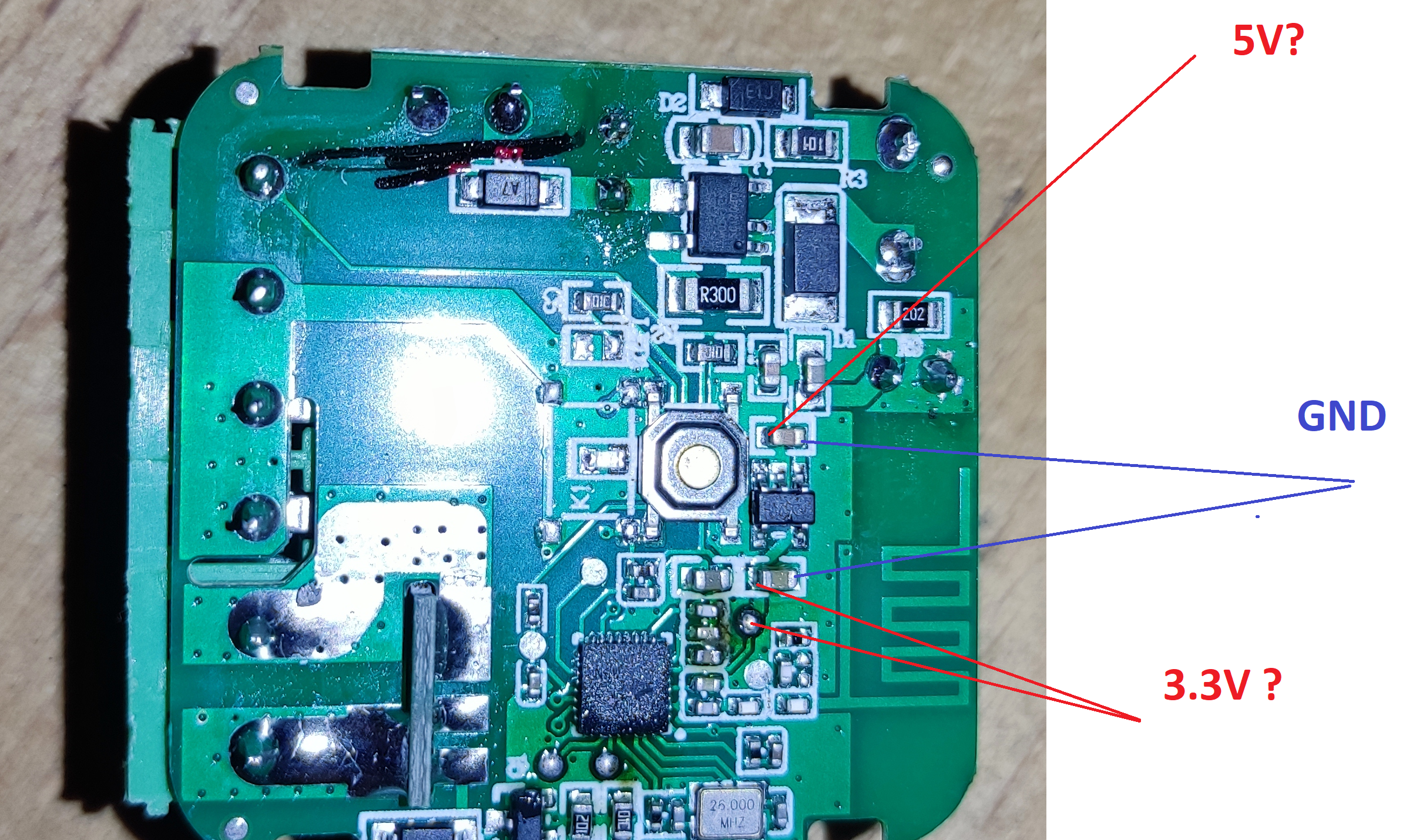

    I am attaching a photo of my board in case you can tell me where to take measurements.
    Close-up of a circuit board with various electronic components.
  • #4 20703189
    Posts: 14771
    Rate: 12914
    Maybe you should try to probe those places:
    Circuit board with voltage and ground markings.
  • #5 20703994
    sephirothnaxo
    I have measured and I have no value in either 3.3v or 5v. Maybe a capacitor or diode is damaged?
    Apparently there are no signs of overheating in the components (the board is new).
    Regards!

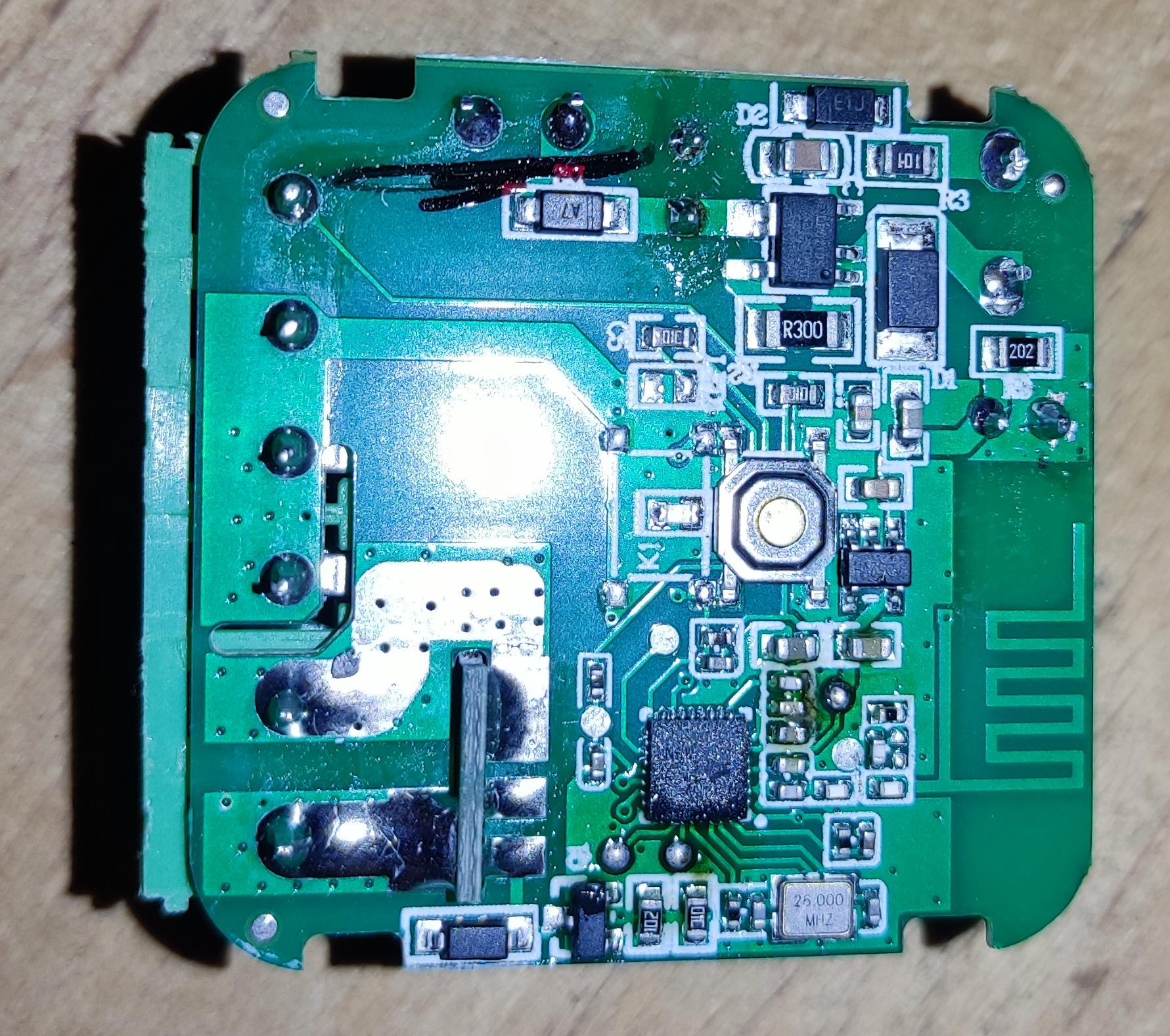

  • Open coil near R1 caused mains fault
    #7 20704457
    sephirothnaxo
    My network is 230V (Spain) and in the measurements, the equipment was connected and with 225V approx between L in and N out.
    I have tried with another device that I have that does not work well (the UART does not detect it and it does not start with the original fw either), but the regulator values give exactly 3.3V and 5V.
    I think it may be a fault in the high voltage circuit. Where would you go?
    Don't worry about safety, the line is protected with a circuit breaker and differential (30 mA) exclusive to the workshop :).
    Regards, and thank you very much.
    Edit:
    After measuring capacitors and diodes, I noticed that one of the coils (located near R1) was open. One of the wires had become unsoldered from the pin (perhaps from a blow).
    I have replaced it, and after that, everything works fine.
    Thank you very much for the help.
    You can close the thread. All the best.
