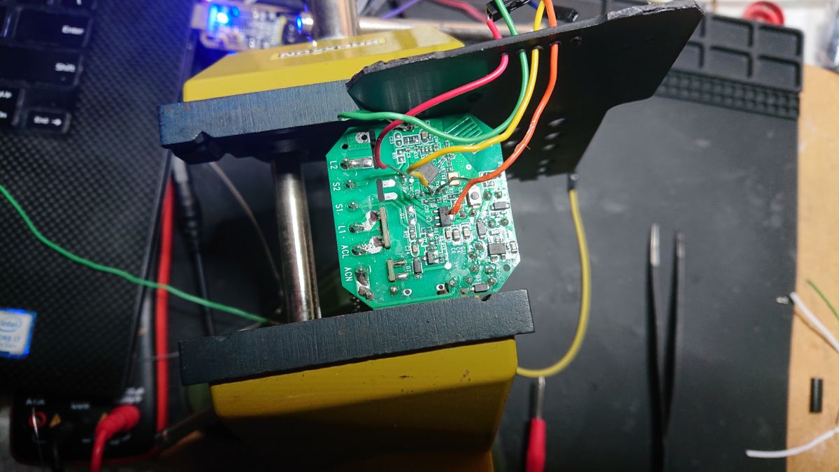

    I just flashed openbeken on this device:
    [BK7231N Aubess] Mini Light Switch Teardown, 5A Capability, OpenBeken Flash & GPIO Info led[BK7231N Aubess] Mini Light Switch Teardown, 5A Capability, OpenBeken Flash & GPIO Info [BK7231N Aubess] Mini Light Switch Teardown, 5A Capability, OpenBeken Flash & GPIO Info
    Beware this is a 5A device, not 16A ! The advantage of this device is that it uses L as an input for an external switch
    Assignment:
    Gpio6 is the led
    Gpio8 is the relay
    More gpios follow, I only traced it using power from my ttl level serial flasher.
    Bought here:
    https://a.aliexpress.com/_mNQp4Ee
    Image got mangled.
    I have a backup flash image for cloudcutter. I will post that later

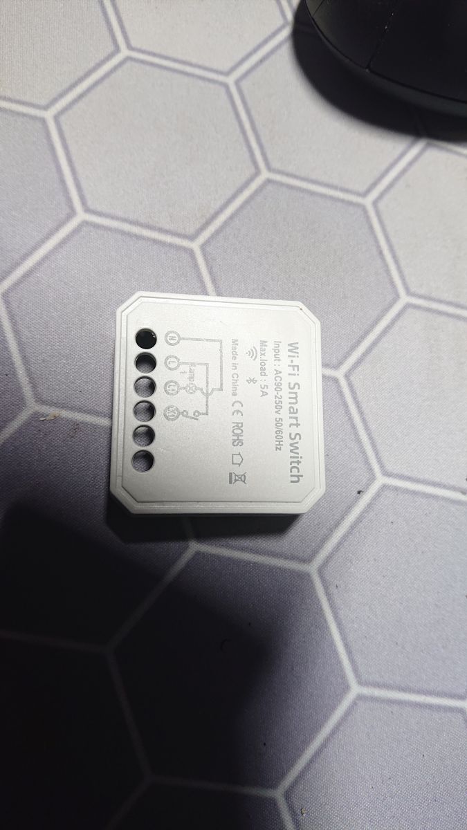

    yvesdm3000
    Posts: 7
    That seems to be the model name, but mine has a different print on the shell, without a model number... A bit weird. On mine there is also a Bluetooth logo. Does the BK7231N also support Bluetooth ?

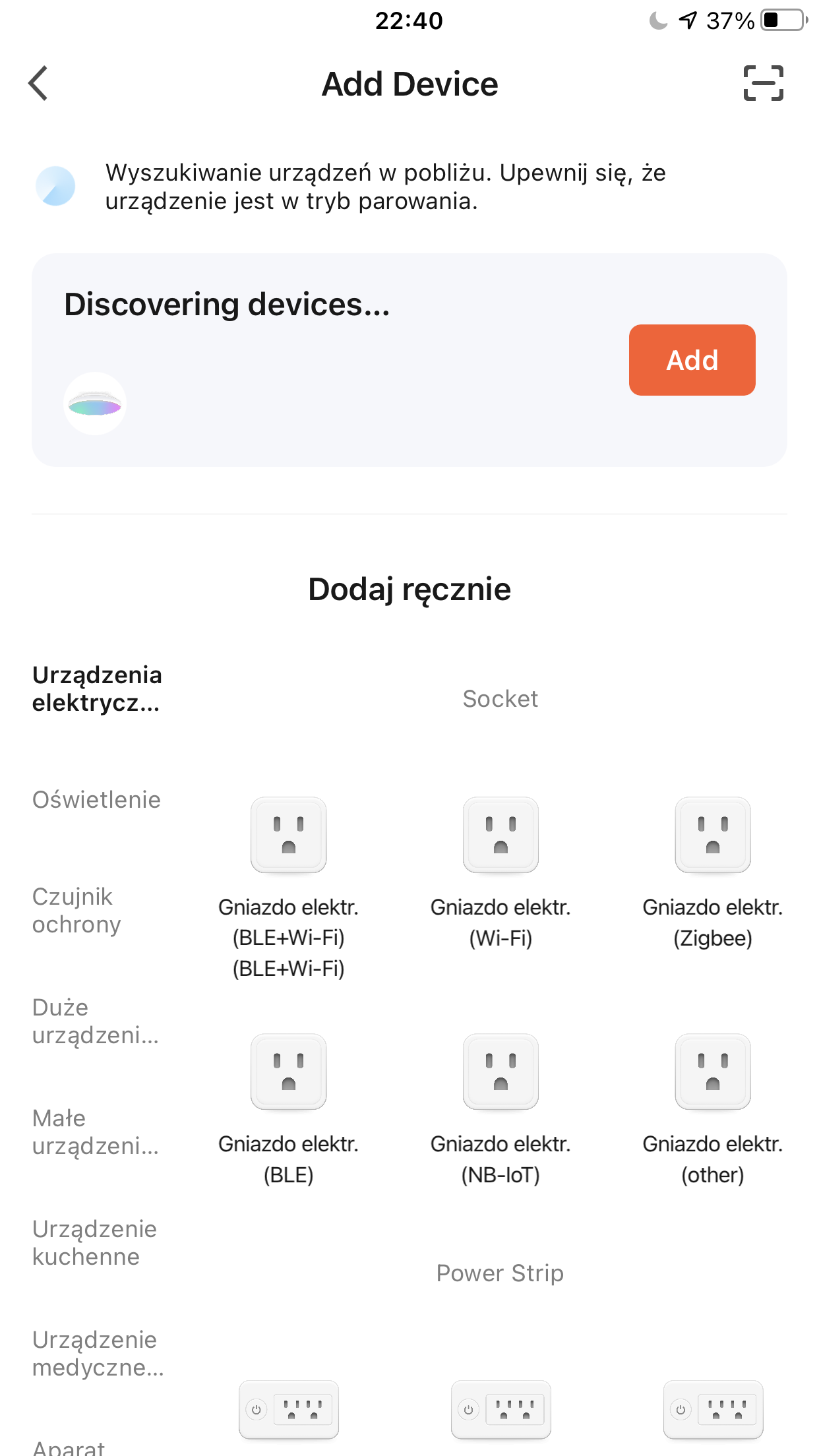

    It supports Bluetooth, which is also used for quick pairing with Tuya App:
    I've also looked more at the offer and the quality of their English does not inspire confidence:

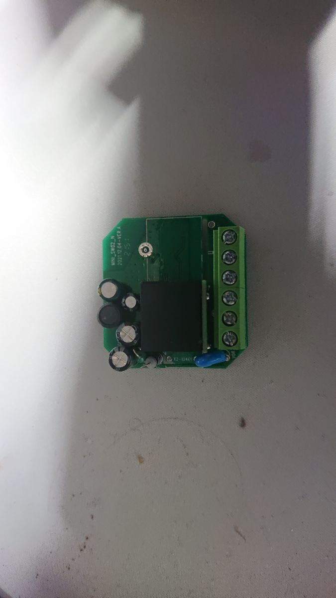

    Remaining pin roles:
    Pin10: Backside push button
    Pin24: Live 240V external switch
    The other device is a Balco HE200022 multi-steckdose. It's a lot heavier than the Chinese ones that I use (I replaced with esp chip) and at least the tuya-cloudcutter script seems to indicate a BK7231 chip. I ordered a triangular screwdriver since I don't have one that is long enough to open the device.
    Yves

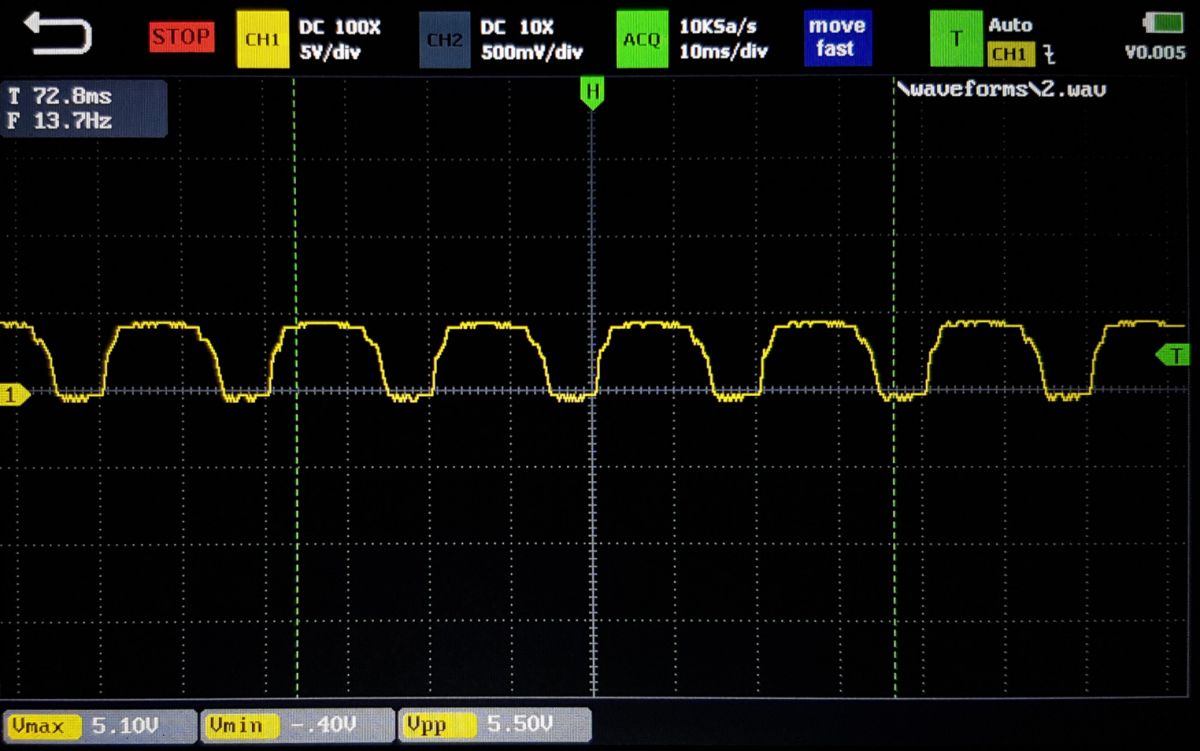

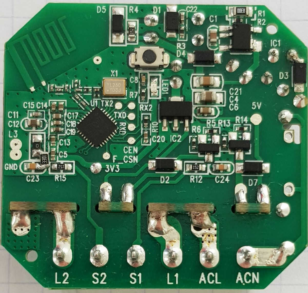

    #19 20438105
    dufu
    Posts: 10
    From the very beginning this switch doesn't work reliably with physical switches and often goes offline.
    If I toggle any of the two physical switches, it can:
    - not switch at all
    - switch after several seconds
    - toggle the light several times
    It also can toggle the light randomly itself.
    I checked with spectrum. This is what I had on S input:
    It should be steady 3.3V
    I already managed to overcome this problem with soldering a 3.3k pullup resistor.
    But I wonder that this should be done via MCU pull-up configuration. Probably Chinese developers forgot to activate pull-up.
    This is the photo of the board with soldered pull-up resistor
    I didn't try your firmware yet.
