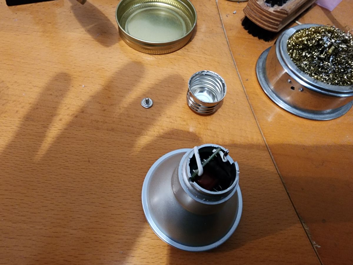

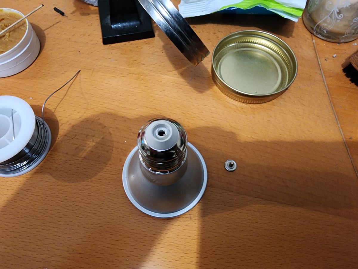

    Take the Live input cap off of the bulb socket, you can use a fingernail to get under the lip to pop it up:
    Non-disassemblable bulb on a table with a metal socket.
    Once it is removed:
    Disassembled light bulb on a table with soldering tools and a lid.

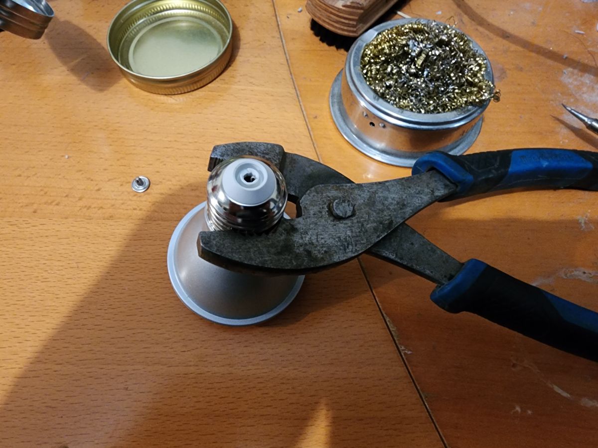

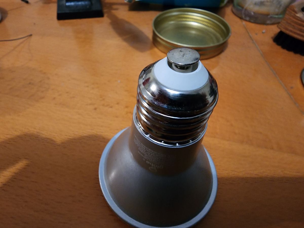

    Next, take some pliers and GENTLY squeeze the bulb socket to get it to break loose from the plastic housing, I also rotated it back and forth while applying pressure.
    Pliers clasping a light bulb socket on a workshop table.
    After removal of the socket:

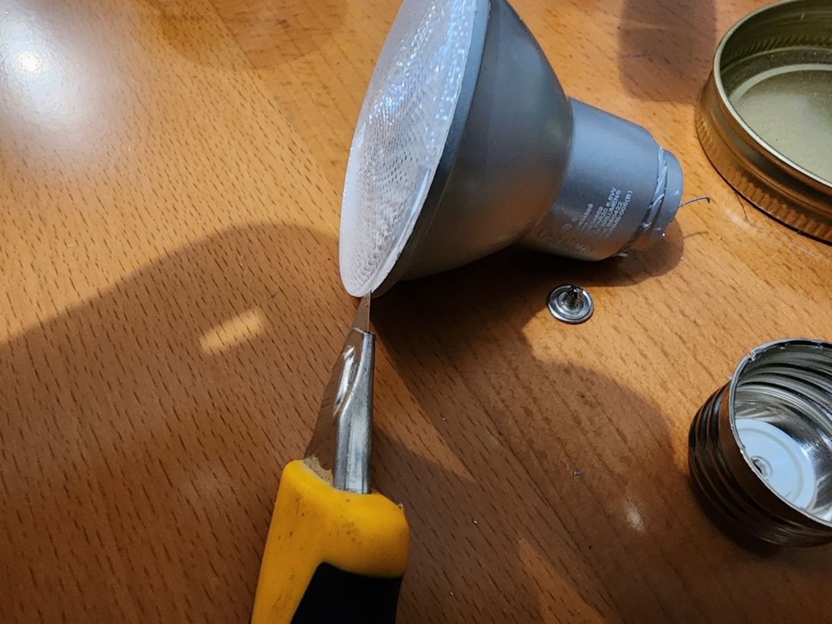

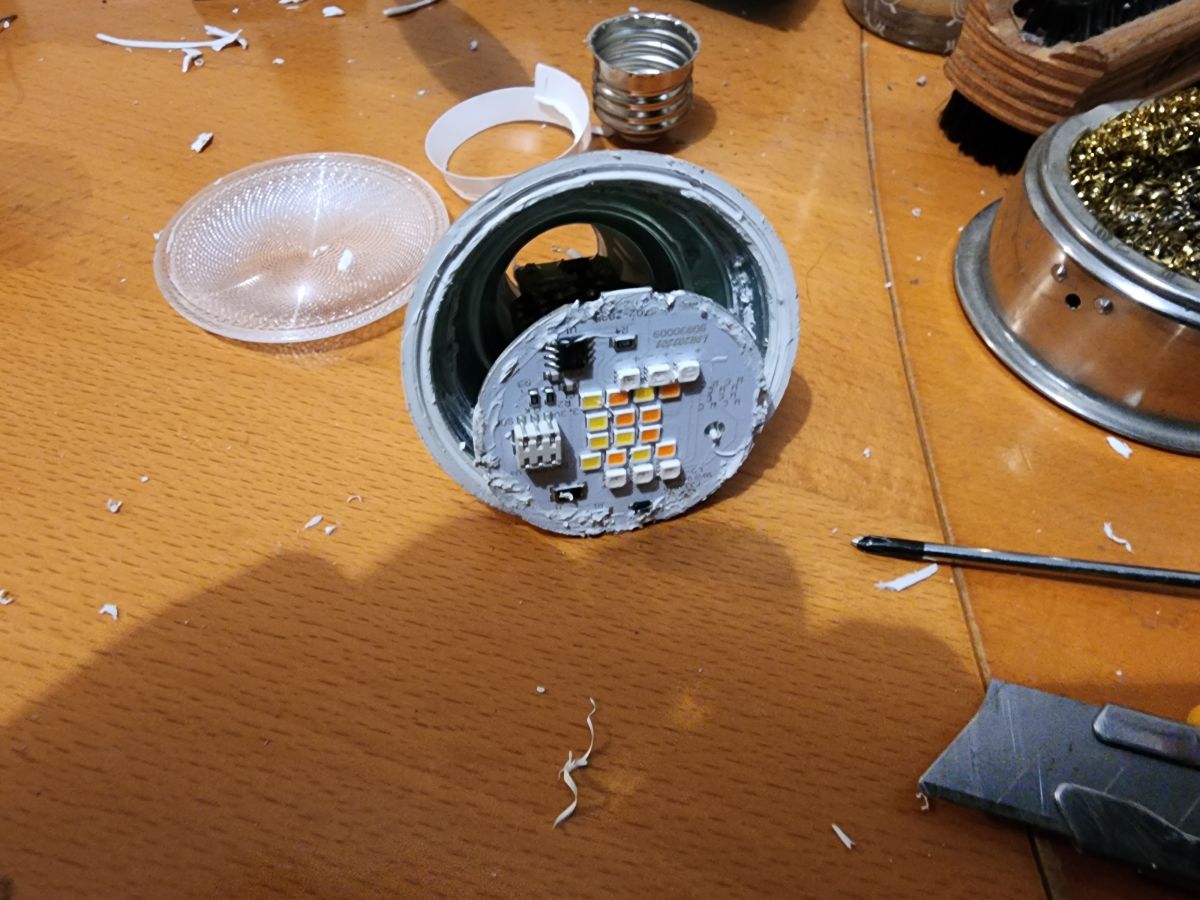

    Now, we can move onto the other end of the bulb, I used a utility knife to get inbetween the lens and the body and worked my way around to pop the lens off:
    Dismantling a light bulb using a knife.

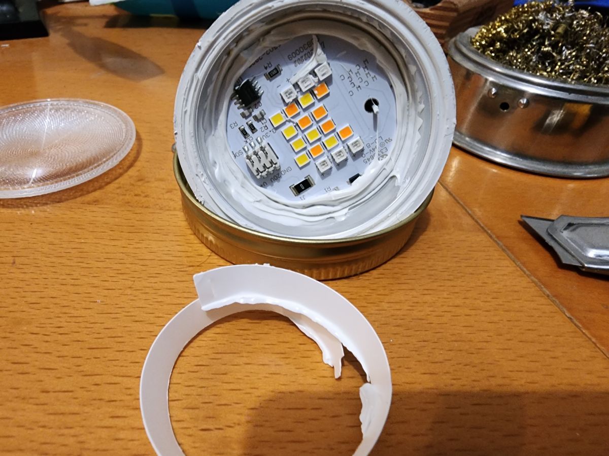

    In my bulbs, there is some sort of white mastic substance used as glue to keep the lens on and hold the LED plate in place. You can also see some sort of white plastic ring that sits inside of the plastic body (for light glare perhaps?). You will need to remove that plastic ring and then remove enough of the white glue to pop the LED plate out.
    Interior of a dismantled smart bulb showing the PCB and LED components.

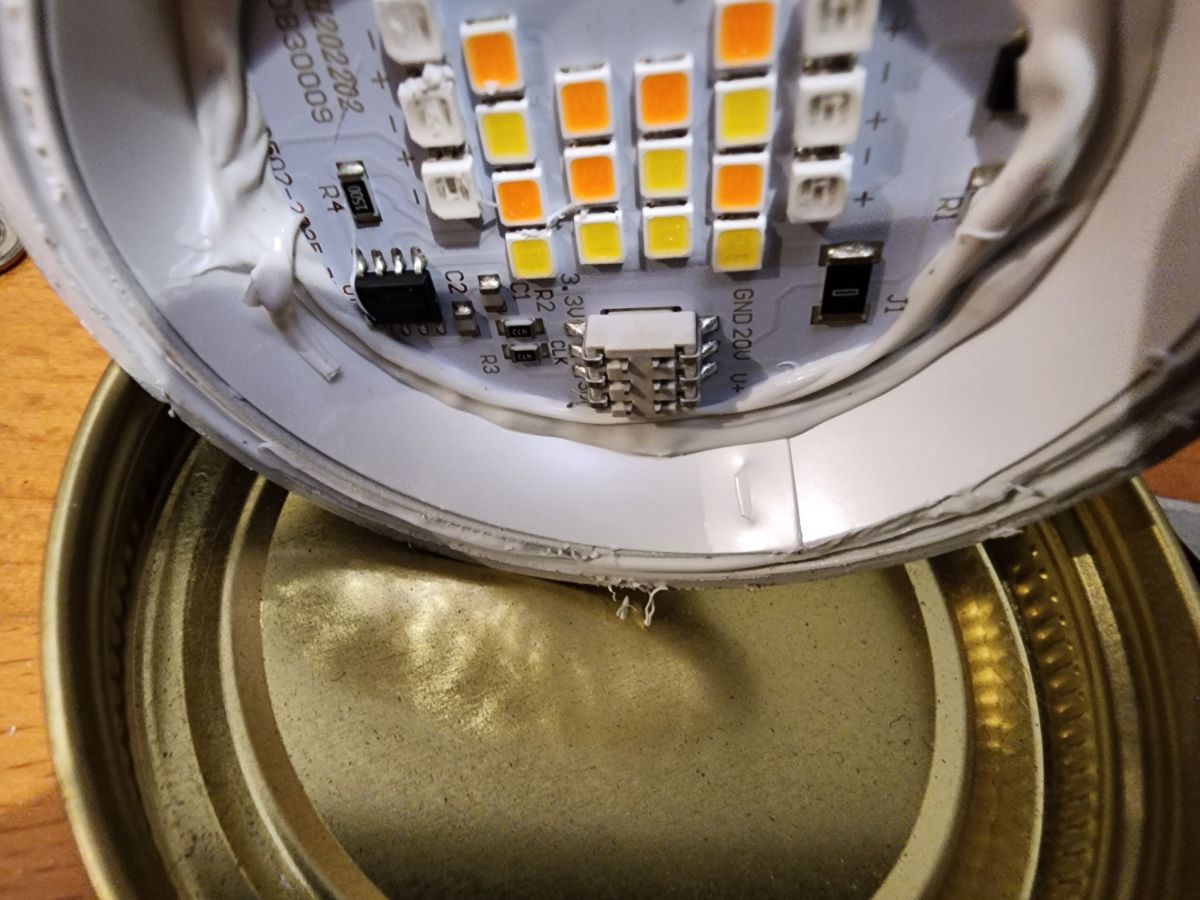

    After pulling the white ring out:
    Interior of a disassembled smart light bulb with visible LED array and white adhesive.

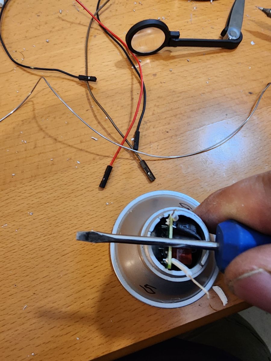

    Now comes the fun part of removing the glue and popping the LED plate out. Take a flathead screwdriver or something similar and scrape as much of the white glue off of the led plate as you can. Use the screwdriver to try and pop the plate up a little bit to loosen it from the glue. Then turn the bulb over and push on the bottom PCB to pop the plate up.
    Person disassembling a light bulb with a screwdriver.
    This leaves the plastic body separated from the PCB:

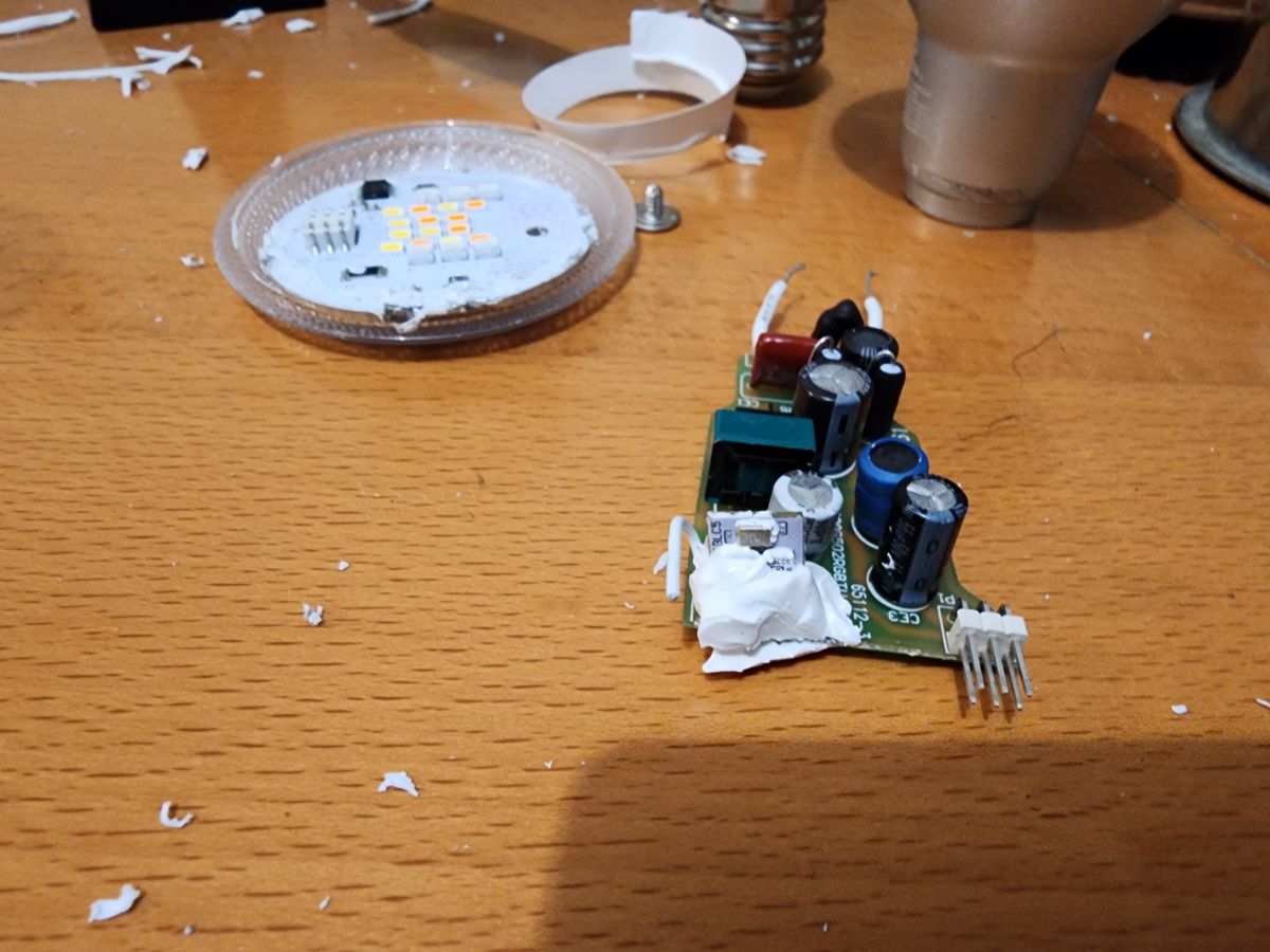

    Now, lets move onto the PCB and the choice of either leaving the daughterboard in place or removing the daughter board and then resoldering it back in after flashing. I personally desolder the daughter board and then resolder it after flashing. Leaving it in place is doable but, it is a nightmare to solder the TX/RX wires in place.
    PCB after removing from plastic body:
    Disassembled light bulb with visible internal circuit board.

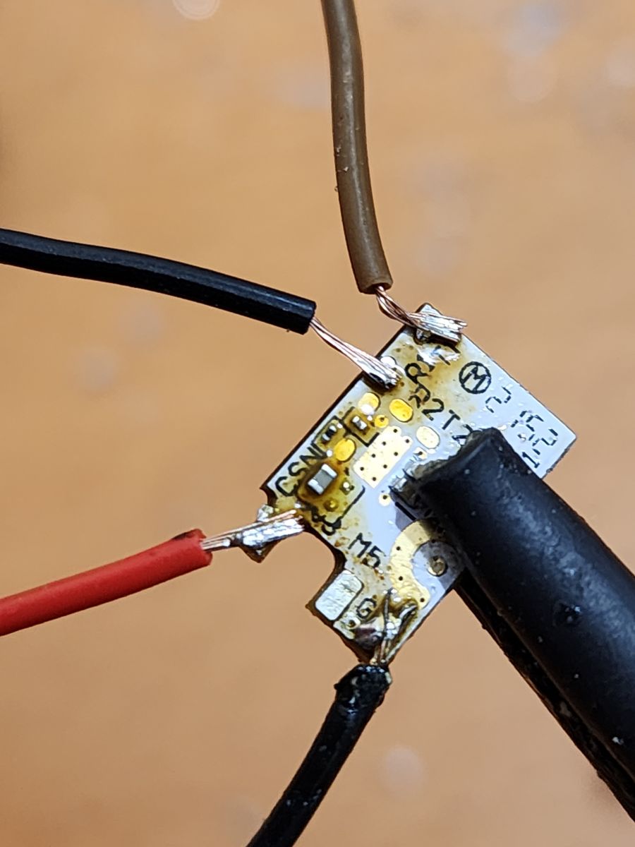

    The T1/R1 pads are on the backside of the daughter board. You can see them here in the top left corner of the white PCB.
    Close-up of a light bulb's circuit board with visible capacitors and wires.

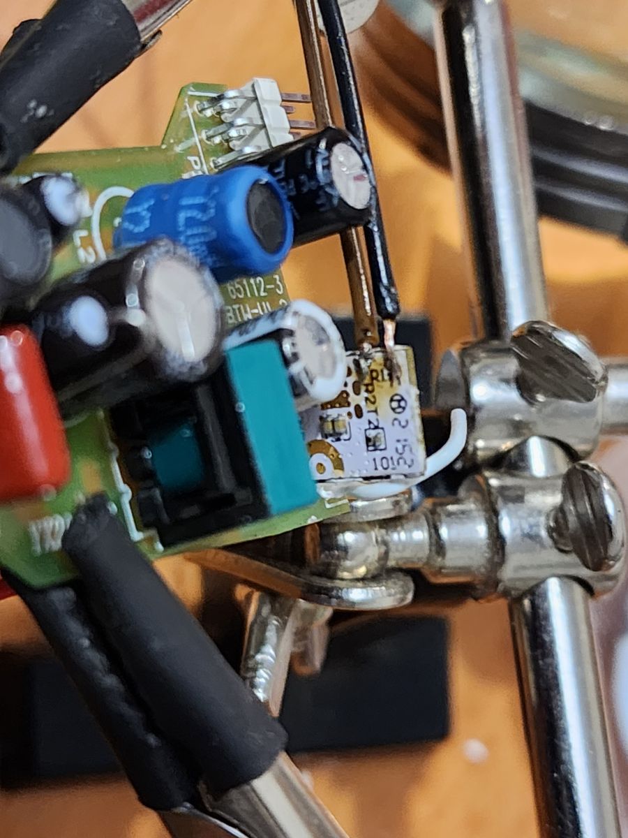

    If you are soldering with daughter board in place, I highly recommend a fine tipped soldering point:
    Light bulb circuit board with soldered wires.

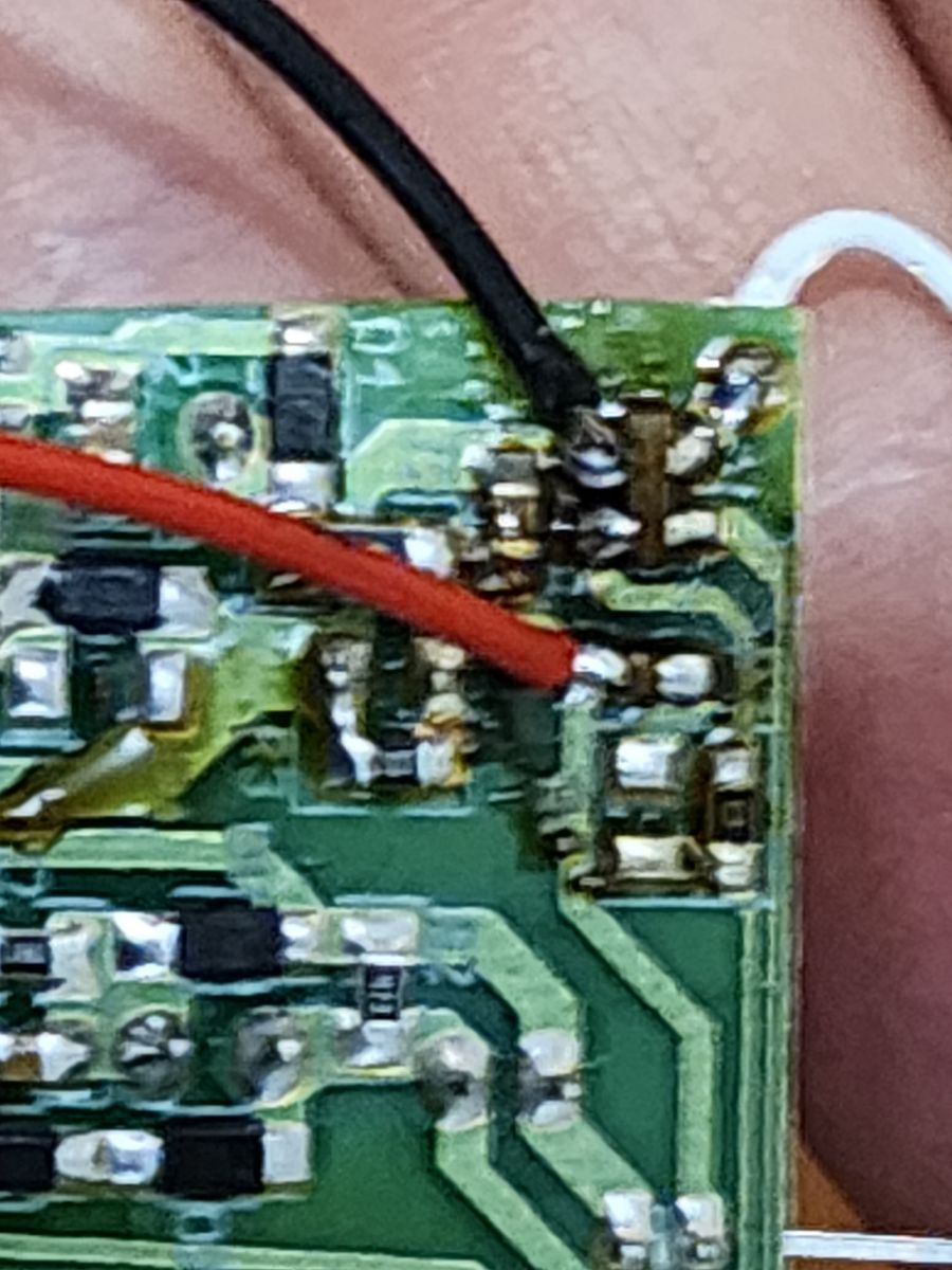

    Put flux on the r1/t1 pads and then tin the pad with solder. Solder the wires on for tx/rx:
    Microscopic view of a circuit board with electronic components.

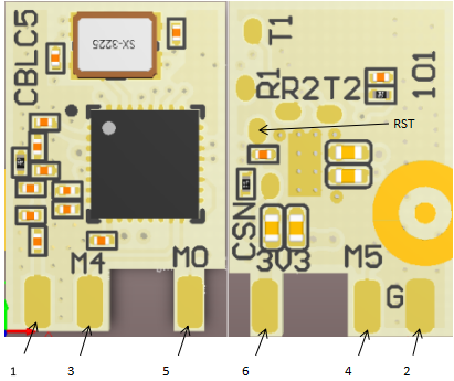

    Next, get 3.3V and GND wired up. These ones are easy as the pads are much larger. You will need to solder the wires onto the main PCB.
    First here is the schematic for CBLC5:
    PCB schematic with labeled pads and pins.
    SymbolI/O typeFunction
    ANTOPad pin for the external antenna
    GNDPGround pin
    M4I/OSupport hardware PWM and correspond to PA 24 on the internal IC
    M5I/OSupport hardware PWM and correspond to PA 26 on the internal IC
    M0I/OSupport hardware PWM and correspond to PA 6 on the internal IC
    3V3PPower supply pin
    Definitions of test points
    R2I/OUART2_RX, LOG RX, which corresponds to P1 on the internal IC
    T2I/OUART2_TX, LOG TX, which corresponds to P0 on the internal IC
    R1I/OUART1_RX, user serial interface RX, which corresponds to P10 on the internal IC
    T1I/OUART1_TX, user serial interface TX, which corresponds to P11 on the internal IC
    CSNIIf connected to the ground before powered on, enter the RF test mode. If not connected or connected to VCC before powered on, enter the firmware application mode.
    NoneIRST pin, which corresponds to CEN on the internal IC
    Wire up 3.3V and GND to the main PCB:
    Close-up of a printed circuit board with soldered wires.

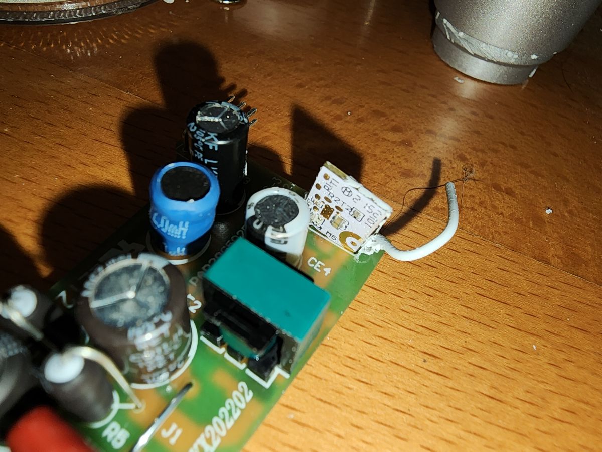

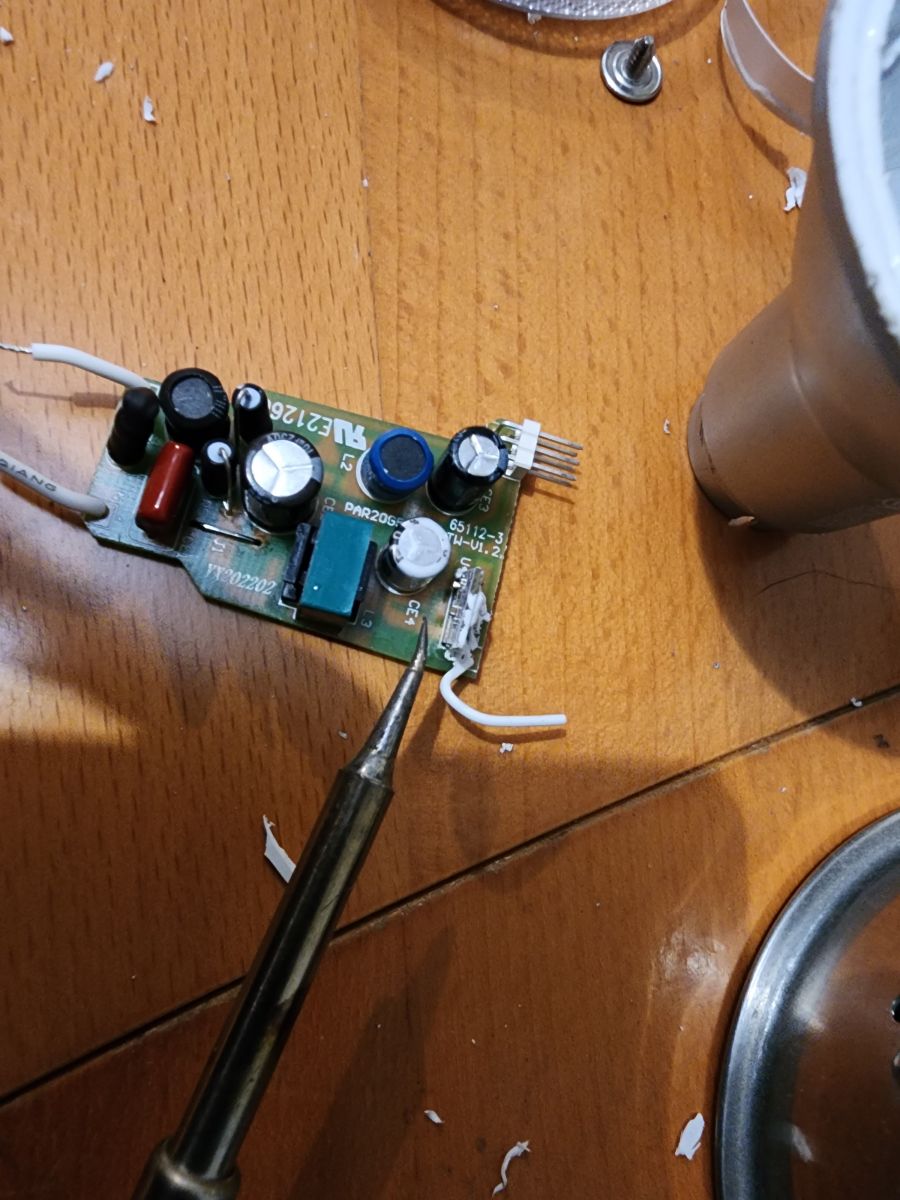

    If you want to remove the daughter board and solder the wires on:
    Close-up of a circuit board with soldered wires
    The only advice I have for soldering the wires on is to use freshly stripped, non tinned, stranded wire. If the wires are tinned or junked up, it will be hard to get it to stick to the pad. I spent an ungodly amount of time trying to solder tinned, junked up wires to the rx/tx pads and ended up tearing one of the pads off, dont be me.
