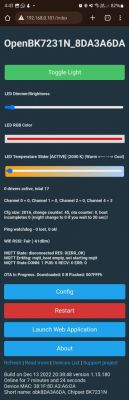

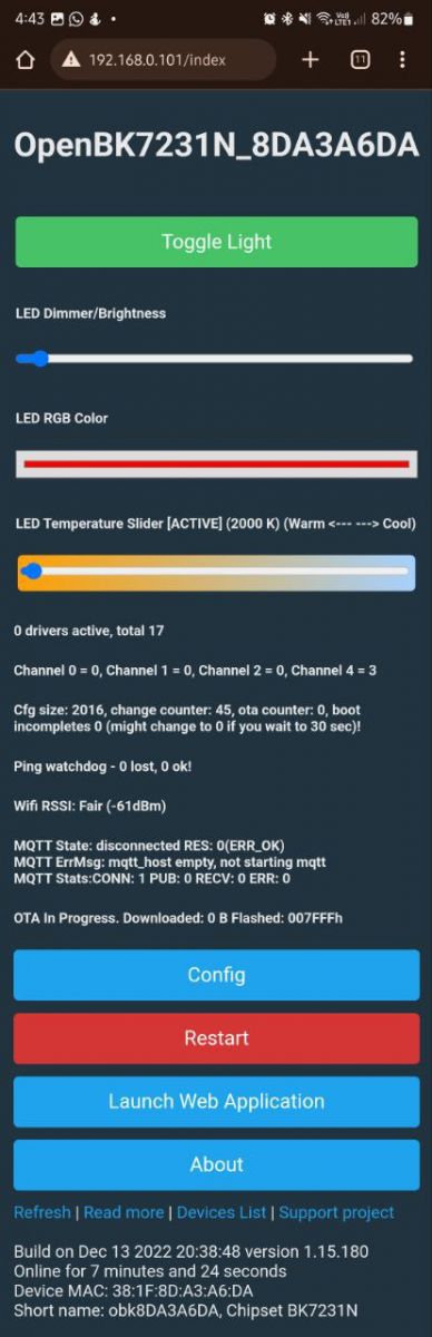

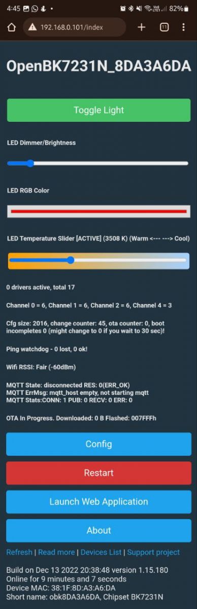

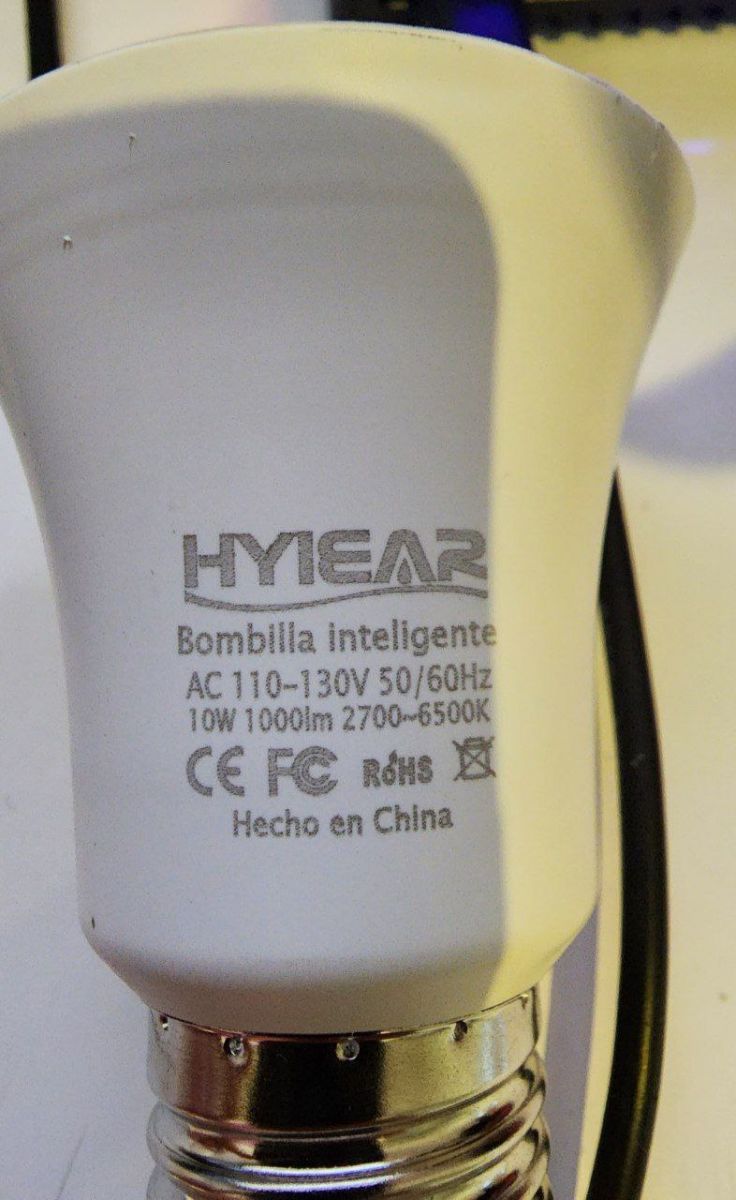

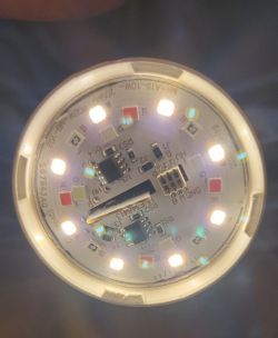

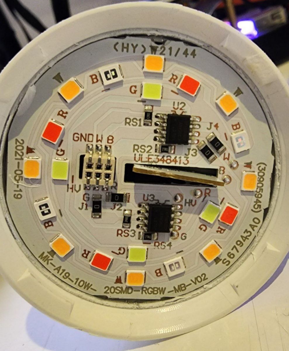

    So I bought a cheap light bulb but it said it had RGBW but it advertised it had warm white and cold white, I opened the bulb and it only has RGB and warm white, I assume the cold white was emulated by the RGB LEDs and a little bit of the warm white, but how do I go about and do this emulation?
    I bought a RGBWW bulb, CB2L board, only 4 PWM... how do i configure that module? I bought a RGBWW bulb, CB2L board, only 4 PWM... how do i configure that module?
    I already changed the firmware to OpenBK and the module is:
    P8White Warm
    P7Blue
    P6Red
    P26Green

    Hello, I will need to add a mechanism for that, would you be able to check if it works correctly for you later?

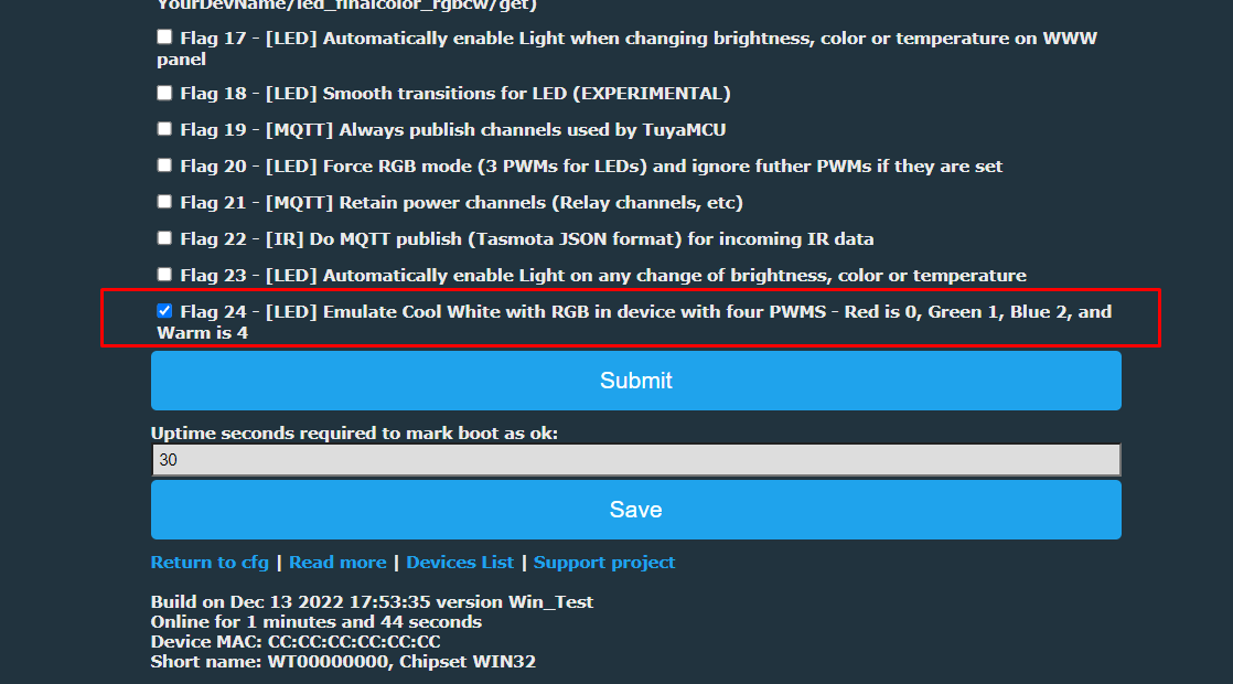

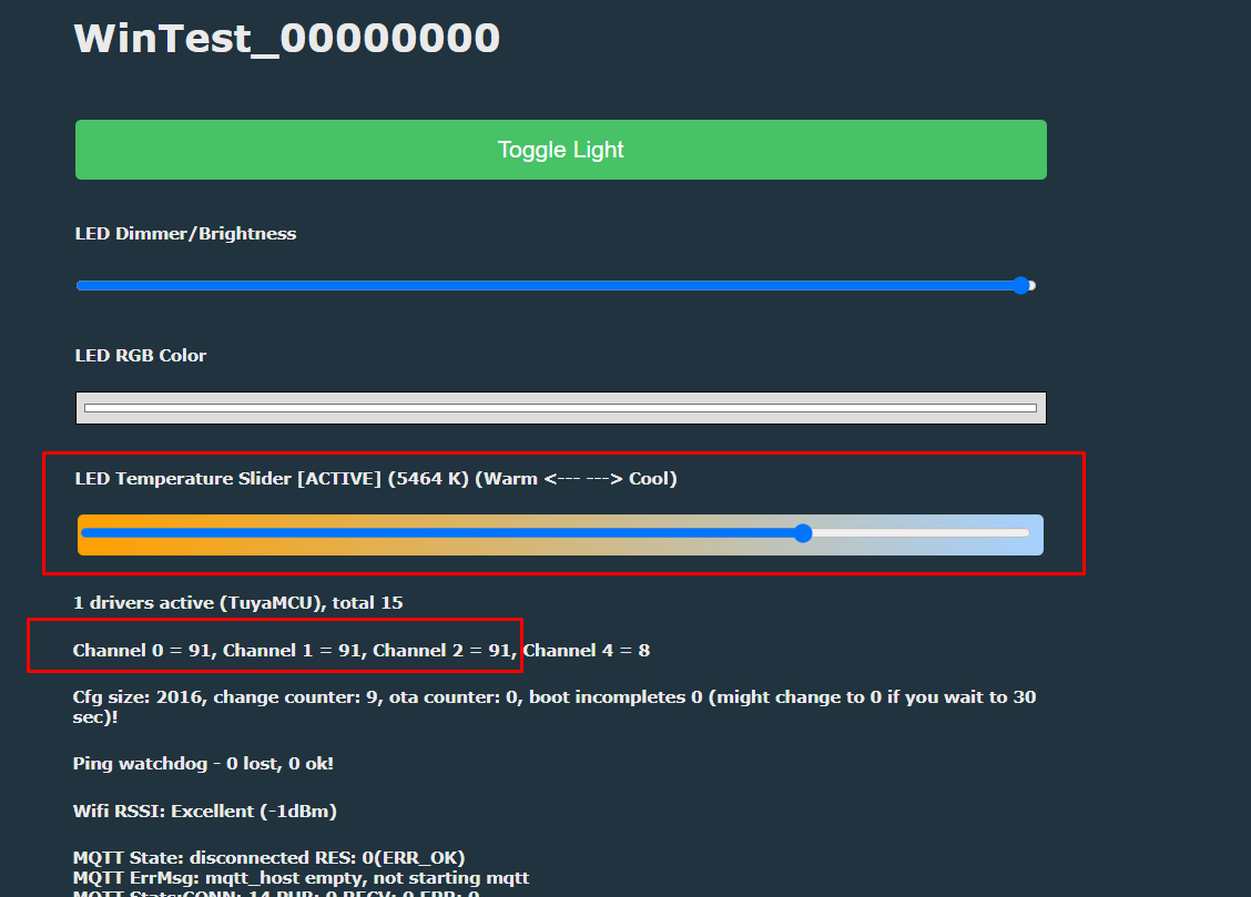

    Update software, enable this flag:
    The color order is RGBCW. R = 0, G = 1, B = 2, C = 3, W = 4
    Make sure your PWMs has channels 0, 1, 2 and 4 (not channel 3, Cool is emulated).
    The device should try to emulate Cool(Cold) White with RGB, example:
    Can you check and show how it looks on your device? Currently, it just takes the Cool channel value and puts in RGB channels (so R, G and B has the same value as cool)

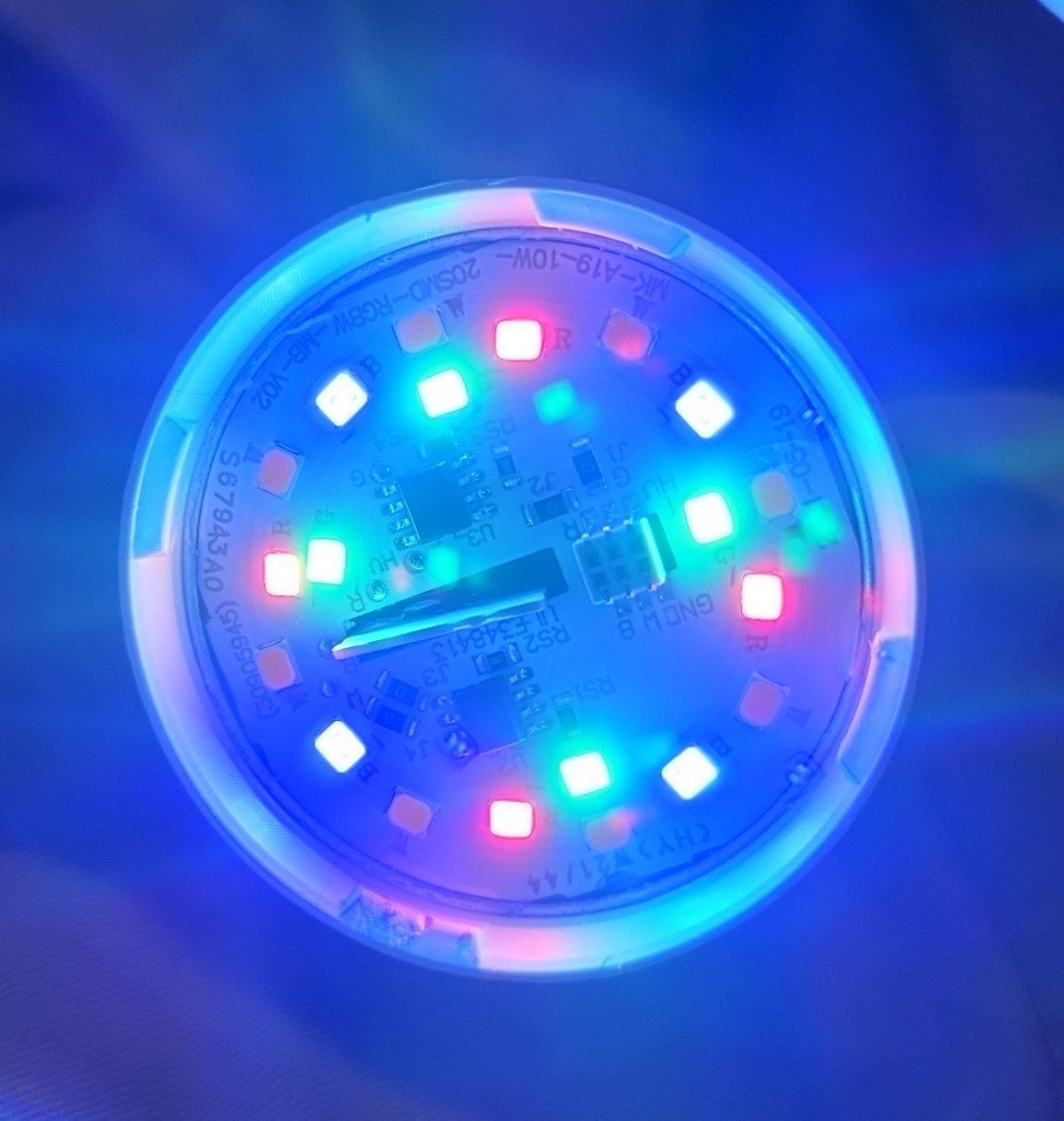

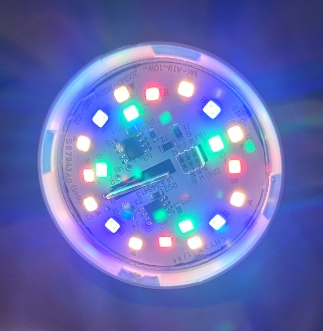

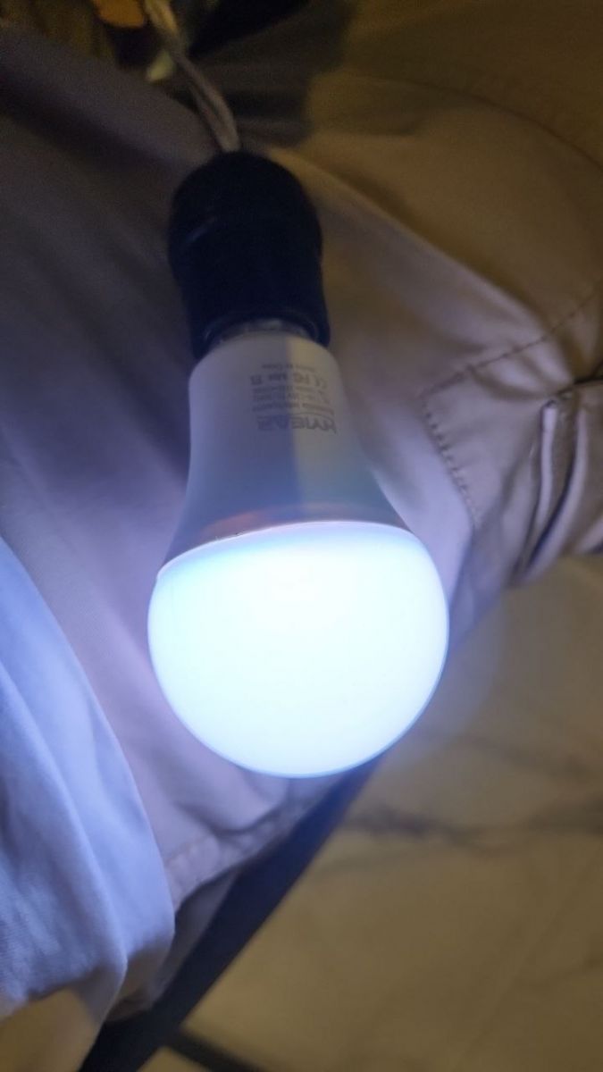

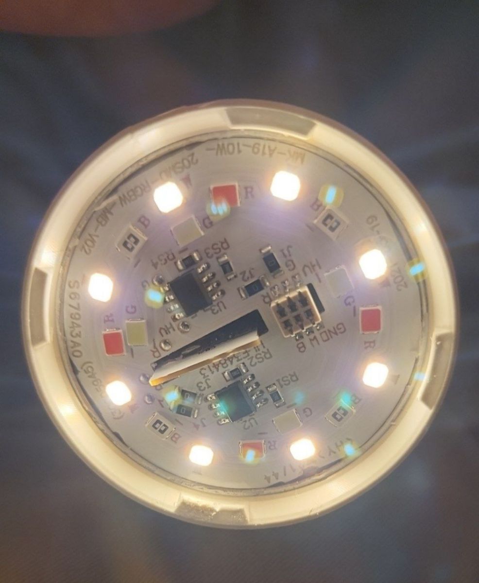

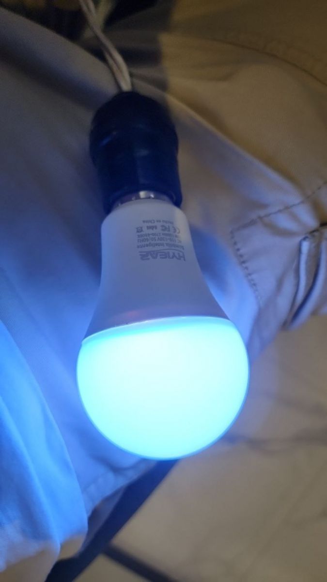

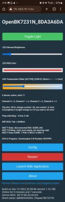

    Make sure your PWMs have channels 0, 1, 2 and 4 (not channel 3, Cool is emulated).
    Can you check and show how it looks on your device? Currently, it just takes the Cool channel value and puts in RGB channels (so R, G and B have the same value as cool)

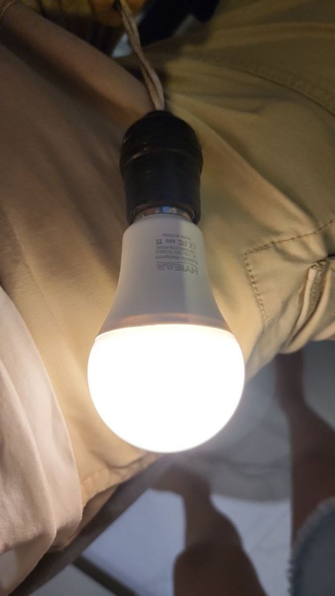

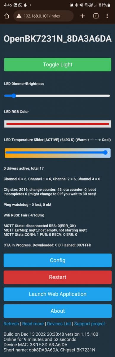

    These next images are when full Warm White:
    I bought a RGBWW bulb, CB2L board, only 4 PWM... how do i configure that module? I bought a RGBWW bulb, CB2L board, only 4 PWM... how do i configure that module? I bought a RGBWW bulb, CB2L board, only 4 PWM... how do i configure that module?
    These are for when going up from warm to cool (I had to lower the dimmer in order to appreciate the LEDs, also in the picture it looks bluer than it actually is)
    And these images are when at full Cool White (at full cool white the LEDs look bluish but not as much as it shows in the pictures)
  • #6 20333913
    Posts: 14682
    Help: 656
    Rate: 12708
    Do you think it's correct now?
    If you want cool white to be emulated with a certain combination of RGB (not 1:1:1, but something else), maybe using a luminance algorithm, let us know. Maybe less blue or make a setting configurable?
