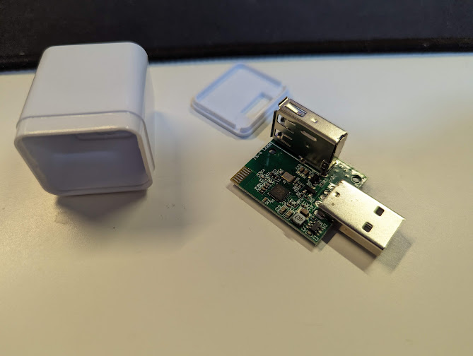

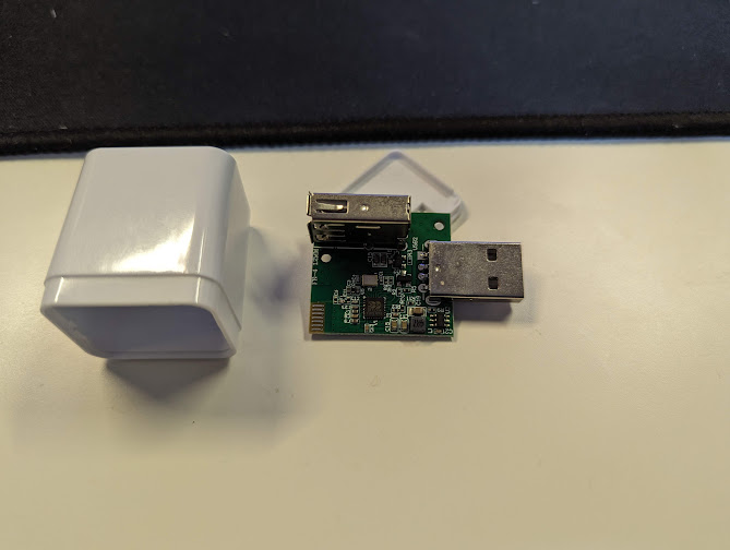

  • Hello,

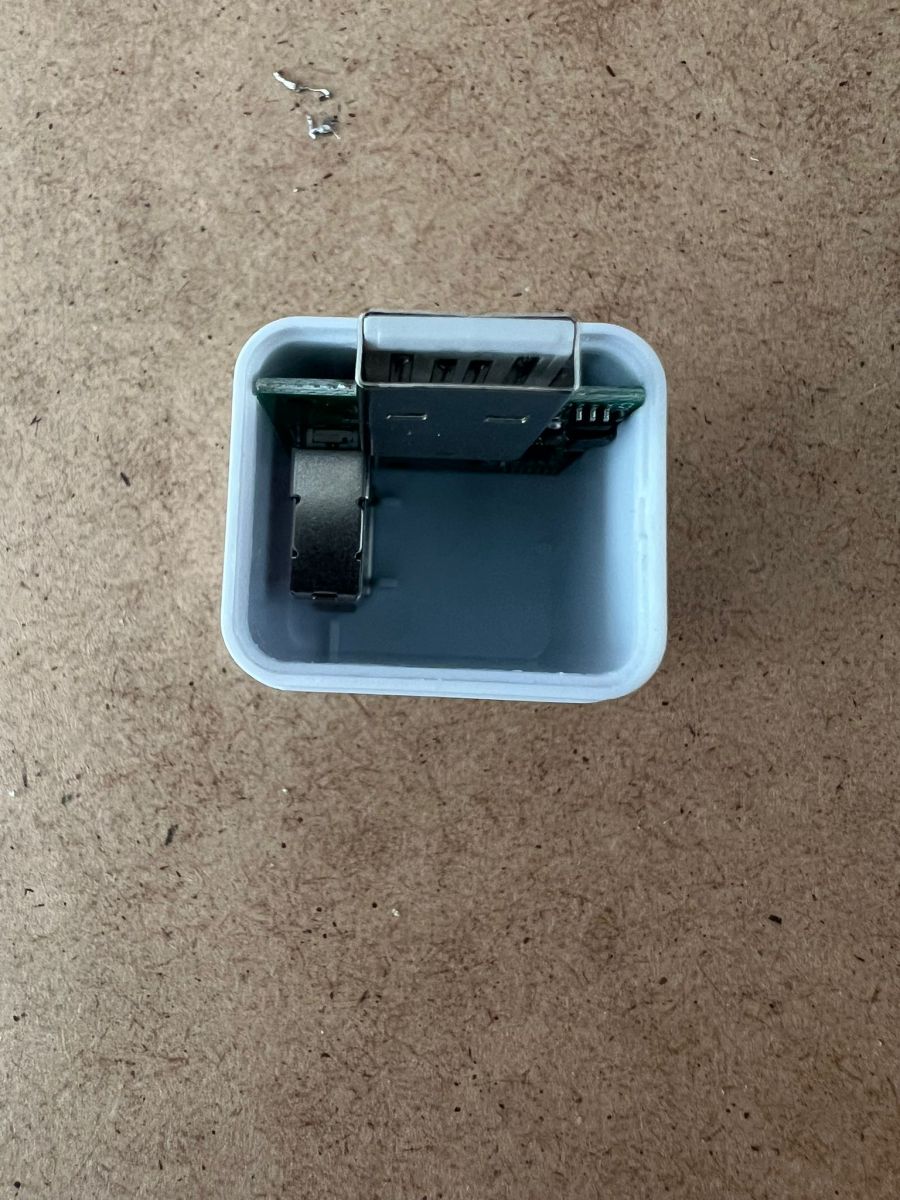

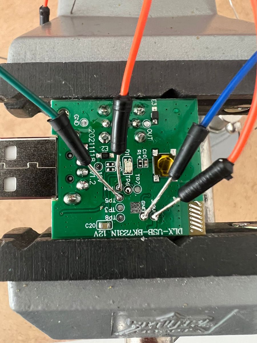

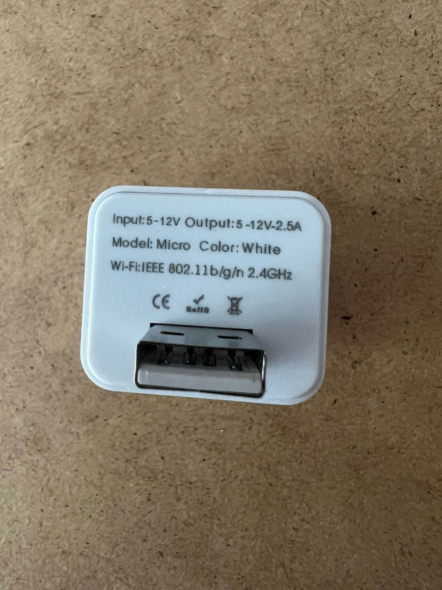

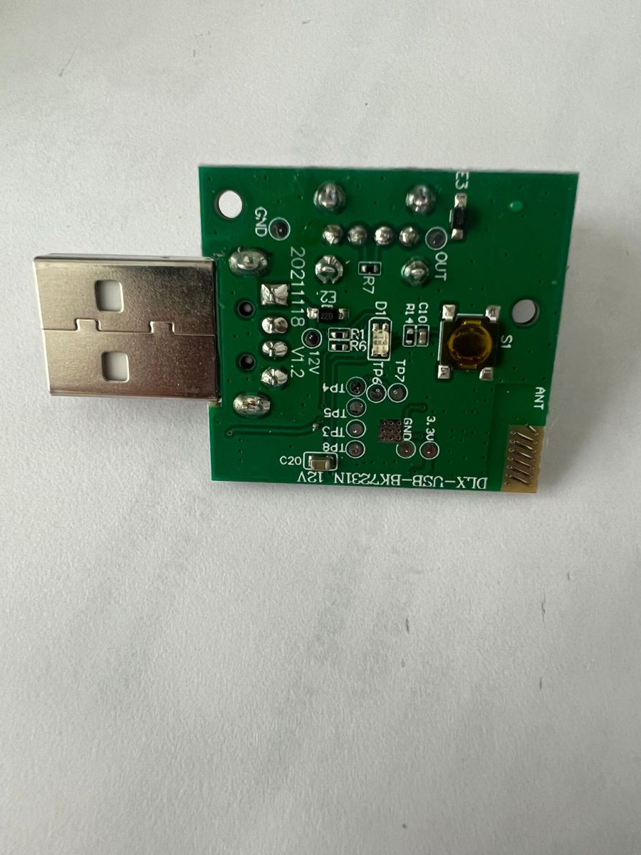

    I would like to present a simple teardown of a "USB Smart Adapter HC-S050-WIFI". It's a small device to control power to a USB socket built around a BK7231N. To open the case, apply some gentle force around the edge to open the lid.
    For flashing via UART connect TP5 as RX and TP4 as TX.

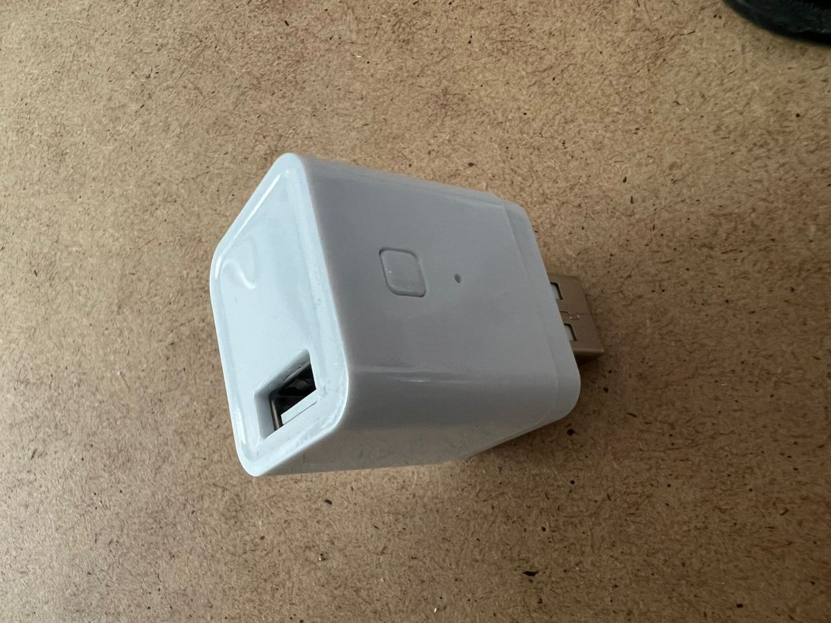

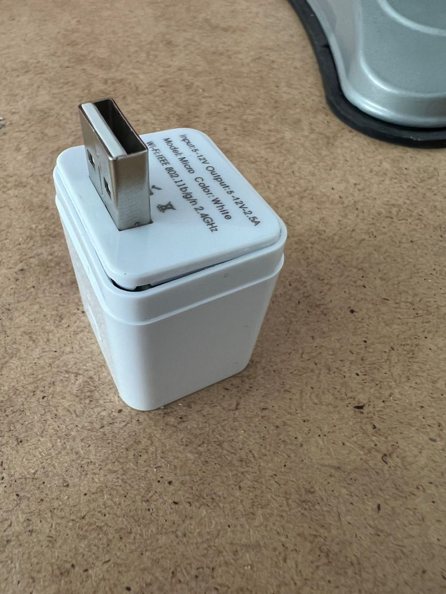

    Front view of USB Smart Adapter HC-S050-WIFI with technical specifications.
    Small USB adapter with a white casing lying on a wooden surface.
    White USB adapter with text on top, placed on a wooden surface.
    Internal view of the USB Smart Adapter HC-S050-WIFI with open casing.
    USB Smart Adapter HC-S050-WIFI circuit board with BK7231N chip. Close-up of the USB Smart Adapter HC-S050-WIFI circuit board with connected UART wires.
    Image of internal components of USB Smart Adapter HC-S050-WIFI with visible electronic components on a green PCB.

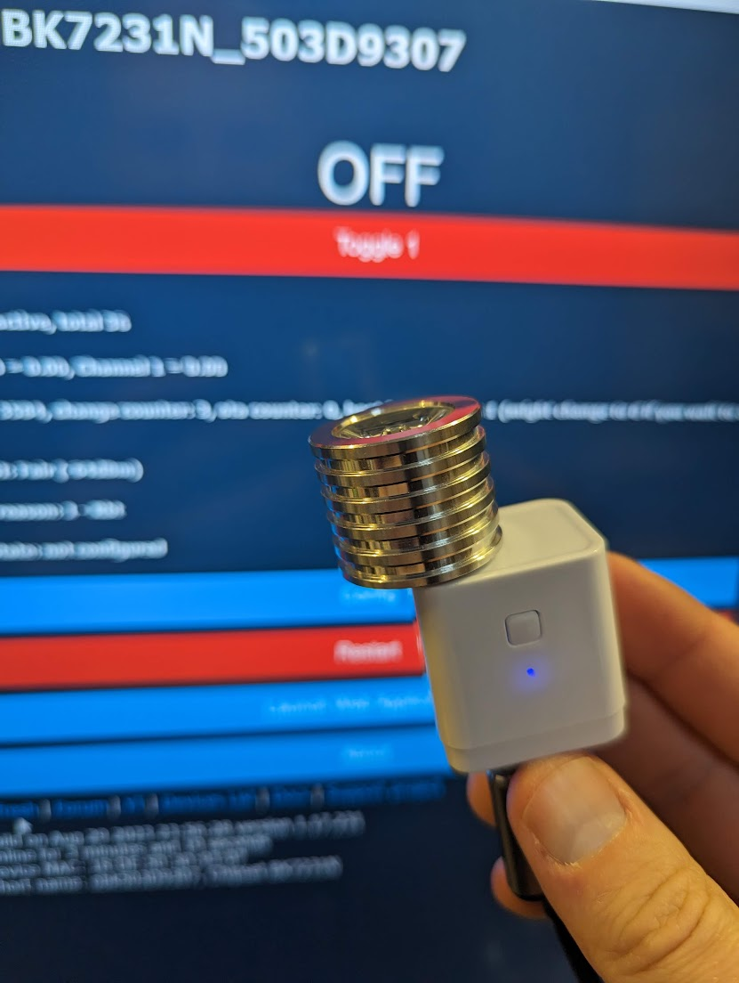

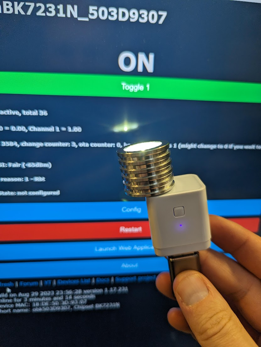

    Flashed. Original firmware is 1.3.10 so can't be exploited via cloudcutter.
    I tried flasher v 1.1.1 but it kept crashing. Went back to 1.0.6 which worked.
    Took a few attempts at disconnecting and turning on/off to get it to flash but got there eventually.
    Seems to have held its flash for me with no issue.
    Integrated into Home Assistant with no issues.
    The cover is glued on, but easy to removed without damage. When you put it back together be careful not to push the device out of the case when plugging in a USB device if you haven't put some glue back on the cover.

    The TP3 pin is CEN so you can reset and flash.

    I am trying to dump the firmware as described in the video in 8 min 44 s but for that I need the CEN or Chip Enable, to put the chip in download mode.
    In this thread it is only described 4 pins, not using the CEN.
    Can please someone help me and point where the CEN is in this board?
    Thank you.
