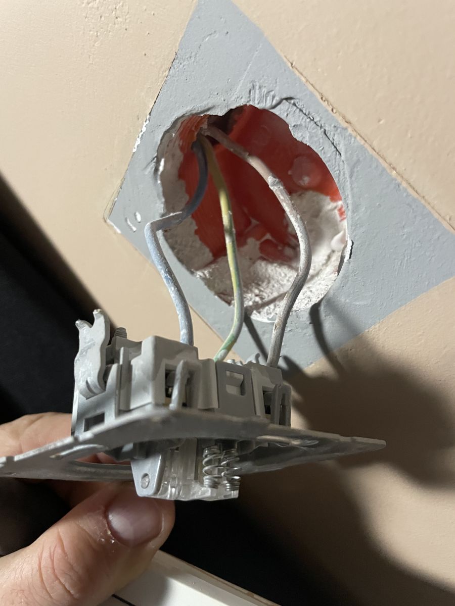

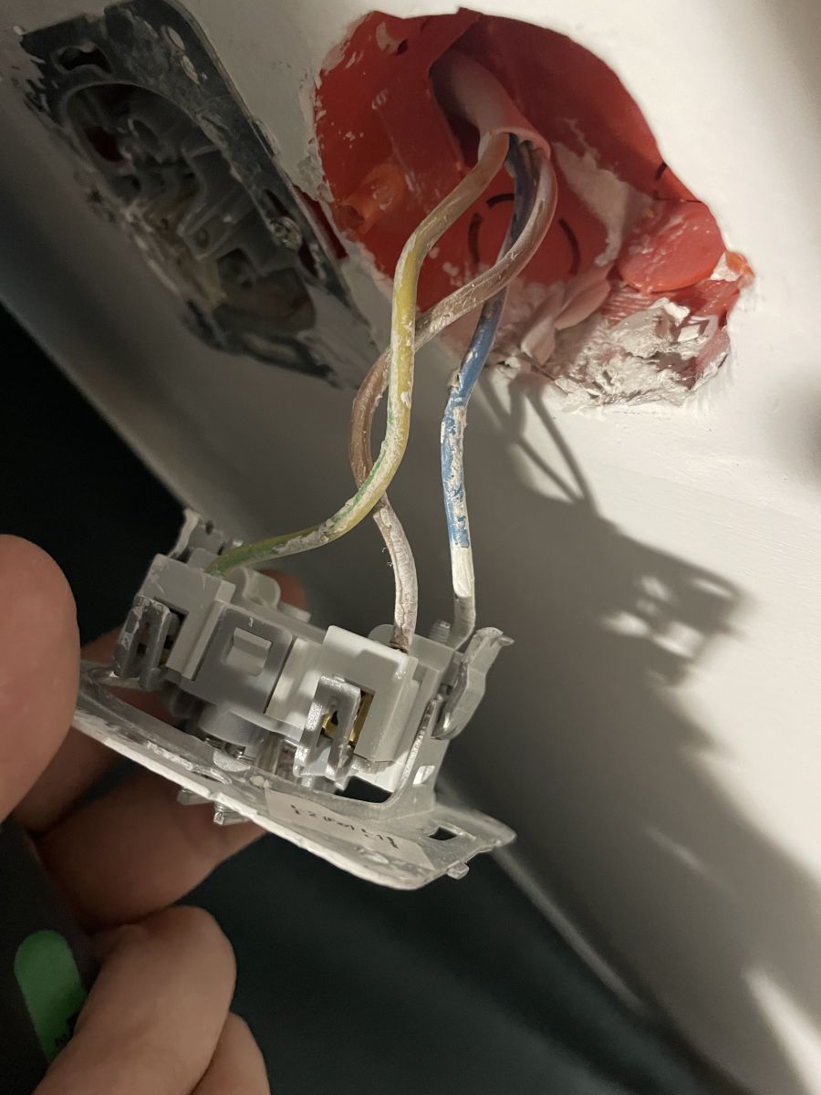

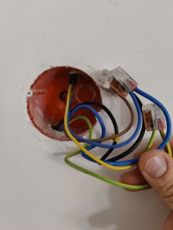

    Which WiFi controller should I choose for 3-wire external blinds? Which WiFi controller should I choose for 3-wire external blinds? .
    I have checked 5 roller shutter switches of which four have 3 cables each as shown in the pictures and one switch has 4 cables (black). This is what I mean, how am I supposed to connect a wifi controller as there is no such thing for 3 cables and if there is, it costs 300PLN.

    #6 20320541
    csvrbntyu
    Level 30  
    Posts: 1394
    Help: 163
    Rate: 405
    O_O
    You can send that electrician home straight away.
    Somewhere there's a junction box into which the 4-wire cable from the blinds (wire, max 2m long), the power supply and the wire going from the box to the switch that's in the photo above is fed. Find it and show what's inside.
    And the installation is screwed up because you'll have to use blue and green as phase wires. I advise against doing this, but otherwise you have to rip up the walls.
  • Need to inspect junction box wiring for blind controller

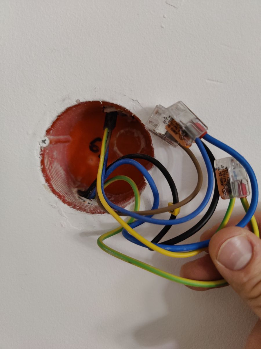

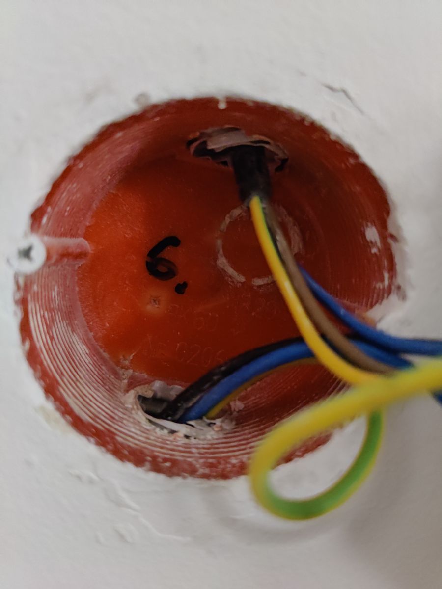

    one for the whole flat as I wrote above is with 4 cables as in the picture :
    All this was done by the developer (handed over the flat in a state of completion) I didn't change anything in it, forging the walls falls out unfortunately....

    #8 20320584
    csvrbntyu
    Level 30  
    Posts: 1394
    Help: 163
    Rate: 405
    akinx7 wrote:
    whether this will work for my sick installation (it's about the option to have the blinds close and open at a specific time)...
    I have no idea. Bloody knows what's going on in your cables.
    You don't have a neutral wire in the switch boxes, and all wifi roller shutter controllers need one. You have a neutral wire in the box you showed in the last photo, and you will mount any wifi roller shutter controller there. What to do with the rest? You need to find the box where everything is connected. You probably understand that connecting the switch to the roller shutter won't do anything, it still has to have power. And that power supply is connected somewhere. Then in that junction box you install a wifi roller shutter controller overhead box , and the manual switch you want.
  • Need to locate the junction box with neutral power
    #9 20320601
    akinx7
    Posts: 17
    csvrbntyu wrote:
    akinx7 wrote:
    will this work for my sick installation (it's about the option to have the blinds close and open at a specific time)...
    I have no idea. Damn knows what's going on in your cables.
    You don't have a neutral wire in the switch boxes, and all wifi roller shutter controllers need one. You have a neutral wire in the box you showed in the last photo, and you will mount any wifi roller shutter controller there. What to do with the rest? You need to find the box where everything is connected. You probably understand that connecting the switch to the roller shutter won't do anything, it still has to have power. And that power supply is connected somewhere. Then in that junction box you mount the wifi roller shutter controller overhead box , and the manual switch you want.

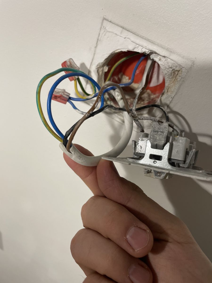

    I understand theoretically what you mean but well as you can see above from the photos only one box has 4 cables correctly the rest have 3 and I have no idea how to solve this so that I can control these roller shutters remotely.... I have looked at all the boxes:
    One has 4 cables as I sent the photo
    three have 3 cables without anything
    One has 3 cables but there is a box next to it with a light switch on the terrace (photo I sent above)
    My hands are already falling off....
  • #10 20320620
    csvrbntyu
    Level 30  
    Posts: 1394
    Help: 163
    Rate: 405
    Look for a box near the roller shutter (high up, covered by a cap), or in other sockets. The covered one may be quite under the plaster. If you tap on the wall you may be able to locate it - the sound will be hollow.
