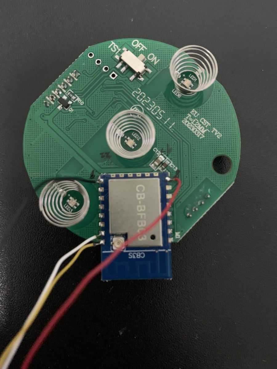

    Circuit board with CB3S WiFi module and switch.
    So I flashed the latest version of openbeken on this CB3S Module,
    Pin 8 is VCC, Pin 9 is GND, Pin 15 is RX, and Pin 16 is TX.
    I had to unsolder Pin 15 and 16 since they are already connected to a TuyaMCU (Py32).
    After normal flashing with BK7231N, I resoldered it and started configuring.

    By the way, I found out that these lines are the connection between Pins 15 and 16 and the PY32, so instead of desoldering the chip and resoldering it, it's much easier to cut these lines and resolder them afterwards.
    Electronic module with labeled pins 15 and 16 and soldered wires.
