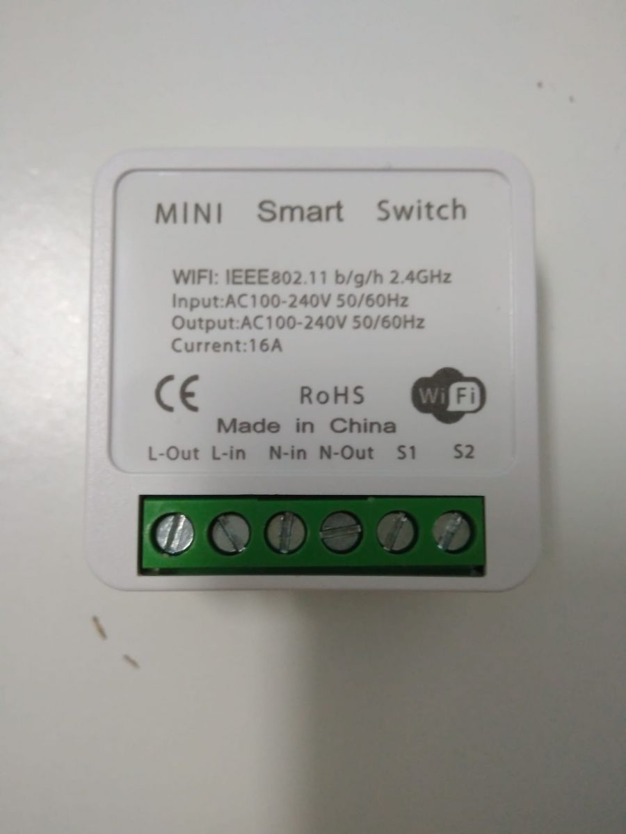

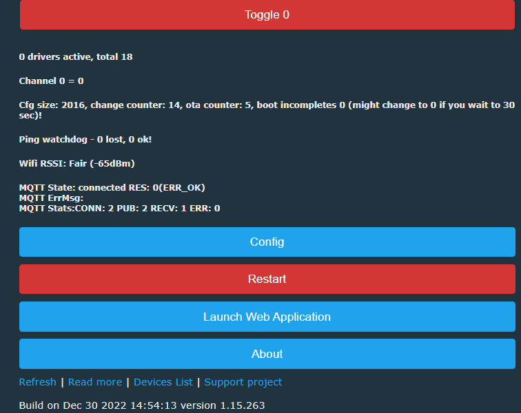

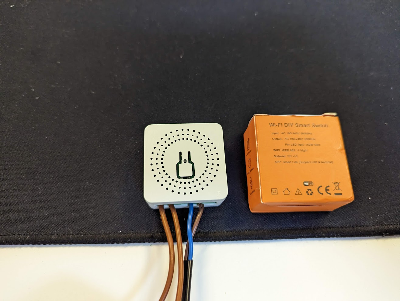

    Another AliExpress Choice Day purchase.
    Not been able to do a teardown as I feel like I'll destroy the device. Not easy to open.
    Case is different to other similar mini smart switches.
    Rear button tab is rotated
    Case is a matt PC finish - rather than the others I have which are a gloss finish.
    Different config also
    Used tuya-cloudcutter to flash OpenBK (didn't even set up in SmartLife app - just went straight to cloudcutter)
    These cloudcutter settings allowed the exploit
    > By firmware version and name
    > 1.2.1 - BK7231N / oem_bk7231n_control_switch
    > Aubess
    > 16A Mini Smart Switch
    LED_n 8
    Rel 26
    Btn 10
    TglChanOnTgl 23

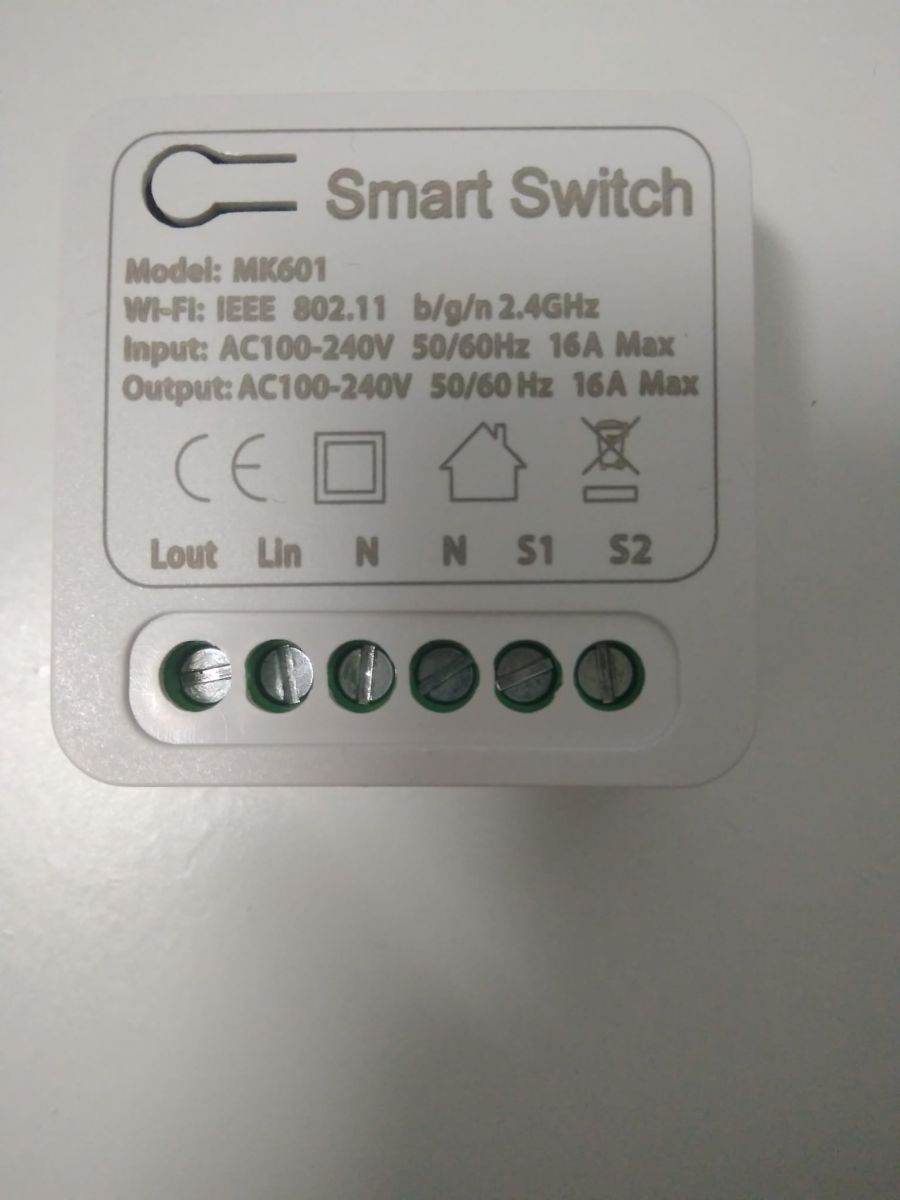

    Whilst the box states MK601, the switch inside the box doesn't reference that product code or look like the switch on the box.
  • #6 20557594
    ratseahr34
    Posts: 6
    anthonythomas wrote:
    Whilst the box states MK601 the switch inside the box doesn't reference that product code or look like the switch on the box.
    I have tested the M-K601 pin settings above and they trigger the relay but not the LED from the webpage button, whereas these do work as expected.

    Can anyone post MK601 image so I can add it to the list with this new pinout? Thanks

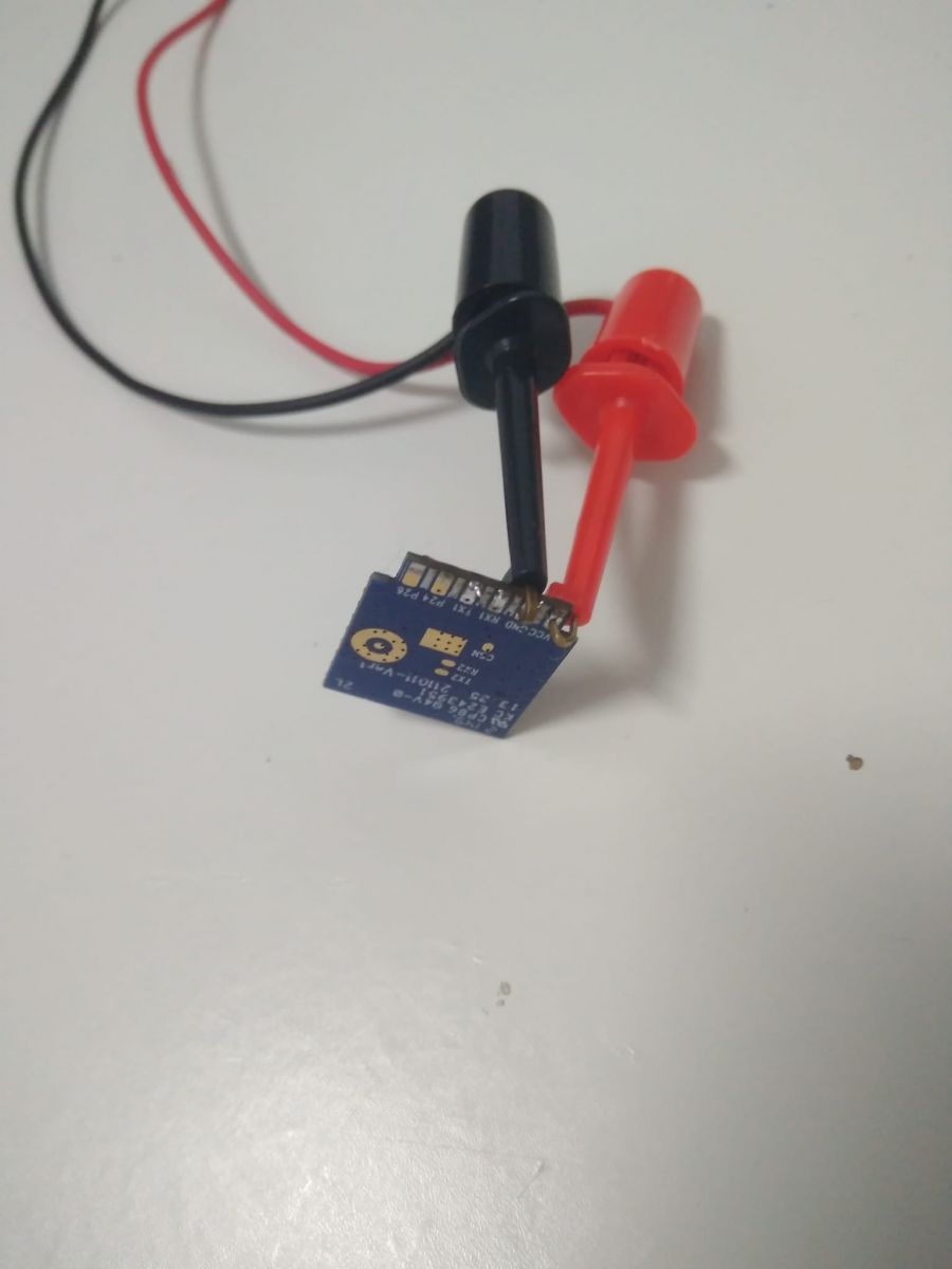

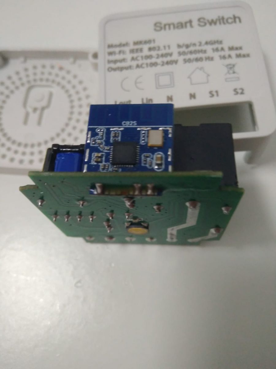

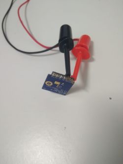

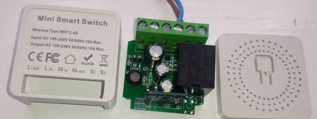

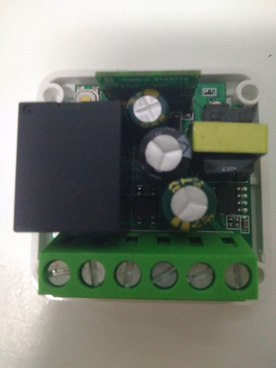

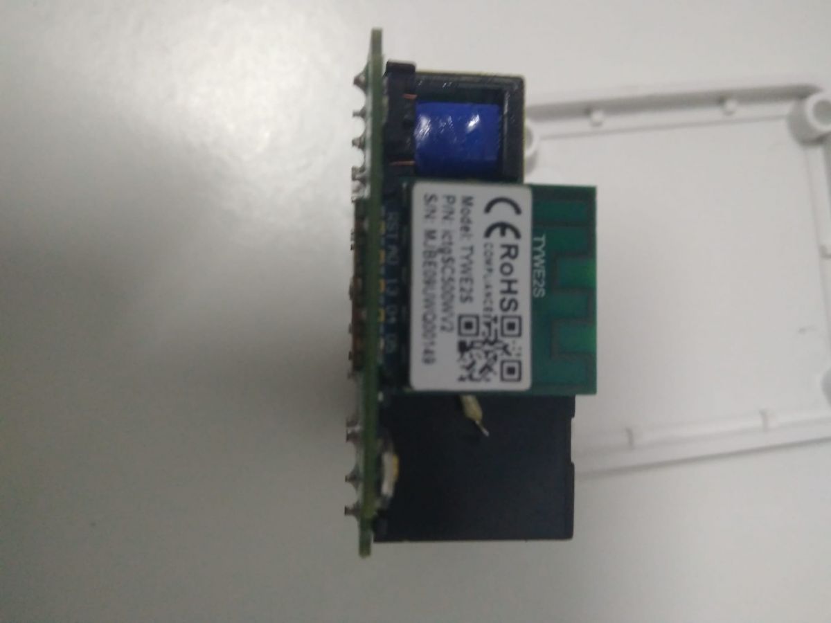

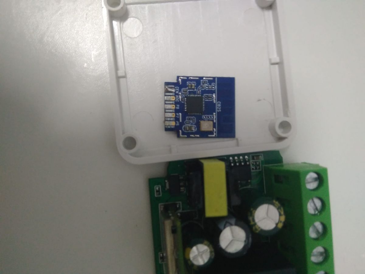

    In his day I already mentioned it. I replaced CB2S with TYWE2S because OpenBeken was very slow in the CB2S module, even feeding the separate module with 3.3V.
    [BK7231N] 16A Mini Smart Switch from aliexpress - configuration [BK7231N] 16A Mini Smart Switch from aliexpress - configuration [BK7231N] 16A Mini Smart Switch from aliexpress - configuration [BK7231N] 16A Mini Smart Switch from aliexpress - configuration
    I no longer remembered that I had changed the wifi module
    P26 --> LED
    P6 --> Rel
    P7 --> Btn
    P10 --> Btn_n S2

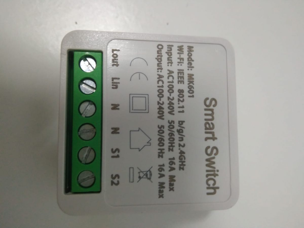

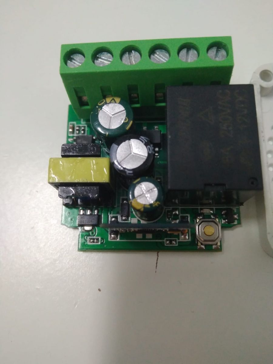

    It seems that there are two versions of the MK601.
    P26 --> LED
    P6 --> Rel
    P7 --> Btn
    P10 --> Btn_n S2
  • #10 20559021
    ratseahr34
    Posts: 6

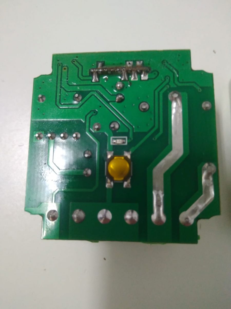

    I think this is going to cause a lot of confusion as I have a different version/conf. I don't have a mini transformer, and looking at Spin55's pictures the pin connections are different too. My version is the same on the inboard (VCC/GRD) side, but the outboard side is only soldered across ADC and Pin 8, whereas Spin55's is CEN. P7 and P6. This would explain the Setting difference, For ref, the setting that work for my board are:
    "8": "LED_n;1",
    "10": "Btn;1",
    "24": "TglChanOnTgl;1", (I don't know what this does!)
    "26": "Rel;1"

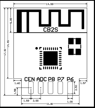

    Definitely, although there are two packages for MK601, the pinouts do match.

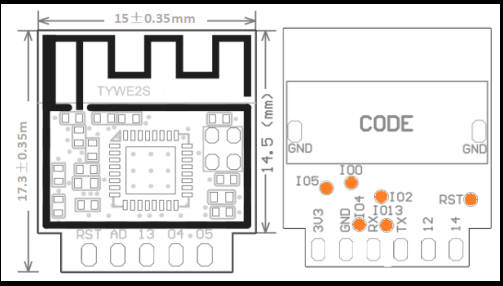

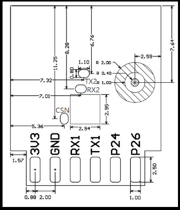

    I have reviewed the YAML configuration of TYWE2S and taking into account the correspondence of pins with the CB2S board, it can be seen that the configuration is the same, despite having different external packaging:
    Pinout TYWE2S:
    Pinout CB2S:

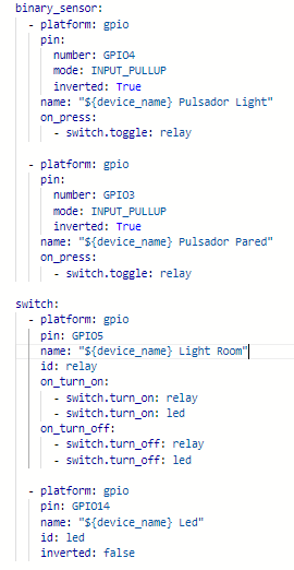

    Esphome configuration:
    TYWE2S --> CB2S mapping:
    IO04 --> Btn --> P7
    IO03 --> S2 --> P10 (Rx1)
    IO05 --> Relay --> P6
    IO14 --> LED --> P26
    MK601 configuration (two packages):
    P26 --> LED
    P6 --> Rel
    P7 --> Btn
    P10 --> Btn_n S2

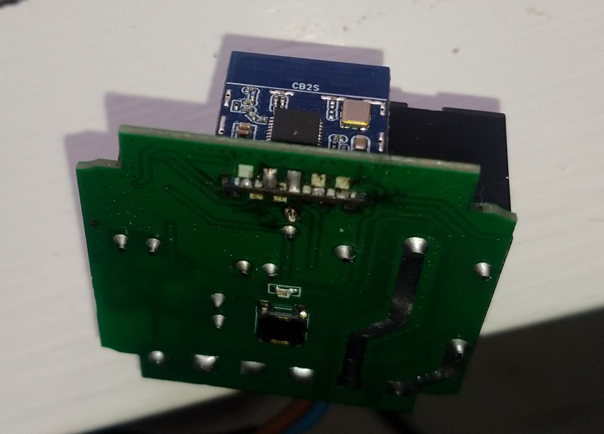

    Yes, I agree the Pinouts match, but my unit does not have P6 or P7 connected - there is no soldered link. So the settings that show P6 and P7 don't work. I don't know how to see the Yaml file, but I have loaded your suggested settings and they don't work. I can control the switch with HA. I think I must have a third version. It was an AliExpress Choice as well.
  • #13 20559707
    spin55
    Posts: 209
    Help: 17
    Rate: 42
    https://obrazki.elektroda.pl/9226450300_1682687538.jpg
    Seeing the photograph of the board, it seems that you have connected ADC, P8, P24 and P26 (although it does not look good). I think I remember that ADC corresponds to P23 (I'm saying this from memory, now I can't confirm).
    ratseahr34 wrote:
    "8": "LED_n;1",
    "10": "Btn;1",
    "26": "Rel;1"
  • #14 20559835
    ratseahr34
    Posts: 6
    You are right, ADC is P23, so I have changed my settings "23": "TglChanOnTgl;1", and this now enables the S1/S2 terminals.
