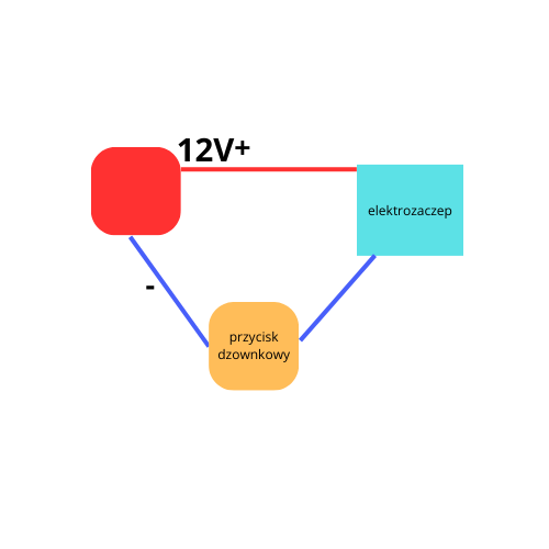

    Hi!
    I am looking for a solution that will enable me to open the wicket remotely. Due to the old installation (90s) I have given up on access control.
    The electric door opener can currently be released via a bell button at home. I am enclosing an amateur diagram.
    I searched for this type of "smart" button, but could not find one. I guessed that it would probably be equipped with a battery backup.
    I am looking for compatibility with a home assistant.
    Can you recommend any urgency?
    Amateur schematic showing a circuit with a 12V-powered electric strike and a doorbell button. .

  • #5 20764688
    12robert12
    Posts: 1137
    Help: 134
    Rate: 179
    Search under the name "voltage free relay"
    Everyone has a "pulse" mode of operation
    Insert what you like, we will assess if it is suitable....
  • #7 20772778
    12robert12
    Posts: 1137
    Help: 134
    Rate: 179
    It looks ok,
    Of course if you would like to connect a physical button under S1 via the opening wires it will be on 230V .
    If you only want to open remotely via an app on your phone then this is sufficient - minus the delays.
    or with a battery operated button remotely .
  • #8 20772933
    bonss
    Posts: 16
    Thanks,
    I understand that I can connect my electric door opener to COM and NC. However, then I still need to connect 230V to L and N?
  • #9 20772953
    12robert12
    Posts: 1137
    Help: 134
    Rate: 179
    Rather, the electric door opener is connected to COM and NO
    Because if you connect it to NC it will still be open 😜
    Yes, to L and N 230V AC must be connected

    sosarek wrote:
    12robert12 wrote:
    Rather, the solenoid switch to COM and NO
    Rather, not quite....
    We can guess without a diagram...
    In the first post the author wrote that he uses a "bell" button to release the electric strike which suggests NO to me.
    Finally it is possible to change NO/NC anyway.
  • #12 20773096
    sosarek
    Posts: 83875
    Help: 9320
    Rate: 15532
    @12robert12 You have the drawing in the first post and now consider where your reasoning and method of connection is wrong and why.
