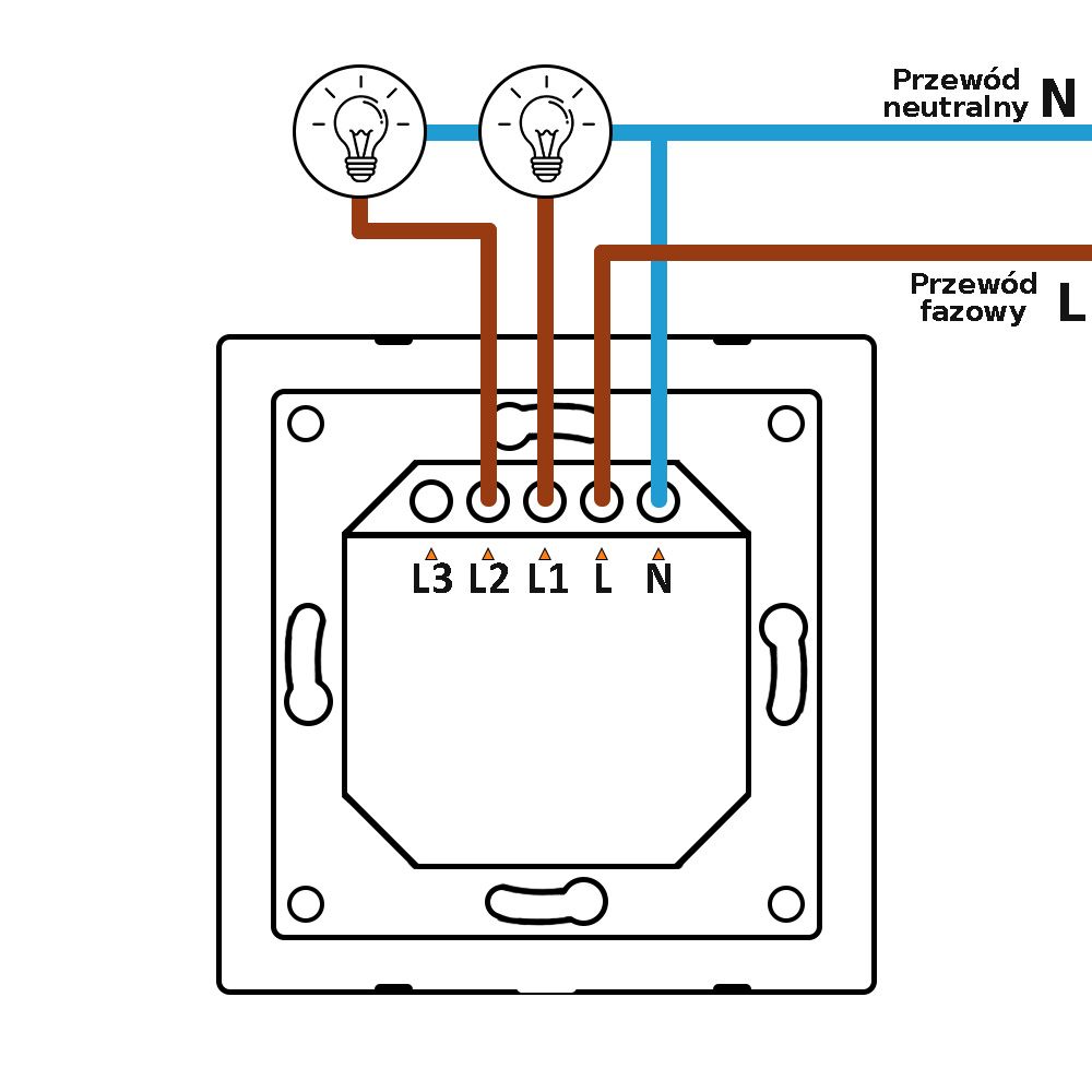

  • Gate control uses momentary shorting, not held contact
    #8 20855556
    KarolJuszkiewicz
    Posts: 183
    Help: 6
    Rate: 12
    MORO84 wrote:
    Currently there are two cables that by shorting open and close the gate
    How exactly do these cables work
    1. You short two for a second
    2. Do you hold until the gate opens?
    If one is worse (but I think if something is soldered out it will charge)
    Added after 22 [minutes]:
    If two is yes:
    Wiring diagram of a switch with live and neutral wires connected to light bulbs.
    L2 no, L1 drive. L power (if you want the buttons to light up then you still need to take the power ground)
