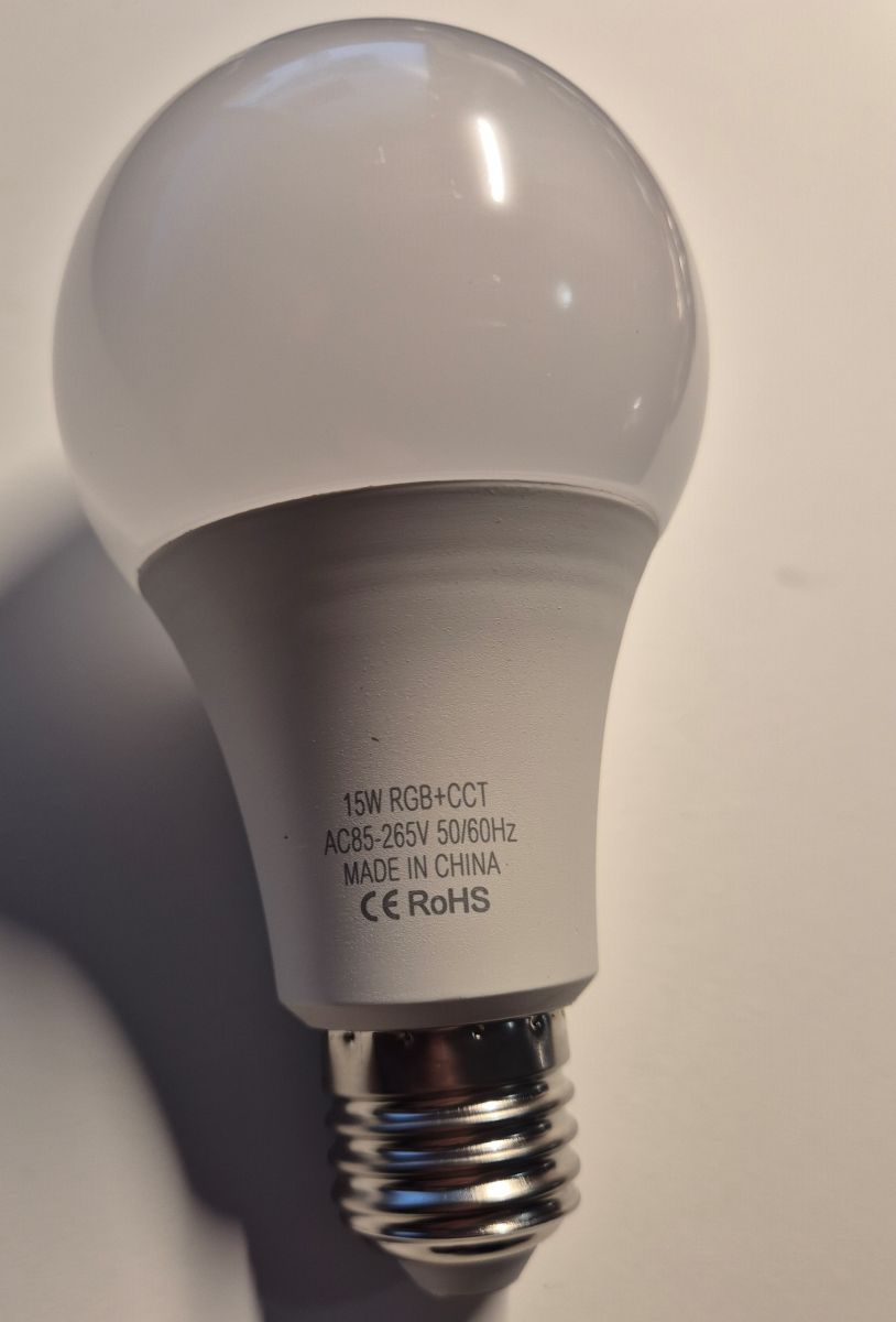

    Packaging of a smart bulb with feature descriptions and QR codes Packaging of RGBCW smart LED bulb. Packaging of the LN882HK (RGBCW) smart bulb on a black background.
    I can't seem to be able to identify a brand (if there is one), but it is advertised as being compatible with the Tuya ecosystem.

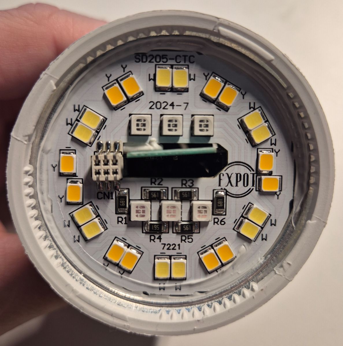

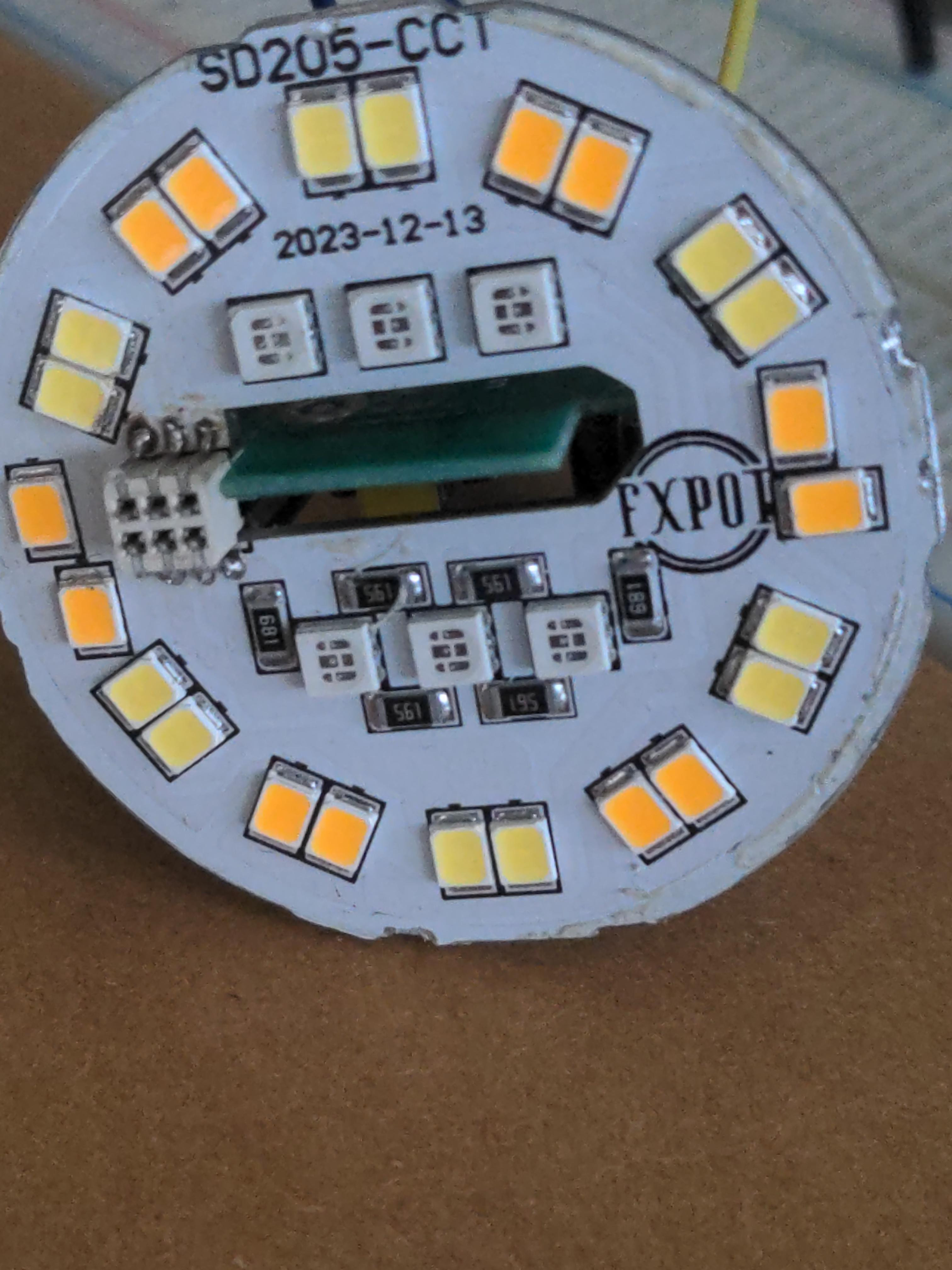

    The bulb itself also looks very generic. Removing the lid shows an LED shield with an outer circle of alternating pairs of cold/warm white LEDs, and within 2 rows of 3 multi-cathode RGB LEDs
       15W RGB+CCT smart LED bulb with technical markings on the casing. Interior of a smart bulb showing LEDs and a circuit board.

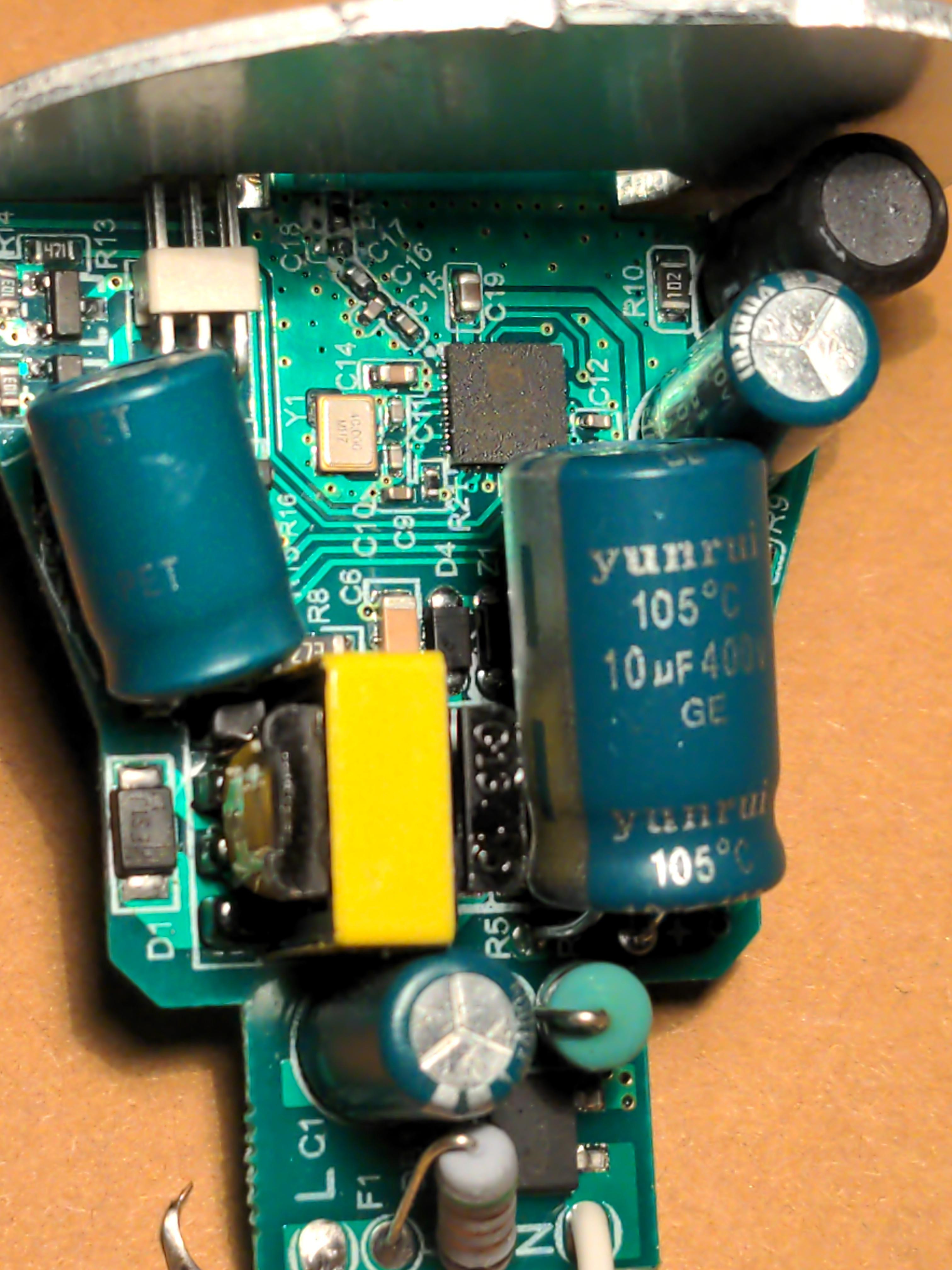

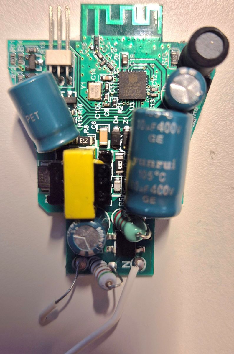

    Removing some thermal glue from the other edge allows the LED shield to be removed, exposing the main PCB:
    Close-up view of a circuit board with electronic components.

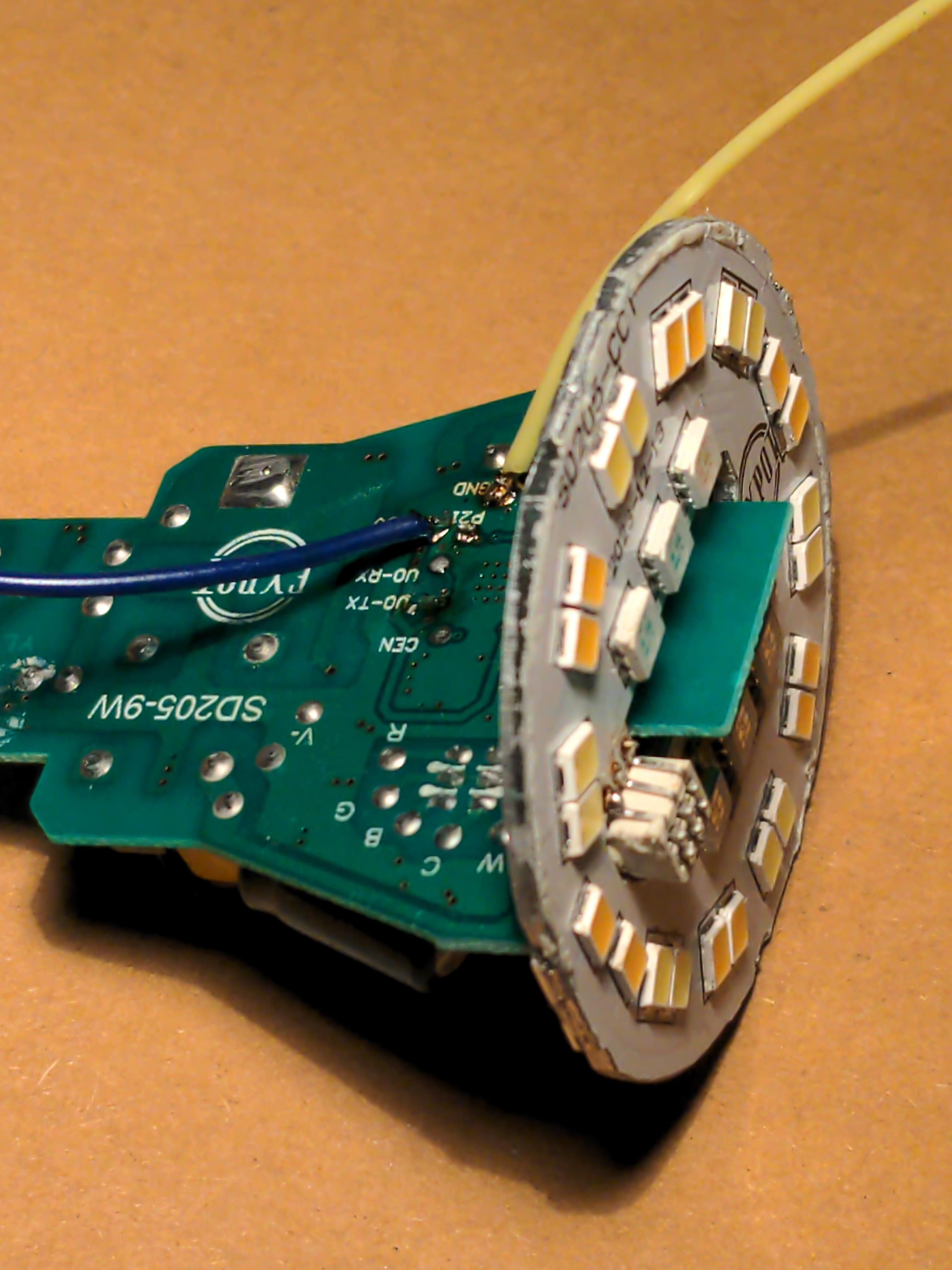

    Note that the N contact is soldered to the tip of the bulb, whereas the P contact is just clamped between the upper end of the bulbs thread and the lower end of the plastic housing - no idea if this is considered a safety hazard, and also almost impossible to reassemble in the same way. I ended up pulling out the P wire and unsoldering the N wire from the PCB, trying carefully not to burn or break anything.

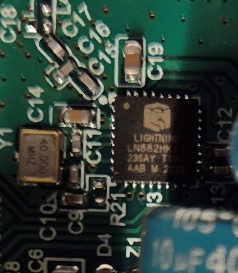

    The controller used is a LN882HK, where neither the company in general nor the chip itself are known to me or anyone else I know.
    Close-up of the LIGHTNING LN882HK integrated circuit on a printed circuit board.

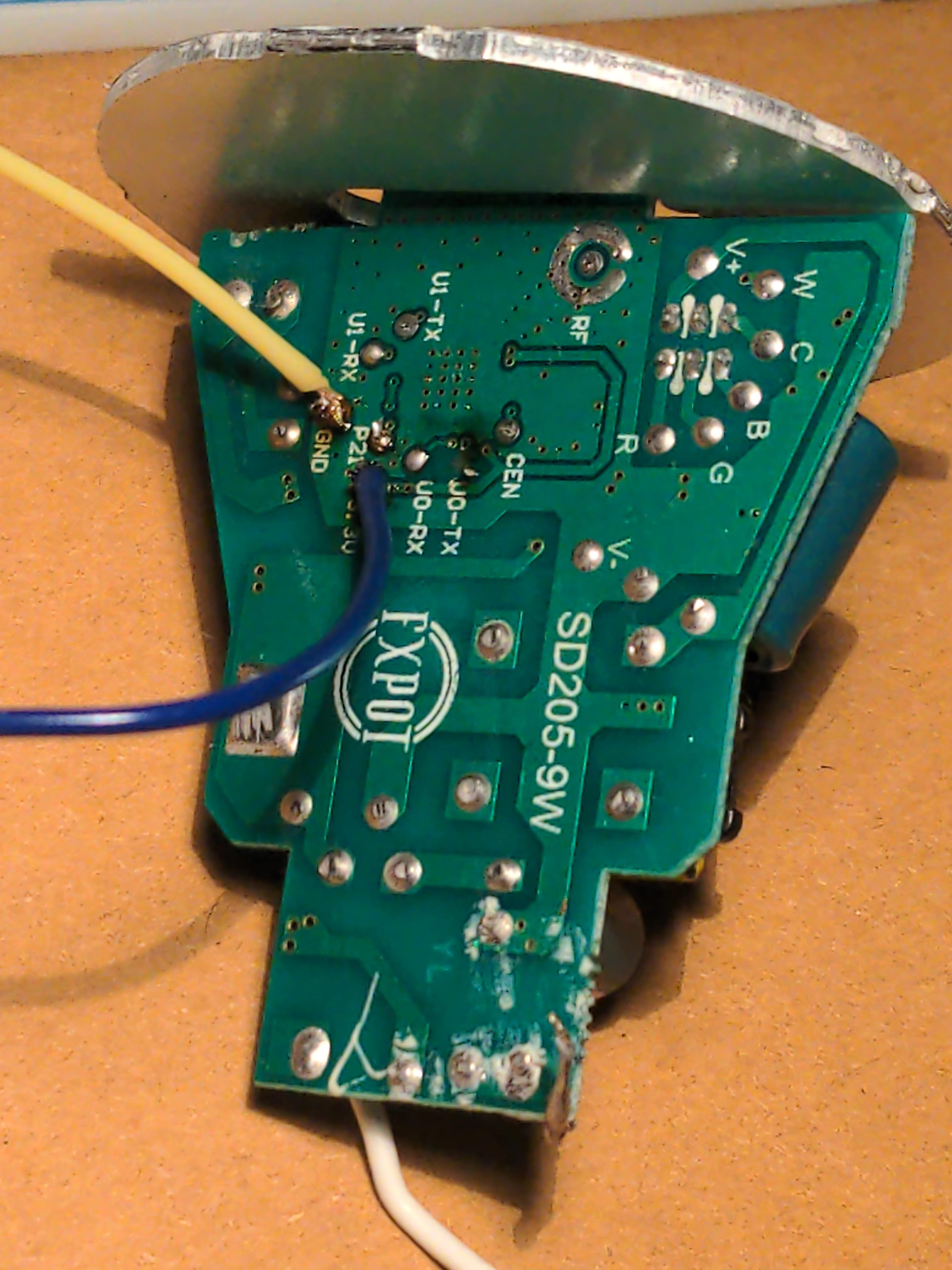

    Naturally it is also not supported by ESPHome, which led me to do an online search that quickly brought me here.

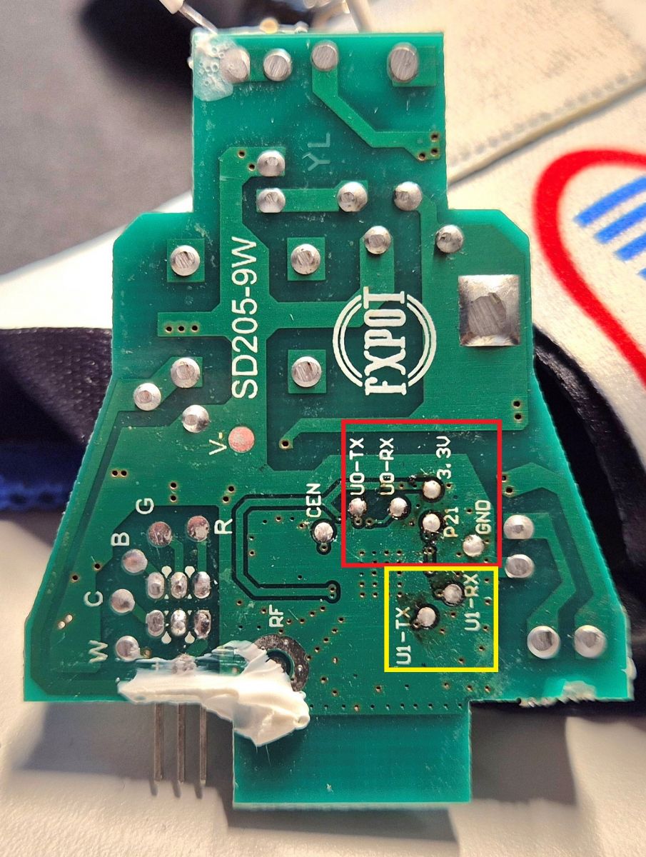

    The backside exposed 2 pairs of UART TX/RX, where U0 is used for flashing and U1  probably as log terminal (I can only guess, since I didn't need to use it) , 3V3 supply and GND as well as a CEN (chip enable, not needed for flashing) and P21, which needs to be pulled to GND for flashing through UART.
    Close-up of the SD205-9W circuit board with marked areas for flashing and debug output.
    Red box: used for flashing
    Yellow box: debug output (?)
    Note that at the bottom right, you can see the cathode connectors of the corresponding LEDs (RGBCW) - the transistors driving them are connected to:
    P09/GPIOA1 -> C
    P12/GPIOA4 -> W
    P13/GPIOA5 -> R
    P14/GPIOA6 -> G
    P15/GPIOA7 -> B

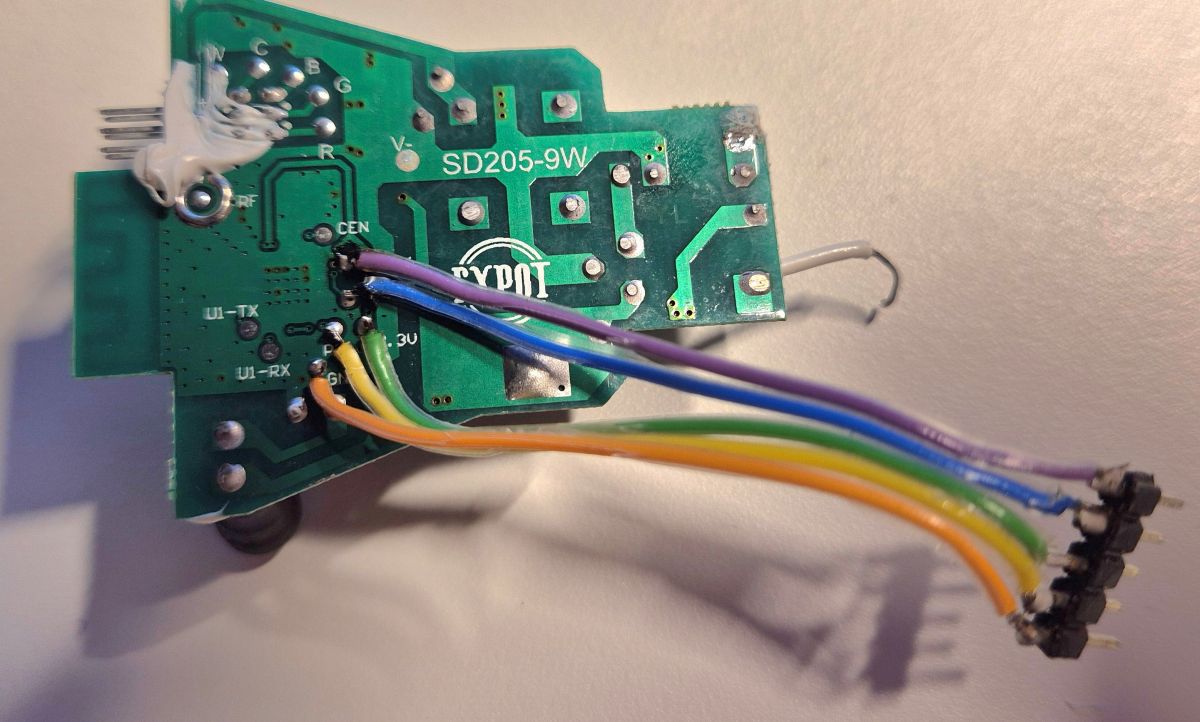

    For flashing, I used a USB to UART/TTL adapter (3.3V) with the following connection:
    U0-TX -> RX
    U0-RX ->TX
    GND -> GND
    3V3 -> 3V3 (benchtop PSU, current limit 500mA)
    P21 -> GND(during flashing)
    Image of a printed circuit board labeled SD205-9W with attached colored wires.
    For flashing OpenBeken, I followed the description in the flashing guide in this forum(Link) as liked on github.
    Flashing worked without any problems - after removing the short between GND and P21 and power cycling, I was able to connect to an OpenLN882H_C25E1088 hotspot.

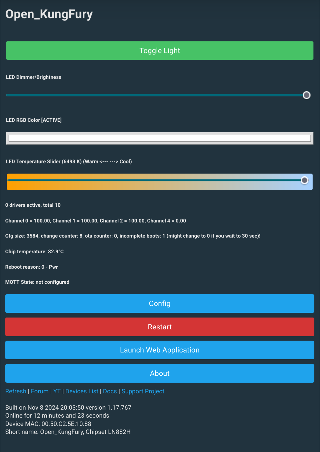

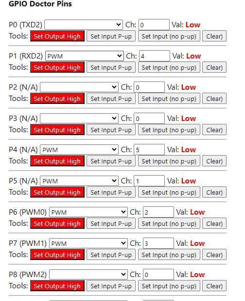

    Using the GPIO finder, I managed to confirm the connections of the LED groups as I suspected from the PCB:
    Screenshot of the GPIO Doctor Pins tool showing output settings and low values.
    However, here is where I ran into some issues:
    If I configure the pins as relays, I'm able to switch all 3 colors (RGB) plus cold/warm white without issue. If I configure them as PWM, I can only use G/B + warm white.
    I'm not sure whether this is due to the LN882HK (maybe they use timer sharing for PWMs, or the pins need to be configured in a certain way) or just some oversight on my side - maybe I'll look into it some more if I find the time. Also if anyone has an idea what could be the issue, please reach out!

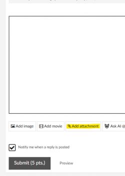

  • #9 21279539
    Posts: 5209
    Help: 446
    Rate: 914

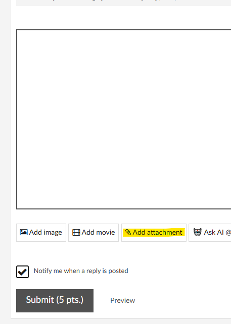

    this option allows the attachment of .bin or .zip files
    Screenshot of an interface with the Add attachment option highlighted in yellow, allowing file attachment.

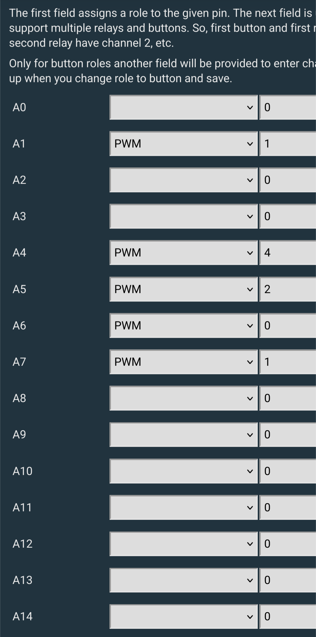

    quite new here. Nevertheless, it seems that I have the same bulb, flashed it with success. but then I couldn't find any matching and working template.
    Thus, I applied manually the configuration shared at the top,
      "pins": {
        "1": "PWM;4",
        "4": "PWM;5",
        "5": "PWM;1",
        "6": "PWM;2",
        "7": "PWM;3"
    And it's working as expected, until some random time when the bulb turn off and disconnect.
    My only option is to switch the lamp electrical power off => on, and wait for the bulb to get back. Sometimes it's immediately, other times I have to wait.
    Thus, I feel like a limit is reach at some point, maybe a temperature one, and makes the bulb to set down.
    Do you have an idea what's going on or/and how to fix it?
    Is it maybe a slightly wrong configuration? Or maybe a flag/option could help (I'm very new to OpenBeken firmaware)?
