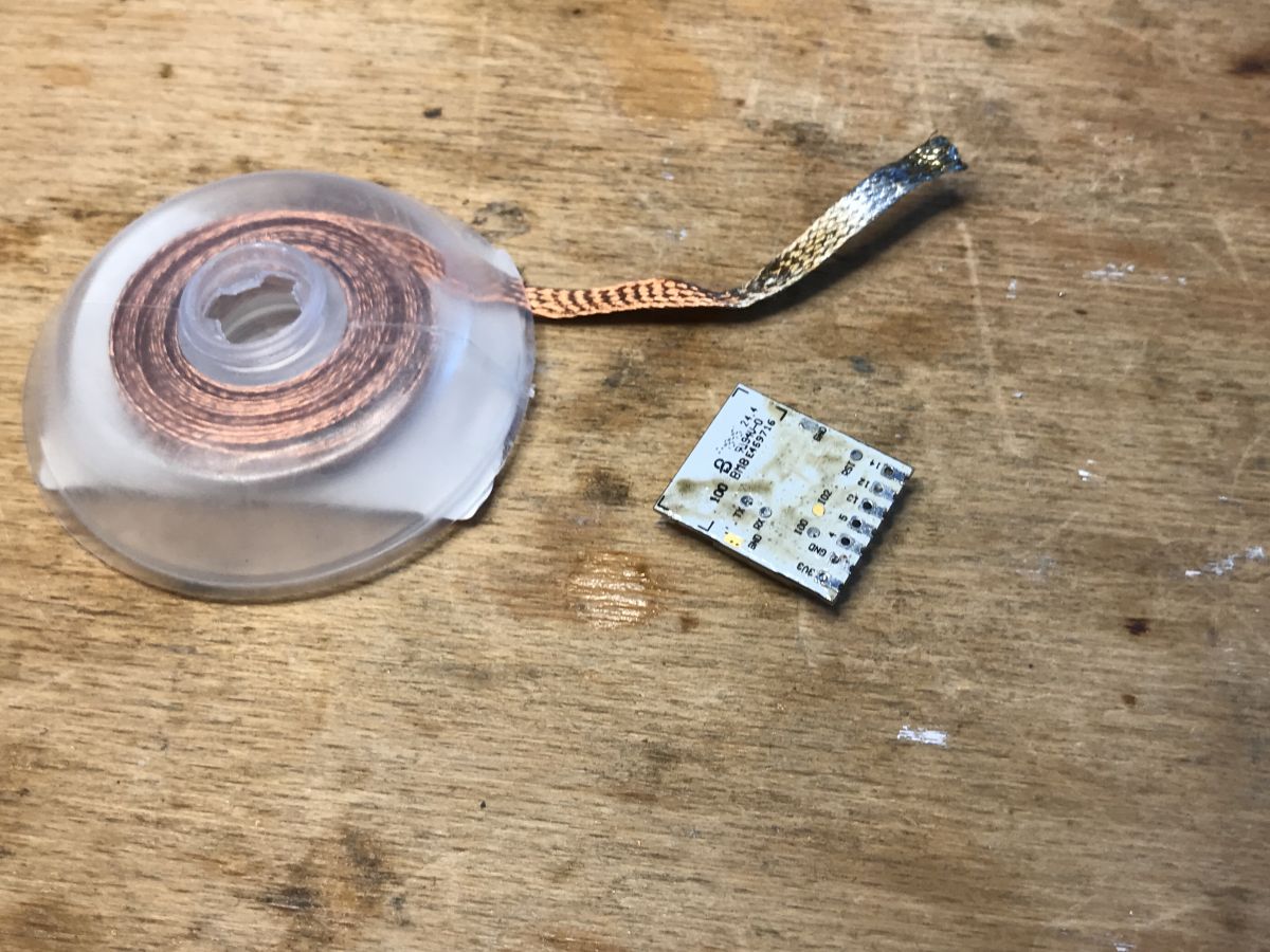

    Simple module desoldering and programming
    The module must be desoldered, because the RX / TX pads are covered by the second PCB and there is no other way to get to them.
    You could use hot air, but why complicate it?
    All you need is the cheapest, used soldering iron without power regulation, flux and some lead solder (Pb-free solder has higher melting point which makes everything hard, so I prefer Pb one).
    1. apply flux
    2. apply additional Pb tin on the pads
    3. heat up all pads with extra tin together
    4. the module should drop by itself
    5. it is worth cleaning with a braid and also IPA pad cleaner
    Some photos from the process:

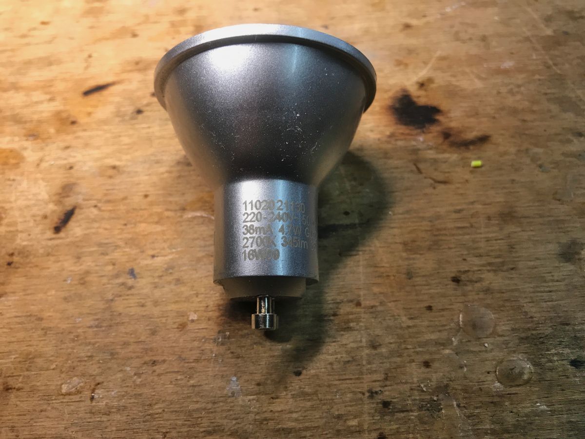

    For comparison - a regular GU10 LED bulb without WiFi
    Only as a curiosity I will show the teardown of an ordinary lamp:
    BKL1262 - RGBCW GU10 LED B.K.Licht Bulb [ESP8266][Tuya-convert?] BKL1262 - RGBCW GU10 LED B.K.Licht Bulb [ESP8266][Tuya-convert?]

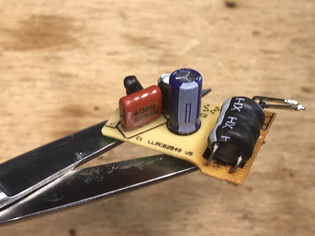

    The LED lamp presented here is damaged, but only two of the four LEDs burned out - if you had two of them, you could make one working.

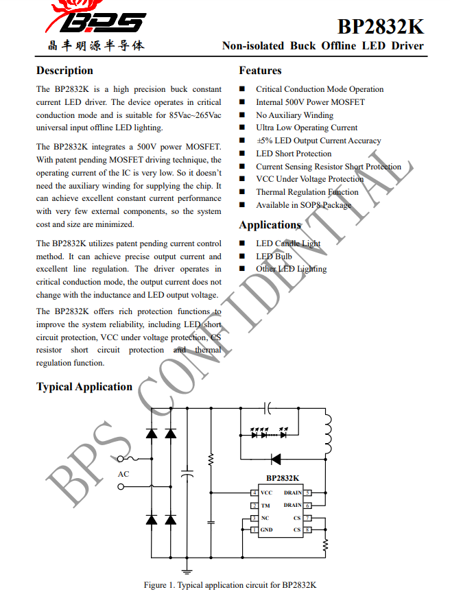

    The LED lamp is based on the BP2832K chip:
    It is a constant current buck converter. The large black element with the HX inscription visible in the photos is a coil.
