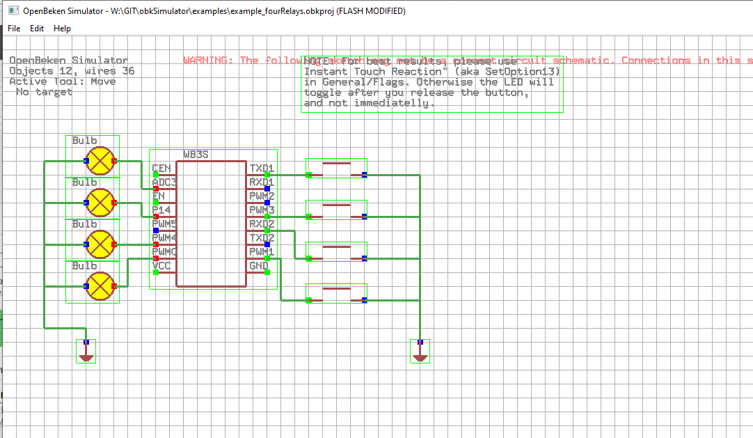

    Is there a command like tasmota SetOption13 1 to set a button only for single press to reduce delay?
  • #5 20775464
    Posts: 14771
    Rate: 12914
    Hello, have you checked our docs?
    https://github.com/openshwprojects/OpenBK7231T_App/blob/main/docs/flags.md
    6 [BTN] Instant touch reaction instead of waiting for release (aka SetOption 13)
    as per RSSI, I can add it to HA discovery if you want. Do you know what would be the HA yaml type for that?

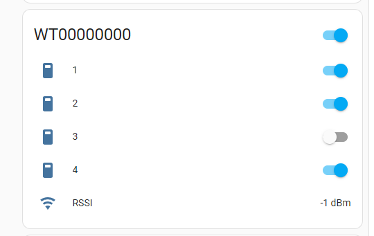

  • Home Assistant RSSI discovery JSON with signal_strength device class
    #9 20776177
    Posts: 14771
    Rate: 12914
    Setting the icon does not work for me. Maybe I got JSON wrong:
    Screenshot showing a code snippet using the cJSON library.
    Still, with this code:
    Code: C / C++
    I got that result:
    Panel with toggles and RSSI value of -1 dBm.
    Ignore -1 value, it's a placeholder for simulator:
    Circuit simulation diagram with four bulbs and a WB3S chip.
  • Suggesting icon instead of icon_template for RSSI

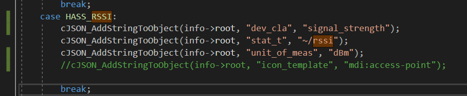

    Code: c Expand Select all Copy to clipboard
    case HASS_RSSI:
    cJSON_AddStringToObject(info->root, "dev_cla", "signal_strength");
    cJSON_AddStringToObject(info->root, "stat_t", "~/rssi");
    cJSON_AddStringToObject(info->root, "unit_of_meas", "dBm");
    //cJSON_AddStringToObject(info->root, "icon_template", "mdi:access-point");
    break;
    I got that result:
    I think it should be icon only not icon_template, not?

    I just did something very similar with a DIY BME280 sensor and an ESP32 module.
    If you specify the device_class, HA will assign the appropriate icon for you.
    Looks like you're covered with device_class signal_strength. This is the same one I used.

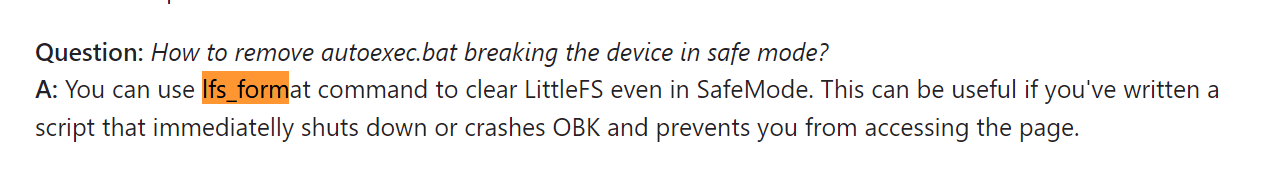

    Is there any way to edit the autoexec file if I boot to safe mode? I use deep sleep and in safe mode the web app loads only a white page.
  • #14 20780542
    Posts: 14771
    Rate: 12914
    Hello @erdeidominik1999 , as far as I remember, there are two options:
    1. in safe mode you should get a "do unsafe boot" button on http gui, but i am not sure
    2. in safe mode, you can use this command:
    FAQ excerpt on removing autoexec.bat in safe mode.
    See more on our FAQ:
    https://github.com/openshwprojects/OpenBK7231T_App/blob/main/docs/faq.md
