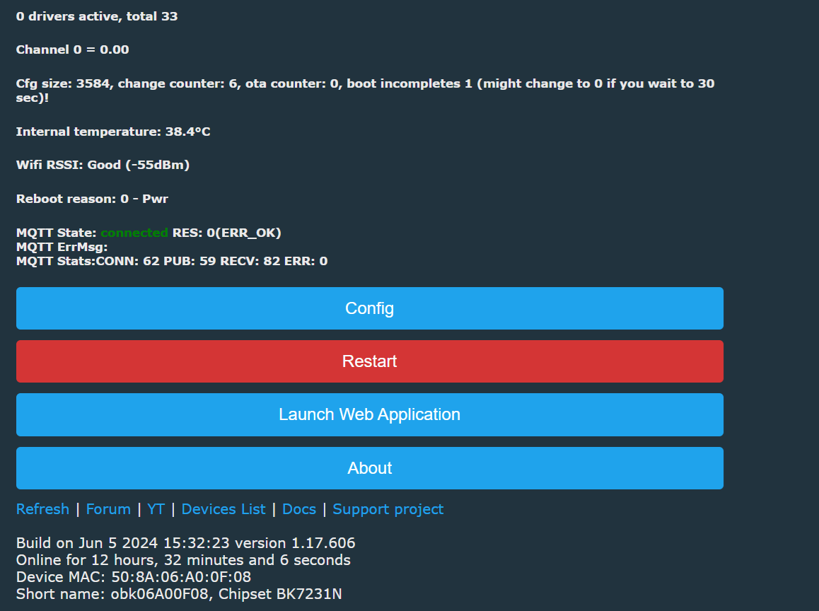

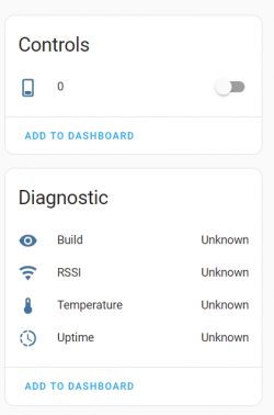

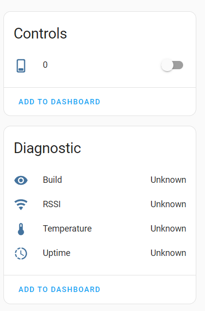

    Hello, first post here. I have installed openbekkeniot firmware onto my smart plug device and connected it to homeassistant and I am happy with how simple it was. But I noticed that when I ran the HA discovery, it added 4 'diagnostic' topics for things like temperature, rssi. Now it is bothering me that the topics just say "unknown". Is there some setting I am missing to send the data on these topics?
    Control and diagnostic panel of a smart plug with Unknown values. Screenshot of OpenBK IoT dashboard showing diagnostic data of a device.
  • #2 21272982
    Posts: 14771
    Rate: 12914
    Do you have flag 10 ([MQTT] Broadcast self state on MQTT connect) enabled?
  • #3 21273564
    timbernasch
    I do have that flag set. Since I posted I got a single update of the data, possibly from when I moved it to another outlet. So it is showing valid values now. But I was hoping to get more constant updates of the temperature for example. Is it only going to update when the plug is first plugged into mains power?
