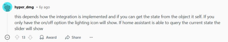

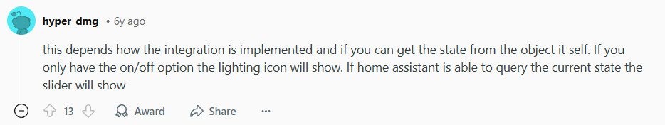

    This problem has come up on the forum in the context of OBK. Users have reported that there are flashes (as it sounds like) when the HA restarts, and only when the OBK publishes its state do they turn into a toggle. For this reason it seems to me that the lightning is until the HA knows the state of the device?
    Reddit confirms:
    Comment by user hyper_dmg on a forum about integration and icons in Home Assistant. .
    And what do you think yourself and where have you encountered this problem?

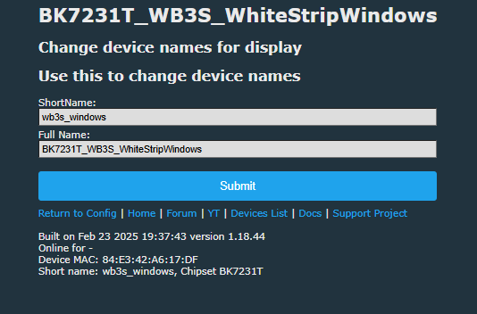

    @walkowiakmariusz8989 what do you mean by quoting this passage?
    The mysterious "WinTest_00000000" comes from the fact that this was tested in the OpenBeken Simulator, which runs on Windows. And the zeros are the zero MAC address.... on the BK7231 platform it would be OpenBK7231_ , on the LN882H it would be OpenLN882H, and so on....
    OpenBeken IoT device simulator - first early alpha version for testing .
    And you can still change it later if you want a different device name:
    Screenshot of the OpenBeken IoT simulator showing device name change. .

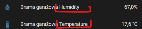

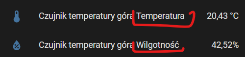

    I have been experimenting with Discovery themes in Home Assistant for some time now and have encountered a problem that I have not yet managed to solve. The issue is on what basis (and why) some names or classes in Home Assistant are translated into Polish, while others remain in the original.
    I have several devices connected to MQTT that publish topics with a similar configuration. I have noticed that humidity topics, for example, are displayed as 'Humidity' once and as 'Humidity' another time. For example, SUPLI devices are not translated into Polish, while most Zigbee topics are. For my own themes, Home Assistant does not translate either, leaving them in English.
  • #10 21473007
    krzbor
    Posts: 1780

    krzbor wrote:
    Start MQTT-Explorer and connect to the MQTT broker with it. Then restart the Z2M. After the restart, Z2M sends "discovery". See if it sends in Polish or English.
    I thought about that too, but no, in MQTT explorer everything is in English. In addition, HA would have to "expose" information about what language the user is using, so that Zigbe2MQTT could use this information when exposing topics. And since there may be several users, and each may set a different language, I would consider this solution unrealistic. I am betting, however, that HA translates the names of typical sensors for itself on some basis, just not sure on what basis.
    Example sensor from Zigbe2MQQT:
    Icons of temperature and humidity sensors with values. .
    Example sensor from Supli:
    Screen showing sensors displaying humidity and temperature in a garage door. .
    And finally "my" sensors with ESP which connects directly to MQTT and publishes its topics:
    Thermometer icon with the text Temperature and value 24°C. .
    Added after 2 [hours] 12 [minutes]: .
    lexx_ wrote:
    I'm betting, however, that HA is translating the names of typical sensors to itself on some basis, just not sure on what.
    I solved the topic, and the solution turned out to be hidden in the documentation.
    HA takes the entity name from:
    1. the device name,
    2. the translation key,
    3. the device class.
    If we put "name" in the discovery subject, it is the one that will be displayed:
    And if we omit "name", the HA will use the device class to display the name and, incidentally, translate it into the language used in the user interface:
    Humidity icon with label and percentage value. .
    So as long as we use typical sensors for "typical" applications, "name" can be omitted.
