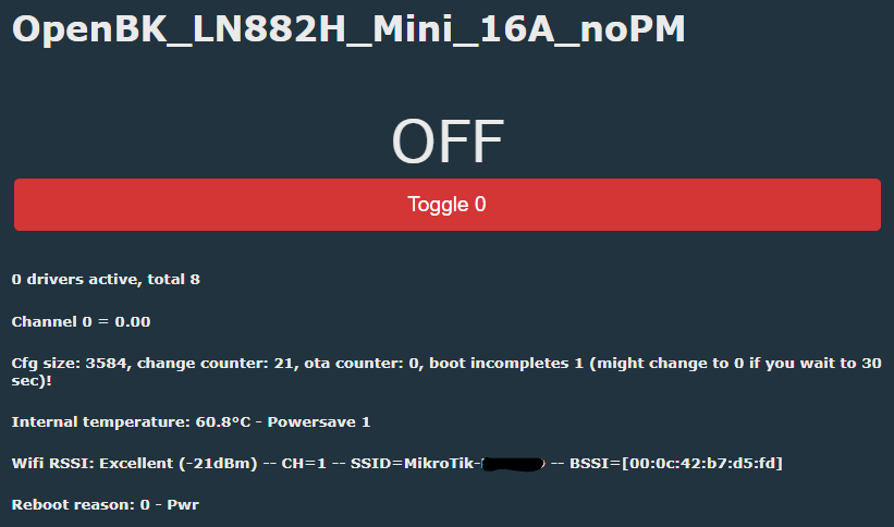

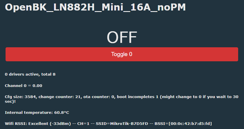

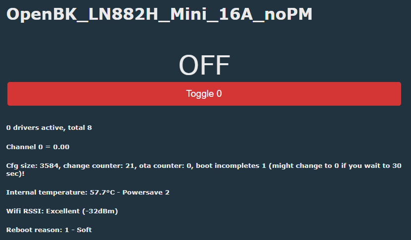

    When accessing an OpenBeken device without a serial log, I often miss some information.
    E.g. I have multiple access points and would like to see, to which my module is connected.
    Or: I would like to see if the device is using PowerSave and (with LN882H) which level.
    So I tried to add some WiFi hal functions, to make this accessible.
    On my LN882H it looks like this:
    User interface of the OpenBeken LN882H control panel.
    Since I only own LN882H modules, I would like some brave testers to try the images from this PR on other platforms.
    https://github.com/openshwprojects/OpenBK7231T_App/pull/1216
    Since I couldn't test them, I would suggest only to test on modules, which can be re-flashed easily (e.g via UART), if it might be inaccessible for an OTA update with this images...
    Thanks for any feedback.

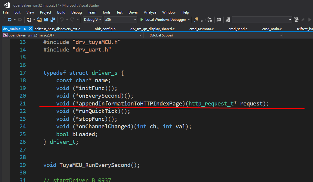

    My first suggestion would be to put your code inside a conditional statement that checks for failed boots. This way you can make sure that you won't break devices even if your code has an error...
    Futhermore... hmmm I see you made a feature to put a WiFi info on the main page just to later censor it before putting it on forum....
    Maybe that's a sign that your feature should be enabled by a flag? Something like "show extra info"? So people can choose whether they show it or not?
    Or maybe... maybe it could have been put in a driver? It would be even better than a flag...
    And then you would just use:
    View of Visual Studio screen showing C code.

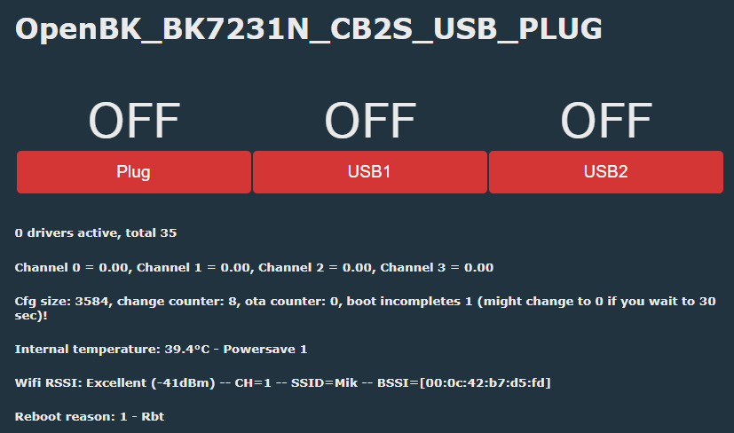

    #3 21073436
    Posts: 5185
    Help: 445
    Rate: 912

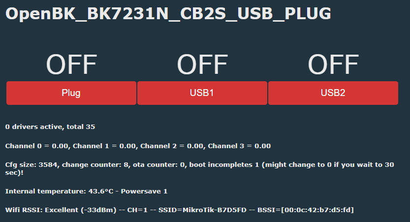

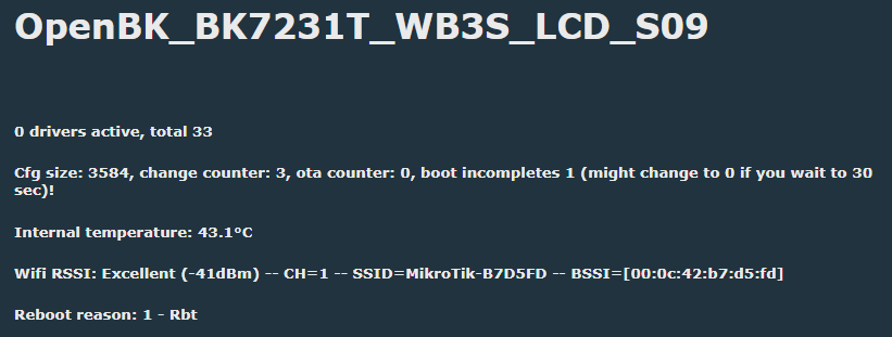

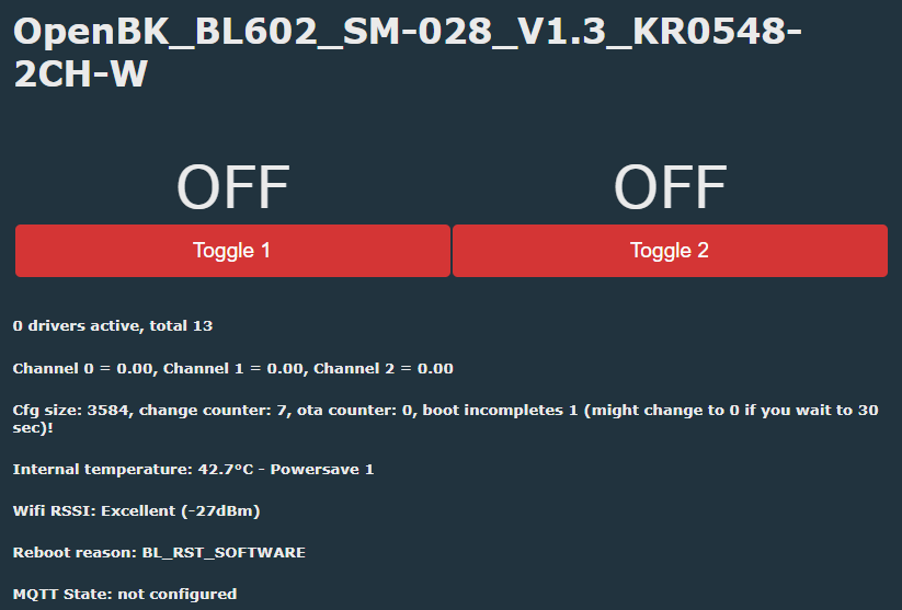

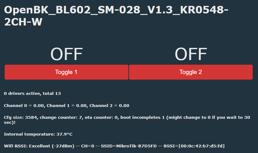

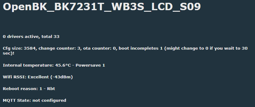

    Device interface with two Toggle buttons, both set to OFF. Screenshot of OpenBK LN882H Mini interface with Toggle 0 button.
    Web interface of OpenBK_BK7231N_CB2S_USB_PLUG controller displaying device status information. Screenshot of the OpenW600 interface with configuration details.
    Screen displaying system data of the OpenBK_BK7231T_WB3S_LCD_S09 device.

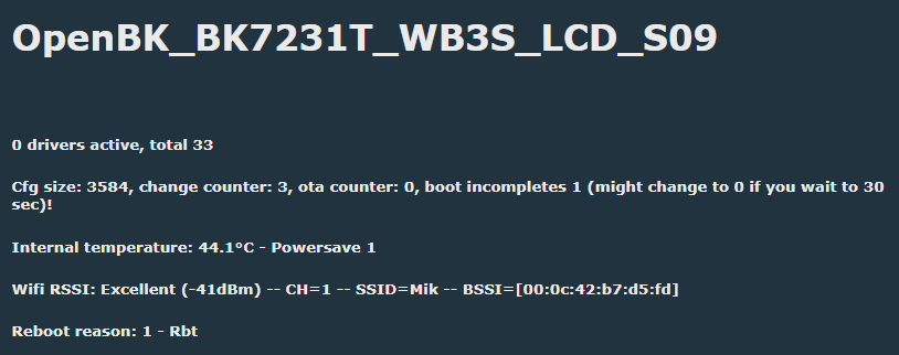

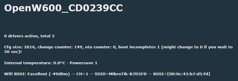

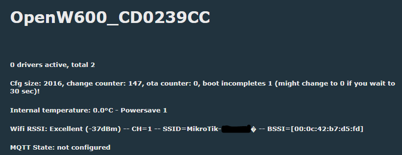

    all Build on May 7 2024 12:48:51 version 1216_merge_a66f326e5e17

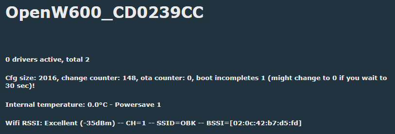

    all truncate SSID except LN882H and W600. W600 has invalid character at end but not if SSID is shorter
    Screenshot displaying diagnostic information for the OpenW600 device.

    I'll take a look into this SSID issue - but even if it doesn't work - most people know what SSID they configured. Just the BSSID of the AP you are connected to is often some clicks away ;-)
    And: at least for my LN882H I had some times, where the displayed information was simply wrong. It showed a valid pair of channel and APs MAC, but it was in fact connected to another AP (could be verified by the (correct) rssi , which didn't match the shown AP (and by the serial log proving, it connected to another AP).
    There is something strange with LN882Hs wifi lib...

    BSSID is as expected for all. Regarding the channel, my Mikrotik doesn't seem to give me the frequency or channel for each client so I cannot say if they're all correct. The BL602 though says channel 0 which isn't a valid 2.4ghz channel?

    Thanks, I think I might just drop SSID (this is known and can be taken from the config - would only be interesting in case you have 2 SSIDs configured).
    Channel 0 is not valid, but usually given to configure startup with only SSID and an unknown channel.
    But maybe you can give the new Version a try (I used strcpy instead of memcpy here)?

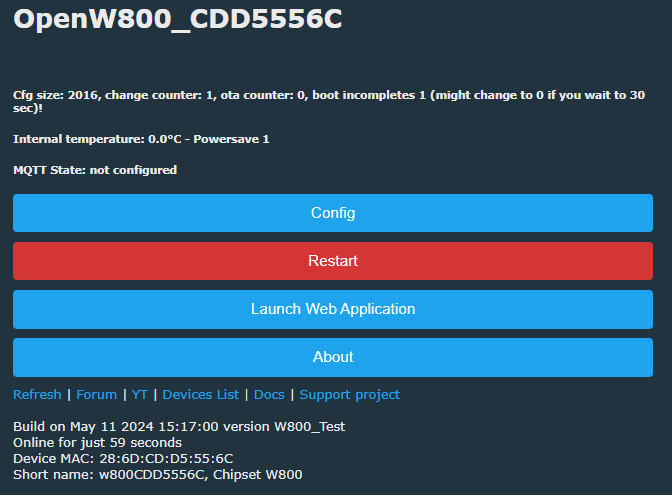

    Status page screenshots from first W800 flash

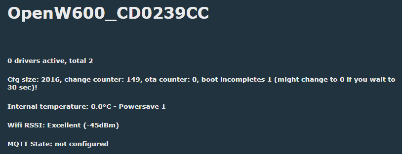

    #7 21076301
    Posts: 5185
    Help: 445
    Rate: 912
    Enhancing OBK Status Page with WiFi Details for OpenBeken Devices Enhancing OBK Status Page with WiFi Details for OpenBeken Devices Enhancing OBK Status Page with WiFi Details for OpenBeken Devices OpenBK interface screen with technical information and Toggle 0 button. Screenshot of the OpenBK interface with system information.
    Added after 1 [hours] 4 [minutes]:

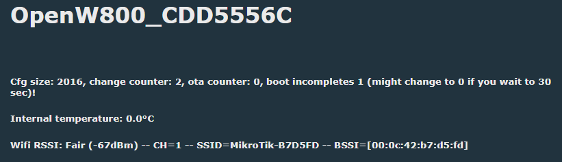

    and my first flash to a new W800
    Screen displaying information about OpenW800, configuration, and WiFi status.

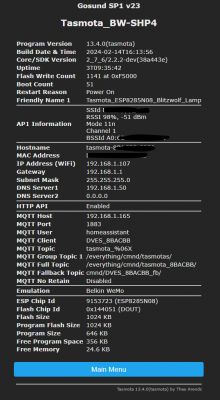

    Posts: 5185
    Help: 445
    Rate: 912

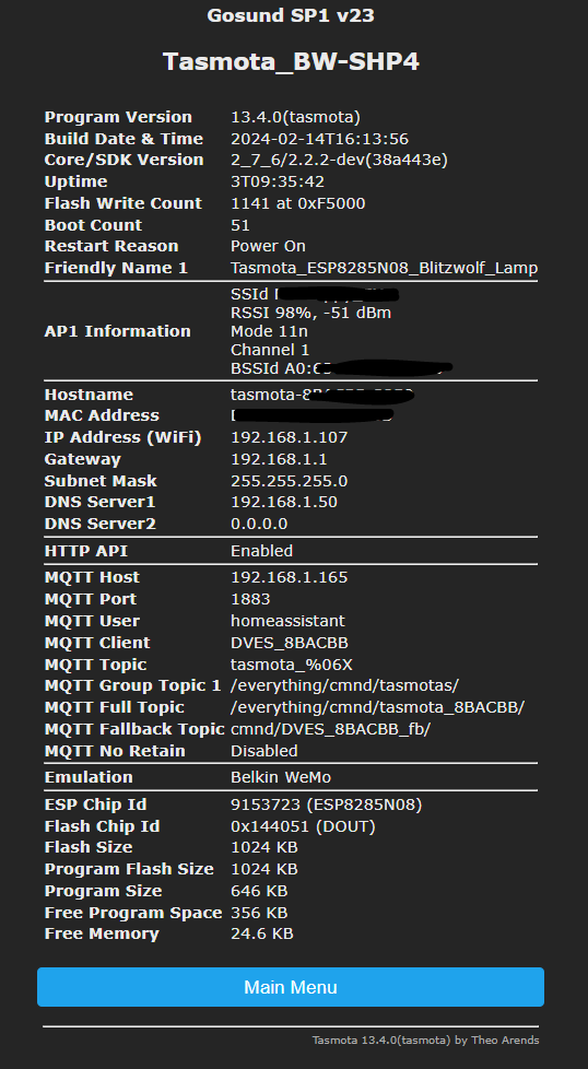

    something like Tasmota, complete with flash ID, size, chip detected
    Screenshot of Tasmota BW-SHP4 device settings on Gosund SP1.

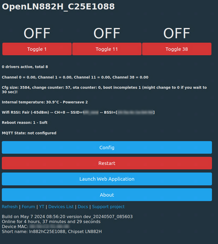

    #10 21076563
    max4elektroda
    Posts: 758
    Help: 49
    Rate: 189

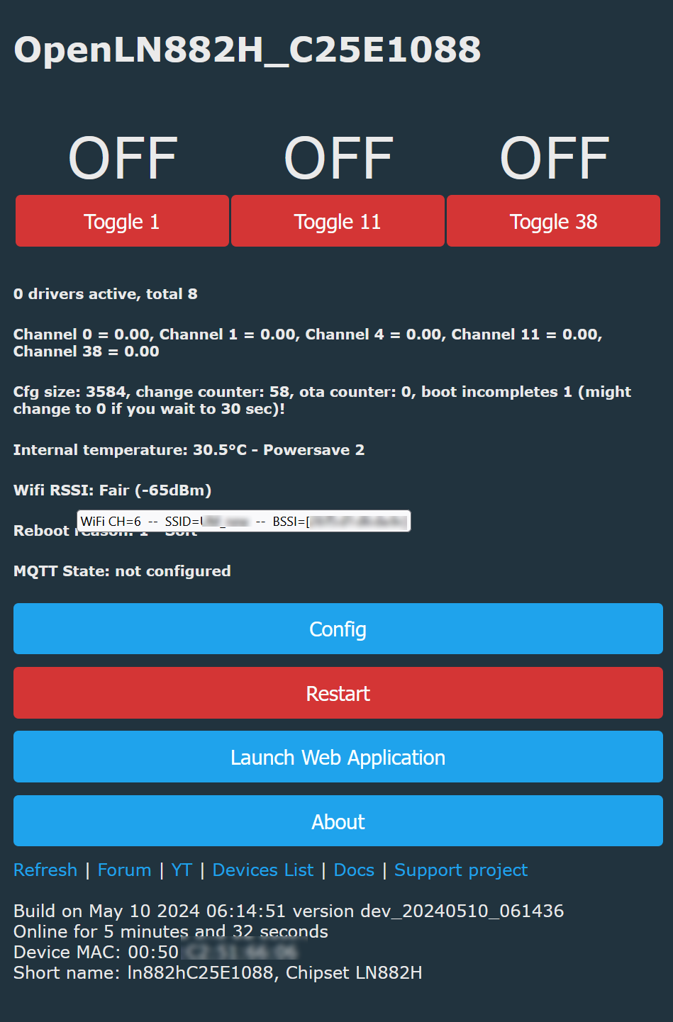

    Yes, that's a good point and I fully agree that BSSID, channel, and SSID are not of interest in most cases, and my suggestion would have been the same, only leaving PowerSave mode in regular status.
    On the other hand: I did put them in one line with existing information for every "appendInformationToHttpIndexPage" takes even more space.
    My first goal was to verify the function of the new functions and as far as I can see, it works o.k., only feedback for an XR802 is missing.
    For the other details I can think of a debug page, removing them fully from the GUI and introducing a command or, my actual idea, hiding it in a mouseover/tooltip.
    That will make it accessible on the main page (something I personally would like) but not visible hence not overloading this already loaded page.
    The drawback: It's not clear on the first look that there is some "hidden" information present.
    But maybe that is a general idea to streamline the main page and hide information like config size, reboot reason ...
    On a separate "detailed information" or "debug" page or in tooltips...
    Added after 51 [minutes]:
    Just a quick hack to show what I mean by information hidden in a "tooltip", if this is not clear (mouse pointer is over "WiFi" - not shown in screenshot):
    User interface page displaying network and device configuration details for OpenLN882H_C25E1088.

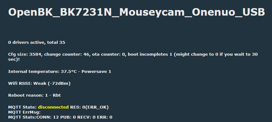

    Screenshot showing the status of OpenBK BK7231N Mouseycam Onenuo USB with a disconnected MQTT state. User interface of OpenBK showing network connection status information. Screenshot of the status panel for OpenW600_CD0239CC. Screenshot of the user interface for OpenBK_BL602_SM-028_V1.3_KR0548-2CH-W, showing Toggle 1 and Toggle 2 buttons in the OFF state. Screenshot of OpenBK interface displaying device status information. OpenW800 user interface displaying device status information and configuration buttons.
    all 1216_merge_0c97efa515cf

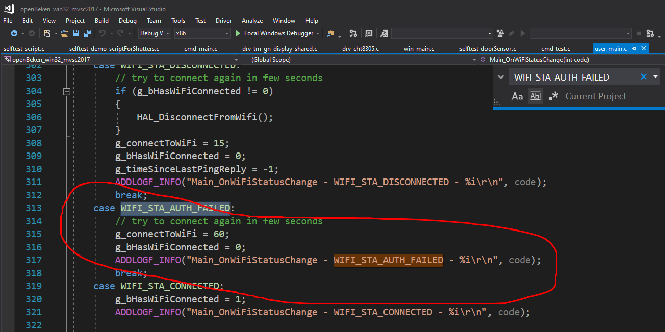

    What if you change SSID itself, and the target AP does not exist?
    The message you've shown originates from here:
    Screenshot of code in Visual Studio showing WiFi authentication error handling in the user_main.c file.
    Maybe we could put there a change of current SSID? In this conditional block?
    it still does please wait connect net...... every minute
  • #25 21079532
    Posts: 14725
    Rate: 12810
    "please wait connect net..." is not the message from the OBK, it's from the underlying SDK on that particular platform

  • Proposes a show extra sensitive info toggle for WiFi details
    #29 21588288
    spleefer90
    Posts: 17
    Using either a MAC address of a device or an AP, an SSID or a BSSID, you can sometimes pin down a very precise physical location.
    The current status page already leaks the MAC in the name of the device and by giving the actual MAC, so if any censoring should happen, MACs should be included.
    There are even *public* databases that can be used for this.
    This thread was linked in the issue where I requested BSSID to be visible on the main page for debugging - https://github.com/openshwprojects/OpenBK7231T_App/issues/1683
    OP tried to censor the info, and still left out the MAC in the name of the device, and used a blurring alg which seems susceptible to being deciphered, so I'd agree with having a "Show extra/sensitive info" button.
