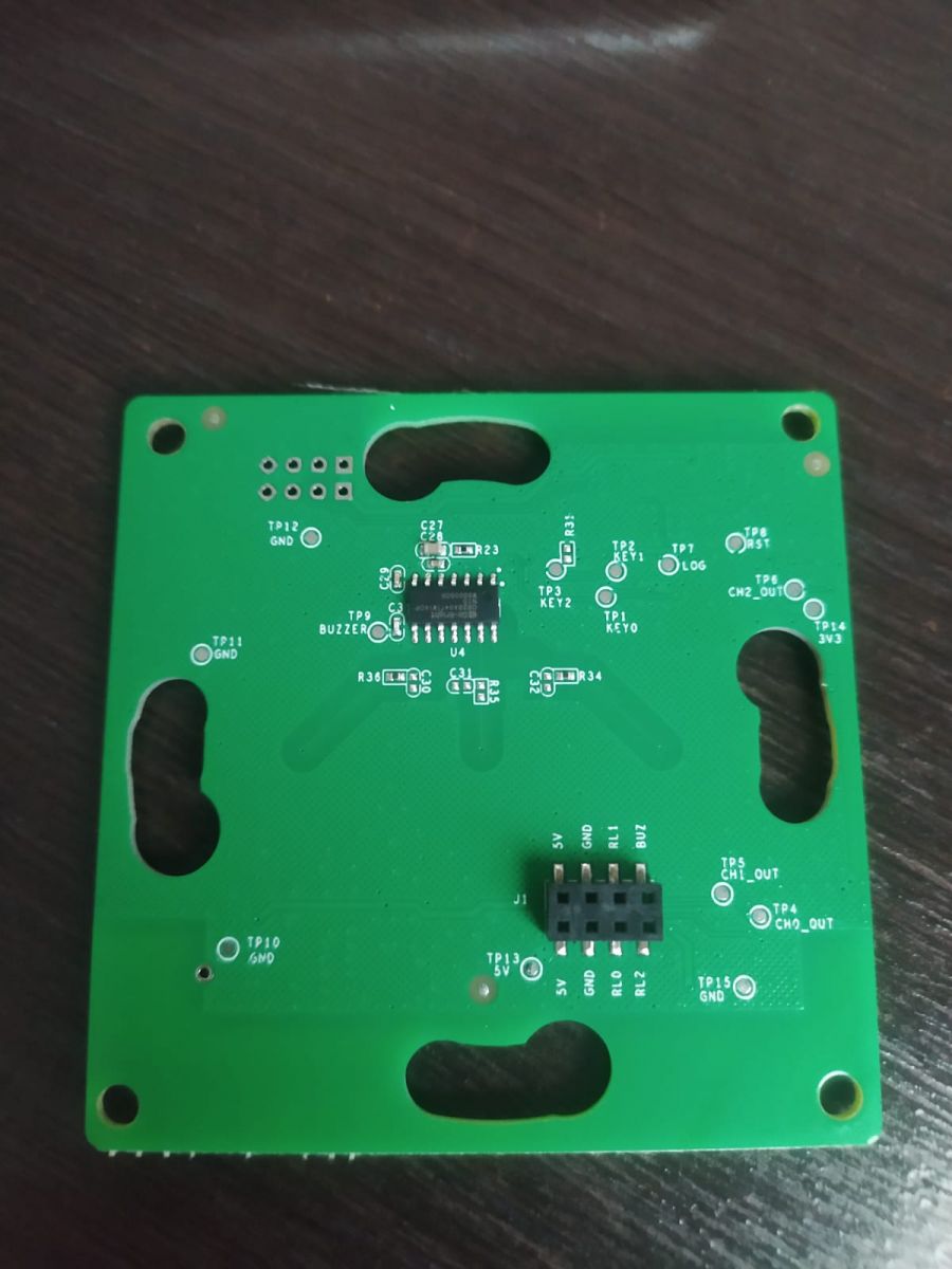

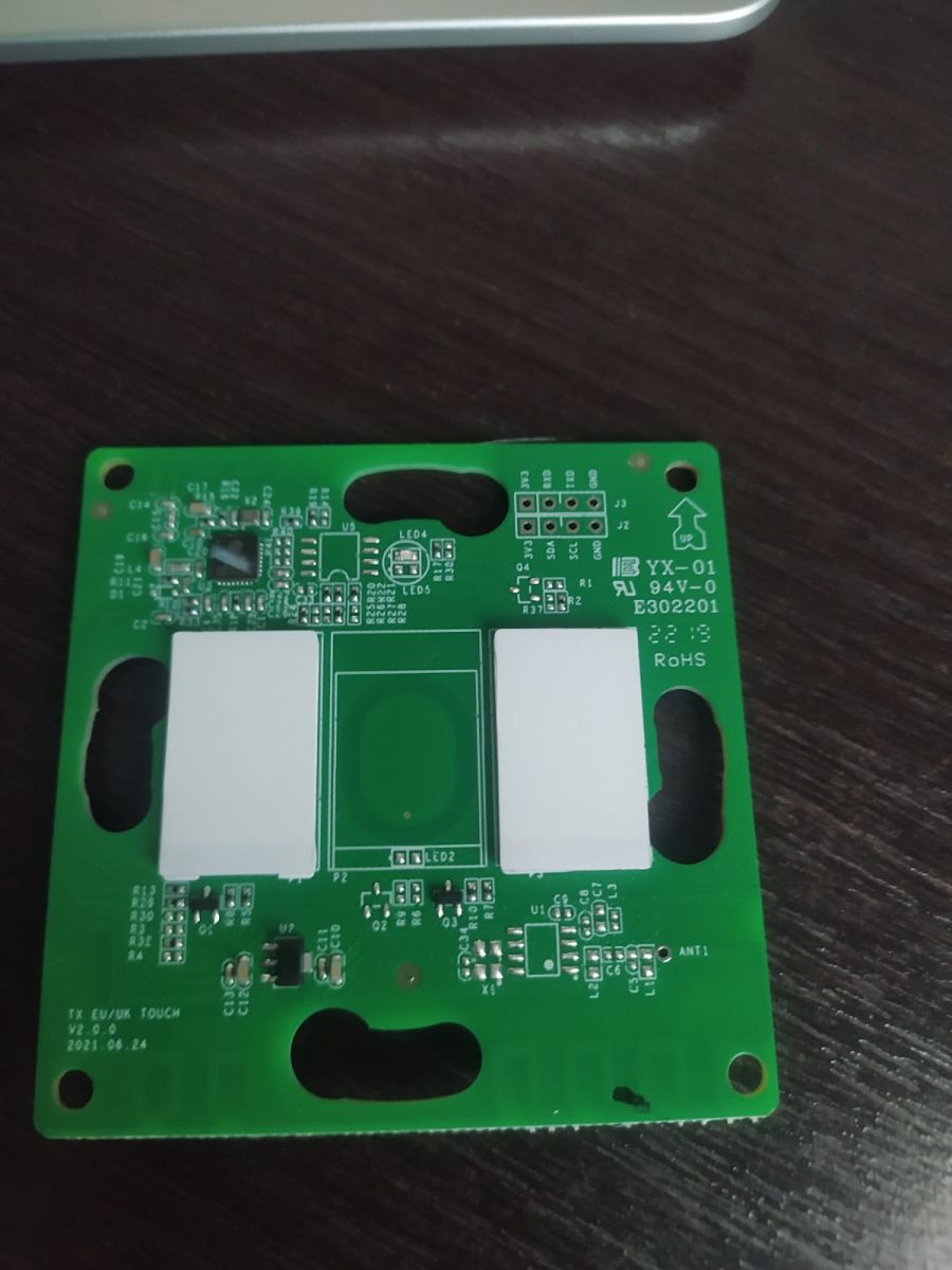

    I have a Sonoff TX EU 2C wall switch that I intend to use to communicate with another ESP that controls lighting. Pressing a button on the TX EU will result in communication with the other ESP (sending a GET request) and switching the light on.
    I therefore need to use both touch buttons and the two LEDs that illuminate them. I plan to upload the OTA firmware from Arduino to the Sonoff TX EU 2C, so that I can test my solution conveniently and without cables.
    Before I can do this, however, I need to have the pinout of these components: the two touch buttons and the diodes. Unfortunately, I can't find it anywhere.
    Has anyone of you perhaps already modified the firmware on this switch and can give me a hint about the pinout? Where can I find it? or if someone has it, could they share their knowledge?
    I enclose a picture of the board.
    Sonoff TX EU 2C circuit board with visible electronic components. Green printed circuit board with various markings and spots for electronic components.
    Thanks in advance for your hints.

    Ok, in case someone is looking, here is the pinout:
    Button 1 - GPIO00
    Button 2 - GPIO09
    Relay 1 and LED - GPIO12
    Relay 2 and LED - GPIO05
    Diode - GPIO13
