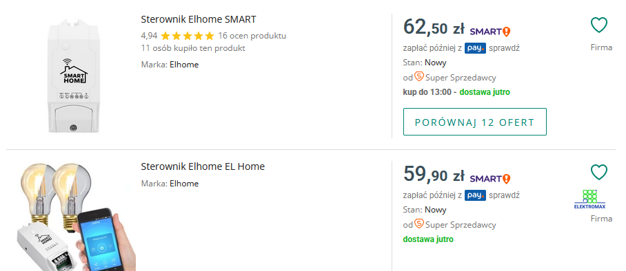

    Purchase of WS-05H1
    The equipment was purchased in our country for PLN 60:
    Screenshot of a webpage featuring Elhome controllers for sale.
    Here are screenshots from the seller's description:

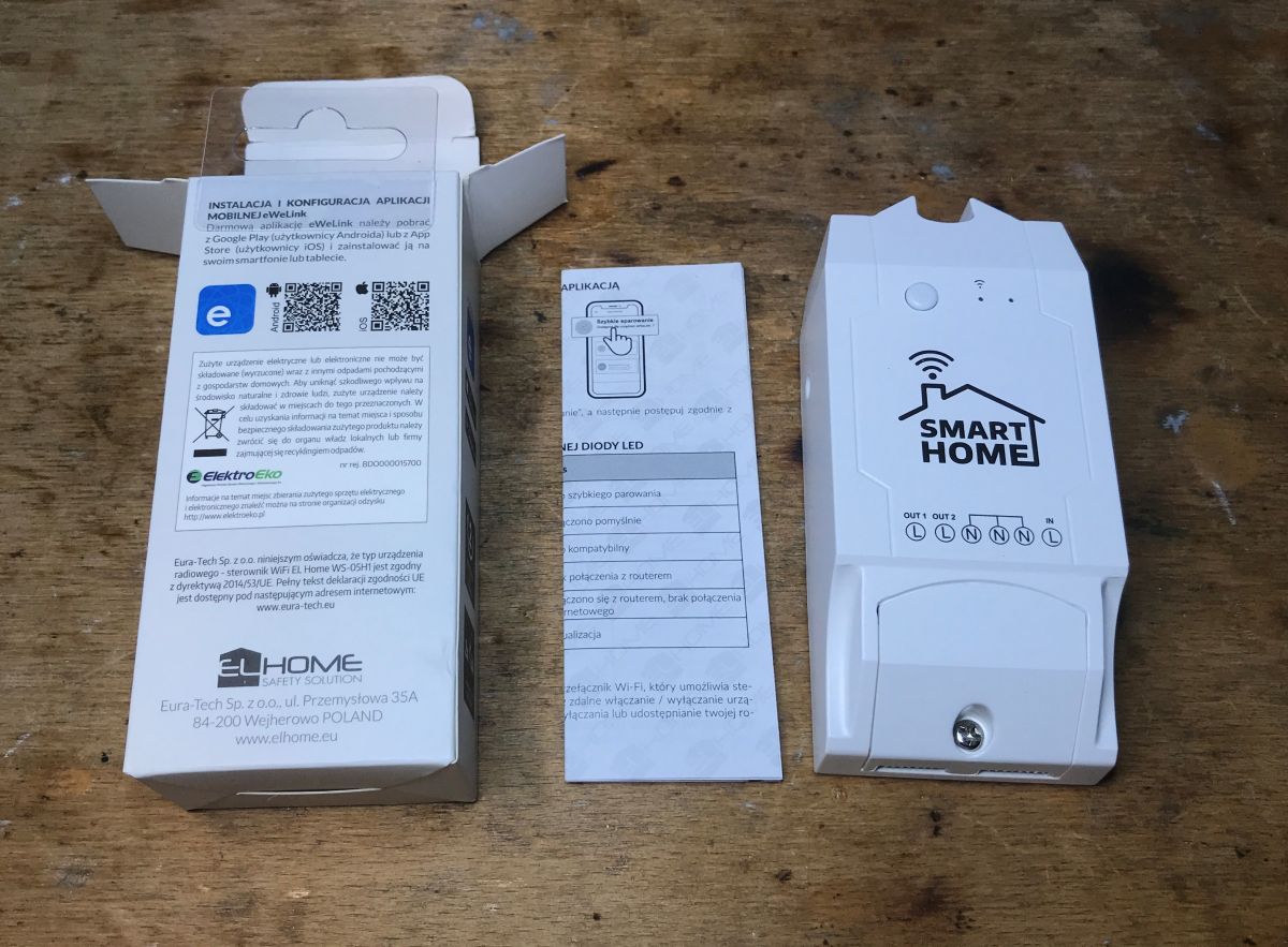

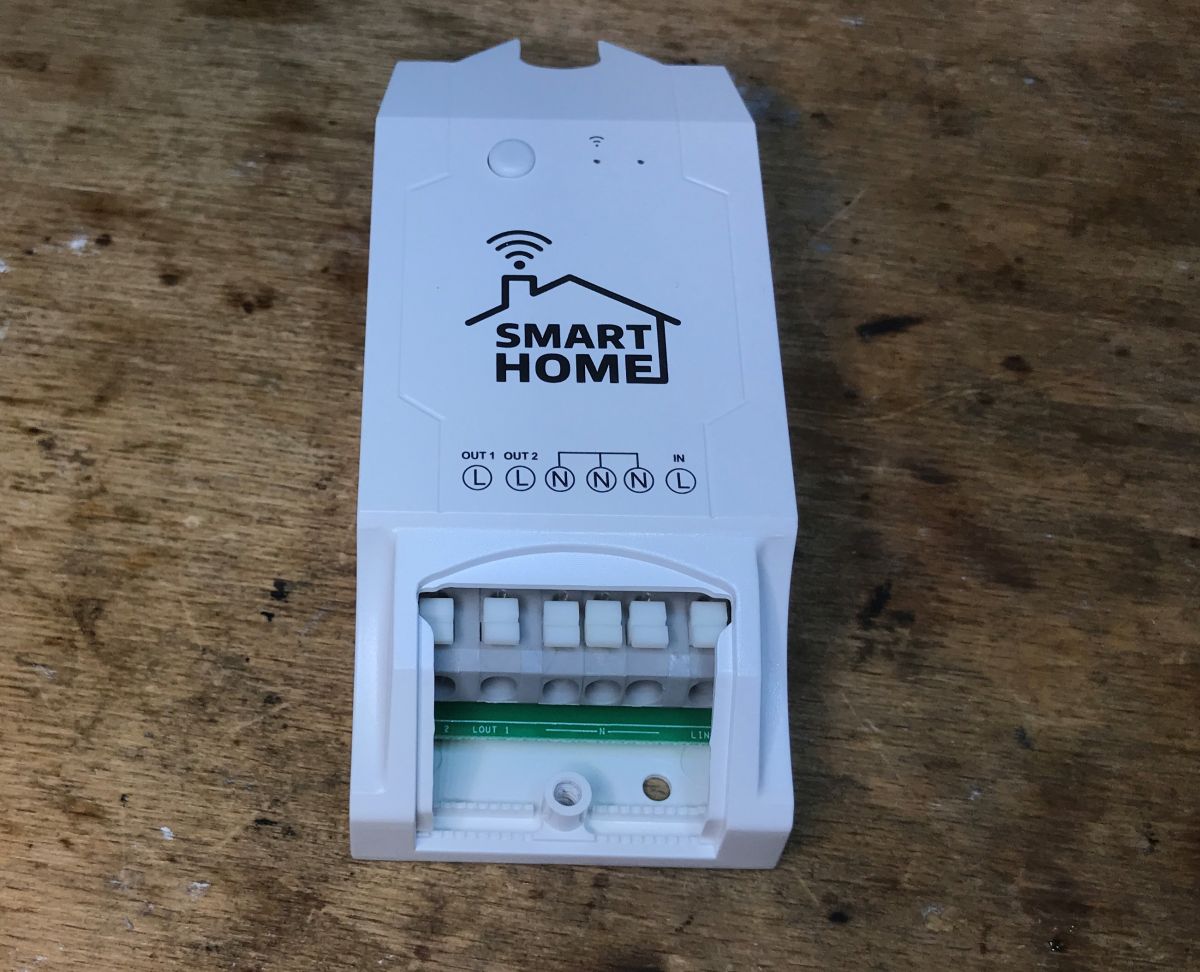

    Let's see what we get in practice:
    Packaging of the WS-05H1 WiFi controller on a wooden surface. Side of the WS-05H1 device box with description of features Packaging of the WiFi EL Home WS-05H1 device with instructions. WS-05H1 packaging with barcode and certification marks. WS-05H1 controller lying on a table next to packaging and instructions.

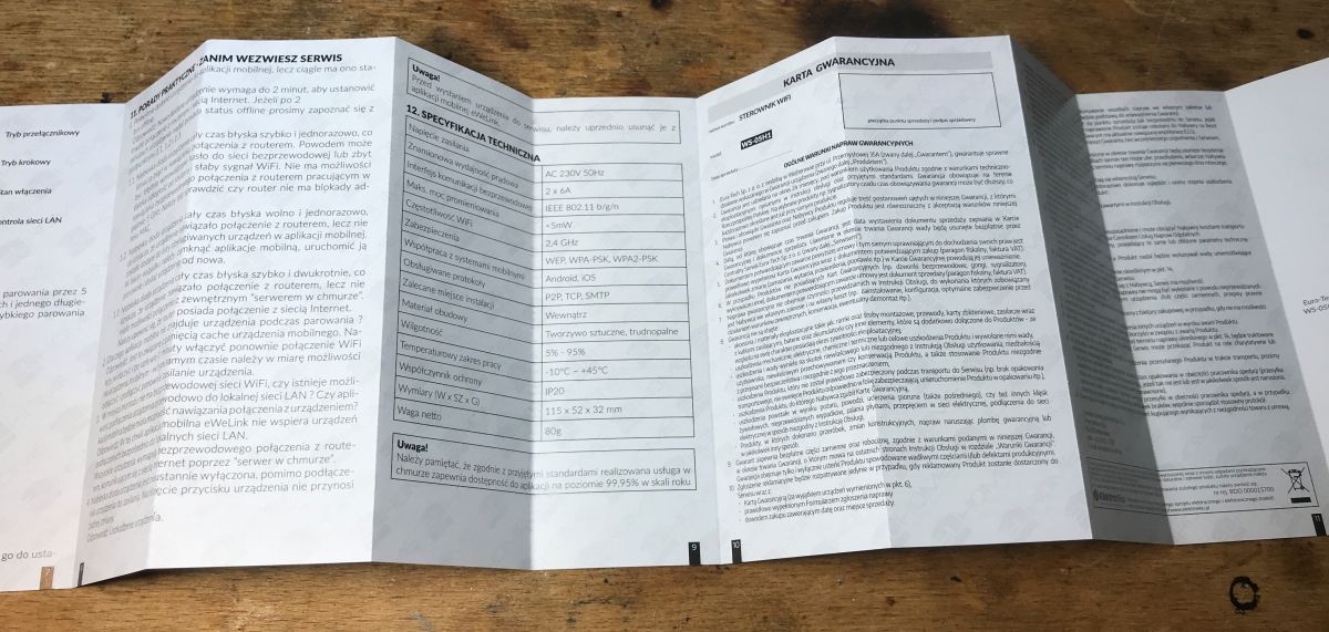

    Instruction:
    User manual for WS-05H1 WiFi controller on a wooden surface. Instruction manual for WS-05H1 WiFi controller unfolded on a table. Manual for the WS-05H1 device with illustrations. User manual for the WS-05H1 device on a wooden surface background. User manual of the WS-05H1 device in Polish with graphics and technical specifications. Open user manual for the WS-05H1 device, showing technical specifications and warranty information. Photo of the WS-05H1 device manual lying on a table.

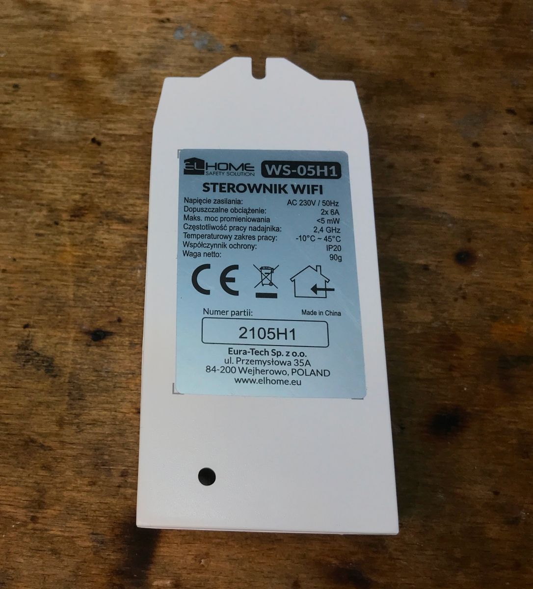

    And the driver itself:
    WS-05H1 WiFi controller with technical label on a wooden table. WS-05H1 smart home device on a wooden table.

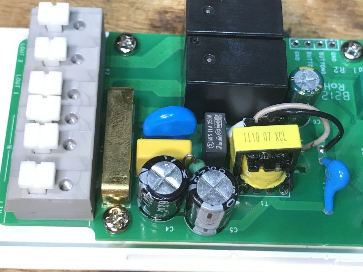

    Interior of WS-05H1

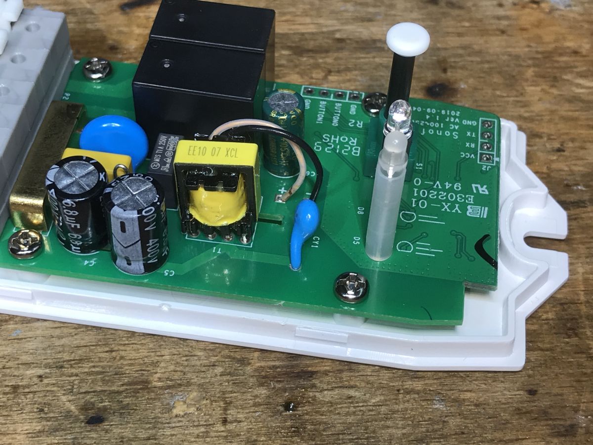

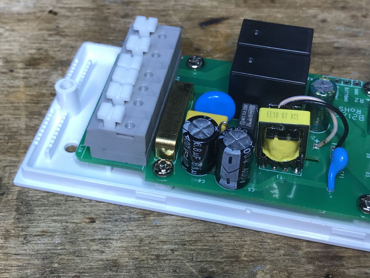

    It is customary to pry the lid off. This time, however, it is a bit different. This device is distinguished by the presence of an isolated flyback power supply. Smaller modules contain non-isolated step down converters.
    Interior of the WS-05H1 module with visible components on the PCB. Interior of the WS-05H1 module showing a relay and electronic components.

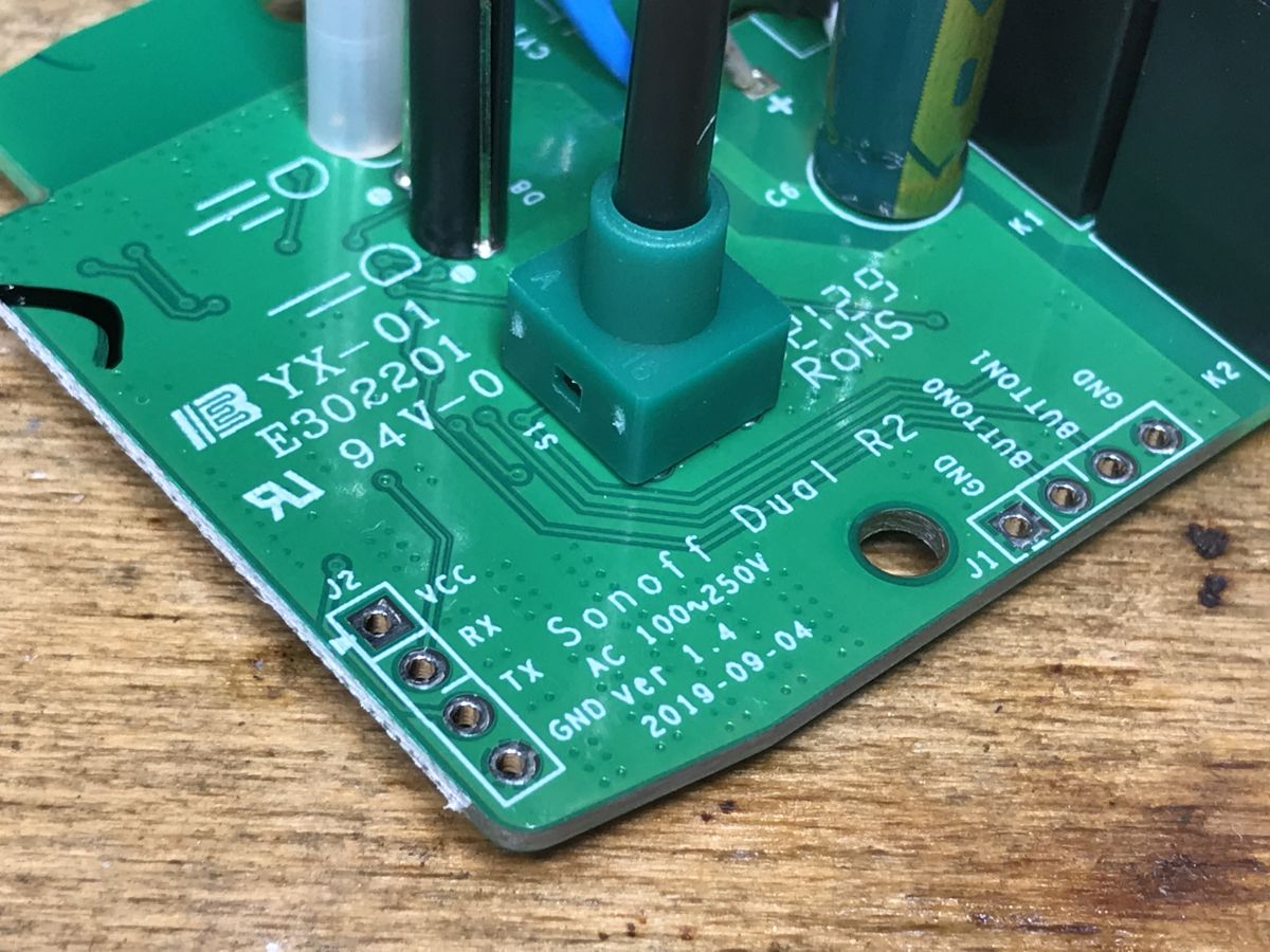

    The PCB has a programming connector (without IO0) and additional signals from the buttons - it's worth doing DIY.
    Close-up of the WS-05H1 controller PCB with connector and component labels.
    The interior is not that bad, I see a filter, a varistor, a fuse, the CY capacitor from the power supply (connects the secondary and primary sides) is also present:
    Interior of the WS-05H1 relay module with visible electronic components. PCB of the WS-05H1 device with electronic components. Close-up of the WS-05H1 module's interior showing relays, capacitors, and a flyback power supply. Close-up of the interior of a Sonoff Dual R2 module showing electronic components.

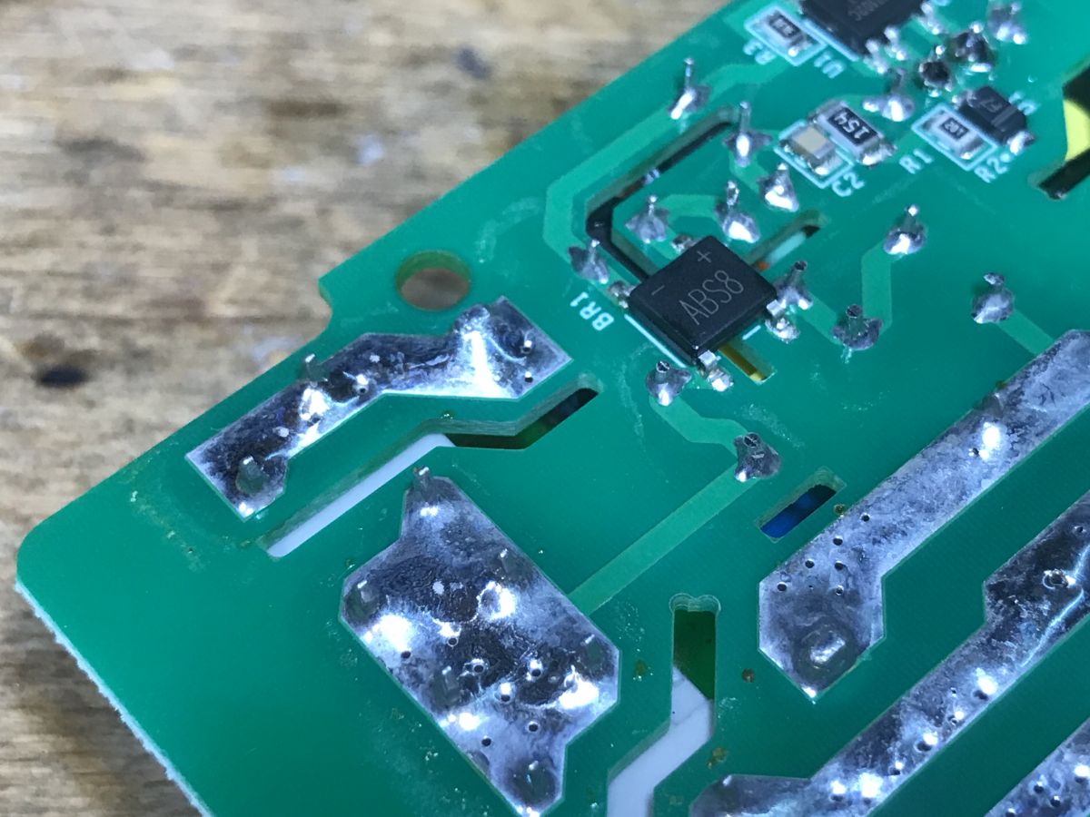

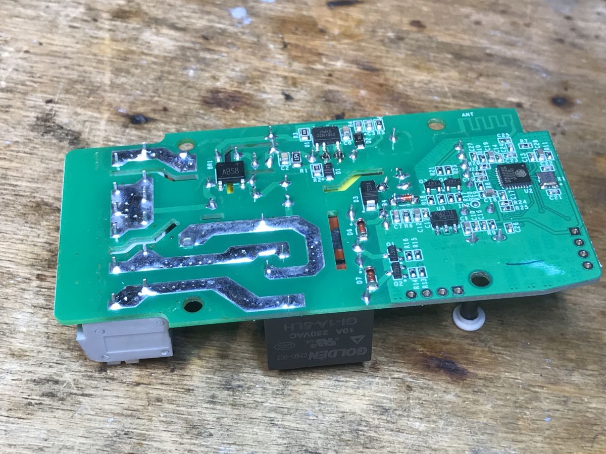

    The bottom of the PCB - high current paths are tinned:
    PCB with electronic components of the WS-05H1 device on a wooden background.

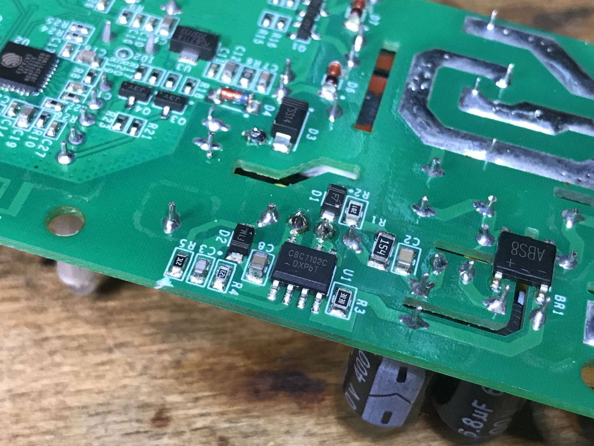

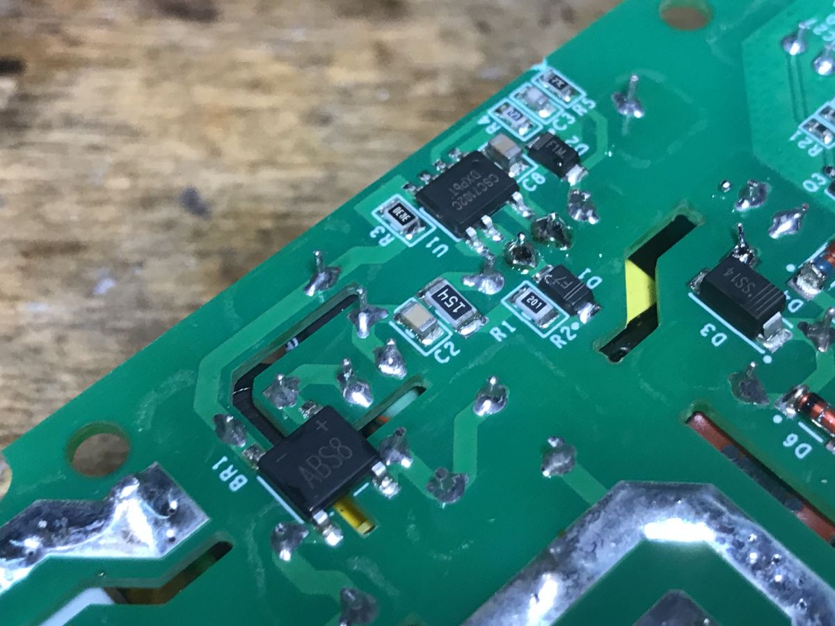

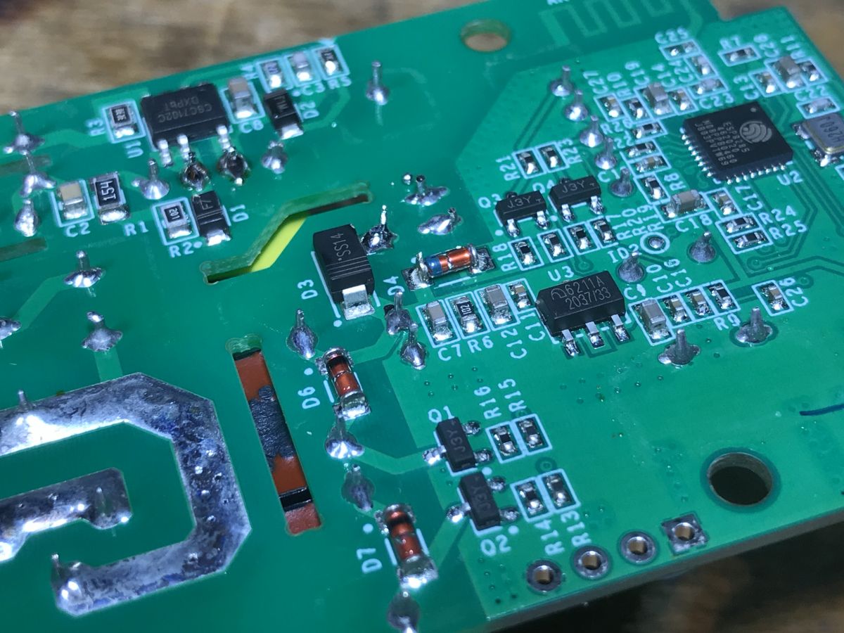

    On the bottom there is a rectifier bridge and a flyback controller:
    Close-up of PCB with visible tracks and electronic components Printed circuit board with electronic components on WS-05H1 module.
    The power supply is based on CSC7102C, which I have already seen in another Sonoff product:

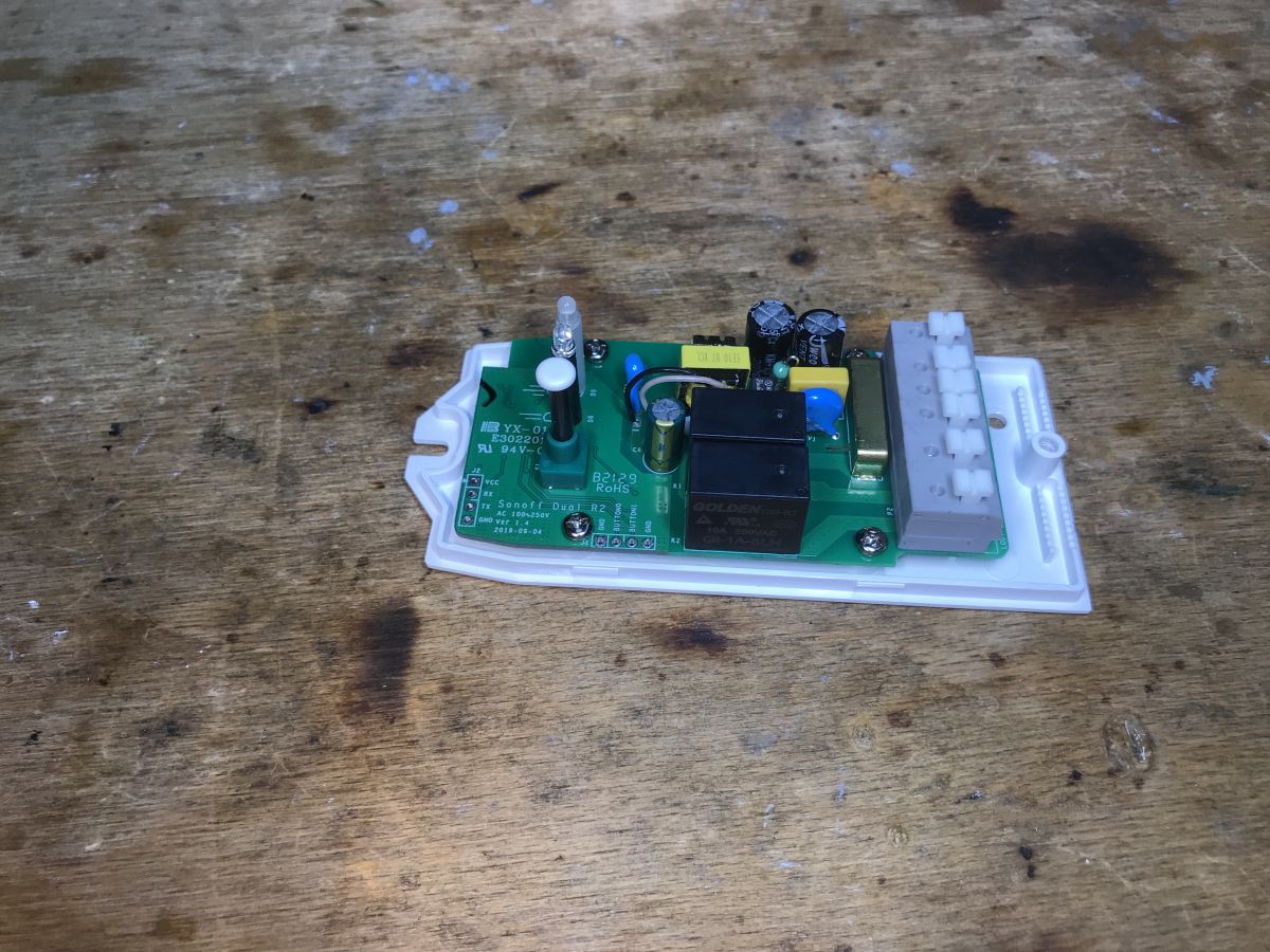

    Sonoff Basic ZBR3, the famous Zigbee version of the relay. Interior, diagram
    Second photo:
    Close-up of the WS-05H1 device PCB showing electronic components.

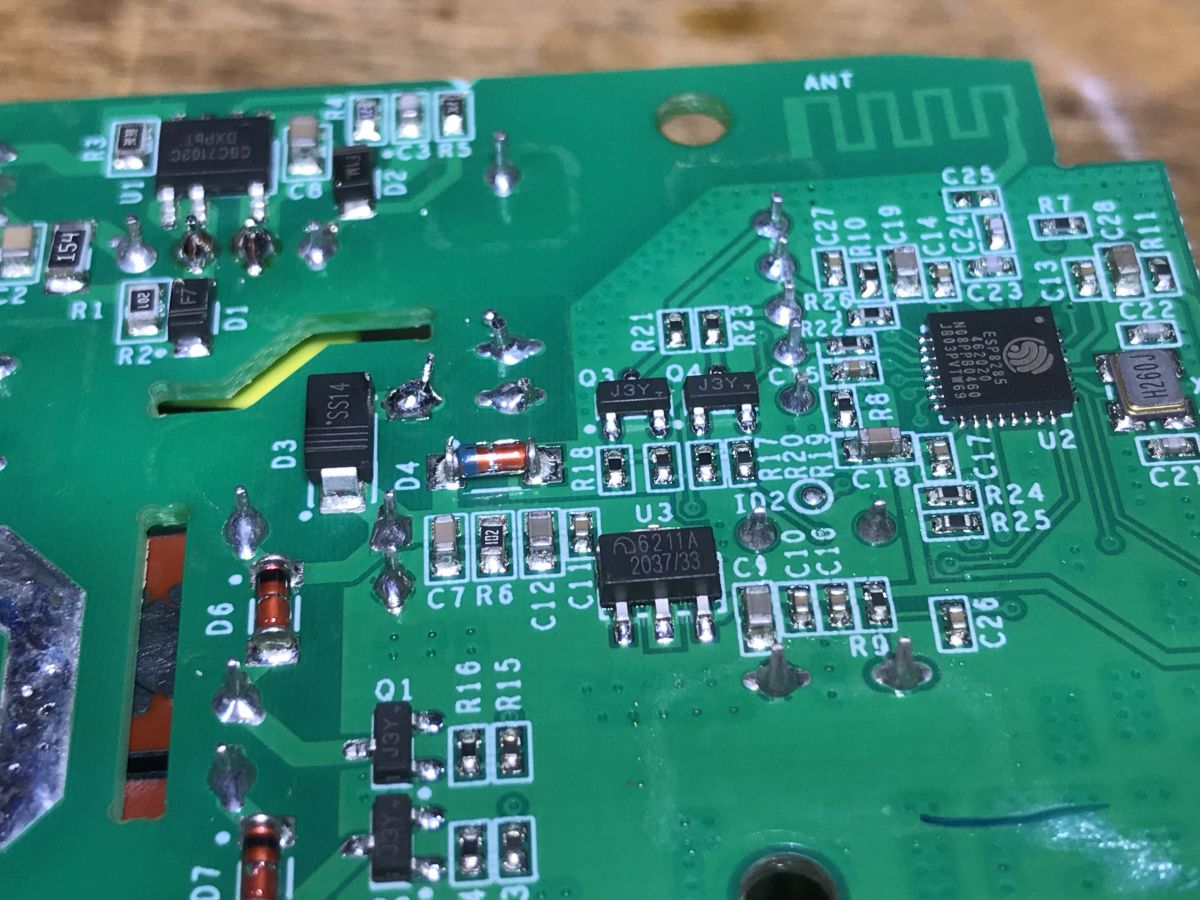

    Still standard, J3Y transistors controlling the relays with protection diodes:
    Close-up of the bottom of a circuit board with electronic components. Close-up of WS-05H1 circuit board with visible electronic components

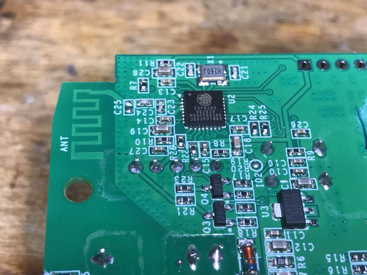

    A little further you can see LDO 3.3V and ESP, this time on the PCB:
    Close-up of a circuit board with an ESP8285 chip and several electronic components. PCB with ESP8285 and electronic circuits. Close-up of the PCB with electronic components of the WS-05H1.
    There is no external Flash chip here because it is ESP8285, i.e. with built-in memory.

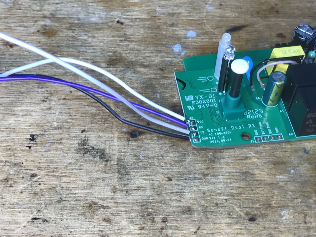

    Firmware change

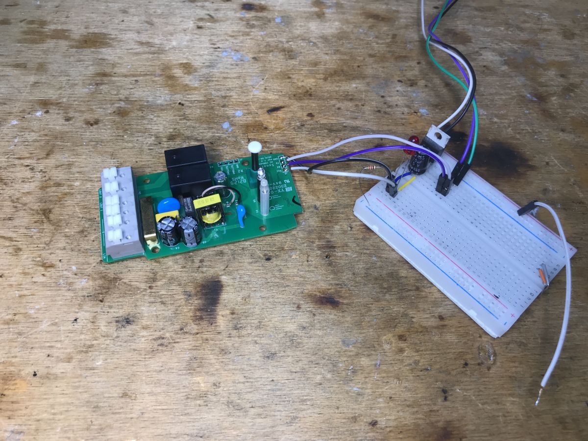

    As in the topic about the light switch:
    SmartLife switch - test, interior and programming of a WiFi light switch

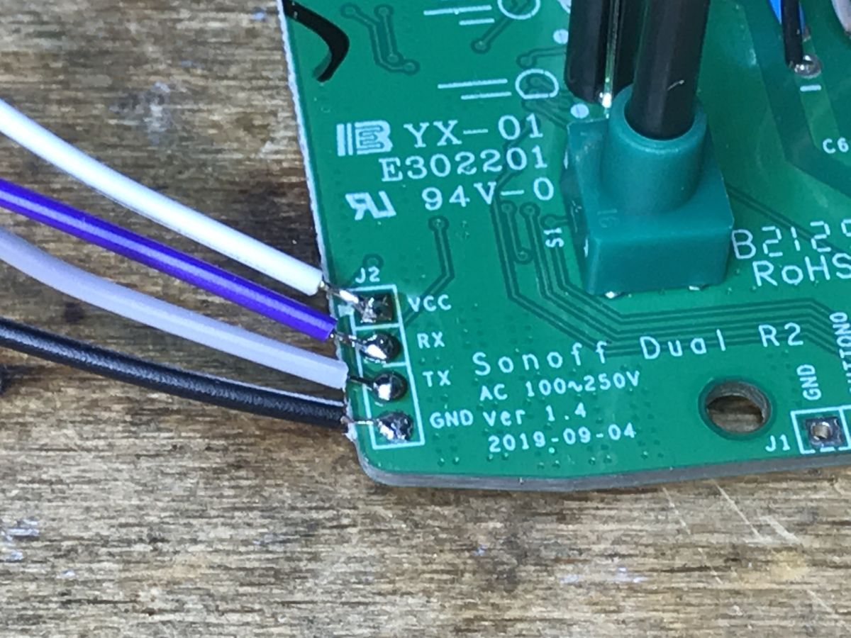

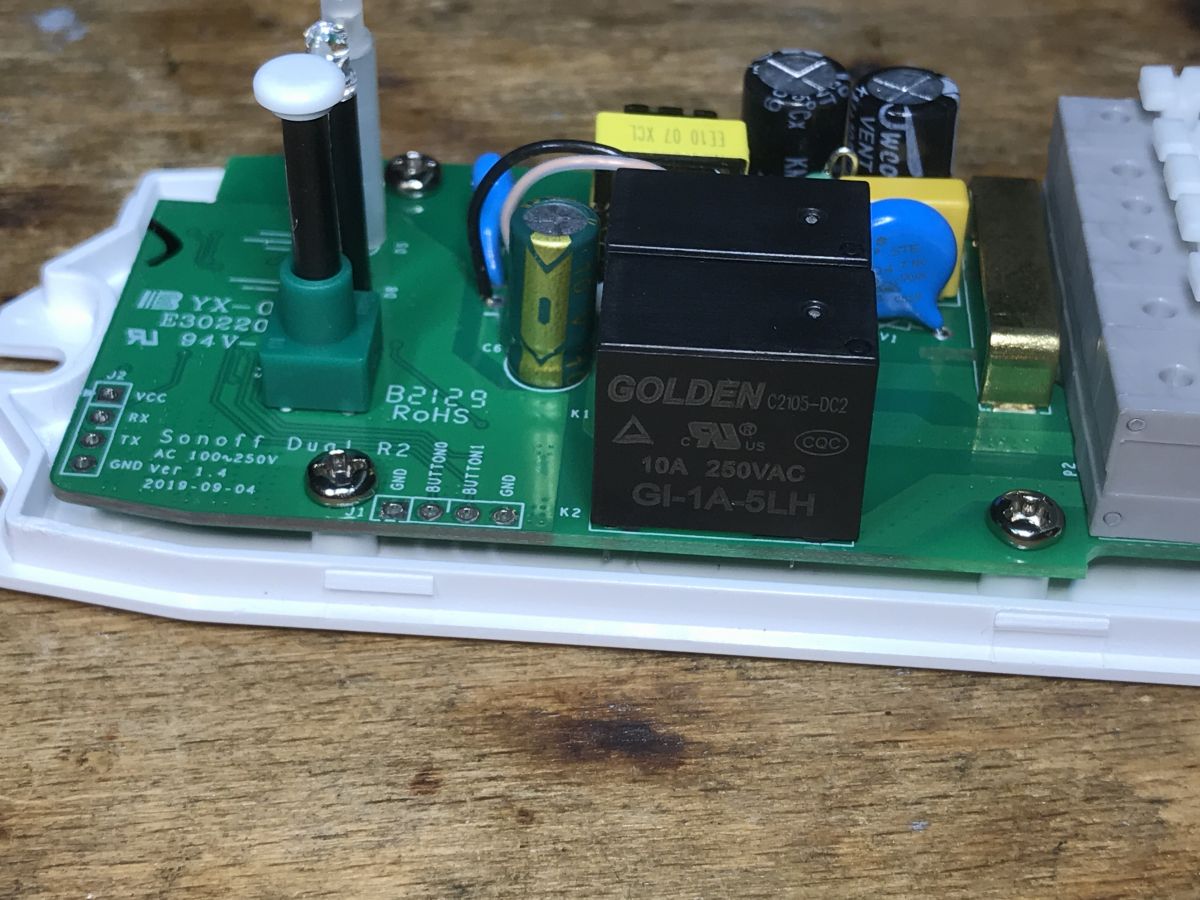

    We solder the cables:
    Close-up of a Sonoff Dual R2 circuit board with visible soldering points and wires. Close-up of Sonoff Dual R2 circuit board with visible connectors. Sonoff Dual R2 circuit board with connected wires.

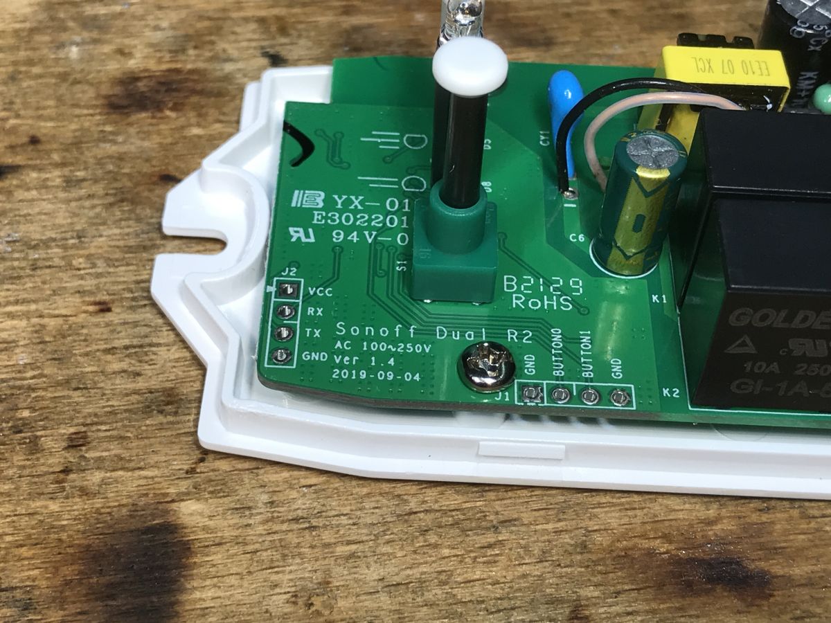

    And now note - we need GPIO0 to enter the bootloader mode, but it is output to Button0:
    Electronics and breadboard on a wooden table Close-up of Sonoff Dual R2 PCB with connected wires on a breadboard.
    And that's it - here's the list of GPIO roles:
    Pin	Function
    GPIO10	Push Button
    GPIO00	Pin "button 0" on expansion header
    GPIO09	Pin "button 1" on expansion header
    GPIO12	Relay #1 and red color on LED
    GPIO05	Relay #2 and green color on LED
    GPIO13	Blue Status LED

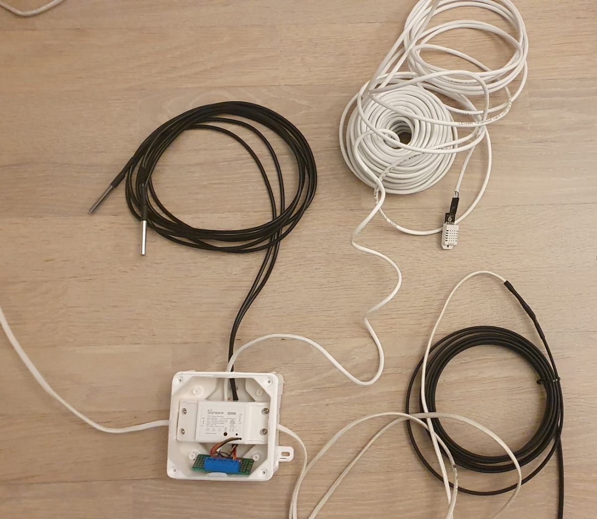

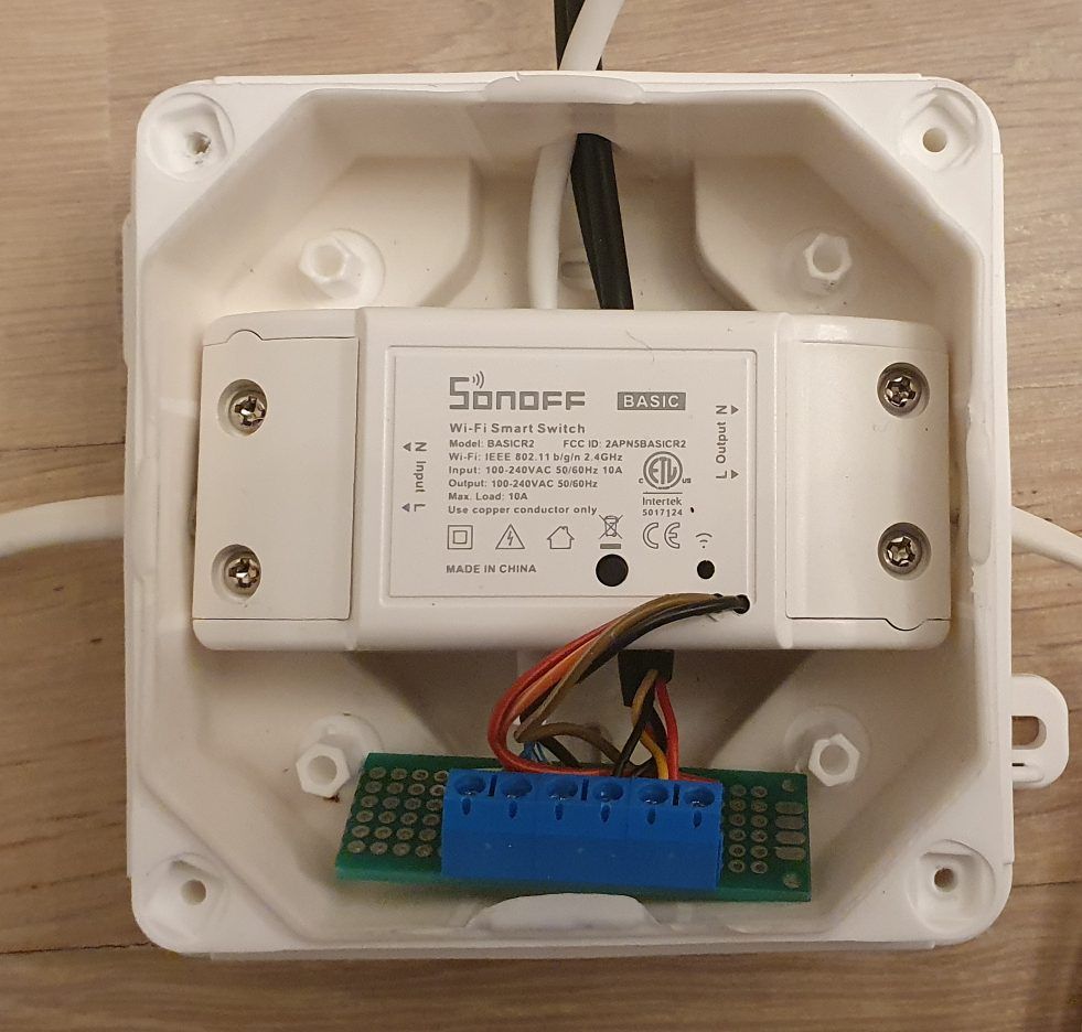

    Sonoff, both Basic and Dual, are great platforms for your own DIY - we have: ESP, power supply, relay and housing. When doing it from scratch, we have to take care of all these components separately. Basic is very small and it is difficult to safely embed cables in it. Additionally, it has terminals on opposite sides, which is not always convenient. Dual has a much larger housing and decent cable attachment. The pins are on one side, which is an advantage for me. I have just finished another project - antifreeze heating of the water installation based on a heating cable along with temperature and humidity monitoring in a newly constructed building. Below are some photos:
    Components of a DIY system with Sonoff Basic and sensor cables.
    Sonoff Basic with attached circuit board in a white enclosure.
    As you can see, Sonoff (Basic here) is perfect for DIY. The program written in Arduino works as a thermostat and additionally sends information about the temperature of the valve (under the insulation) and the temperature outside the insulation (temperature of the garage, because the water installation is there). DS18B20 were used for this purpose. An additional DHT22 sensor measures temperature and humidity and allows you to monitor the drying of plasters. This sensor is on a very long cable - it can be moved to any room. In addition to temperature and humidity data, the operating time of the heating cable is also sent. To connect all this, the RX and TX pins acting as regular I/O were enough.
  • Goldpin headers preferred over direct pad wiring

    Well, look, recently I was looking for Sonoff Dual R2 on Aliexpress and Allegro and I was surprised that they are no longer available, as if they stopped producing them and switched to double cup modules. Meanwhile, you can still buy these modules under a different name. What surprised me the most was that even on PCB they didn't want to change the description and Sonoff continues to write there :-)
    Yes, by the way - no offense, but soldering the cables directly to the pads instead of soldering the goldpin connector is asking for vengeance to heaven ;p I have various modules in stock, for the future (when the need arises, I program it for a specific task) and the first thing I do when the delivery arrives (because I always buy 5-10 pieces), I solder the goldpin in all of them so that I can quickly program or reprogram the module in the future. Yes, sometimes it is possible to perform further programming OTA, but out of habit I prefer (and sometimes need to) connect the USB-to-serial port adapter and do it using the traditional method.
    In my case, I program all modules with our Polish SUPLA :-)

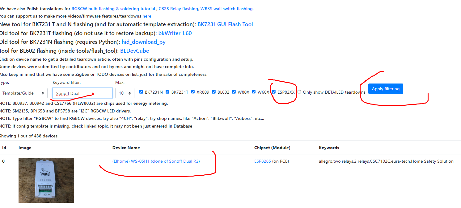

    Our electrode list of interior IoT devices was created to share such information. If you type Sonoff there, WS-05H1 pops up:
    Screenshot showing an IoT devices list filtering Sonoff Dual.
