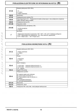

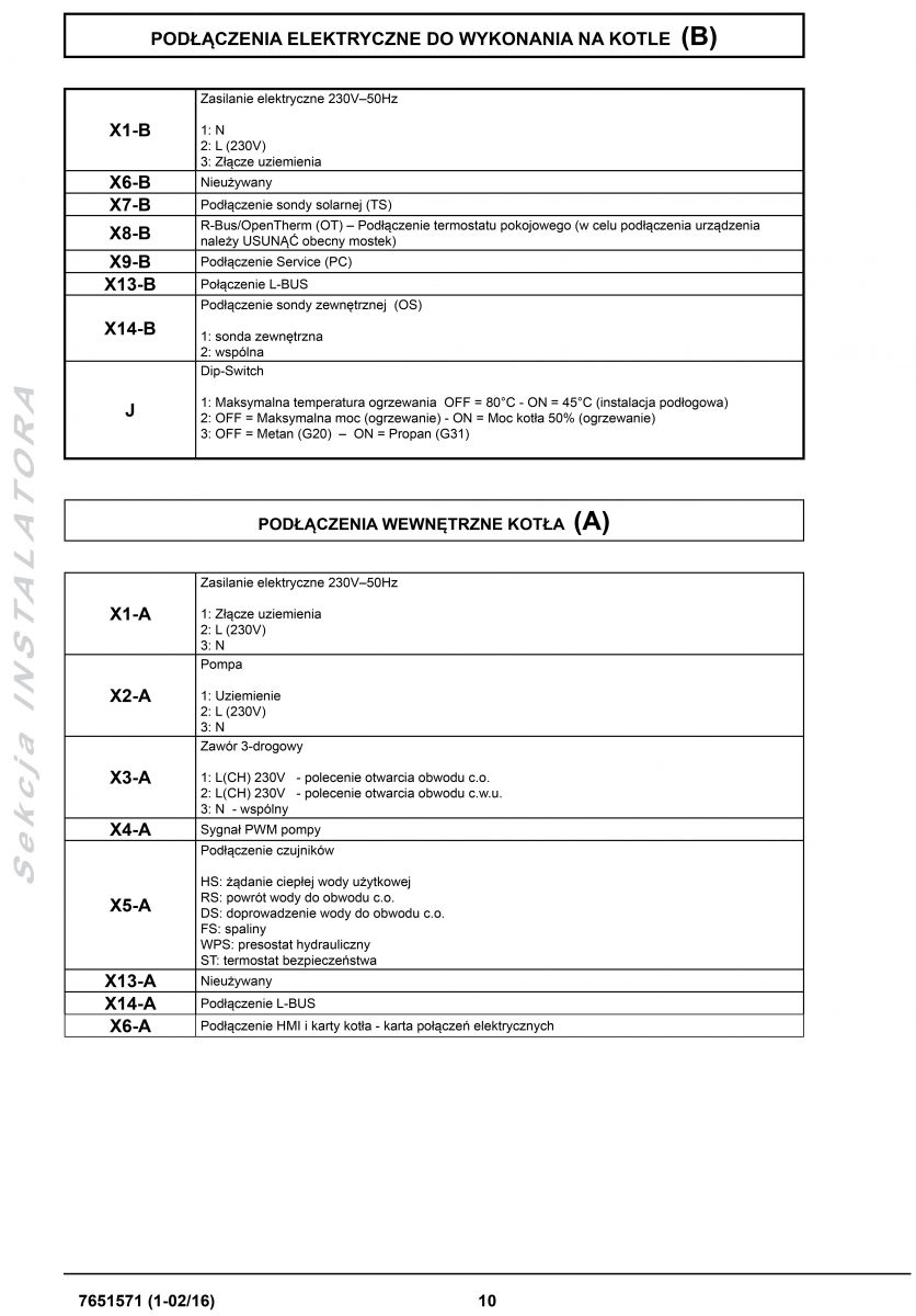

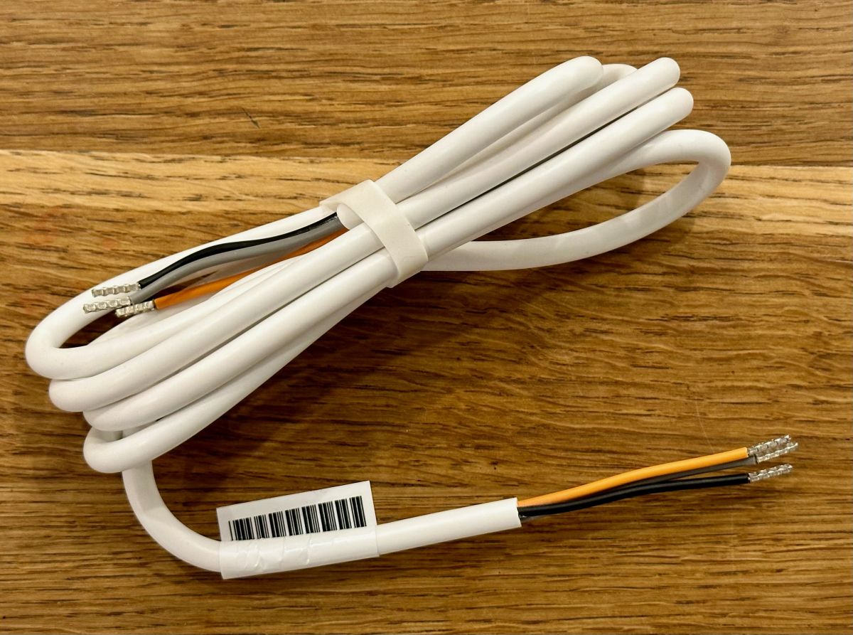

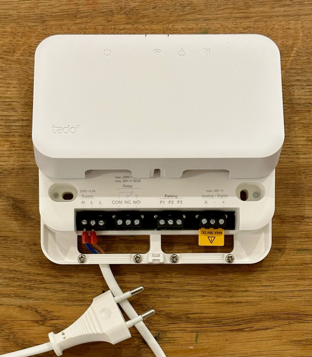

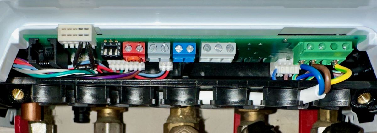

    Good day,
    I have a De Dietrich MCR HOME 24/28 MI furnace and would like to connect a Tado Wireless Receiver/Controller V3+ to it.
    Today I do not have connected, any controller to operate the furnace.
    I have underfloor heating with 6 sections and 5 radiators.
    The bridge, heads and indoor thermostat in the living room are already active.
    Could someone please suggest how to connect the controller to this furnace correctly and how to configure this to work properly.
    After adding it to the Tado system, an additional tile for hot water control appeared to me for the moment.
    I have selected the MCR Home boiler from the list and sent an enquiry to technical support, I have also indicated that I have underfloor heating.
    Thank you very much in advance for your help.
