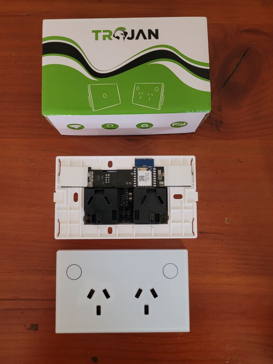

  • A Shawader Tuya-based Smart WiFi Wall Socket using a BK7231N [CB3S] board gets torn down as an Au-type generic Tuya 2 Gang GPO.
  • The unit flashes directly with a jig, and mapping P6 and P24 as Btn inputs restores the blue off LEDs.
  • The Tuya app reported module version V1.1.15, and the suggested OpenBeken pinout uses P8 for WifiLED_n, P14/P26 for relays, and P6/P7/P9/P24 for buttons.
  • OpenBeken shows power monitoring, but it only ever displays zero, so the author suspects there is no BL0942.

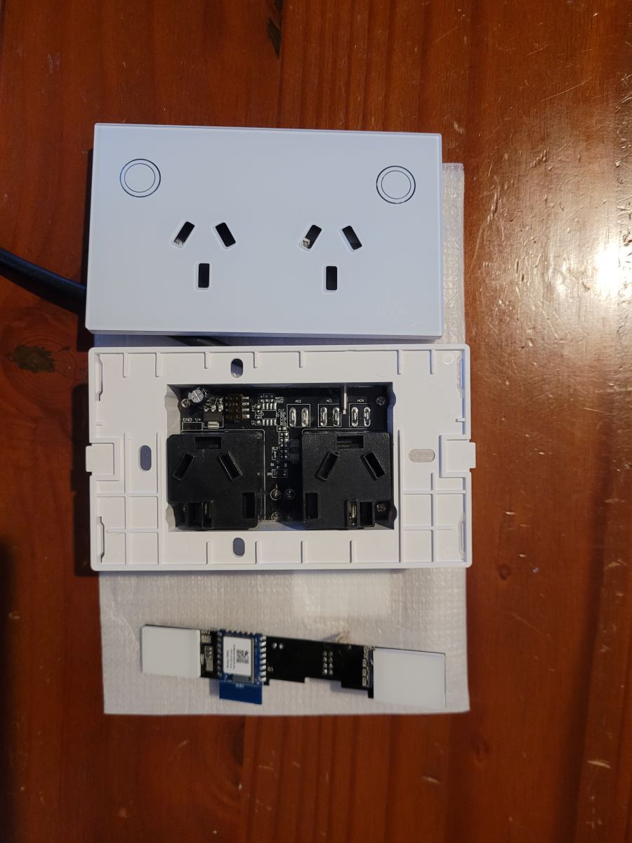

  • This is a short teardown of Au type Generic Tuya 2 Gang GPO
    Basic information:
    Brand: Shawader (Tuya based)
    Model: Smart WiFi Wall Socket
    Chip: BK7231N [CB3S]
    Local Vendor: https://shawader.aliexpress.com/store/4884178
    These switches look a lot like Makegood GPOs

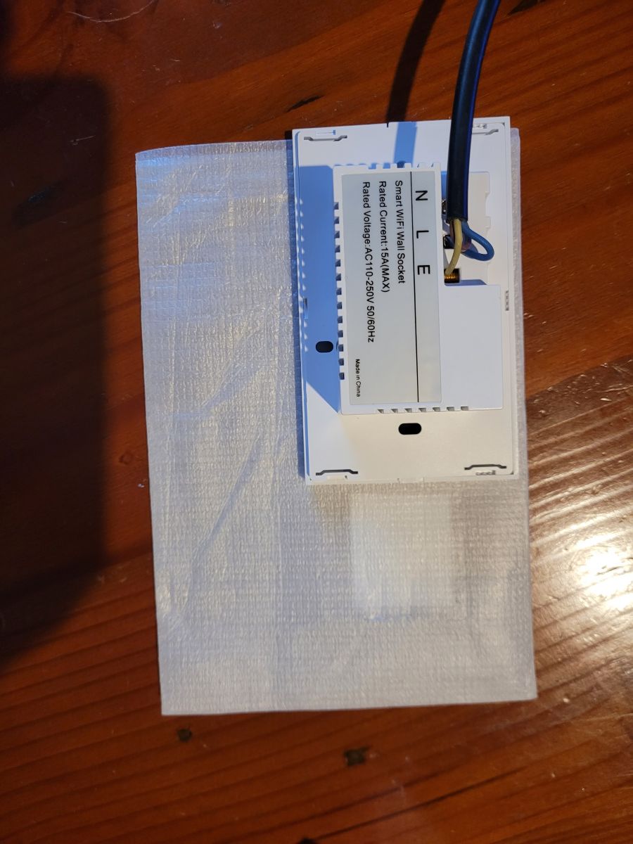

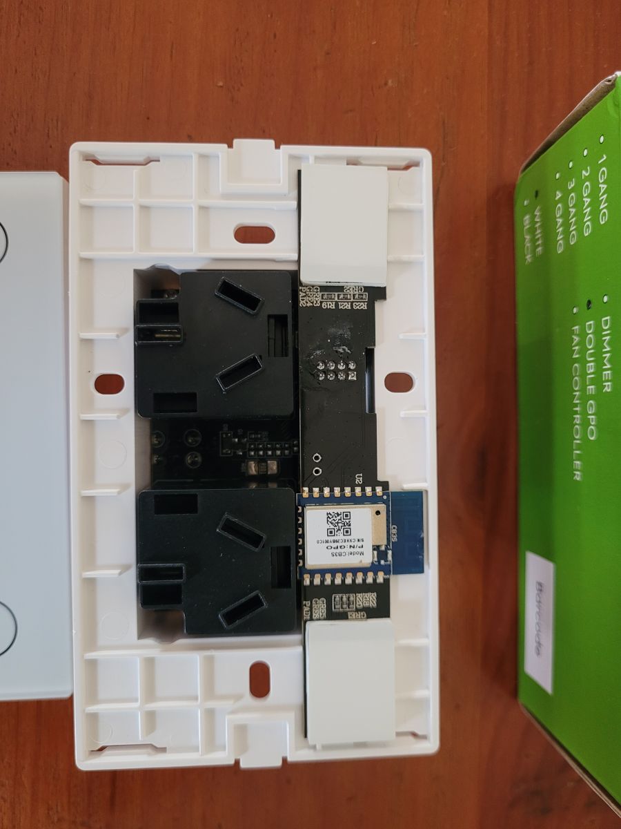

    Front and internal parts of a Wi-Fi smart wall socket Au 2 Gang type. Interior view of Shawader smart Wi-Fi wall socket.
    Rear view of a smart Wi-Fi wall socket with N, L, E labels. Packaging of Shawader Smart WiFi Wall Socket.
    Main Module version in the Tuya app was V1.1.15 (I couldn't find a match in Tuya-Cloudcutter).

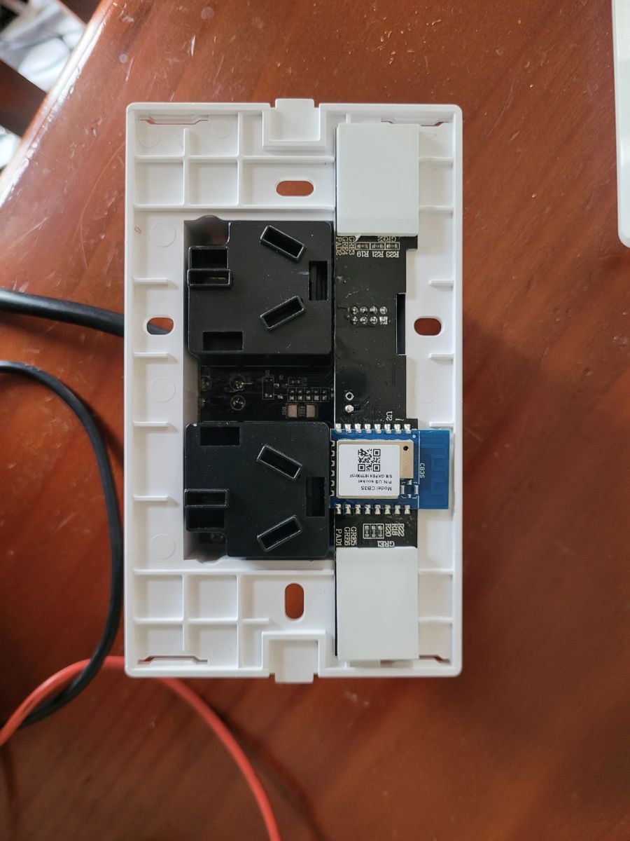

    However, these can be flashed directly fairly easily. I used a jig so I didn't need to solder anything.
    This is the Au GPO but I would think the EU and US ones would be similar.
    The OpenBeken firmware shows power monitoring but I am not sure if that is correct or actually works. It only ever shows zero. I do not think it has a BL0942.
    This is what worked for me, I found the Blue Off LEDs did not come on after flashing only the Red On LEDs. However, by adding Btn to P6 and P24 then the Blue Off LEDs returned. So if you do not want Blue LEDs for Off leave P6 and P24 blank.
    Pinout for Au 2 Gang GPO:
    P6 Btn 2*
    P7 Btn 2
    P8 WifiLED_n
    P9 Btn 1
    P14 Rel 2
    P24 Btn 1*
    P26 Rel 1

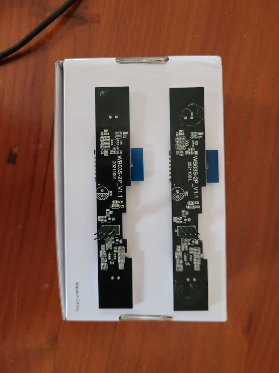

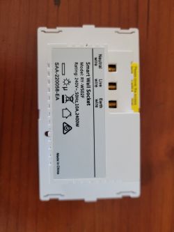

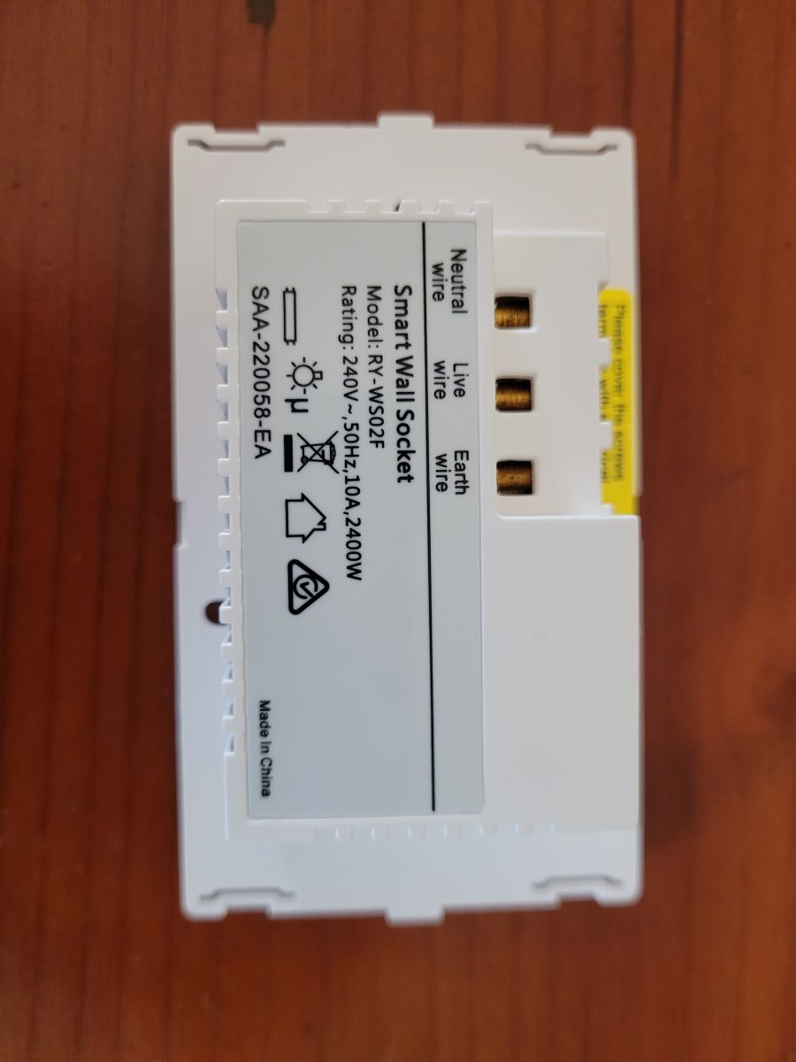

    Update on this Shawader Smart WiFi Wall Socket
    The above Shawader Smart Switch is actually imported into Australia under the name of Trojan.
    Model No: RY-WS02F
    Au Cert is SAA-2200058-EA
    The only difference is the switch plate has a single ring for on/off rather than double. Everything else is identical and all parts are interchangeable.
    In the below image the Shawader PCB (with less glue marks) is below the Trojan one.
    View of Shawader Smart WiFi switch PCB and packaging with Trojan logo. PCB of Shawader smart socket located under Trojan board.
    Shawader Smart Wall Socket module with electrical markings and certification. Two black PCBs lying on a white background, differing only in the amount of adhesive traces.
