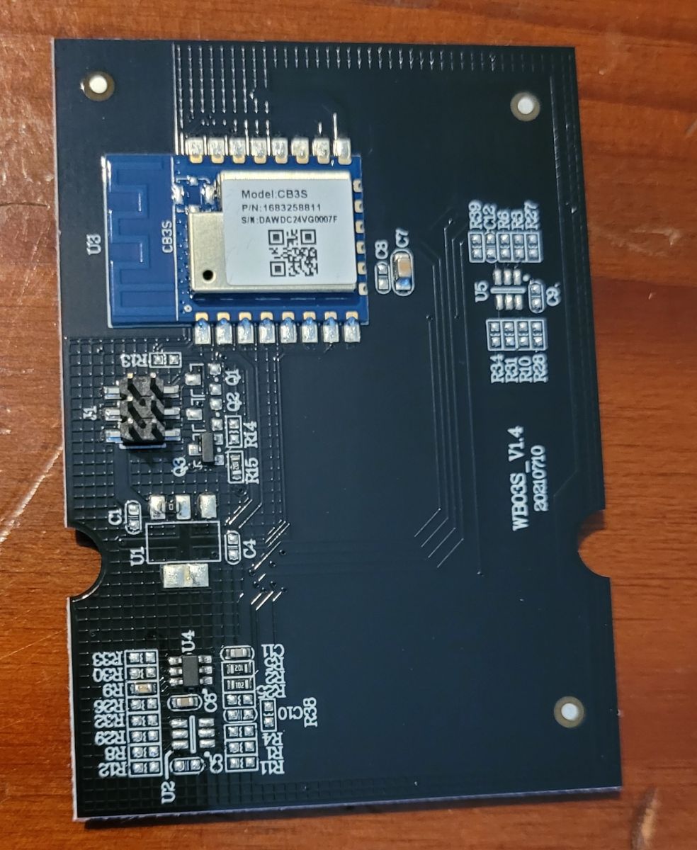

  • Generic Tuya US-style touch wall switch with neutral and matching dimmer uses a Shawader Tuya-based CB3S module with BK7231N.
  • Tuya-Cloudcutter flashed it by firmware version and name, using the V1.1.0 dctrl switch and V2.1.6 common user config ty profiles.
  • The 1-gang switch pinout is P10 Btn, P11 LED_n, and P26 Rel, while the dimmer autoexec sets TuyaMCU channel 2 as a dimmer with range 2-1000.
  • OpenBeken-v1.17.130_bk7231n.ug.bin worked, but WIFILED_n made the off-blue indicator too dark, so LED_n was preferred; 2-4 gang versions are only assumed similar.

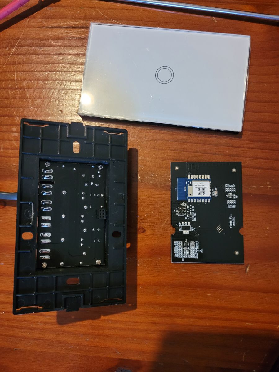

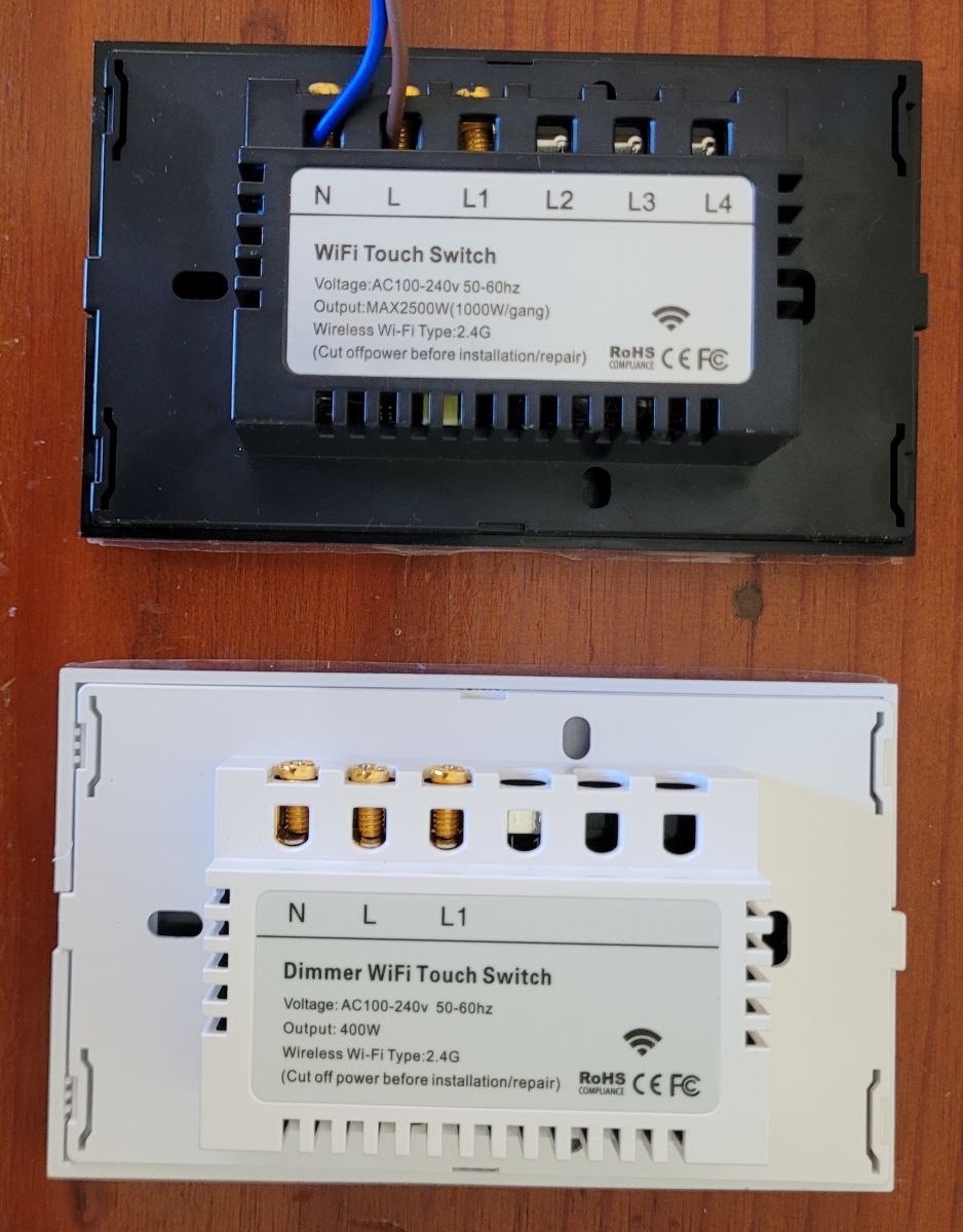

  • This is a short teardown of US type Generic Tuya Touch Wall Switch (With Neutral) with CB3S module.
    Basic information:
    Brand: Shawader (Tuya based)
    Model: WiFi Touch Switch & Dimmer WiFi Touch Switch

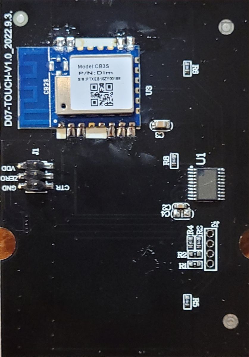

    Chip: BK7231N [CB3S]
    Local Vendor: https://shawader.aliexpress.com/store/4884178

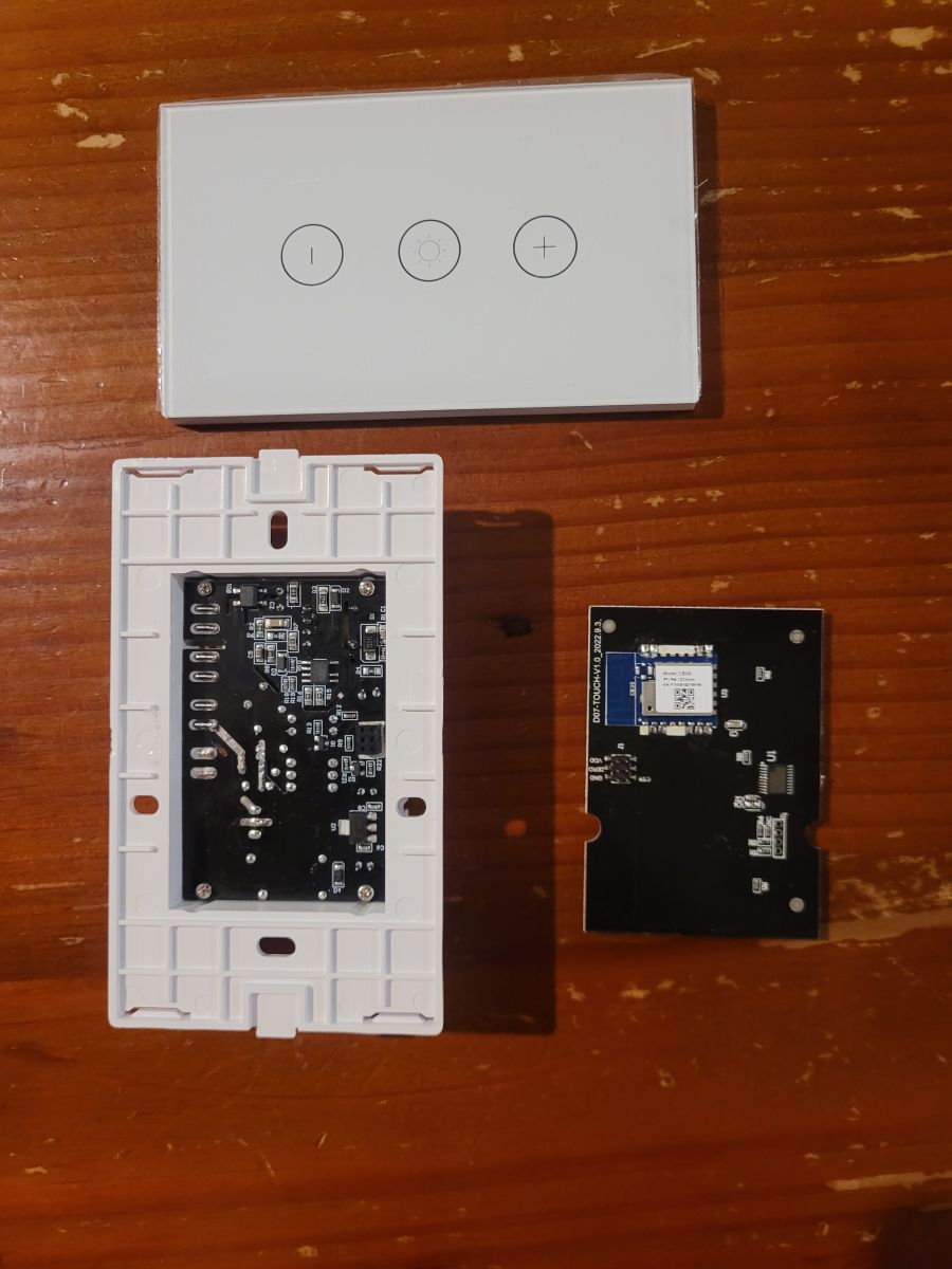

    Dismantled Shawader touch wall switch with CB3S module. CB3S module on a circuit board. Packaging of Shawader touch switch.
    Dismantling of Tuya touch switch with CB3S module. CB3S module embedded on a circuit board of the D07-TOUCH-V1.0_2022.9.3 touch switch. Two WiFi touch switches showing connection schematics.

    Main Module version in the Tuya app was V1.1.0 on the switch and V2.1.6 on the Dimmer.
    These can be flashed with Tuya-Cloudcutter.
    I used the option 2 > By firmware version and name.
    There is a V1.1.0 'dctrl switch' and V2.1.6 'common user config ty' file that both flashed fine.
    I think from memory they both flashed OpenBeken-v1.17.130_bk7231n.ug.bin
    This is only the one gang version but I would assume the 2,3,4 would be similar.
    This is what worked for me, I found with the switch that if I used WIFILED_n then the off blue was too dark so used LED_n instead the wifi led is under the cover anyway so you cant see it.
    Pinout for 1 gang switch:
    P10 Btn
    P11 LED_n
    P26 Rel
