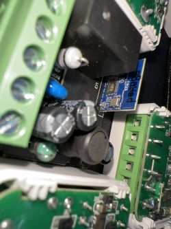

    4 variants in total:
    First one:
    Patched firmware 1.3.10 (Tuya-Cloudcutter won't work)
    [BK7231N/CB2S] Comparison of multiple smart switch modules, differences on PCB, patched firmware [BK7231N/CB2S] Comparison of multiple smart switch modules, differences on PCB, patched firmware [BK7231N/CB2S] Comparison of multiple smart switch modules, differences on PCB, patched firmware
    - Pair/Toggle All Pin on P8
    - WiFi LED on P6
    - TglChannelToggle (channel 1) on P14
    - Relay (channel 1) on P15
    Device seems to be using CBU module, which is using BK7231N.
    Second one:
    Also patched firmware
    - Pair/Toggle All Pin on P23
    - WiFi LED on P26
    - TglChannelToggle (channel 1) on P6
    - Relay (channel 1) on P7
    Device seems to be using CB2S module, which is using BK7231N.

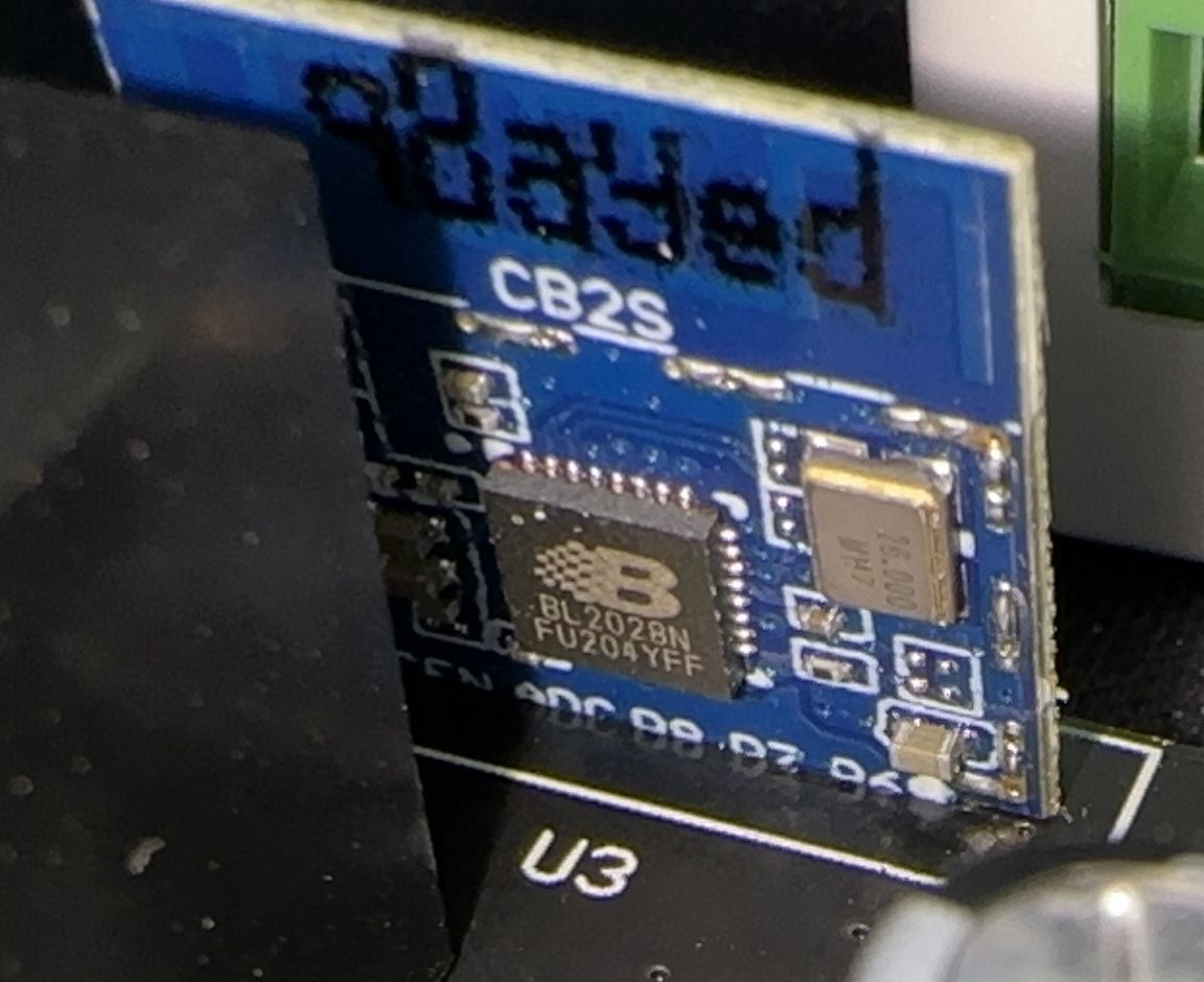

    Forth one:
    BL2028N chip. (BK7231 variant)
    Firmware 1.2.1 Tuya-cloudcutter worked yay
    UPDATE:
    I later received another one and it was patched. Be aware that RX is shorted to ground so the connection between the module and the main pcb needs to be removed. No need to desolder the entire module, just wick away the solder connection.
    - Pair/Toggle All Pin on P10
    - WiFi LED on P7
    - TglChannelToggle (channel 1) on P26
    - Relay (channel 1) on P8

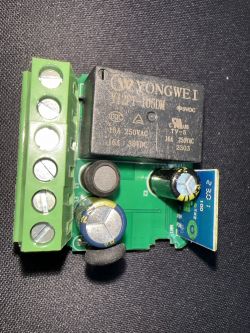

    5th one:
    This one should support power monitoring.
    Also patched firmware.
    [BK7231N/CB2S] Comparison of multiple smart switch modules, differences on PCB, patched firmware [BK7231N/CB2S] Comparison of multiple smart switch modules, differences on PCB, patched firmware [BK7231N/CB2S] Comparison of multiple smart switch modules, differences on PCB, patched firmware [BK7231N/CB2S] Comparison of multiple smart switch modules, differences on PCB, patched firmware

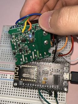

    My setup:
    I used an ESP8266 Nodemcu because I'm too cheap to buy a dedicated serial to usb. I disabled the ESP12F chip by connecting the ENABLED pin to GND
    I'm using a breadboard so I can disconnect VCC easily.
    To flash the Openbeken firmware I used BK7231GUIFlashTool. Only downside of this tool is that it doesn't work on MacOS with Mono.
    NOTES:
    Every switch I flashed with BK7231GUIFlashTool had firmware 1.3.10 and for some reason I couldn't read any firmware. Flashing worked fine tho.
    AFTER SOLDERING THE WIRES ALWAYS CHECK WITH A MULTIMETER THAT THEY ARE NOT BRIDGED OR MAGIC SMOKE MAY COME OUT.

  • #24 20589187
    erlipan2001
    Posts: 29
    >>20588900
    Yours looks like this?
    I received my last package and I found one of these. They claim power monitoring and based on the presence of the big 1 ohm resistor it should be true. Petty good deal for 1.79$...
    It's not hard to solder the wires to it but be aware I think they shorted rx to ground so you will have to remove the connection between the module and the main PCB or flashing will fail.
    Added after 18 [minutes]:
    Anyway.
    I received all the packages.
    To sum it up:
    x20 16A smart switch
    x7 variant 2
    x6 variant 1
    x3 variant 3
    x2 variant 4
    x1 variant 5 (power monitoring)
    x1 Trash (Non hackable)
    Considering one is unusable I spent on average 1,88$ for each. Not bad.
