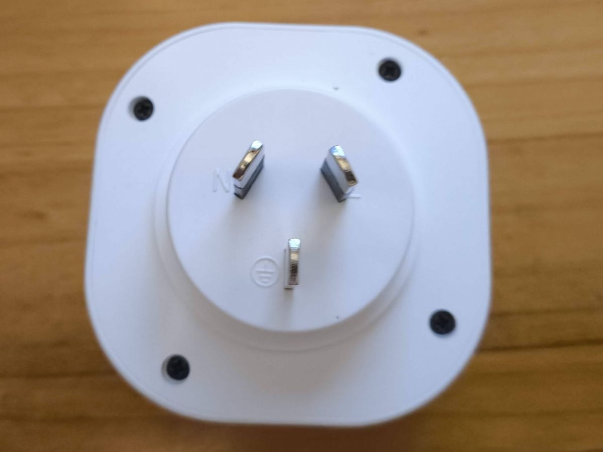

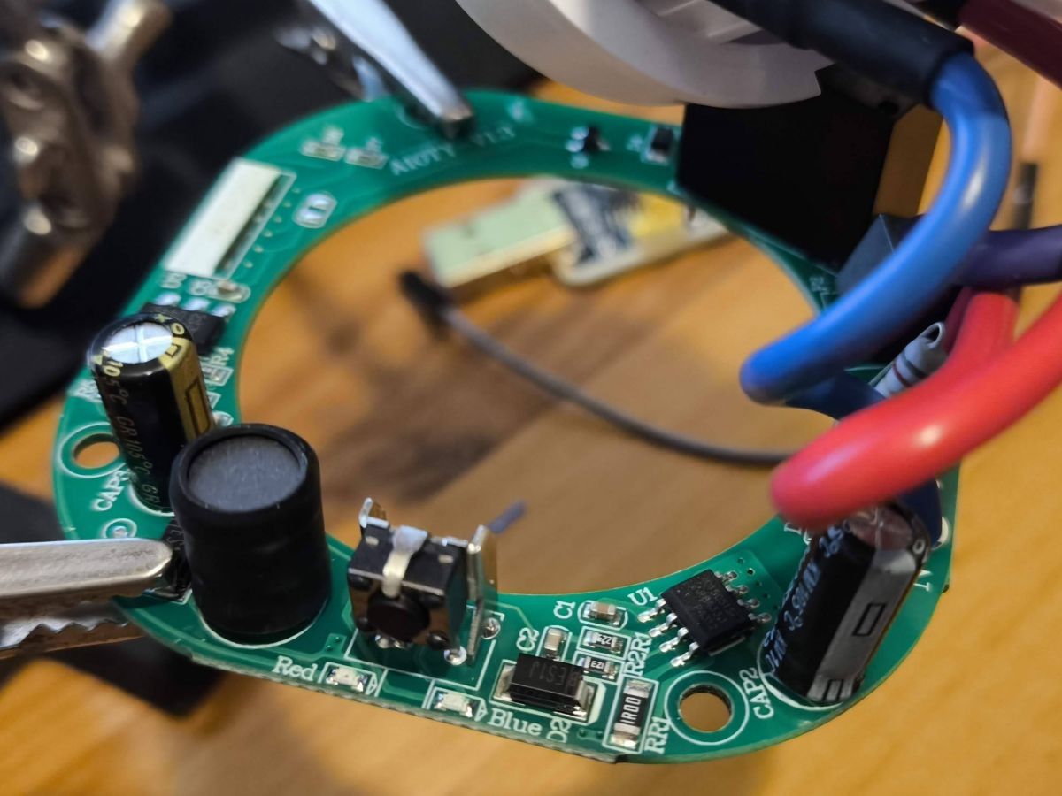

    This is a teardown for my "Smart Plug WiFi Socket". It's an Australian plug which means the variants are not many, this was the only one I could find that had RCM - the compliance mark for australia. I de-soldered CB2S module and spent about 4 hours trying to get it going from initial opening the packet to finishing up this post.

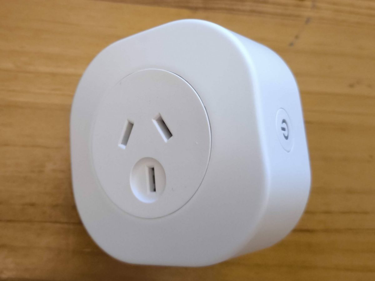

    Which is not the same thing, you can see the button is on the side not the top (different listing photos show it in different places) and the magical RCM version has two relays so proudly displayed in the photos whereas the one i received has only one relay.
    White cube-shaped electrical plug on a wooden surface.
    Top view of a three-pin electrical plug adapter.

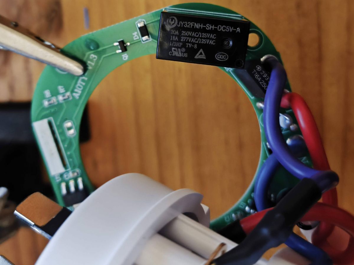

    Printed circuit board with attached wires and an electronic component.
    Close-up of a circular circuit board with various electronic components, including capacitors and wires.
    Electronic circuit with wires on a desk.

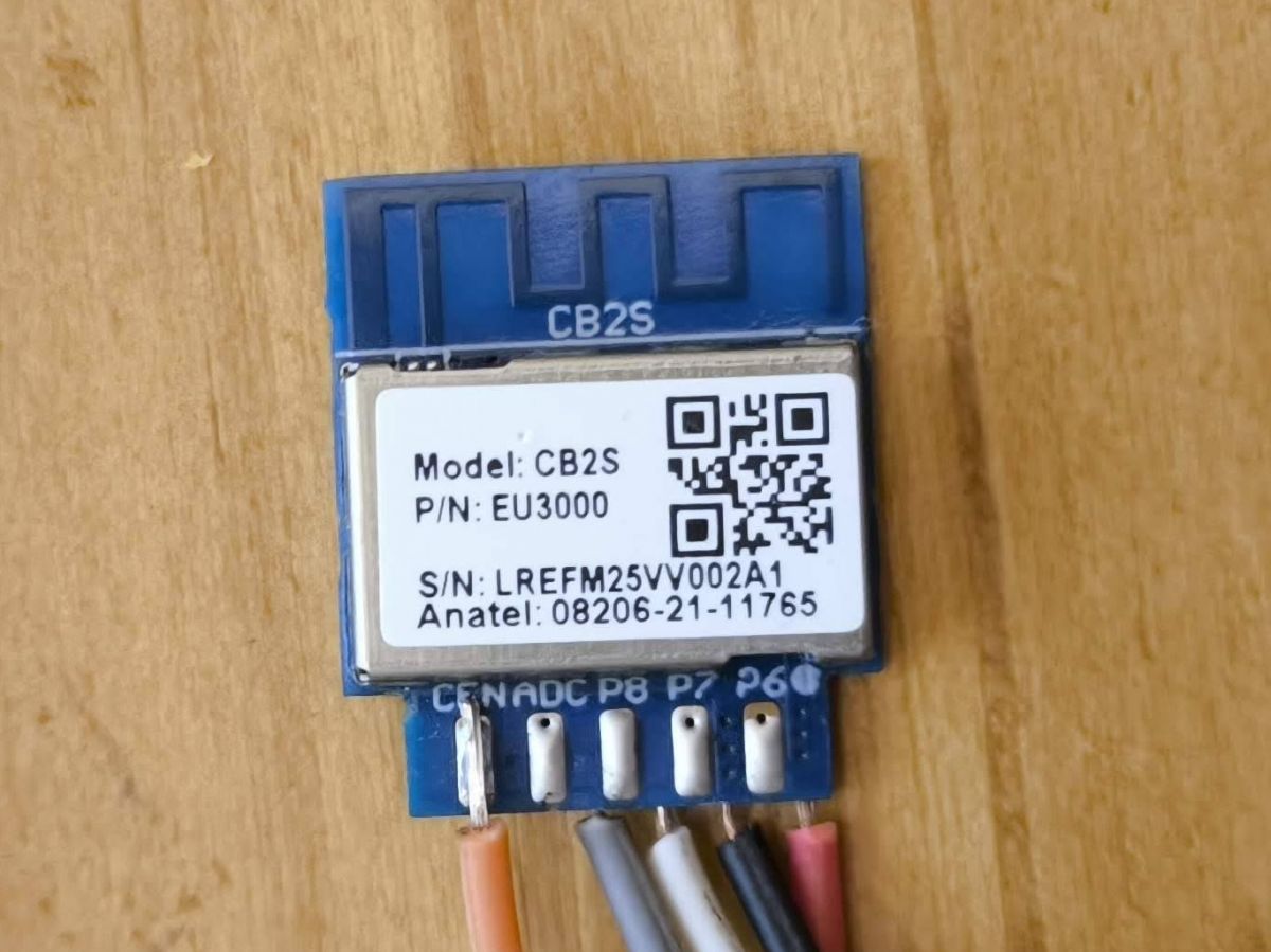

    As you can see it's a very basic plug, simple on/off with no current shunt despite the inflated price tag due to the alleged safety compliance. Aaaand here's the CB2S problem child with the cloud addiction.
    CB2S electronic module with label and QR code.
    Of course I had no idea what I was doing and was simply blindly following the Elektroda com YouTube videos, easy enough to get the board out with my hot air re-flow station. When putting it back in I definitely recommend just scraping most of the excess solder off the pads before shoving it back in there or you'll be lifting pads.

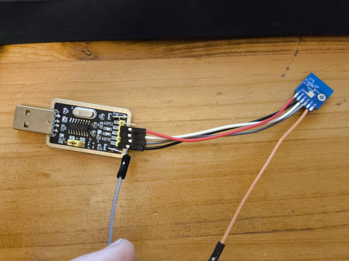

    USB to serial converter connected to a module with wires.

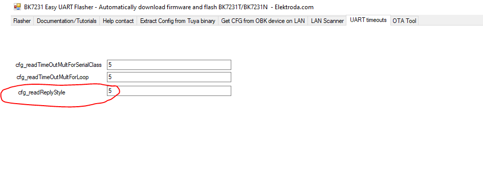

    Once I had it all wired up I started bashing my head against the excellent BK7231 Easy UART Flasher, I had no idea what chippy was under the metal can so I just tried reading each chip type, (of course if I had bothered to read the note next to the select chip type drop down this would have saved me some time) no luck from K, N gave me some more output - encryption key but as soon as it started reading it would hang.
    I started thrashing as usual and by complete chance found this post. which saved the day.
    https://github.com/openshwprojects/BK7231GUIFlashTool/issues/18
    Screenshot of BK7231 Easy UART Flasher program with timeout settings.
    Bingo, It read out the memory so I flashed the OpenBK7231N Firmware and off she went. Then I had a look in the "change OBK settings for flash write" and added in the wifi ssid and password like a sane person and re-wrote the config and used pingtools on my phone to find the device IP.

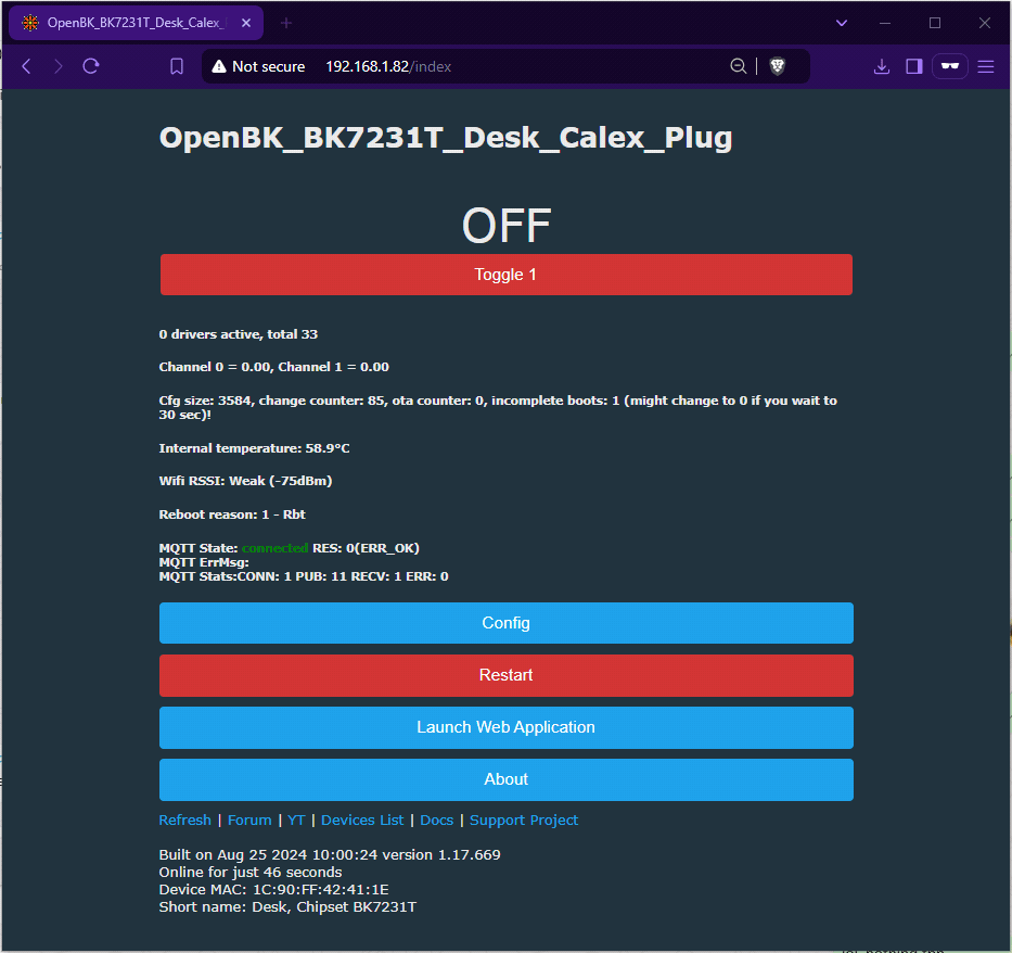

    interesting circular PCB.

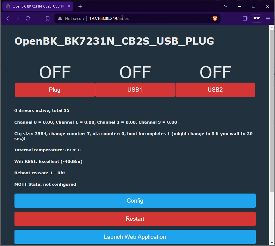

    Please post your OBK template
    Screenshot of the OpenBK BK7231T Desk Calex Plug web interface showing device status information and configuration options.
    and /or post your Tuya config file after extraction
    OpenBK user interface showing USB device statuses.
