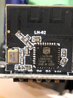

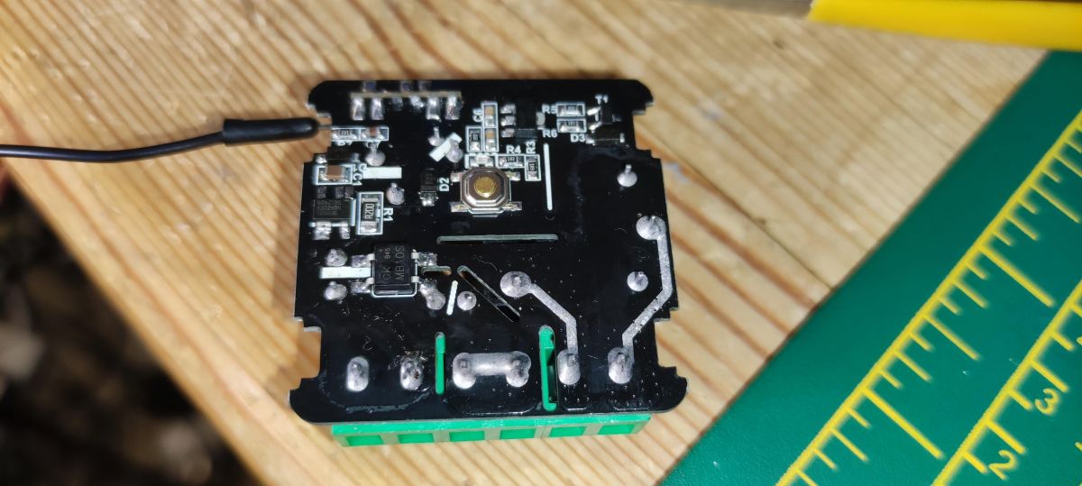

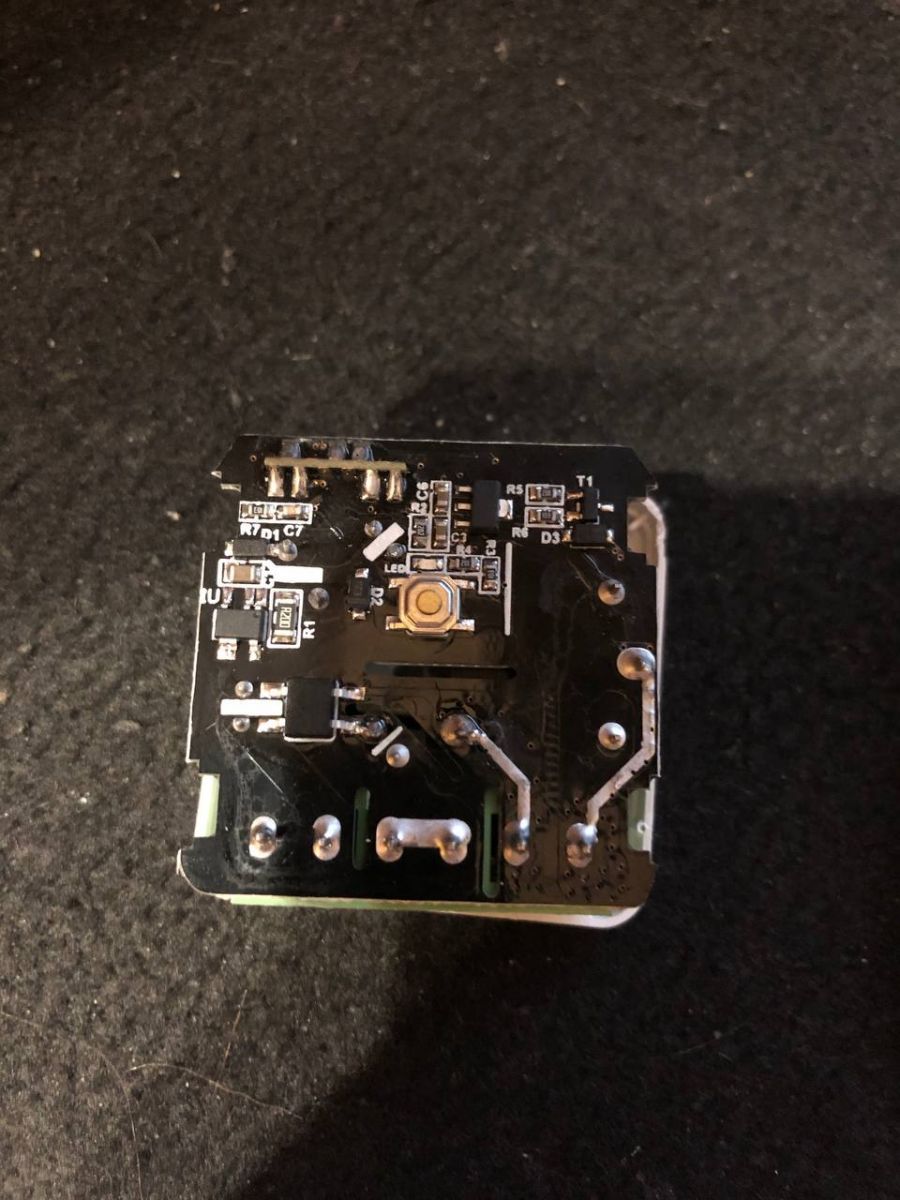

    I got a relay on an unknown chip, maybe someone knows what kind of chip it is? Electronic circuit with visible components on a circuit board. Close-up of a circuit board with a chip labeled LN82XHKI.

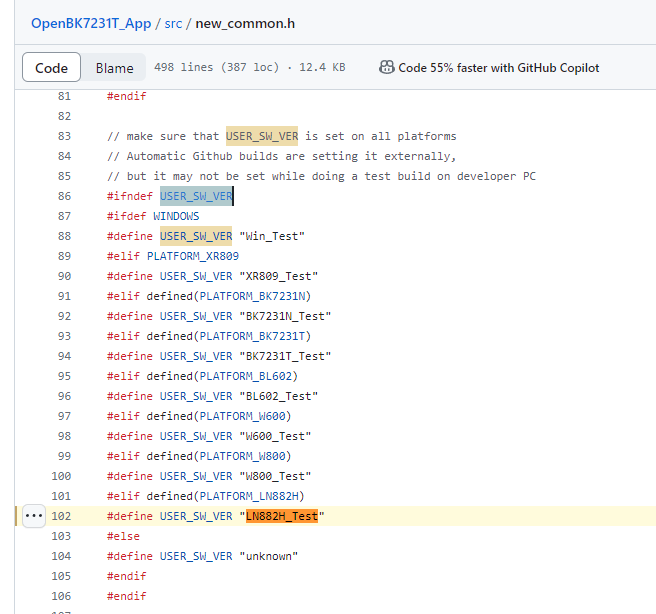

    Maybe it's possible, there is some SDK:
    https://github.com/lightningsemi/ln882h
    Can you check whether the flash tool is also present there? Is the flash tool able to read and write the device flash via UART?

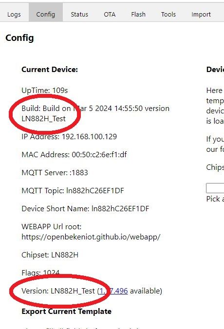

    Can I somehow help with development?
  • #6 20820592
    Posts: 14795
    Rate: 12944
    Hello, are you referring to OBK development in general or to LN882H?
    You can try to test the LN882H flash tool, you can try porting OBK to this platform (I can tell you how, if you're interested), you can also make a donation: https://paypal.me/openshwprojects

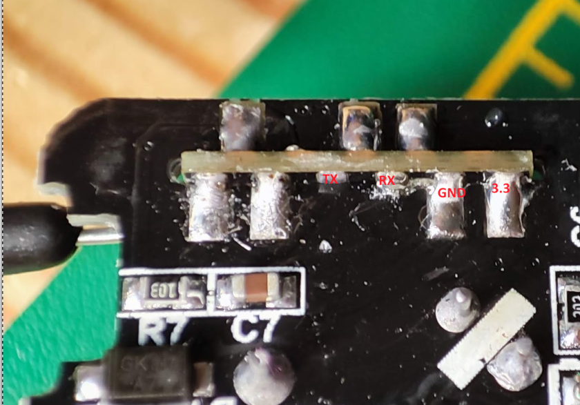

  • UART reveals CozyLife LN882H firmware boot log
    #7 20839581
    protectivedad
    Posts: 40

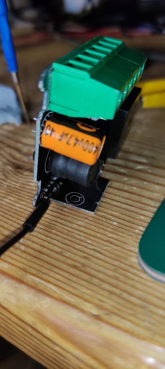

    I hooked up the uart and it keeps repeating:
    ------  wifi_mcu_basic_example  ------
    While I was connecting the 3.3v lead it started up the CozyLife code:
    TCP/IP initialized.
    LN882H SDK Ver: 1.8 [build time:Sep  9 2023 08:53:42][0x010800ff]
        ____               _     _  __
       / ___|___ _____   _| |   (_)/ _| ___
      | |   / _ \_  / | | | |   | | |_ / _ \
      | |__| (_) / /| |_| | |___| |  _|  __/
       \____\___/___|\__, |_____|_|_|  \___|
                     |___/
    cozylife_app_info
    CozyLife SDK Version: 0.6.0
    CozyLife SDK Build Sep  9 2023 08:53:37
    cozylife_app_info
    Product Id: iy9fT1
    Firmware Version: 1.0.1
    Firmware Build Sep  9 2023 08:53:44
    device id:DELETED
    1609473600 [L] [     lib_log] udplog_init on: 0, 192.168.2.2:7789
    1609473600 [L] [    lib_wifi] wifi_start_connect
    [WLIB_I]cap_comp = 0, xtal_capbank_tab:[0]:40 [1]:35 [2]:35 [3]:35 [4]:50 [5]:70 [6]:70 [7]:70
    [WLIB_I][original]phy_tab_1f:0x4C, phy_tab_20:0x3C
    [WLIB_I][efuse]phy_tab_1f:0x54, phy_tab_20:0x44
    [WLIB_I][flash]phy_tab_1f:0x54, phy_tab_20:0x44, tx_pwr_comp_all=0, tx_pwr_comp_b=0, tx_pwr_comp_gn=0
    [WLIB_I]==>temp_sect:2,phy_tab_1f:0x54,phy_tab_20:0x44
    [WLIB_I]<==temp_sect:2,phy_tab_1f:0x54,phy_tab_20:0x44
    [WLIB_I]LN882H WiFi Lib Ver(CozyLife-230526.1): 1.1.3 [build time:May 26 2023 18:45:35][0x010103ff]
    [WLIB_I]STA_Startup.
    [WLIB_I]Disconnected.
    [WLIB_E]HwEr:UKI:0
    psk value :
    00000000:  DELETED
    00000010:  DELETED
    00000020:  DELETED
    1609473601 [L] [    lib_wifi] wifi connecting to ssid: DELETED  passwd: DELETED
    STA startup!
    [WLIB_I]Status: Scan Successful. Initaiting Join:
    [WLIB_I]SSID      = DELETED
    [WLIB_I]BSSID     = DELETED
    [WLIB_I]Channel   = 3
    [WLIB_I]RSSI      = -70
    [WLIB_I]StationID = DELETED
    [WLIB_I]Status: Initiating Authentication.
    [WLIB_I]Status: Authentication Successful. Initiating Association.
    [WLIB_I]Peer's HT-Capabilities:
    [WLIB_I]ht_capable             = 1
    [WLIB_I]ldpc_cod_cap           = 0
    [WLIB_I]smps_mode              = 3
    [WLIB_I]greenfield             = 0
    [WLIB_I]short_gi_20            = 1
    [WLIB_I]short_gi_40            = 1
    [WLIB_I]rx_stbc                = 0
    [WLIB_I]max_rx_ampdu_factor    = 3
    [WLIB_I]min_mpdu_start_spacing = 6
    [WLIB_I]htc_support            = 0
    [WLIB_I]sta_amsdu_maxsize      = eff
    [WLIB_I]chan_width             = 1
    [WLIB_I]dsss_cck_40mhz         = 1
    [WLIB_I]Status: Association Successful.
    [WLIB_I]Connected.
    STA connected to target AP!
    1609473602 [L] [    lib_wifi] wifi_connect
    [WLIB_I]xtal_temp_cal.curr_sect=3,last_sect=2
    [WLIB_I]==>temp_sect:3,phy_tab_1f:0x54,phy_tab_20:0x44
    [WLIB_I]<==temp_sect:3,phy_tab_1f:0x54,phy_tab_20:0x44
    +--------------- net device info ------------+
    |netif hostname: sta                         |
    |netif ip      = DELETED
    |netif mask    = 255.255.255.0               |
    |netif gateway = DELETED
    |netif mac     : DELETED
    1609473609 [L] [    lib_wifi] wifi_get_iP
    1609473609 [L] [   lib_mainw] ip: DELETED
    [WLIB_I]xtal_temp_cal.curr_sect=2,last_sect=3
    adc raw:  792, temp_IC:   33
    Total:135436; Free:104080;
    Total:135436; Free:104168;
    adc raw:  794, temp_IC:   34
    I don't know how I got it to run and I haven't been able to do it again.

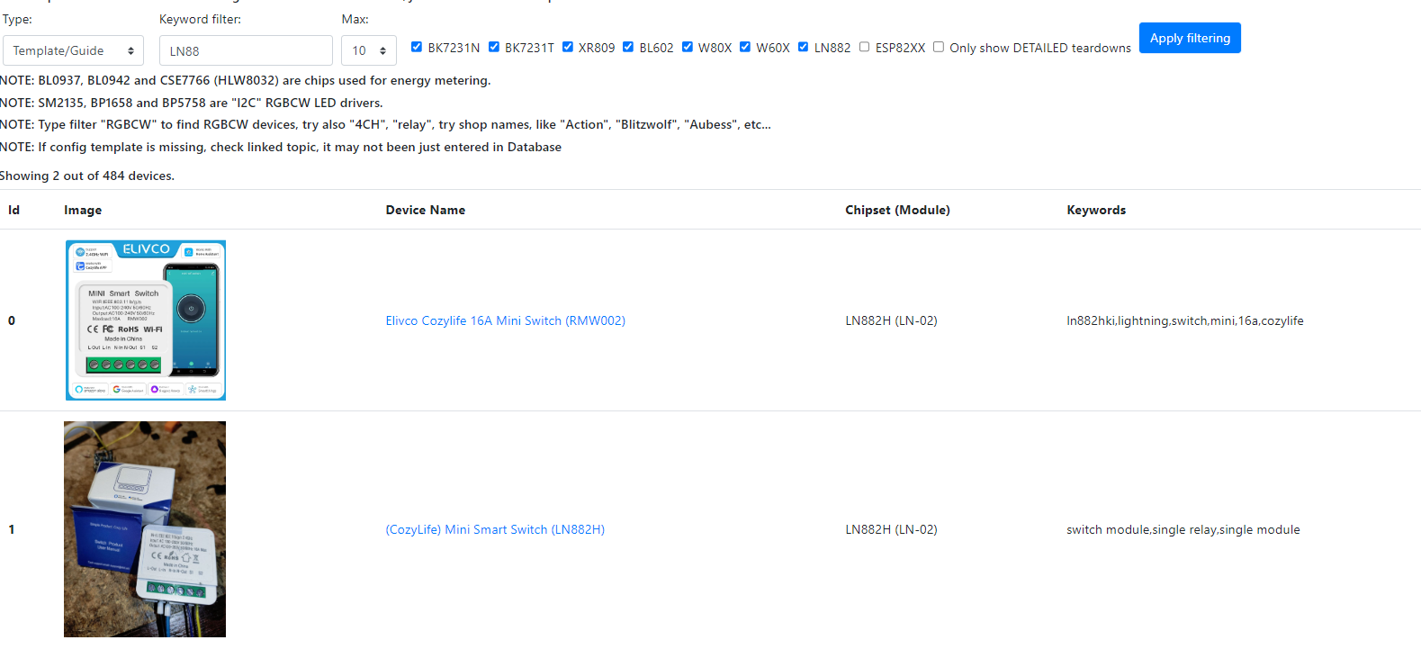

    Newer CozyLife LN-02 firmware with same product ID

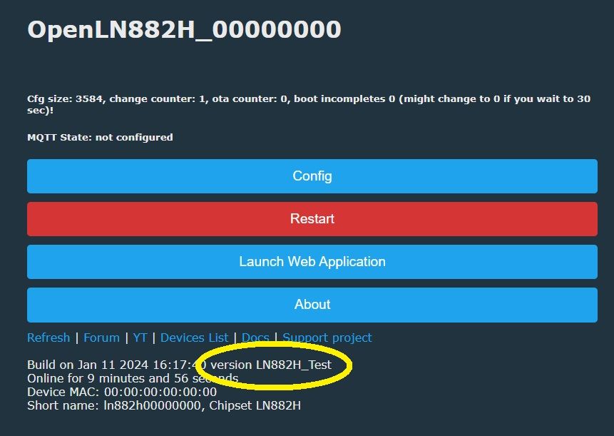

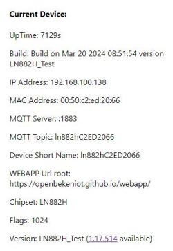

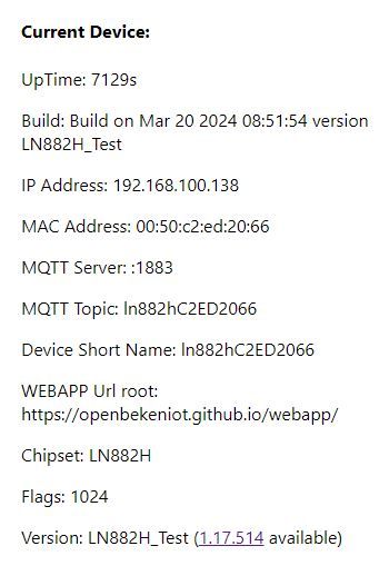

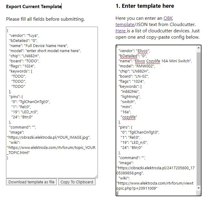

    #8 20911009
    Posts: 5236
    Help: 449
    Rate: 918

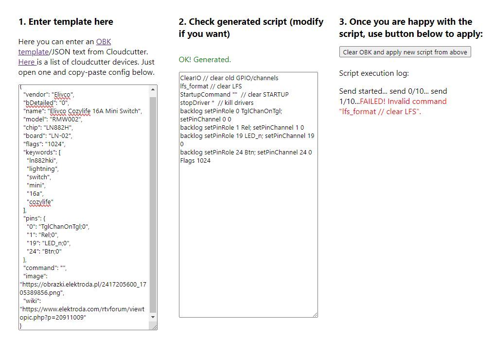

    I also have this Cozylife 16A mini switch with LN-02 - https://www.aliexpress.com/item/1005006127262082.html
    I've captured the boot log and it has the same product ID, but a newer firmware.

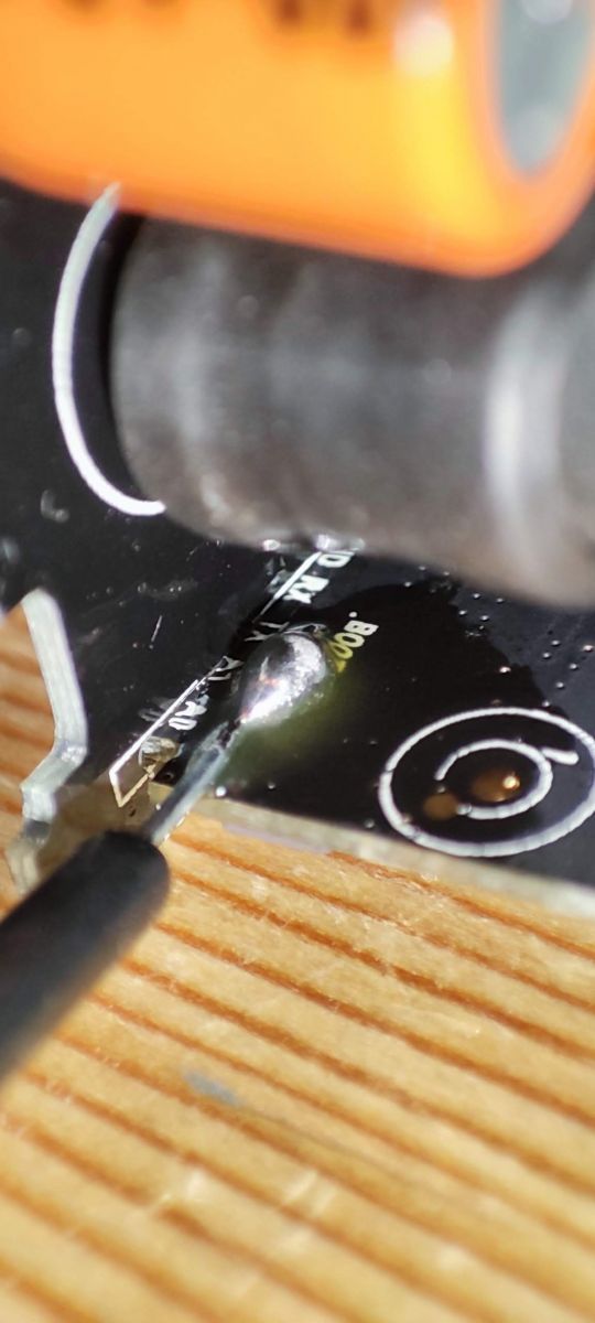

    I've started a firmware dump and will then proceed with the LN882H test image from @sweetlilmre and @p.kaczmarek2 as discussed in https://www.elektroda.com/rtvforum/topic4008545.html
    I've soldered BOOT in situ Close-up of soldering point on a black circuit board labeled BOOT. Cozylife 16A LN-02 mini switch with attached wire Mini switch Cozylife 16A LN-02 with BOOT wire soldered Close-up of a circuit board labeled LN-02 with a Lightning LN882HKV chip.
    Close-up of a circuit board with soldered pins labeled TX, RX, GND, and 3.3.
    ELIVCO mini smart switch with an app on the phone. Advertisement for Cozylife 16A Wi-Fi switch on AliExpress Digitaling Store.

  • #10 20943170
    Posts: 14795
    Rate: 12944
    I think it's already on our list:
    Screenshot of an IoT devices list showing two devices in a table.
    Here: https://openbekeniot.github.io/webapp/devicesList.html

    #13 20974595
    silvestro_gatto
    Posts: 30
    >>20911009
    I have some of this Cozylife 16A mini switch with LN-02 and I was able to save original firmware and upload OpenLN882H firmware LN882H_Test_ver_1.17.478.
    I couldn't get any serial output with the original firmware. Could you please tell me which speed you set on the serial port to capture the boot log? Thanks!
    Added after 12 [minutes]:
    >>20943170
    One more question ...
    Could you please explain how to modify the upper part of the Template info ( "vendor" , "bDetailed", "name", "model", "chip", "board",
    "flags", "keywords")? I tried many times to Import the "Elivco Cozylife 16A Mini Switch (RMW002)" Template and apply it, but I can only update the pin settings.
    Screenshot showing a JSON template editor for the Cozylife 16A Mini Switch device.
    I am also getting a "FAILED! Invalid command "lfs_format // clear LFS" error when I click on "Clear OBK and apply new script from above" button
    Screenshot showing template configuration and script execution log for Cozylife 16A mini switch.
    Thank you!
  • Manual module config required for LN882 firmware
    #14 20974623
    Posts: 5236
    Help: 449
    Rate: 918
    silvestro_gatto wrote:
    I have some of this Cozylife 16A mini switch with LN-02 and I was able to save original firmare and upload OpenLN882H firmware LN882H_Test_ver_1.17.478.
    I couldnt get any serial output with the original firmware. Could you please tell me which speed you set on the serial port to capture the boot log? Thanks!
    I think maybe just 115200. Obviously the BOOT pin is not grounded for standard flash boot output. The output logs posted are from factory fw, so you can expect an already-flashed OBK output to be different.
    The import function strips this info out anyway and will only apply the pins and flags settings. The export box text is for copying out into a text editor for manual editing and then posting on these forums. If the template posted is unique it'll normally end up being added to the devices list - https://openbekeniot.github.io/webapp/devicesList.html
    yes. the import/littlefs stuff doesn't seem to be setup for LN882 firmware yet. Manual module config required
  • Factory firmware gives no serial output
    #15 20975324
    silvestro_gatto
    Posts: 30
    Hi divadiow,
    Thank you for your prompt answer.
    In my past test I tried to log from serial port the factory fw, but (even changing the serial port speed and leaving BOOT disconnected from Ground) I did not get any output in the serial monitor. Just curious what version of factory fw is running on my devices ...
    Btw, is there a way to modify the values of "vendor", "bDetailed", "name", "model", "chip", "board", "flags", "keywords" in the currently running Template and make them consistent with the current hw? Is there any configuration file where these information are stored that can be edited and updated?
    Thanks!
  • #16 20975378
    Posts: 14795
    Rate: 12944
    All those fields (except flags) are for template only, they are not stored on the device. The idea is that you are supposed to fill them while creating a teardown topic on our forum, and then paste the template in the topic, so we can later add it to https://openbekeniot.github.io/webapp/devicesList.html
  • #17 20975465
    silvestro_gatto
    Posts: 30
    Got it!
    Many thanks p.kaczmarek2
  • Show OpenLN882H version in web UI footer
    #18 20998750
    silvestro_gatto
    Posts: 30
    Instead of the text "LN882H_Test", it would be nice to show the current version (i.e. OpenLN882H_1.17.501) both in the footer of each page
    User interface displaying software version LN882H_Test at the bottom of the screen.
    and in the Config Tab of the Web Application
    Screenshot of the Config tab showing current device details with software version LN882H_Test.
    I have several devices running different versions of OpenLN code and Build info is not enough to quickly find the correct version.
  • #19 20999123
    Posts: 14795
    Rate: 12944
    It seems we need to define USER_SW_VER in Makefile, I will check this out.
    If that's not defined, then a default value is used:
    Screenshot of a code editor displaying the new_common.h file defined in the OpenBK7231T_App.
  • #20 21012494
    silvestro_gatto
    Posts: 30
    Hello @p.kaczmarek2,
    I updated the firmware on some LN882H modules and noticed that they are still showing "version LN882H_Test"
    Displayed text showing the software version as LN882H_Test.
    Screenshot of LN882H device information showing details such as firmware version, IP and MAC addresses.
    instead of the current firmware version.
    Is there any timeframe for fixing this issue?
    Thank you!
  • #21 21012498
    Posts: 14795
    Rate: 12944
    Not yet, we need somebody who knows CMake to look into forwarding the CMake variable to a #define , I have looked into that some time ago but I don't know CMake and I didn't have much time to research that. Here is unfinished PR:
    https://github.com/openshwprojects/OpenBK7231T_App/pull/1123
  • #22 21012694
