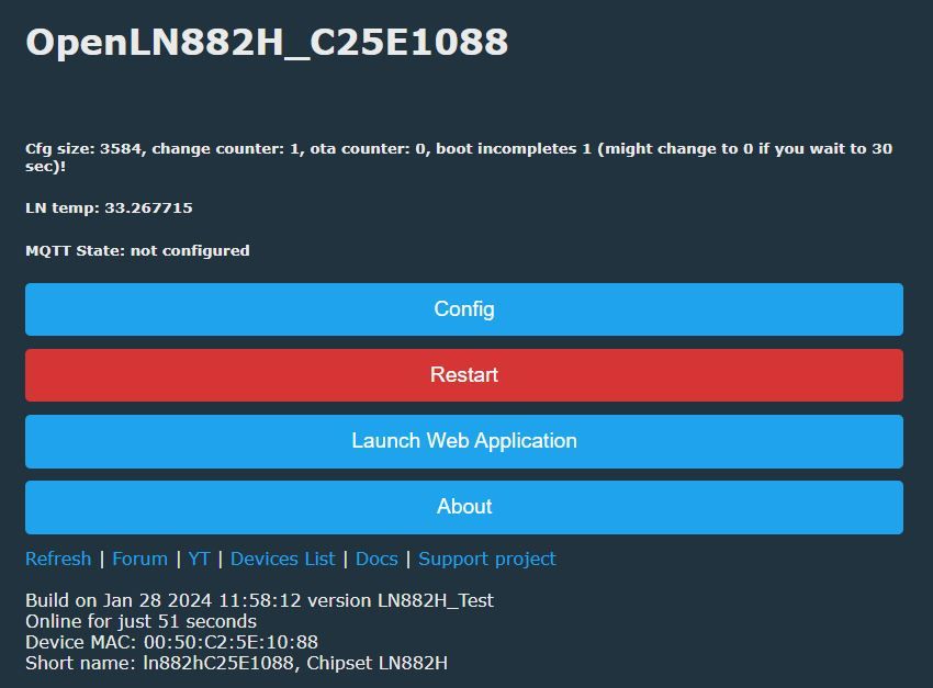

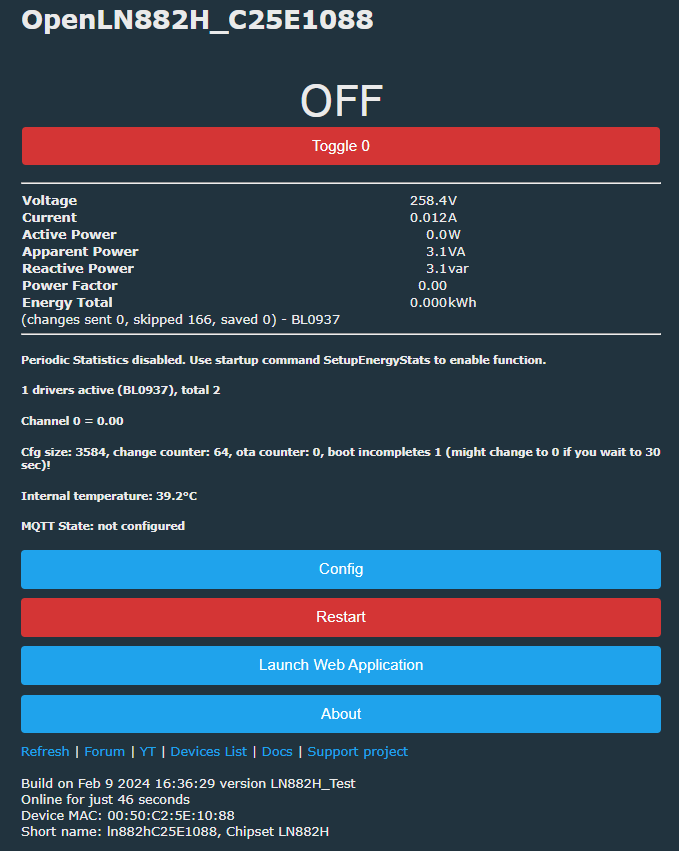

  • Teardown and OpenBeken flashing of an Elivco/BSD34 20A EU smart plug using a WL2S module with Lightning Semiconductor LN882H and BL0937 power monitoring.
  • The WL2S module was desoldered, the A9/BOOT pad grounded to enter BOOT mode, the factory firmware dumped, then OpenLN882H UART firmware downloaded and the module resoldered.
  • A modified LN882H_Flash_Dumper capped the dump at 0x00200000, and the slow read took about 30-40 minutes.

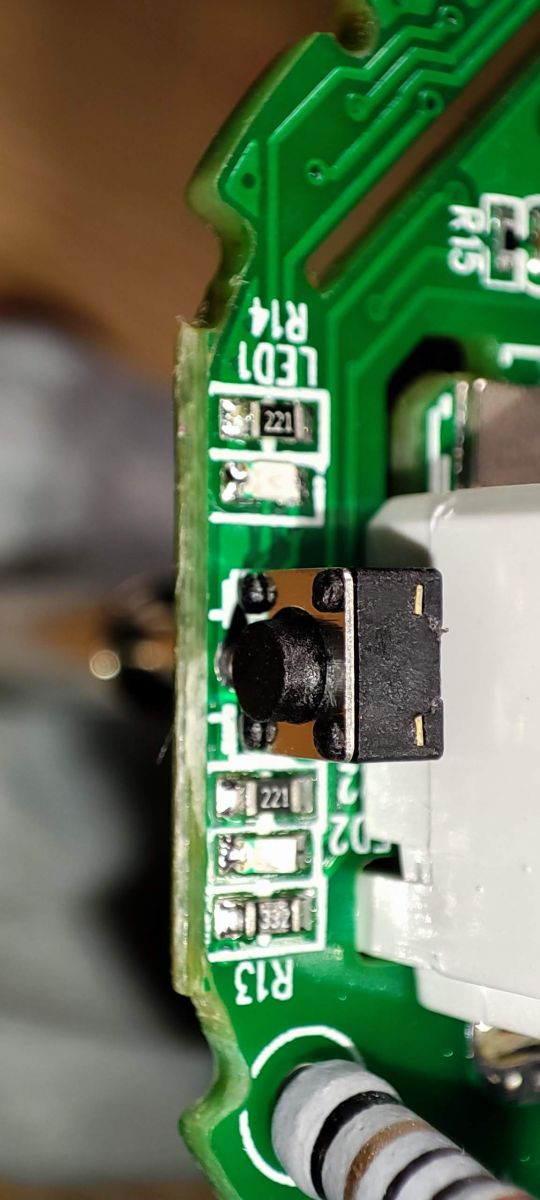

  • OBK found A0 for the red LED, A3 for the button, A10 for the blue LED, and A11 for the relay; the plug worked, but BL0937 support was still nonfunctional.

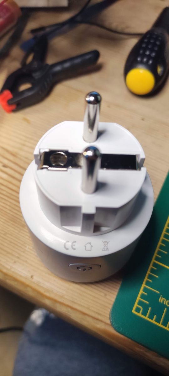

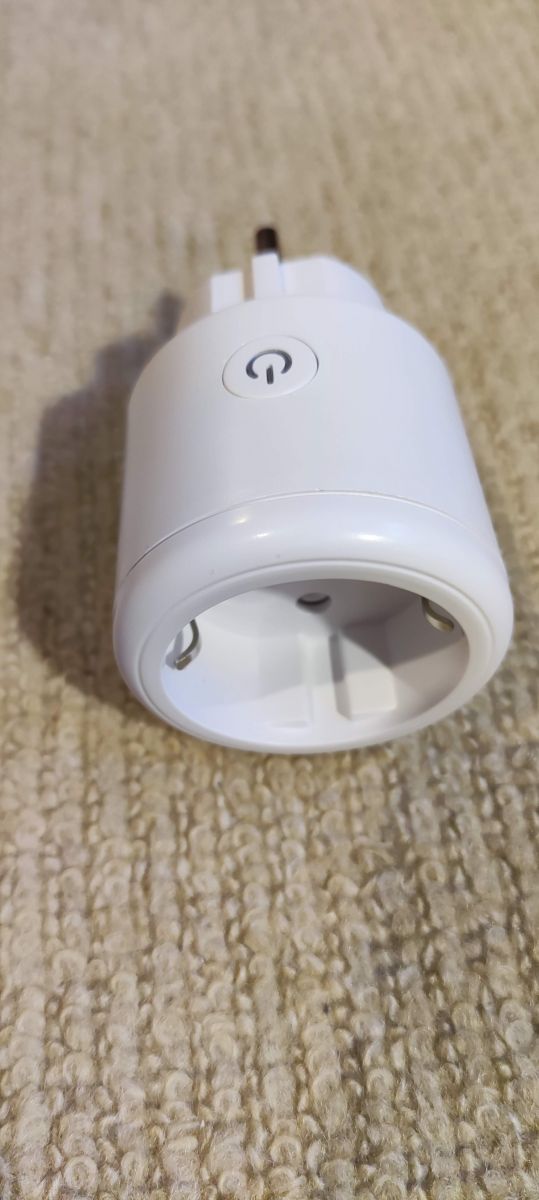

    I live in the UK, so have no immediate use for an EU plug, but I was intrigued to get my own WL2S to open and flash with OpenBK.

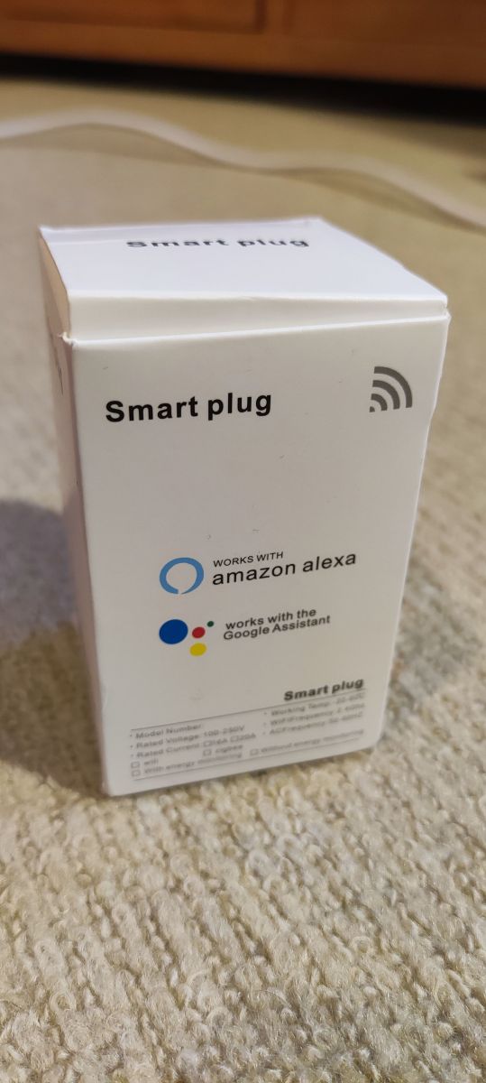

    External pics of the unit and packaging received 5 days after the order was placed:
    White smart plug with two pins. Close-up view of a smart plug labeled as model BSD34. White smart plug with a power button on the housing White smart plug with a power button on a smooth background. Smart plug box supporting Amazon Alexa and Google Assistant. Packaging of Elivco BSD34 smart plug. Smart plug packaging with barcode and product details. Smart Plug user manual. User manual for Elivco smart plug with power monitoring.

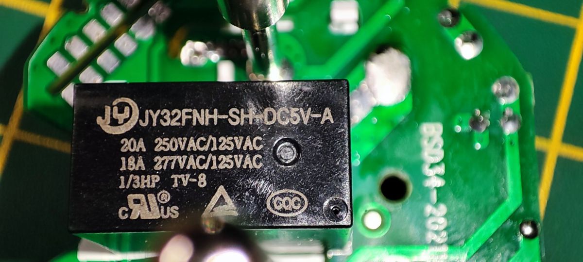

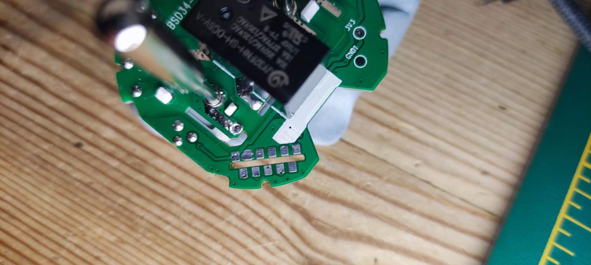

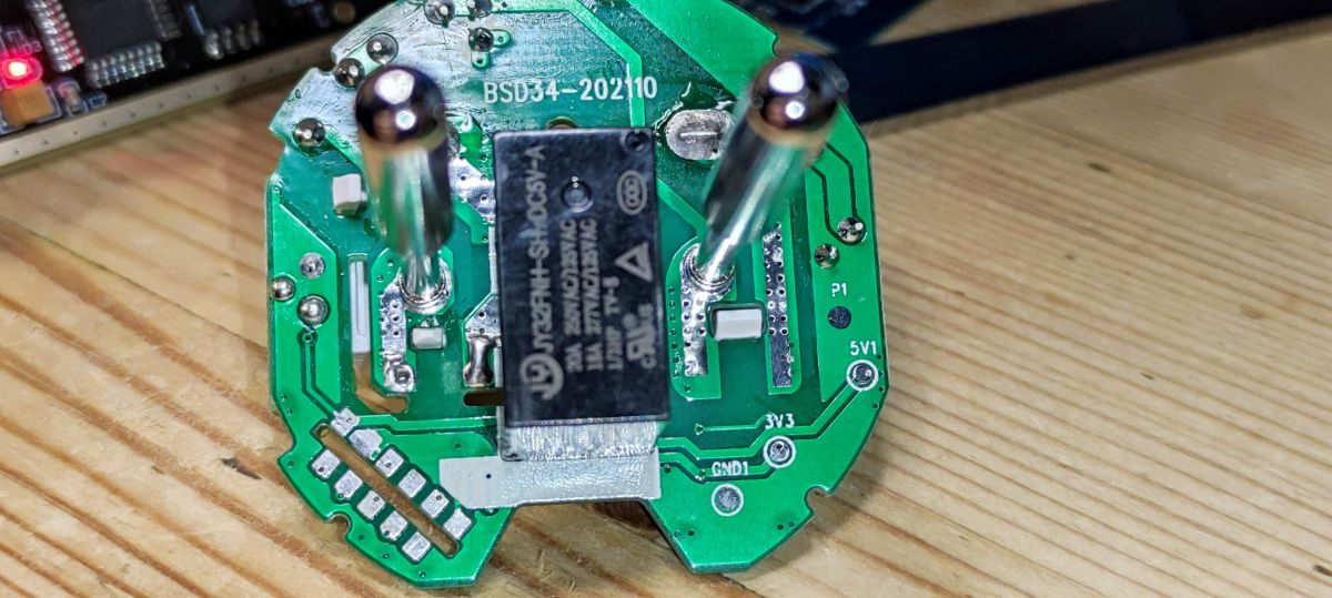

    From teardowns in other posts, and by visual inspection, it was obvious where the unit would open up, -where the unit was glued/clipped along the top rim. Not happy with how some of the UK plug I've had to open have turned out, all gnarled up and battered, I sought a better, less destructive way. Maybe EU plugs are generally easier anyway, but this method was excellent for opening

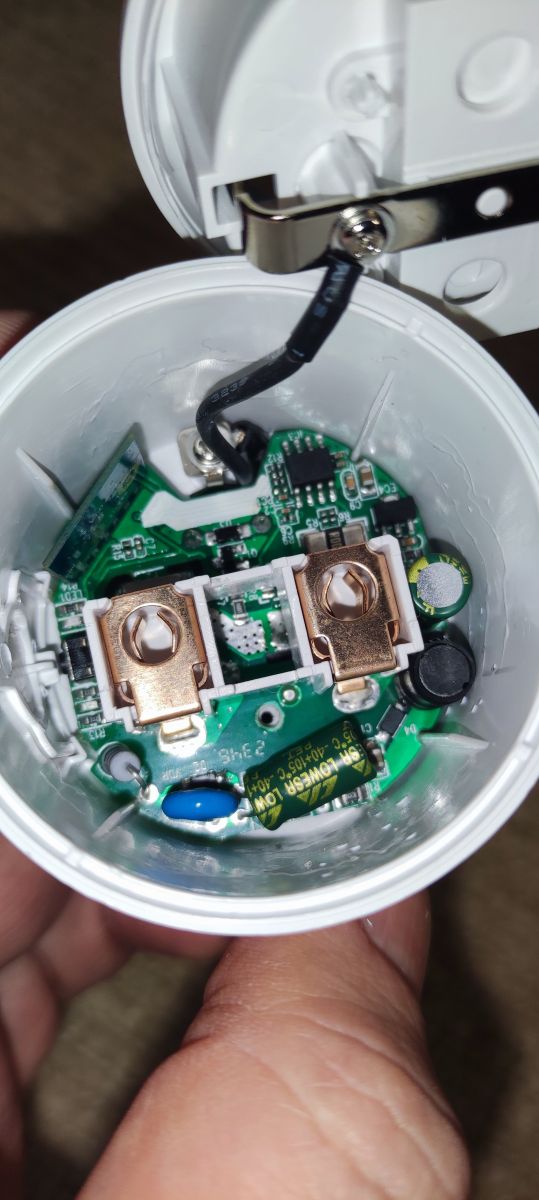

    The casing is a little different and I don't have F clamps, but I did use G-clamps and a bit of targeted force. Position the clamps just below the joining line then tighten until you hear the glue cracking - then loosen and move to a slightly new place and tighten again. Quite quickly the unit broke open without damage. With the top loose only the earth wire keeps the two sections joined.
    Interior of Elivco 20A smart plug with LN882 chip.

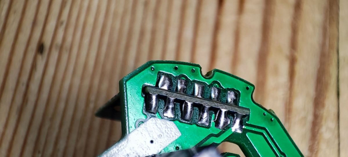

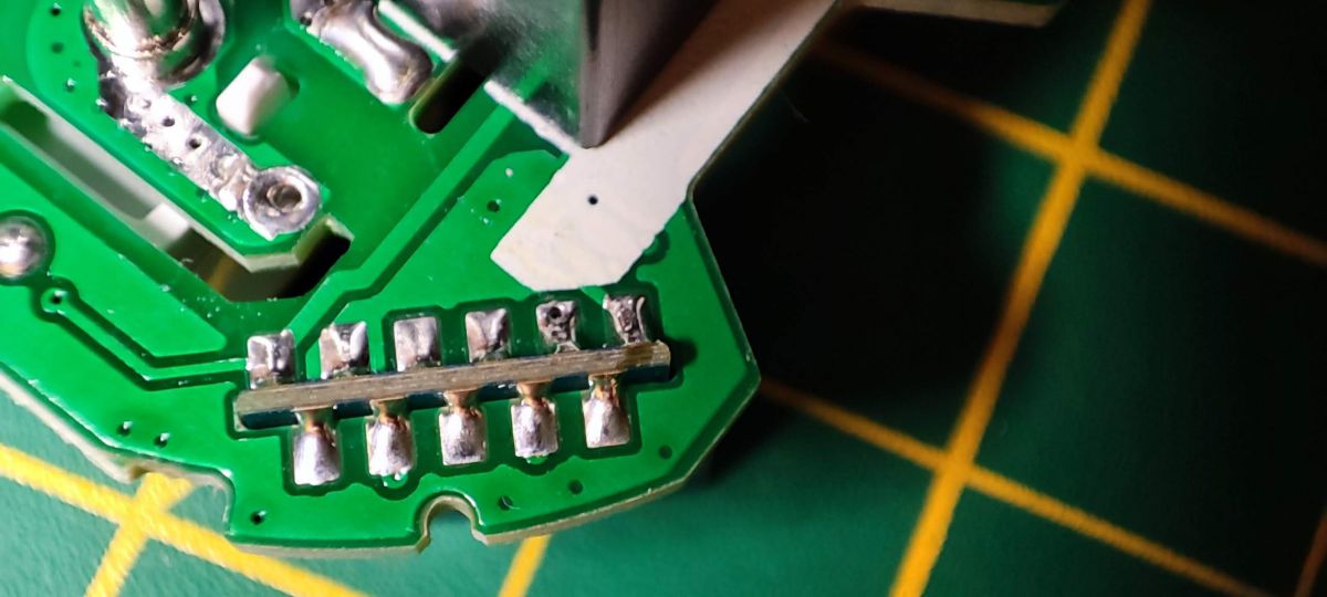

    Unscrewing fully the single screw on the PCB allowed me to push the two power prongs up and out of the case. I had to loosen the earth screw slightly to move the connector round a bit to allow the PCB to slide out.

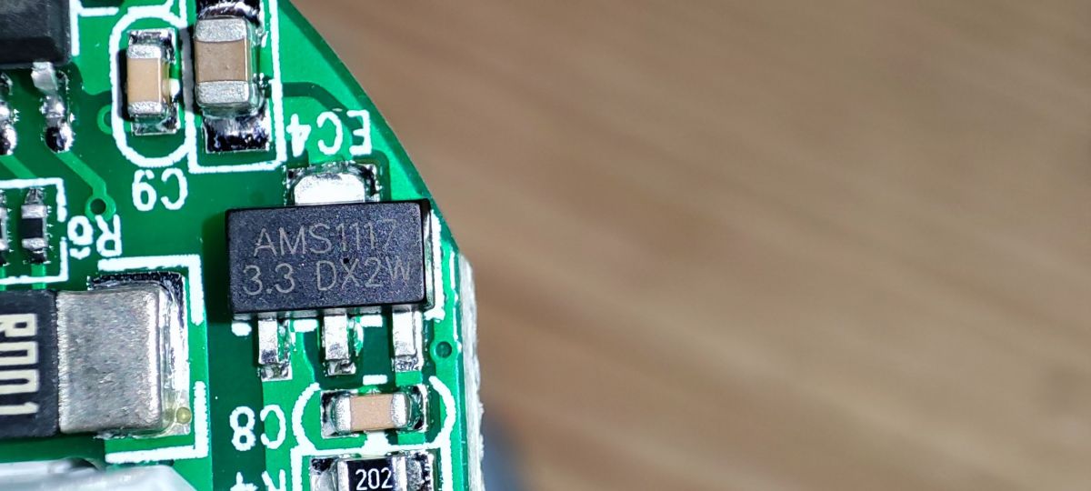

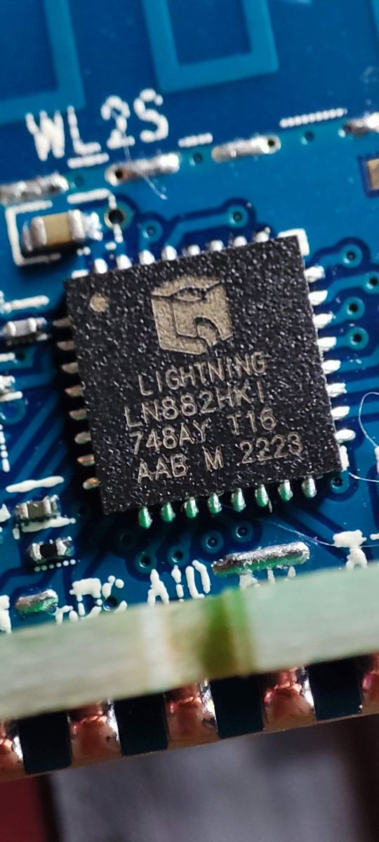

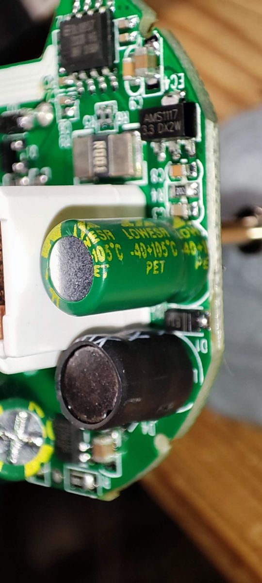

    Now that it's free I can photograph the internals:
    Close-up of the Lightning Semiconductor LN882HKI chip on a PCB. Close-up of an electronic module with visible connection labels, such as RXD1 and GND. Close-up of a PCB with markings for RX0, TX0, GND, and other ports. Close-up of the interior of a smart plug, showing PCB components and solder connections. Close-up of a PCB with BL0937 chip in a smart plug Close-up of the interior of a smart plug showing electronic components. Close-up of a smart plug circuit board with visible electronic components and capacitors. Close-up of a PCB with a visible button and components labeled LED1 R14. Close-up of a circuit board with an AMS1117 component labeled 3.3 DX2W. PCB board of BSD34 smart plug viewed from the bottom, visible electronic components Smart plug BSD34 with visible JY32FNH relay.
    silkscreen: BSD34-202110

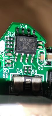

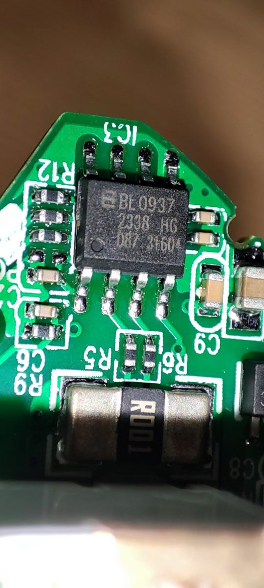

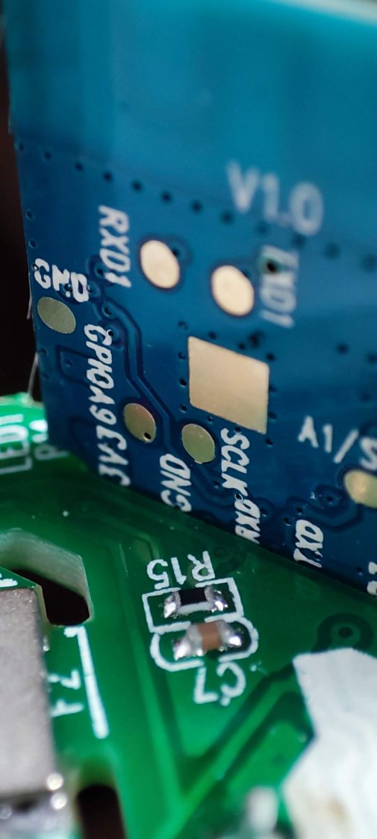

    Knowing this unit has powering monitoring by way of a BL0937 chip and not wanting this to get in the way of any flashing efforts (and also the angle and position of the module makes access to some of the pads difficult for in situ flashing), I took the plunge to desolder the entire WL2S module. I first applied lots of flux to both sides of the board, covering the soldered contacts completely. I then used extra pb solder to make a single sausage blob of solder along both sides, so the factory solder was melted and mixed into one. I then pasted copper solder braid with flux and used the soldering iron to soak up all solder. Very quickly the module dropped out of the main board. This technique has been demonstrated by Elektroda:
    Image of the PCB from a BSD34 smart plug with LN882 chip, top view.

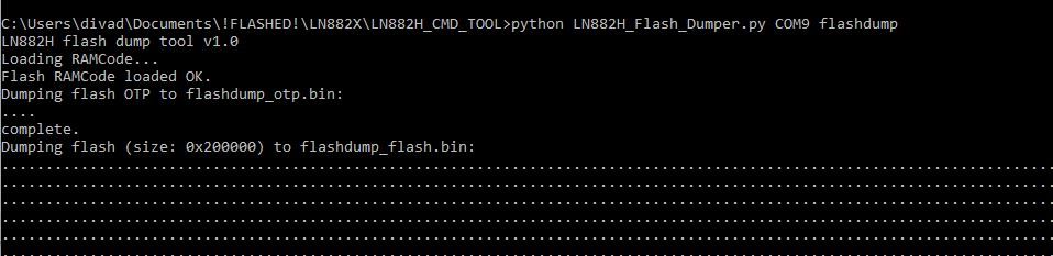

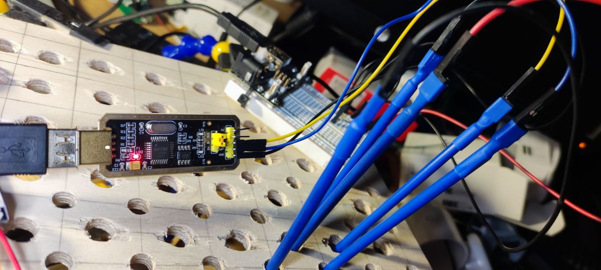

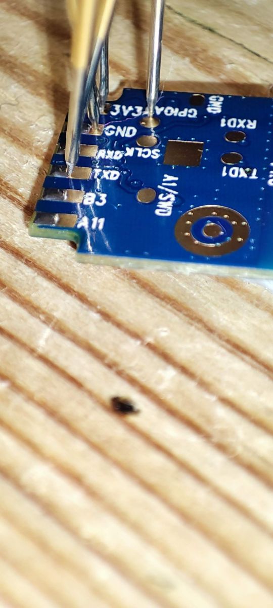

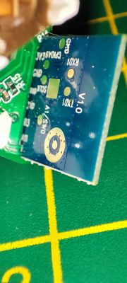

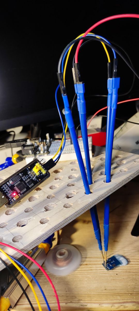

    After cleaning the module with isopropyl alcohol I set up pogo pins connected to a USB-TTL adaptor, and separate (ie not the VCC from the USB adaptor) 3.3v power supply.
    Close-up of a PCB module with connected test wires.
    Electronic circuit with multicolored wires connected to a prototype board. Connected wires with USB-TTL adapter and test board on a wooden surface.
    TX0 -> USB-TTL RX
    RX0 -> USB-TTL TX
    GND -> USB-TTL GND
    3V3 -> External 3.3V PSU
    External 3.3V PSU GND -> USB-TTL GND (so all 3 share a ground)
    with this config, I could collect the uart boot log on power-up, which output as:

    Then with A9/BOOT pad grounded I could continue with the factory flash dump and upload of the work-in-progress LN882H OBK firmware.
    Unplug USB-TTL, power off external 3.3v
    Plug in USB-TTL with A9/BOOT ground (and all other connections) in place
    Power up 3.3v
    The LN882H will see that A9 is pulled low and enter BOOT mode and await flashing.
    Using a slightly modified LN882H_Flash_Dumper.py (with flash size capped at 0x00200000 after this discovery), I dumped the factory firmware which I attach to this post. I also attach the modified LN882H_Flash_Dumper.py, which will instead say complete when it hits 2mb, rather than erroring.
    python LN882H_Flash_Dumper.py COMx flashdump
    The dump speed is fixed and is very slow, so this took ~30-40 minutes.
    Screenshot of the LN882H flash dumping process using the LN882H_CMD_TOOL.

    Removing the A9/BOOT gnd and resetting the power resulted in a new "LN882H_XXX" AP to which I connected and got a 192.168.4.100 IP address.
    Wi-Fi signal icon with network name OpenLN882H_C25E1088.
    browsing to 192.168.4.1 presents you with the OBK web config pages
    OpenLN882H user interface with device information and control buttons.
    With a steady hand, plenty of flux, a small point on the soldering iron and some patience I soldered the module back in place. I think I did OK!
    Close-up of a smart plug PCB with exposed traces and soldered connections.
    Thanks to @sithyoda is looks like we have the GPIOs for the BL0937 but I don't believe we can test this yet (as at 29th January 2024) as the driver is not functional.

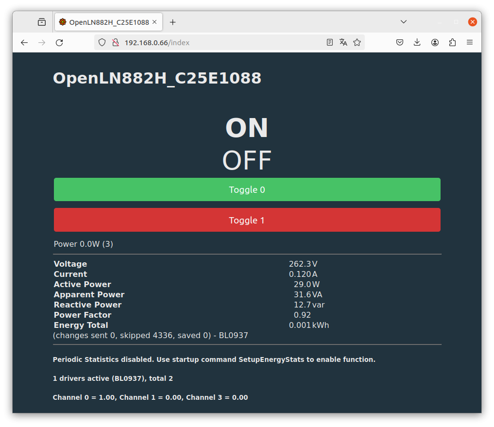

    I got a bunch of "LSPA9" plugs with LN882H (wanted Zigbee ones, but ordered WIFI :-() so I stumbled over your work on LN882H.
    Works from the start, only the BL0937 not working, so I tried on my own and ended up in a plug not booting...
    With some minor changes I tried the files from the pull request, and - ta da it works (not tested too much, no calibration ...)
    Screenshot of OpenLN882H_C25E1088 user interface with power status information.
    Here the files changed as a tar file and a diff (didn't get it to diff CMakeLists.txt, so this is in tar only (sorry, I'm not so familiar with git etc to see how this could be integrated).
    The main work (all the code in drv_bl0937.c) was done by @miegapele, I just changed the path to the includes and one typo).
    Once again, thanks to everybody working on this project!

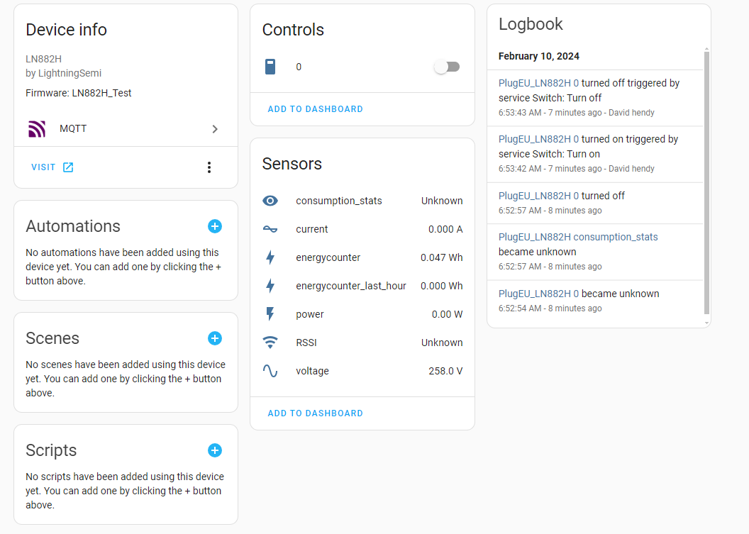

  • #18 20953708
    Posts: 14783
    Rate: 12924
    I had report saying that executing HASS Discovery causes ERR_MEM in MQTT and I would like if it no longer happens. I've increased MQTT buffers to match the required sizes.
  • Home Assistant MQTT discovery for LN882H plug
    #19 20954030
    Posts: 5225
    Help: 449
    Rate: 918
    Info:MQTT:Publishing val 258.2 to euplug/voltage/get retain=0
    Info:MAIN:Time 36535, idle 0/s, free 96048, MQTT 1(2208), bWifi 1, secondsWithNoPing 36470, socks 0/0
    Info:MQTT:MQTT client in mqtt_incoming_publish_cb topic euplug/voltage/get
    Info:CMD:[WebApp Cmd 'logfeature 2 0' Result] OK
    Info:MQTT:Publishing val 0.047 to euplug/energycounter/get retain=0
    Info:MQTT:Publishing val 0.000 to euplug/energycounter_last_hour/get retain=0
    Info:MQTT:MQTT client in mqtt_incoming_publish_cb topic euplug/energycounter/get
    Info:MQTT:MQTT client in mqtt_incoming_publish_cb topic euplug/energycounter_last_hour/get
    Info:MQTT:Publishing val 260.3 to euplug/voltage/get retain=0
    Info:MQTT:Queued topic=homeassistant/switch/OpenBK_LN882H_WL2S_EUPlug_PM_relay_0/config, 1 items in queue
    Info:MQTT:Queued topic=homeassistant/sensor/OpenBK_LN882H_WL2S_EUPlug_PM_sensor_0/config, 2 items in queue
    Info:MQTT:Queued topic=homeassistant/sensor/OpenBK_LN882H_WL2S_EUPlug_PM_sensor_1/config, 3 items in queue
    Info:MQTT:Queued topic=homeassistant/sensor/OpenBK_LN882H_WL2S_EUPlug_PM_sensor_2/config, 4 items in queue
    Info:MQTT:Queued topic=homeassistant/sensor/OpenBK_LN882H_WL2S_EUPlug_PM_sensor_3/config, 5 items in queue
    Info:MQTT:Queued topic=homeassistant/sensor/OpenBK_LN882H_WL2S_EUPlug_PM_sensor_4/config, 6 items in queue
    Info:MQTT:Queued topic=homeassistant/sensor/OpenBK_LN882H_WL2S_EUPlug_PM_sensor_5/config, 7 items in queue
    Info:MQTT:Queued topic=homeassistant/sensor/OpenBK_LN882H_WL2S_EUPlug_PM_rssi/config, 8 items in queue
    Info:MQTT:Publishing val (325 bytes) to homeassistant/switch/OpenBK_LN882H_WL2S_EUPlug_PM_relay_0/config retain=1
    Info:MQTT:Publishing val (359 bytes) to homeassistant/sensor/OpenBK_LN882H_WL2S_EUPlug_PM_sensor_0/config retain=1
    Info:MQTT:Publishing val (359 bytes) to homeassistant/sensor/OpenBK_LN882H_WL2S_EUPlug_PM_sensor_1/config retain=1
    Info:MQTT:Publishing val (353 bytes) to homeassistant/sensor/OpenBK_LN882H_WL2S_EUPlug_PM_sensor_2/config retain=1
    Info:MQTT:Publishing val (376 bytes) to homeassistant/sensor/OpenBK_LN882H_WL2S_EUPlug_PM_sensor_3/config retain=1
    Info:MQTT:Publishing val (396 bytes) to homeassistant/sensor/OpenBK_LN882H_WL2S_EUPlug_PM_sensor_4/config retain=1
    Info:MQTT:Publishing val 0.011 to euplug/current/get retain=0
    Info:MQTT:MQTT client in mqtt_incoming_publish_cb topic euplug/current/get
    Info:MQTT:Publishing val (315 bytes) to homeassistant/sensor/OpenBK_LN882H_WL2S_EUPlug_PM_sensor_5/config retain=1
    Info:MQTT:Publishing val (330 bytes) to homeassistant/sensor/OpenBK_LN882H_WL2S_EUPlug_PM_rssi/config retain=1
    Info:MQTT:Channel has changed! Publishing 0 to channel 0
    Info:MQTT:Publishing val 0 to euplug/0/get retain=0
    Info:MQTT:MQTT client in mqtt_incoming_publish_cb topic euplug/0/get
    Info:MQTT:Publishing val 0.000 to euplug/current/get retain=0
    Info:MQTT:Publishing val 260.1 to euplug/voltage/get retain=0
    Monitoring panel for LN882H device with MQTT, showing device info, controls, logbook, and sensor data.

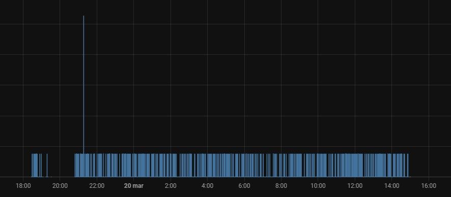

  • Watchdog fails and Wi-Fi never reconnects
    #21 21010987
    beloborodom
    thank you so much for the guide,
    i flashed it with the lastest firmware, but i noticed that the watchdog just dont work,
    when it come to 60 seconds, the module just deactivate wifi, and do nothing
    also, if the module disconnects from wifi, it will never reconnects anymore, i need to restart it manually(phisically)
    the web interface button restart works!
    Ota updates also works
    Module Name:
    LIGHTNING
    LN882HKI(or 1 i cant see, or L)
    748AY T16
    AA8 M2223
    Elvico 16A Tuya smart plug
    thank you so much
    EDIT:
    Graph showing irregular Wi-Fi disconnections of the BŁYSKAWICA module.
    this is how it disconnects, and never reconnect

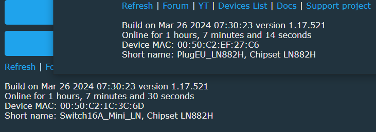

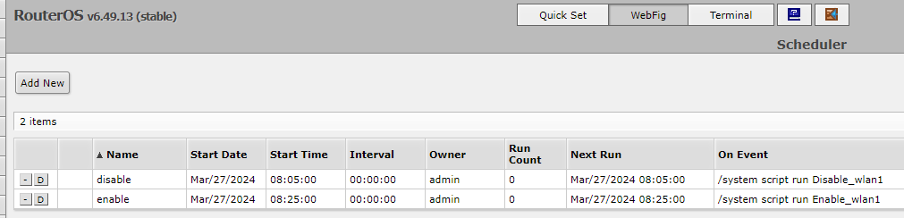

  • Wlan1 disable test shows devices reconnect cleanly
    #29 21021470
    Posts: 5225
    Help: 449
    Rate: 918
    scripted disablement of wlan1 on test router for 20 mins. no other devices connected to this network but 1 LN-02 mini switch and one WL2S EU smart plug with power monitoring and my PC.
    Screenshot of the Scheduler settings in RouterOS.
    both latest OBK and online for 30+ mins before starting
    Firmware build details including date, version, and online duration.
    on wlan1 re-enablement both LN devices are seen as connected again within a few seconds. total uptime is consistent with when they were first powered on.
    Screenshot of a table showing the uptime and signal strength of two devices.
    Screenshot displaying connection data for two network devices.
    is that test enough?
  • #30 21021494

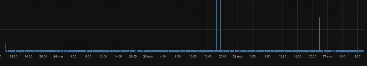

    beloborodom
    I have a quick update: I've recently updated to version 1.17.517 three days ago. So far, everything seems to be running smoothly without any disconnects. Over the next few days, I plan to test by disconnecting the WiFi to see how it performs, also will try the ping watchdog
    Thanks to everyone
    today i update to the 1.17.521
    Line chart showing network activity from March 24 to 27 with noticeable peaks.
