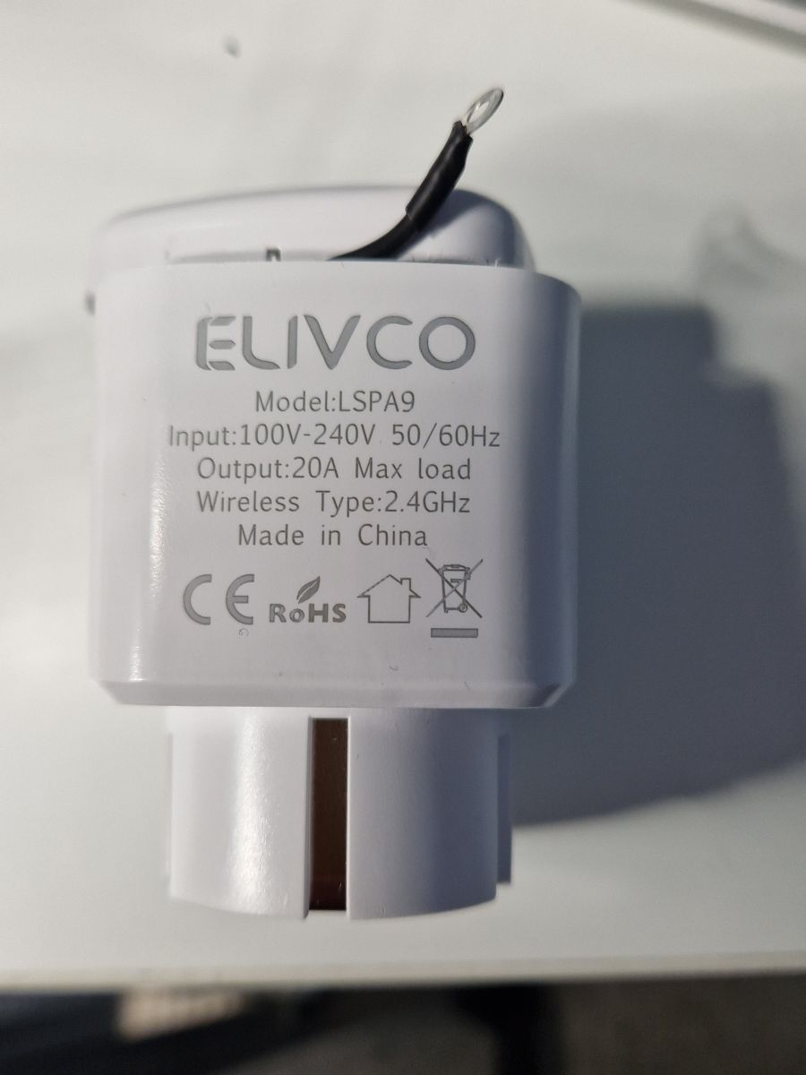

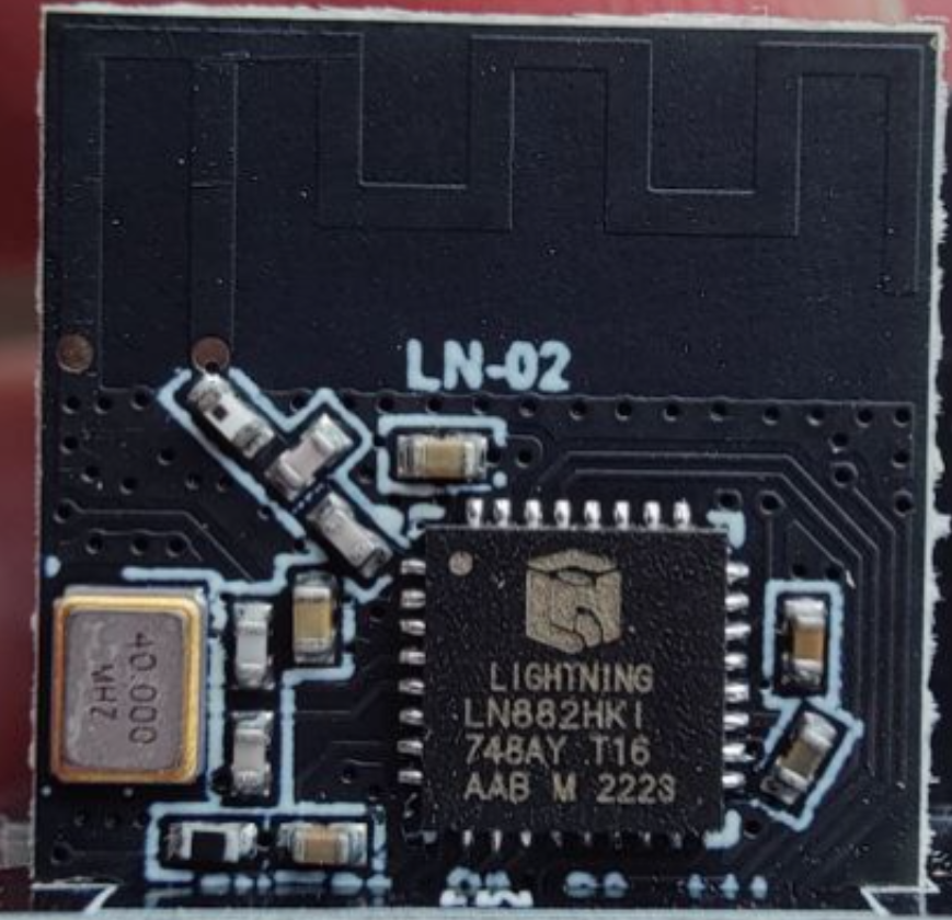

    Just got some ELIVCO LSPA9 modules and wanted to flash it with OpenBeken firmware.
    ELIVCO LSPA9 module with technical information on the casing

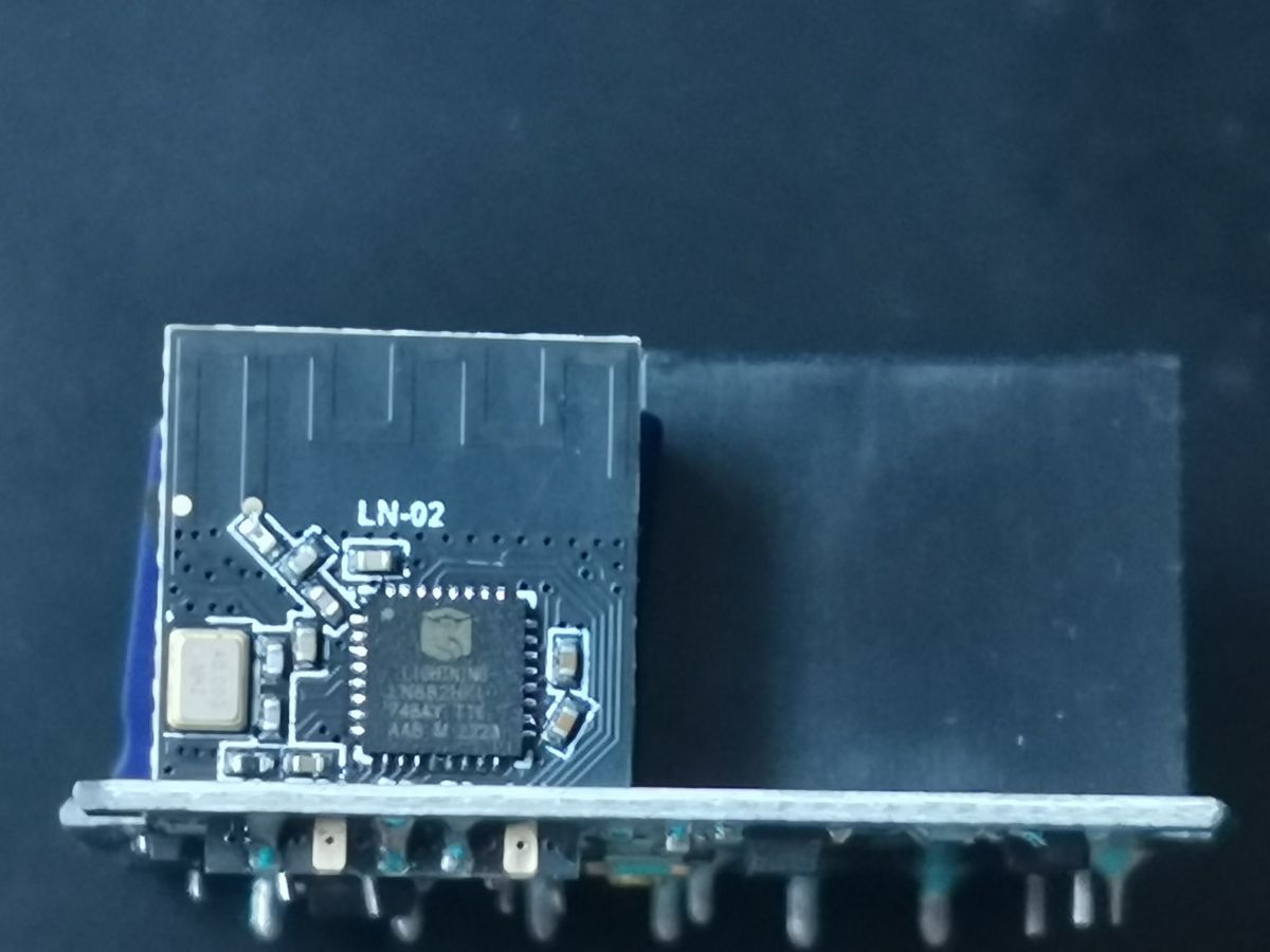

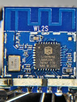

    After disassembling I had to find out that the installed microcontroller board is named WL2S and the chip used is LIGHTNING LN882HK.
    Close-up of a module with a WL2S microcontroller board and LIGHTNING LN882HK chip.
    Unfortunately, this one seems to be quite new and I did not find a lot of information about it, except on some tuya sites: Link
    Link
    Is there any chance to get it supported, even it seems not to be beken chip based?

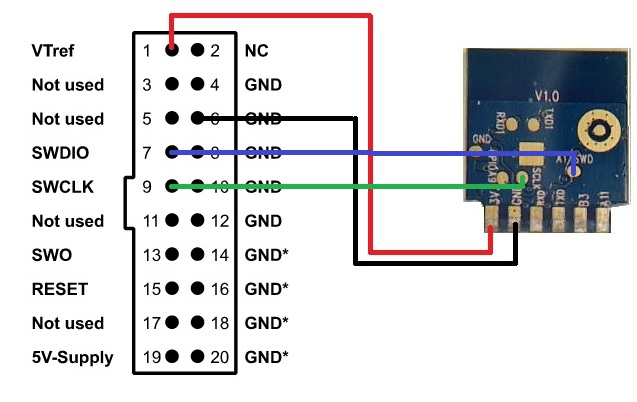

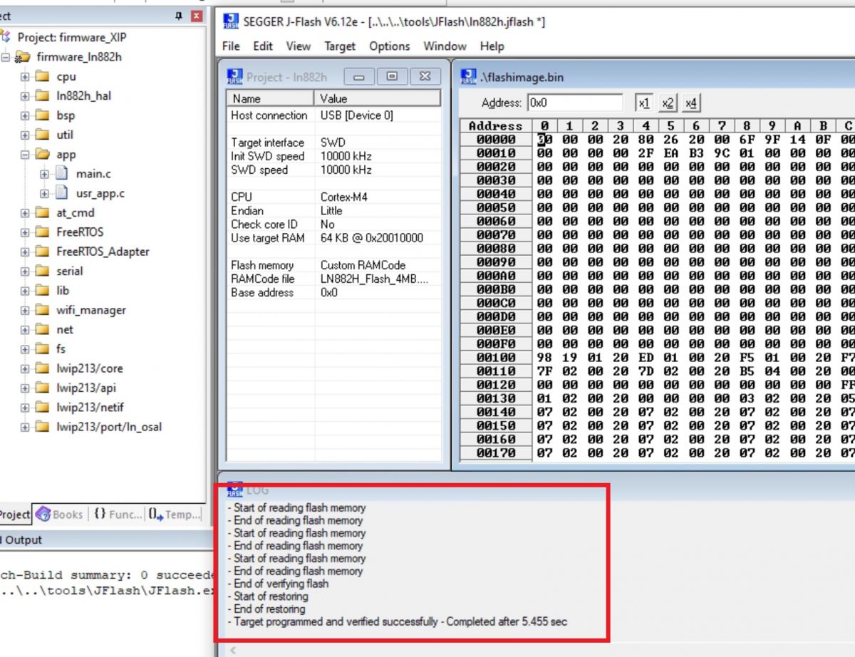

    Update 2026
    As of 2026, this platform read/write is also supported by our flash tool:
    The connection (soldering, wires), is the same, but you can use our tool instead of the legacy one.
    Please check it out and use it instead of legacy tools, let us know how it works for you!

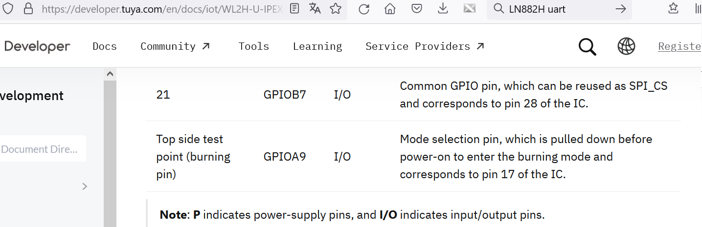

    That's something totally new to me! I would love to support that chip. Have you tried to at least capture debug log from UART?
  • No TX bootlog despite trying multiple baud rates
    #3 20774969
    sithyoda
    Posts: 37
    Yes, of course. Unfortunately, with no luck so far.
    I tried many different baud rates, but it seems that there is absolutely nothing coming out from the TX pin. I'm not quite sure if there is any other pin that has to be connected except VCC, RX, TX, and GND to get at least some bootlog.
    LED's are flashing during bootup and remain stable. With CEN pin to GND, the chip can be rebooted, just like the beken chips.
    Added after 1 [hours] 34 [minutes]:
    I might give it a try in the lab after desoldering the module from the main board.

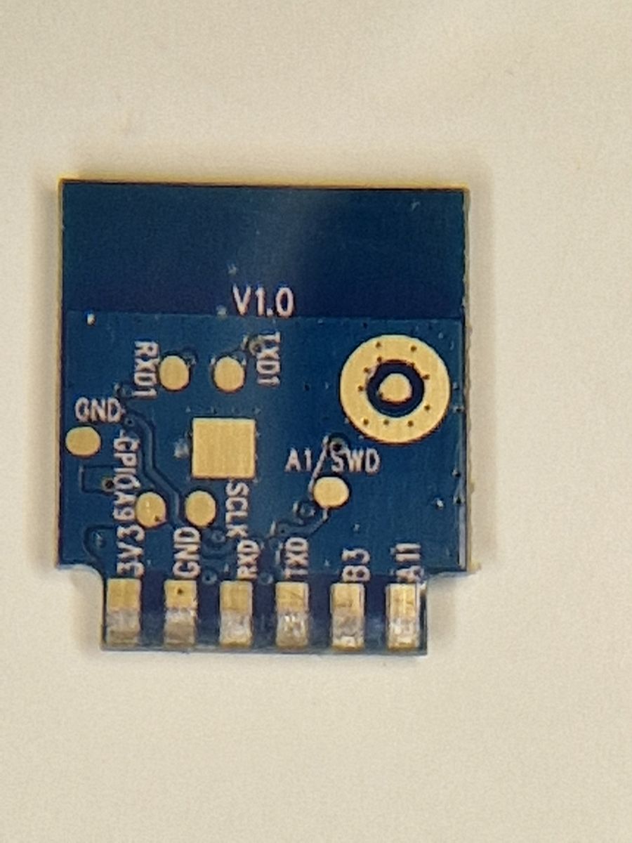

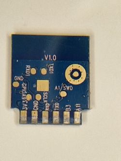

    How does the back of the module look like?
  • Bootlog shows WL2S module enters normal mode
    #5 20775964
    sithyoda
    Posts: 37
    Here a pic of the back of the desoldered module.
    Back of an unsoldered module with pin labels.
    Bootlog is output on TXD1 pin:

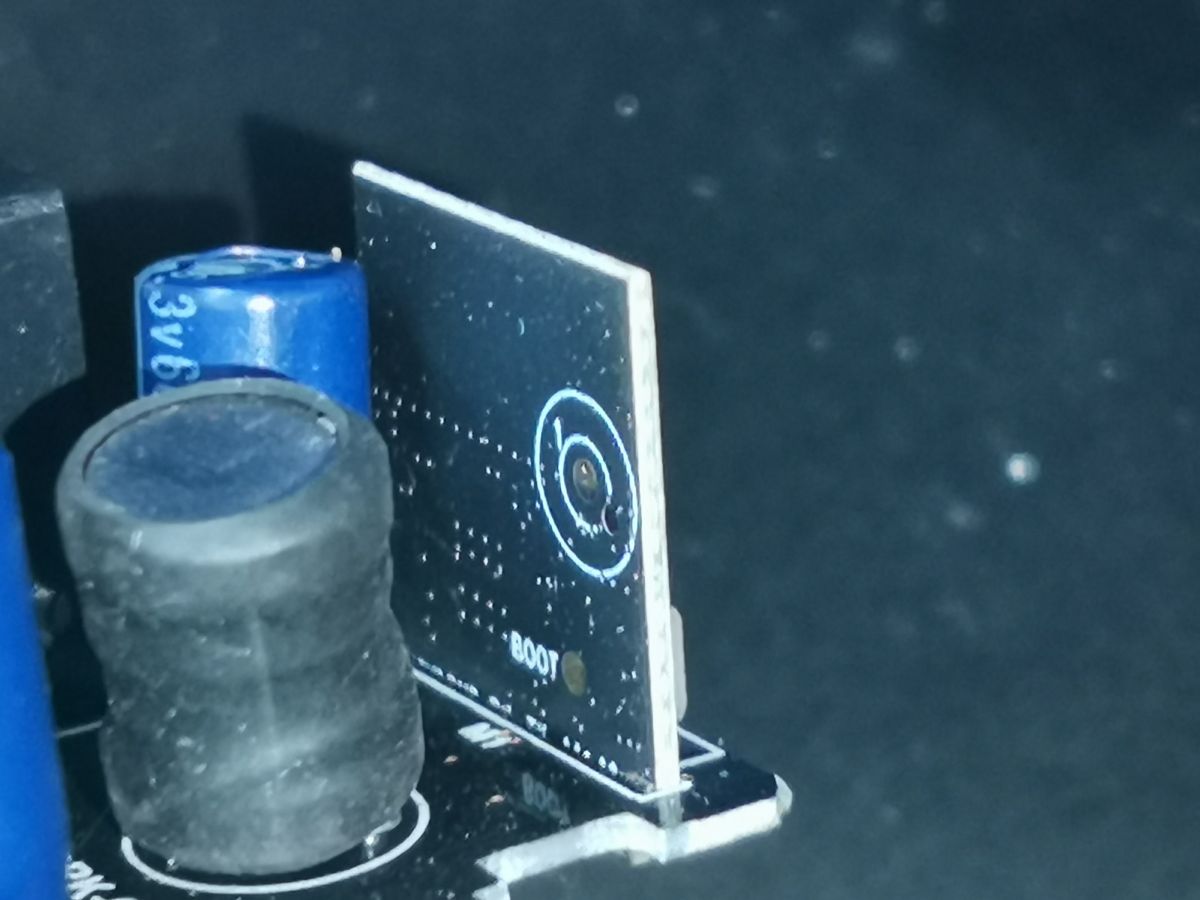

    Just tried to read flash via RXD1/TXD1 with bk7231flasher, but no luck.

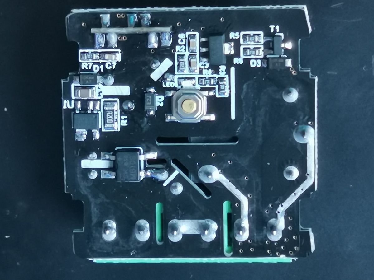

    Good afternoon! Got a relay on this chip. The CozyLife program is needed for management.
    Top view of a relay module with electrical specification markings. Close-up of a circuit board with various electronic components. Close-up of an LN-02 integrated circuit on a black background. Close-up of an electronic board with blue capacitors and a chip.

    I'm not quite sure. But I found this on a Tuya site, that makes me confident:
    Screenshot of a Tuya page with documentation on GPIO and connector descriptions.

    Tuya may have it's own bootloader that is separate from the LN882HK SDK, but we may not have access to it yet.

    With a Segger J-Link, I'm able to erase/flash the chip via SWD. So I flashed the SPI image OpenBK7231T_QIO_1.17.318.bin, but no bootup messages. I guess the bootloader does not fit this device.

    Here the pinout I use:
    Pinout diagram showing connections between a connector and a module.

    Hello, I have the same problem. I was trying to understand how I can put something 100% local
    Like OpenWrt or Tasmota ;)
    Close-up of a circuit board with a chip labeled LIGHTNING LN882HKI.
    my ic

    sithyoda
    Posts: 37
    Finally, I managed to compile an example from the SDK in KEIL and was able to successfully upload it to the chip.
    Screenshot of SEGGER J-Flash showing a firmware project and flash memory operation log.
    If you tell me how to compile OpenBK, I'll give it a try.

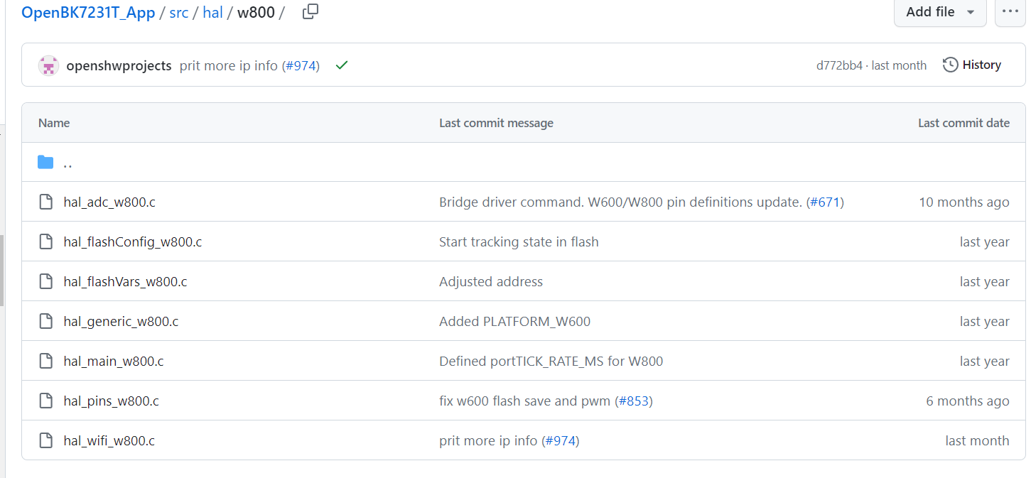

    Porting OBK to new chip is very simple, you just need to create separate directory in hal:
    https://github.com/openshwprojects/OpenBK7231T_App/tree/main/src/hal
    and stub all the functions, like we did for W800:
    https://github.com/openshwprojects/OpenBK7231T_App/tree/main/src/hal/w800
    Create files like your hal_generic_YourPlatform.c, etc:
    Screenshot of a GitHub directory with files for platform W800 in the OpenBK7231T_App project.
    Implement wrappers for WIFI and GPIO control, etc.
    You also need to create a 1 second timer for "every second" in main, but you can see all that in the HALs for different platforms.
    For compiling itself, we usually put whole OpenBK7231T_App dir into a "parent" project from given SDK, for example for T platform, we put OpenBK7231T_App in OpenBK7231T SDK project.
