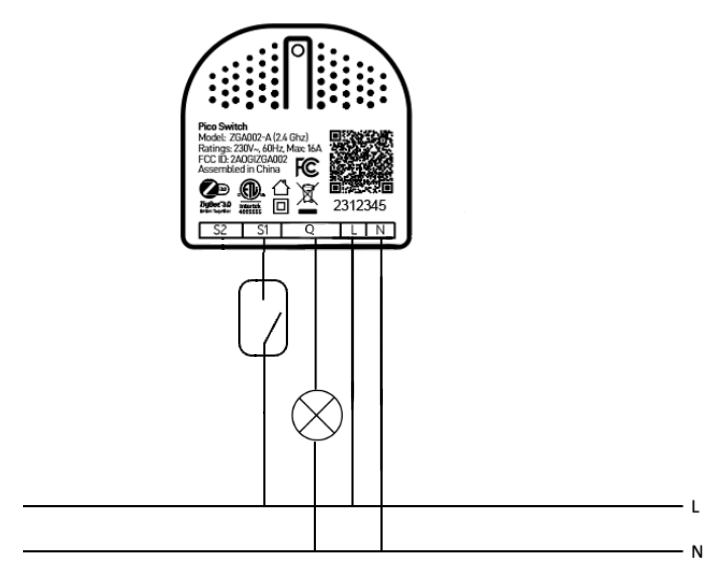

    Aeotec Pico Switch (zigbee 3.0) as a light switch.
    I have a standard installation in a new block (N, L, PE).
    I need help reading this diagram and connecting to an external switch.
    Aeotec Pico Switch (Zigbee 3.0) wiring diagram with labels S1, Q, L, N.
    What exactly is coming out of S1 and what is coming out of this Q?
    1. Do I feed LOAD from S1 to the switch from one side and LIVE from its other side?
    2. What passes from Q?
    The previous "non-smart" switch had only LOAD and LIVE.

    Basic symbols bow...
    There is nothing coming out of S1 and there is a switch (probably a bell button) connected to the phase.
    There is nothing coming out of Q and it is a phase output to supply the consumer(lamp).
    nullsoul wrote:
    I have a standard installation in a new block of flats (N, L, PE).
    No and in the box what do you have?

    It went
    Thank you, I was taken aback by this Q and actually just needed to calmly remind myself of the patterns.
