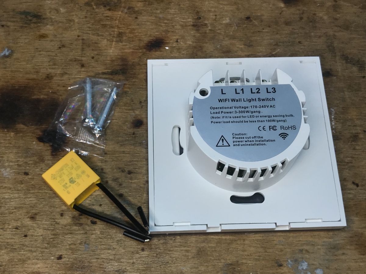

    Set contents:
    Back view of a WiFi wall switch with markings L, L1, L2, L3, screws, and a yellow capacitor. Appio 9605 touch switch box on a wooden table. User manual and packaging of the Appio/Lumenix 9605 light switch on a table.

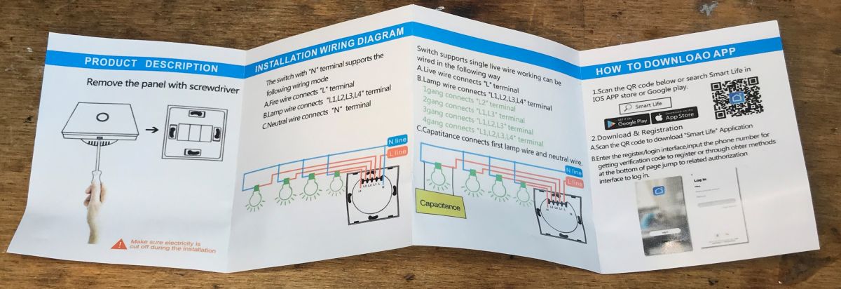

    Instruction:
    Installation instructions for Appio/Lumenix 9605 light switch. Installation instructions and product parameters for the Appio/Lumenix 9605 wall switch.
    User manual and electrical connection guide for a wall switch. Instruction manual for Appio/Lumenix 9605 touch Wi-Fi switch.

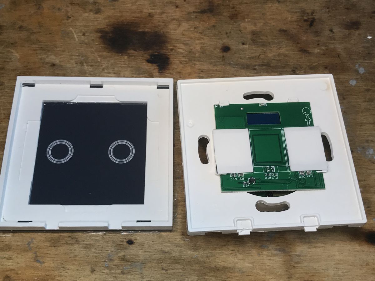

    Appio 9605 interior

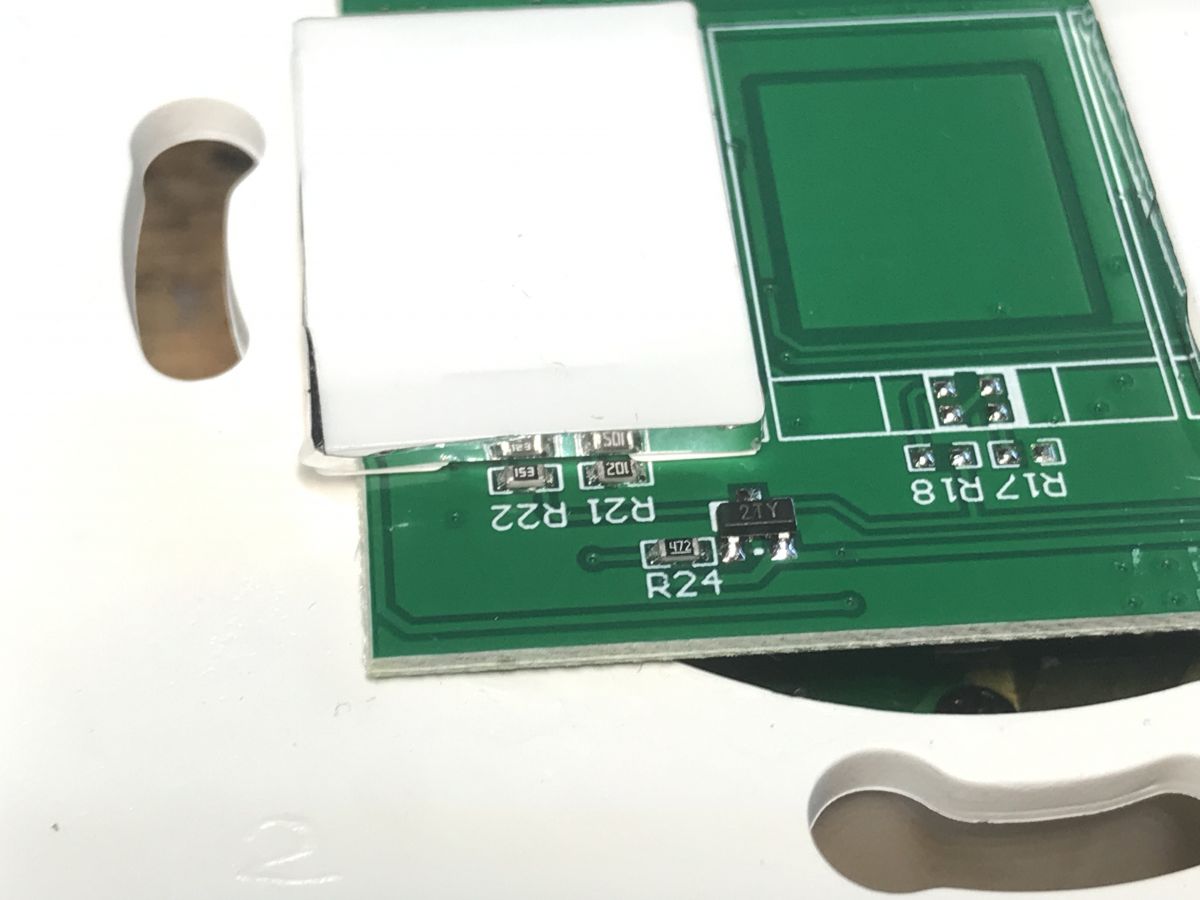

    As standard, we remove the undermined front:
    Disassembled Appio/Lumenix 9605 light switch showing internal circuits

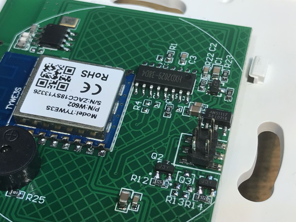

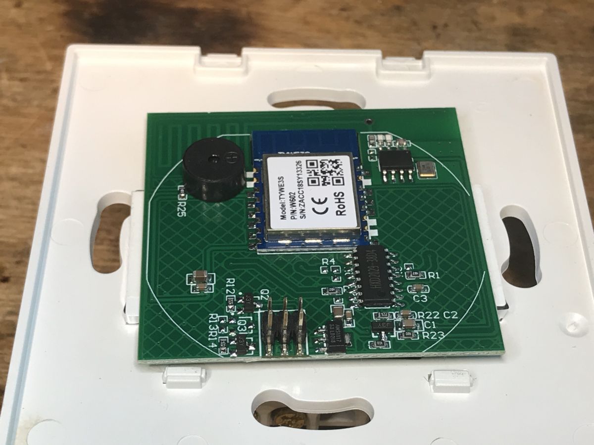

    WiFi module on the PCB of the Appio 9605 switch

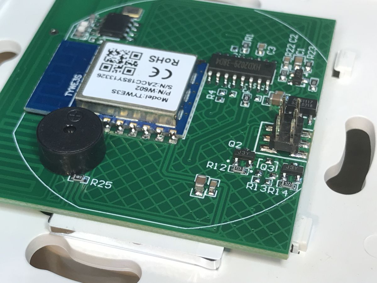

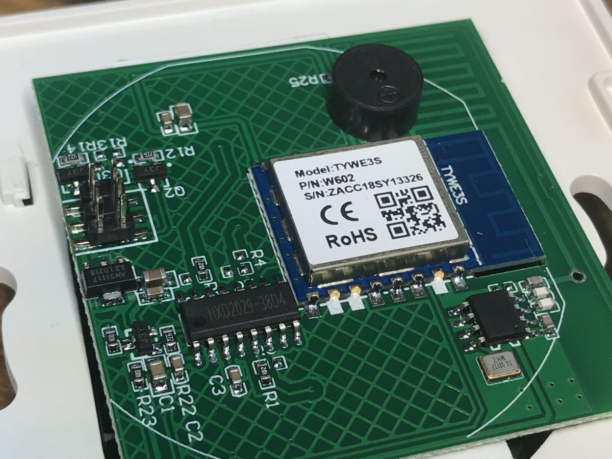

    On its other side we can see the WiFi module and buzzer. This WiFi module seems to be an ordinary TYWE3S with ESP8266 inside, but it has different pins. More on that later.
    Close-up of a PCB with TYWE3S WiFi module and a buzzer. View of the TYWE3S WiFi module on the control board from a light switch. Close-up of a circuit board with a TYWE3S module and other electronic components. View of the interior of a switch based on the TYWE3S module with chip markings on the PCB.
    The buzzer and the system in SO8 with an additional antenna are from the RF 433MHz remote control receiver circuit. The larger HXD2029 chip is both for touch buttons and RF. The RF receiver is connected to it, which means that the WiFi module "does not know" that it is controlled by RF at all, so HXD2029 puts states 0 or 1 on individual pins that are connected to the GPIO of the WiFi module and in this way the WiFi module receives key presses.
    There is also AMS1117-3.3V on the PCB, as usual, because the "power supply" board provides 5V and the WiFi module requires 3.3V.

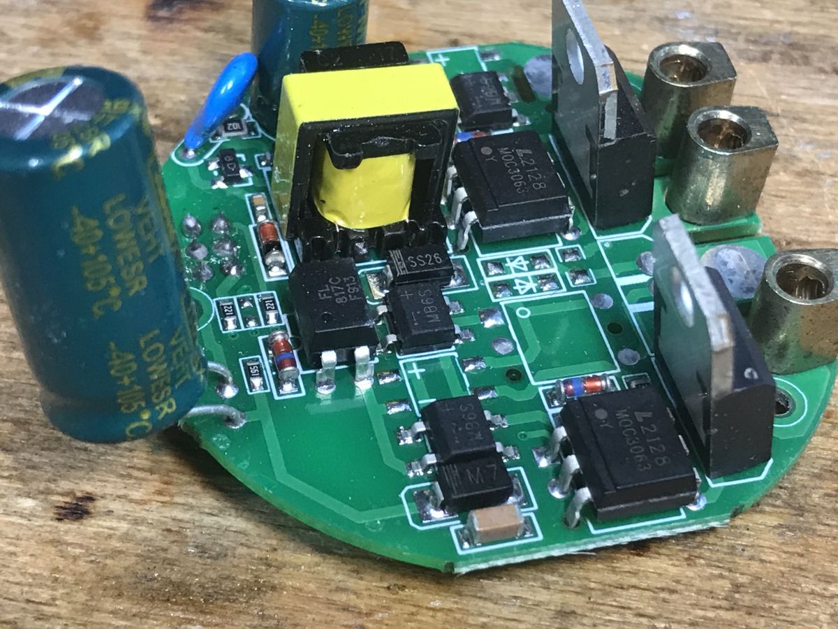

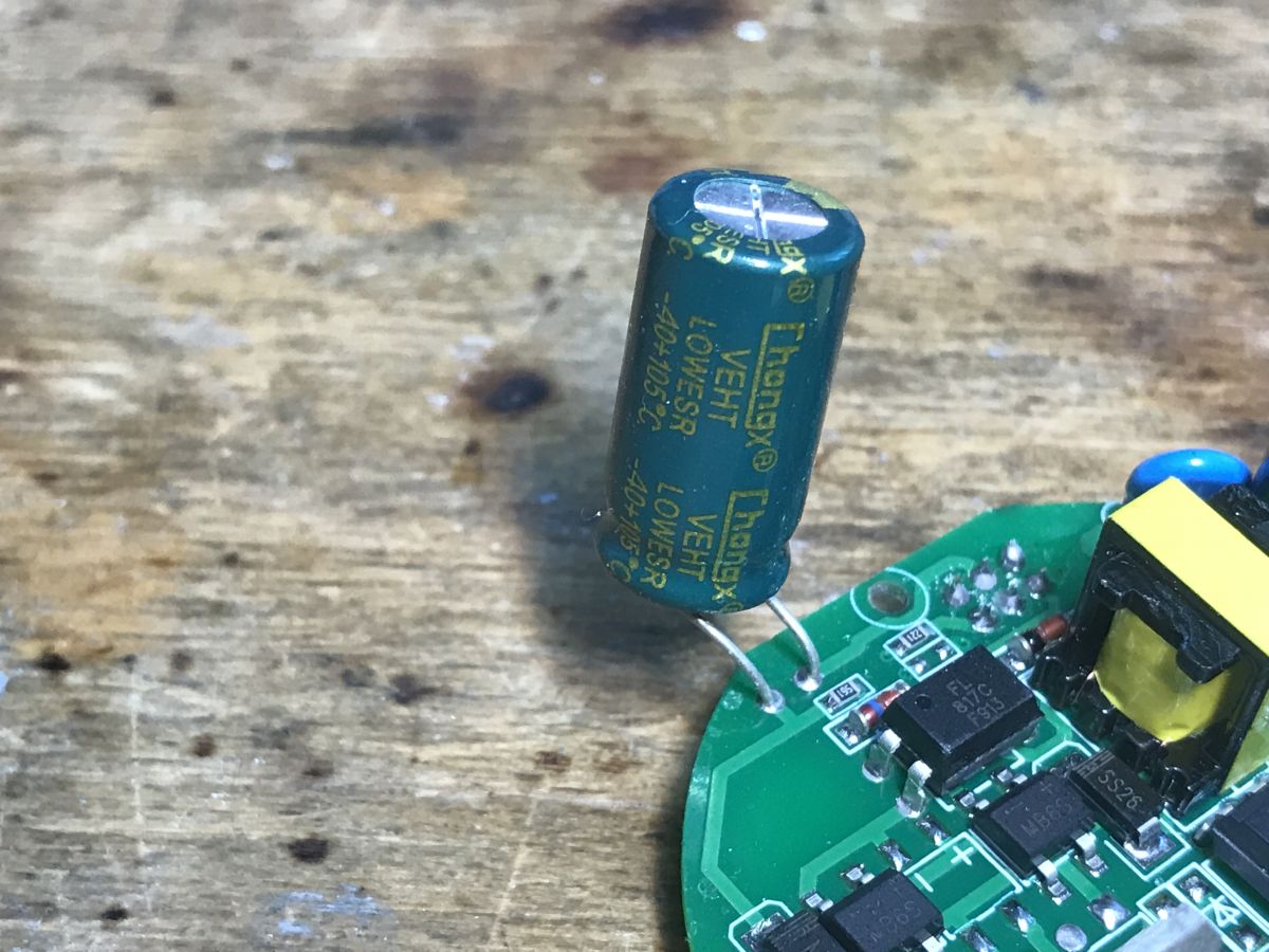

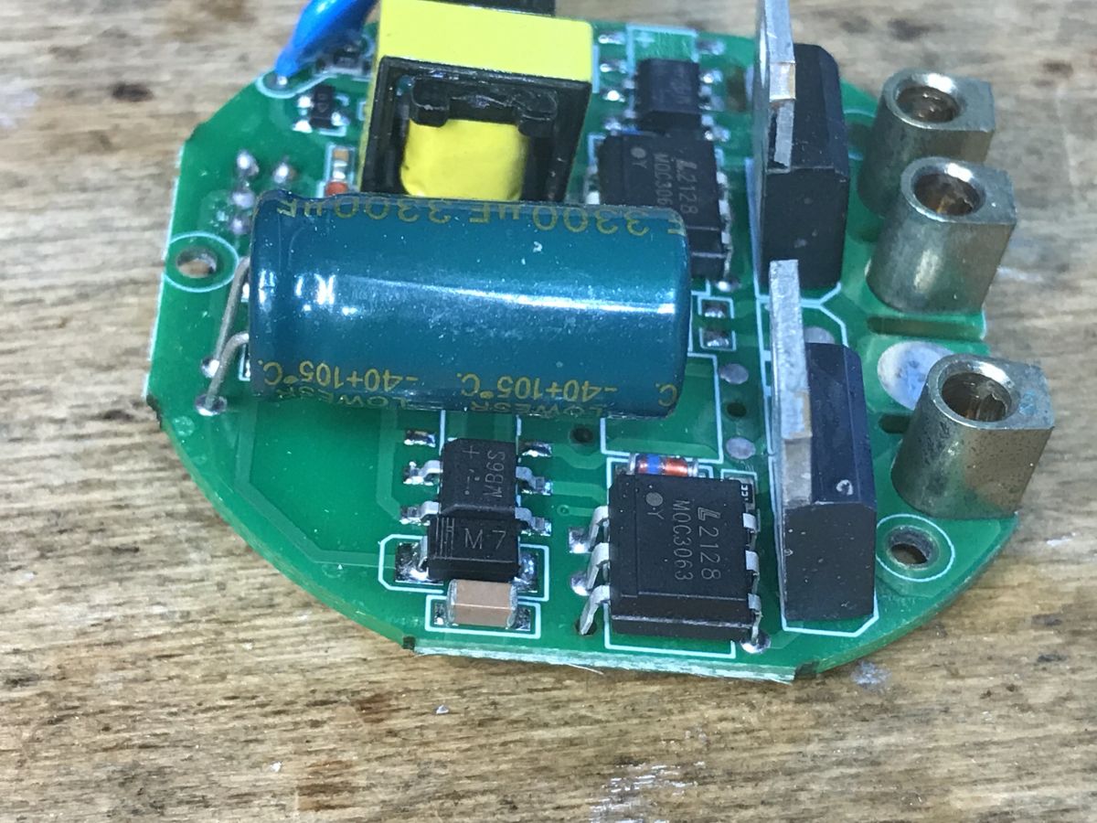

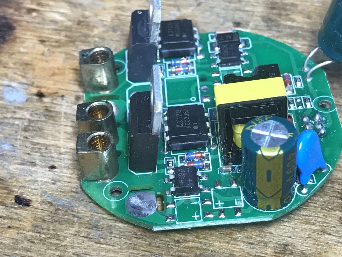

    To change the firmware, all we need to do is remove the board discussed above, but out of curiosity, you can also see the module with the power supply and relays:

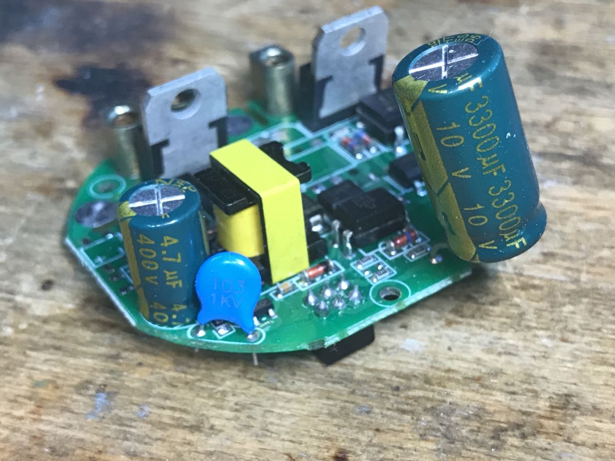

    Printed circuit board with electronic components, including capacitors and connectors. Power supply and relay module from Appio/Lumenix 9605 switch. Circuit board with electronic components, including a capacitor, triac, and integrated circuit. Close-up view of a switch PCB with various electronic components. Interior of the Appio 9605 switch PCB with electronic components. Electrolytic capacitor on a printed circuit board.

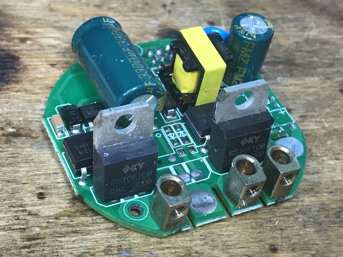

    The bulb switching circuit is based on the GS10F10B triac controlled by MOC3063.
    I have not analyzed here how this switch without the N wire works. I once drew a diagram of a similar switch in the topic QTouch WiFi switch plugged into the L cable only - test, interior, diagram but there was no time for that here.

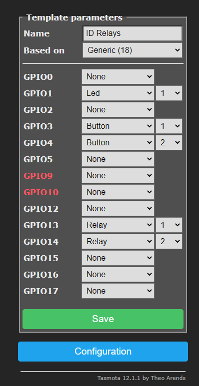

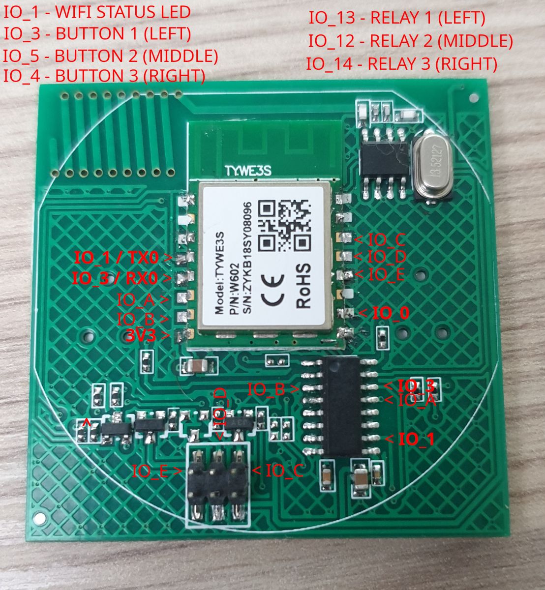

    There was a problem with uploading Tasmota. It turned out that the TYWE3S module here has non-standard pinouts. RX, TX and GPIO0 are in different places than specified in the Tuya documentation. I posted the details in a separate topic:
    Alternative/new GPIO pinout of TYWE3S/ESP8285 WiFi module, Tasmota
    Tasmota Appio 9605 template

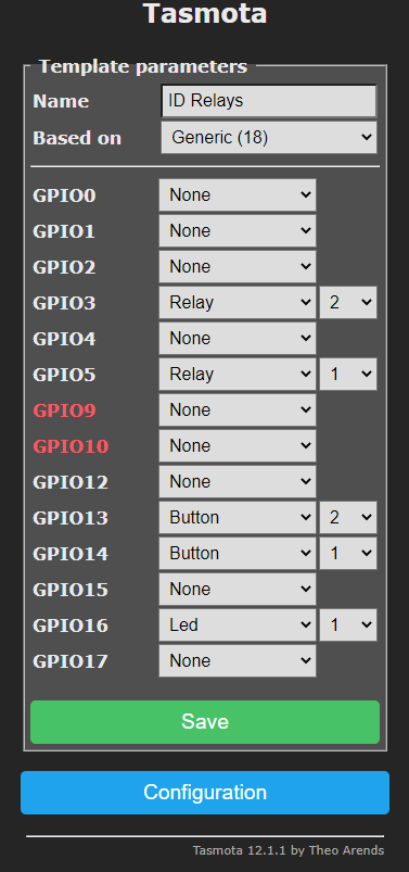

    This time I was lucky. The template from a Github user matched. I am quoting the information I found in this topic : :
    PCB with TYWE3S module labeled with port connections
    Screenshot of Tasmota template settings for the Appio 9605 switch. Tasmota configuration interface on Appio/Lumenix 9605 switch with GPIO selection.
    The first template has started working for me. Everything works:
    If you want the switch to respond faster, it is worth turning on SetOption13 in Tasmota.
