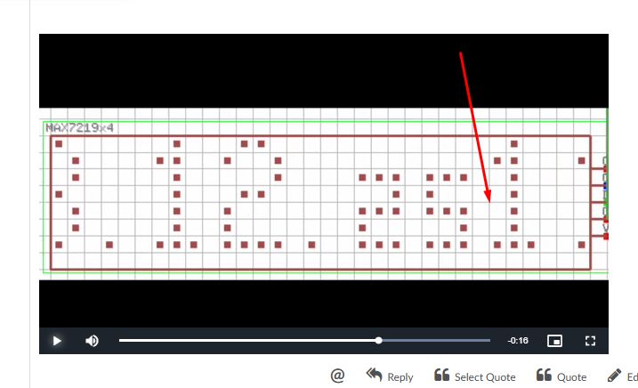

    Since I got my MAX7219 display this weekend, I tried your project (on a W800).
    Maybe you would like to use some of my changes, too?!?
    I missed "seconds" on display, but the numbers wouldn't fit on the display. So I made some changes and additions to the font used.
    Here is the changed part of the "font" in drv_max72xx_single.c
    - small digits in unused chars 10 to 19 (allows for seconds and a (two digit) year on 4 8x8 displays)
    - made "." smaller (46)
    - made digits smaller (4 columns) but same width for all (no "jump" e.g. from "0" to "1" or "1" to "2")

    to use the "small" numbers, the string needs to be "transposed" by -38, so e.g. digit 0 is not using 48 but 10.
    In drv_max72xx_clock.c an additional function:
    void transposeString(char *input, int shift) {
        for (int i = 0; i < strlen(input); i++) {
            input[i] += shift;  // Shift each character by the specified amount
    and this output (no temperature here atm), so, just for testing, I display only time and date.
    I used sprintf to print the data, to "seperate" two chars by another empty columns, I used char "127" (this has 0 columns, so only the one after this empty char is written).
    Seconds and year are first printed to a string, which is transposed to use the small numbers I added to the font.

    Here's how it looks (demonstrating also the setting of the clock):

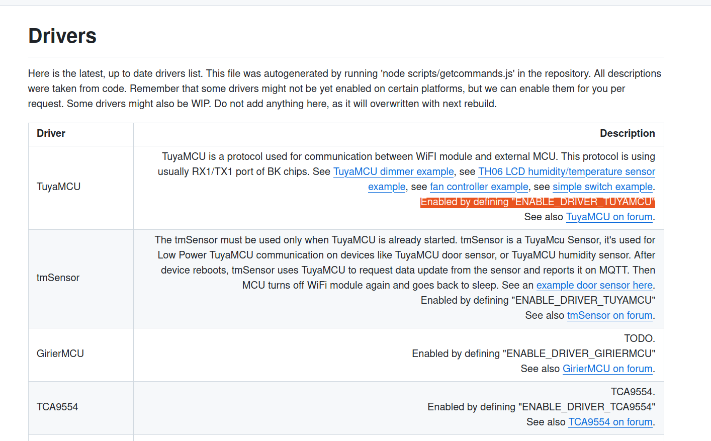

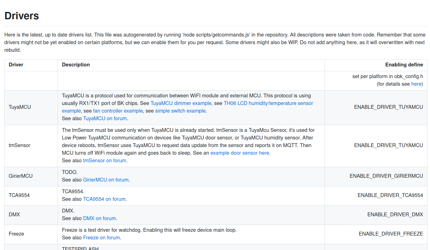

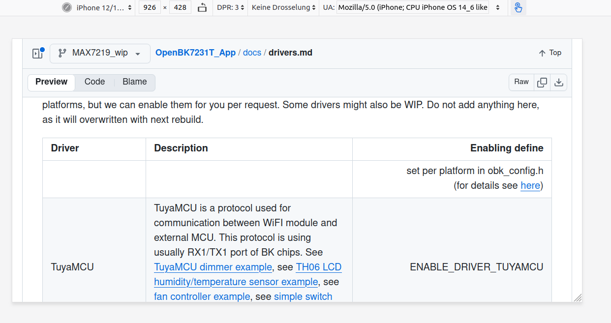

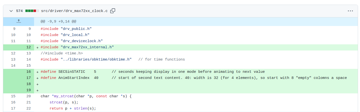

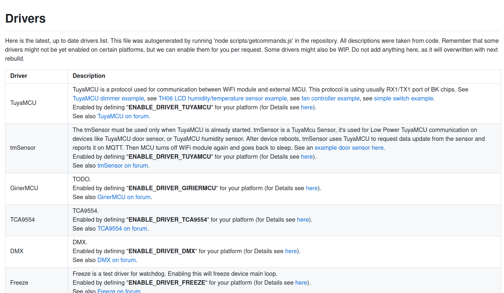

    O.k., lets start with the basics - I made a separate PR1877 only containing the fixes:
    Some drivers were still missing arg "int bPreState" in some XX_AppendInformationToHTTPIndexPage() functions and in drv_main.c some functions were missed args for "onHassDiscovery".
    If you are interested how I tried a "complete" fix:
    Identifying "incomplete" AppendInformationToHTTPIndexPage() functions by searching all occurrences with "_AppendInformationToHTTPIndexPage(" and fron the results searching the ones without ","
    (since it should be _AppendInformationToHTTPIndexPage(http_request_t *request, int bPreState) the missing "," indicates a missing ", int bPreState" )
    Spoiler:

    To find "missing" args for "onHassDiscovery" I searched all "driver lines" and counted the number of "," (it should be 9, but some only had 8)
    Spoiler:
    max@Max-PC:~/run/shm/tmp/OpenBK7231T_App$ sed -n  "/{[^}]*}/ {s/[ \t]*//g; s/{//; s/,[^,]*/,/g p}" src/driver/drv_main.c | awk -F "," '{printf("%-20s\t%i\n"), $1 , NF-1}'

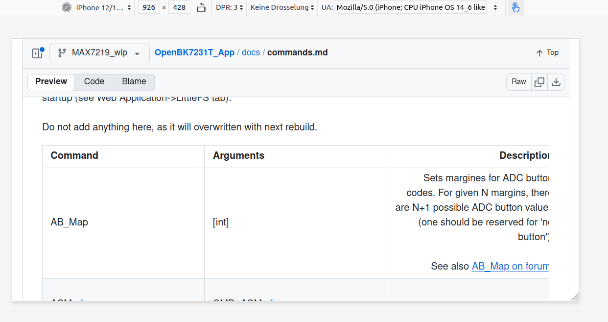

  • #34 21767805
    Posts: 14827
    Rate: 13009
    Nice, just check if (already partially broken?) getcommands.js still works. It's the script that generates docs
  • getcommands.js fixed for multiline command layout

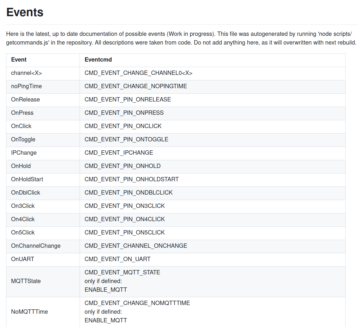

    To be honest, I didn't check that (and I should have done, since I "repaired" it some time ago ;-)). Will do an report here about the results.
    Added after 2 [hours] 49 [minutes]:
    You were absolutely right, "getcommands.js" would struggle with the new layout for "commands" in drv_main.c now spanning multiple lines.
    Fixed now, so it works, but running the command shows, there are quite some possible new fixes to make documentation "clean" ;-):

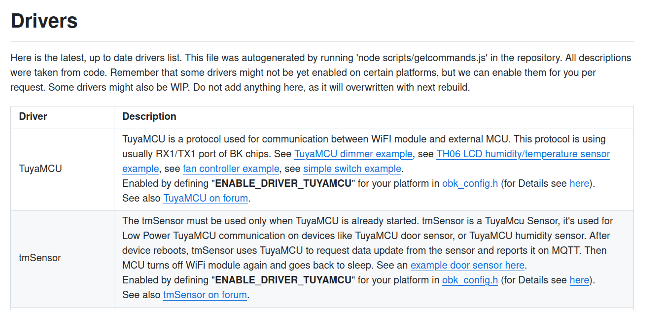

    duplicate driver docs at file: ./src/driver/drv_main.c line: static driver_t g_drivers[] = {
    updated ./src/driver/drv_main.c

     #ifdef ENABLE_DRIVER_GIRIERMCU
    +   //drvdetail:{"name":"GirierMCU",
    +   //drvdetail:"title":"GirierMCU",
    +   //drvdetail:"descr":"TODO",
    +   //drvdetail:"requires":""}
        { "GirierMCU",                           // Driver Name

  • #36 21768233
    Posts: 14827
    Rate: 13009
    Saving related #if definition name is a good idea. Maybe for now add a hardcoded fix or allow multiple if values for single driver name. So, keep an array.
  • #37 21768357
    max4elektroda
    Posts: 758
    Help: 49
    Rate: 189
    I think I didn't get it, the message only indicates that the documentation is not "unique", but what about the code itself?
    Both drivers are registering the same commands, if I'm not mistaken.
    I didn't/don't use IR, so I'm not sure what happens, if both are present, or is there something preventing enabling both?
  • #38 21768745
    Posts: 14827
    Rate: 13009
    Ah, that's what you asked for. Well, then explanation is simple - it's not possible to use both at the same time and they are never present in single binary together.
  • Duplicate IR command docs are harmless to ignore
    #39 21770009
    max4elektroda
    Posts: 758
    Help: 49
    Rate: 189
    I did "tune" getcommands.js a bit more. Now the only "complaints" left are:
    $ node scripts/getcommands.js >/dev/null
    duplicate command "IRSend" docs at file: ./src/driver/drv_ir_new.cpp line: //cmddetail:{"name":"IRSend","args":"[PROT-ADDR-CMD-REP]",
       first seen in "driver/drv_ir.cpp"
       First found:
          "{"name":"IRSend"
             "args":"[PROT-ADDR-CMD-REP-BITS]"
             "descr":"Sends IR commands in the form PROT-ADDR-CMD-REP-BITS, e.g. NEC-1-1A-0-0, note that -BITS is optional, it can be 0 for default one, so you can just do NEC-1-1A-0"
             "fn":"IR_Send_Cmd"
             "file":"driver/drv_ir_new.cpp"
             "requires":""
             "examples":""}"
       this occurence:
          "{"name":"IRSend"
             "descr":"Sends IR commands in the form PROT-ADDR-CMD-REP, e.g. NEC-1-1A-0"
             "fn":"IR_Send_Cmd"
             "requires":""
             "examples":""}
    duplicate command "IREnable" docs at file: ./src/driver/drv_ir_new.cpp line: //cmddetail:{"name":"IREnable","args":"[Str][1or0]",
       should be safe to ignore, they are equal beside the file name!
    duplicate driver docs (in "static driver_t g_drivers[] = {") for drv.name="IR" at file: ./src/driver/drv_main.c  --  actual line://drvdetail:{"name":"IR",
       last "#if" statement: "#if ENABLE_DRIVER_IR"
       first defined with "#if" statement: "#if ENABLE_DRIVER_IRREMOTEESP"
       should be safe to ignore, because documentation is equal!
    So in the end, there's only one point open:
    The two commands "IRSend" differ in their description - then its impossible to "write" a (simple/automated) documentation if the arguments for the same command are not the same.

    What about
    Drivers table with descriptions and activation info via #define macros.
    diff --git a/scripts/getcommands.js b/scripts/getcommands.js
    index c989aa178c..28cdffaa9b 100644
    --- a/scripts/getcommands.js
    +++ b/scripts/getcommands.js
    @@ -412,6 +412,7 @@ function getFolder(name, cb) {
     										 else console.error('\tFirst occurence:\n\t\t"' + JSON.stringify(drvindex[drv.name])  + '"\n\tactual:\n\t\t"' + JSON.stringify(drv) + '"' );
     										//console.error(line);
     									} else {
    +										drv.define = 'Enabled by defining "' + lasthash.replace(/#if[^ ]* /,"") + '"';
     										drvs.push(drv);
     										drvindex[drv.name] = drv;
     										drvdefines[drv.name] = lasthash;
    @@ -1044,7 +1045,7 @@ for (let i = 0; i < drvs.length; i++) {
     	let descMore = "<br/>" + genReadMore(drv.name);
     	let descBasic = formatDesc(drv.descr);
    -	let textshort = `| ${drv.name} |  ${descBasic}${descMore} |`;
    +	let textshort = `| ${drv.name} |  ${descBasic}\n${drv.define}${descMore} |`;
     	// allow multi-row entries in table entries.
     	textshort = textshort.replace(/\n/g, '<br/>');
  • #46 21771396

    Two ideas, please choose:
    all in second column:
    Driver table listing names and usage descriptions for various MCU modules
    add a third column:
    Table of drivers with descriptions and defines for enabling them
  • #48 21772187
    Posts: 14827
    Rate: 13009
    Which is more mobile friendly? I don't have strong feelings one way or the other, but I think we may have some mobile users?

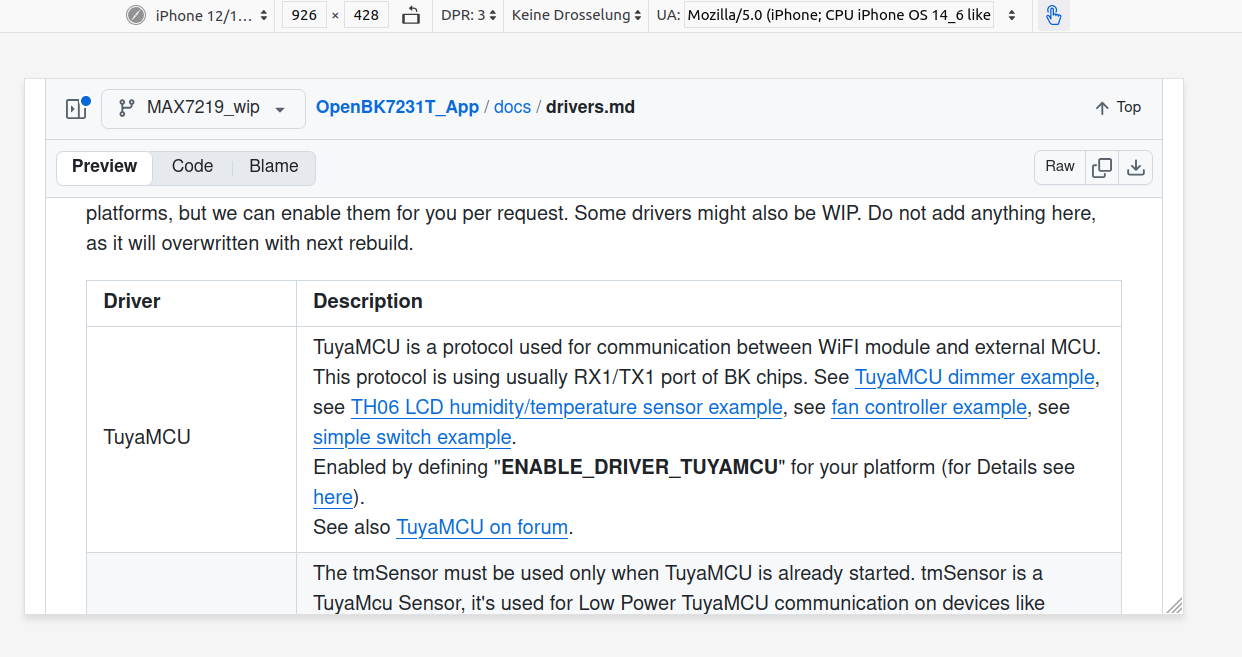

  • Two-column layout fits small displays better
    #49 21772201
    max4elektroda
    Posts: 758
    Help: 49
    Rate: 189
    Two columns are easier on a small display, as an example this is what it will look like on an older iphone 12/13 (landscape).
    Driver table from OpenBK7231T documentation showing TuyaMCU protocol entry
    Documentation table for TuyaMCU driver with description and example links
    On the other hand, we now have some three column docs, too, e.g. for commands, which won't even fit:
    Screenshot of GitHub documentation table showing the AB_Map command entry
  • #50 21772214
    Posts: 14827
    Rate: 13009
    Let's do two columns and merge, we can improve futher docs later.

    Very nice, I think it could be acceptable for DIY and I will merge it, but could you add a space there?
    Digital LED display grid showing the time 12:36 with a red arrow pointing at digit 3
    Also, I assume it loops seamlessly? And humidity/temperature etc is shown only if there is a sensor.

    ...but could you add a space there?
    Done (https://github.com/openshwprojects/OpenBK7231T_App/pull/1889), the space or time in "static" can be changed here, if you like more/less space:
    Code snippet with added SECSinSTATIC and AnimStartIndex definitions
    Looks good for me, but you can easily try with simulator from build if it's o.k for you (screen recording is a bit lagging, because it's done in a VM).
    And if temp/hum is not present, it will be skipped,

    At least a minimum version can be found here here in PR#1888:
    Changed the text driver so the "define part" will point to obk_config.h
    Table listing TuyaMCU and tmSensor drivers with descriptions and documentation links
    And a very basic doc for events:
    Table listing possible events with corresponding Eventcmd commands in OpenBK7231T.

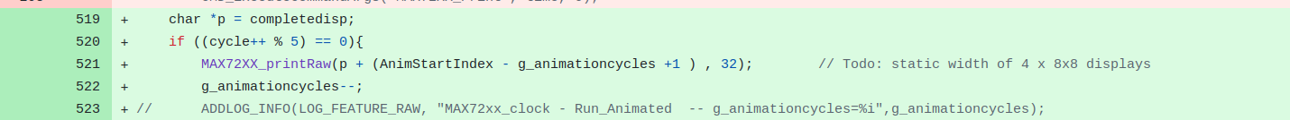

    Added after 8 [minutes]:
    If yo want animation faster/slower, you can change the modulus here to call animation more or less often:
    C code snippet with conditional function and MAX72XX_printRaw call
