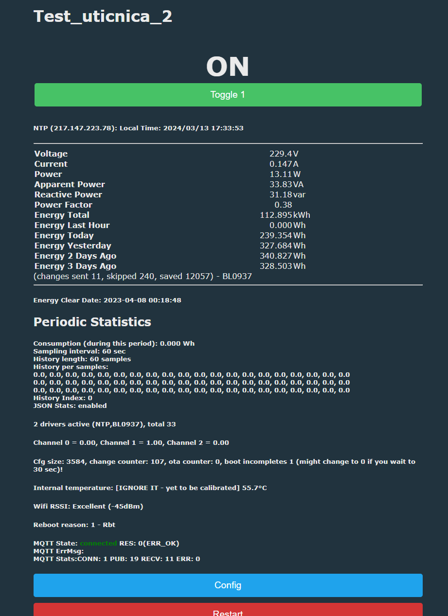

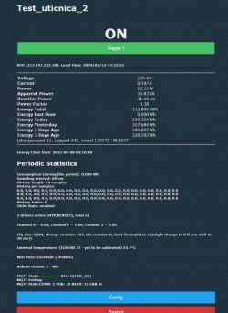

    The temperature is OK, but displayed data of power consumation is not OK from few last builds of FW
    Screenshot showing energy statistics from a sensor and system settings.

    Does the problem persist after resetting the energy counters?

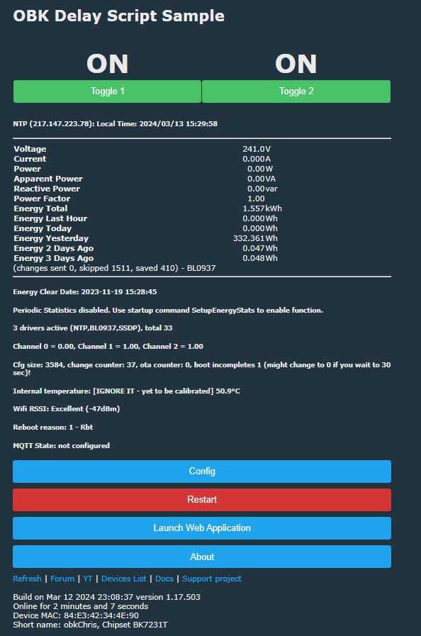

    EDIT: seems ok for me?
    Screenshot of the OBK delay script interface showing energy measurements.

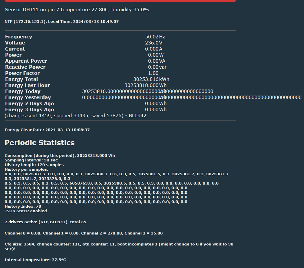

    Does the problem persist after resetting the energy counters? YES, in picture shown "energy clean data". First shown value is OK, after second - problem persist. In "Periodic statistic" - too. My last and worked ok version has been OpenBK7231N_1.17.439.rbl, after I flash with 501, and see this problem. I back 439 again, and problem exist after reset counters...

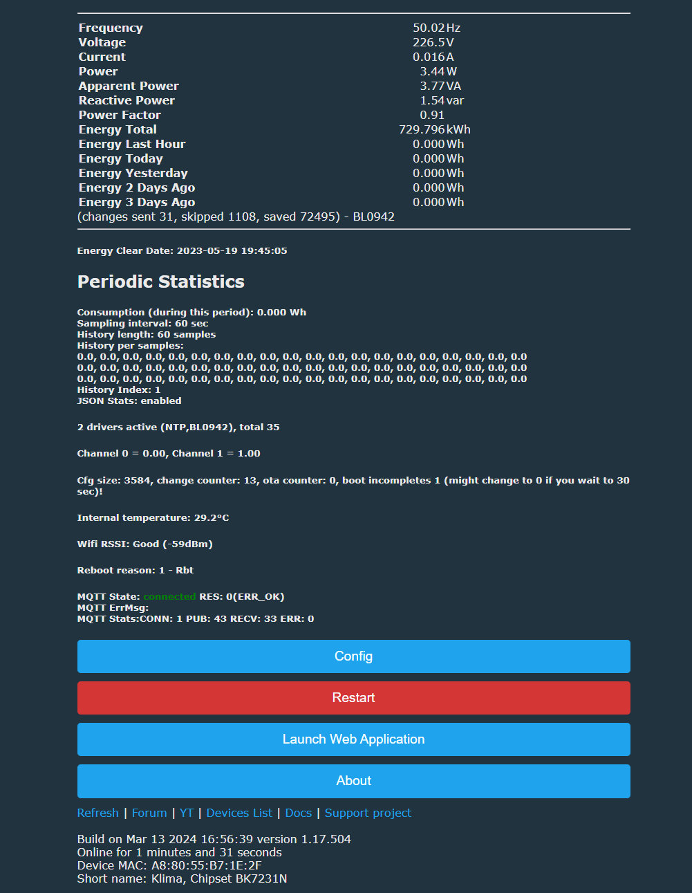

    before
    Screenshot of a device control panel displaying power information, periodic statistics, and restart options.
    after
    Screenshot of a user interface displaying energy statistics for a device.

  • #8 21011887
    mminkov
    Posts: 18
    >>21004145
    Problem solved. Inflated capacitor in box of module....
