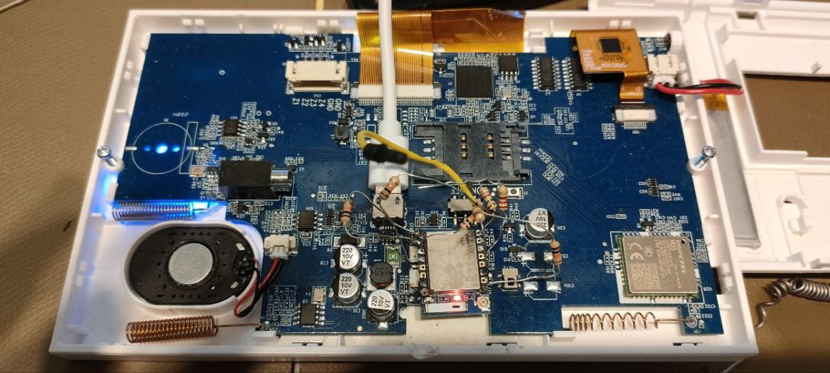

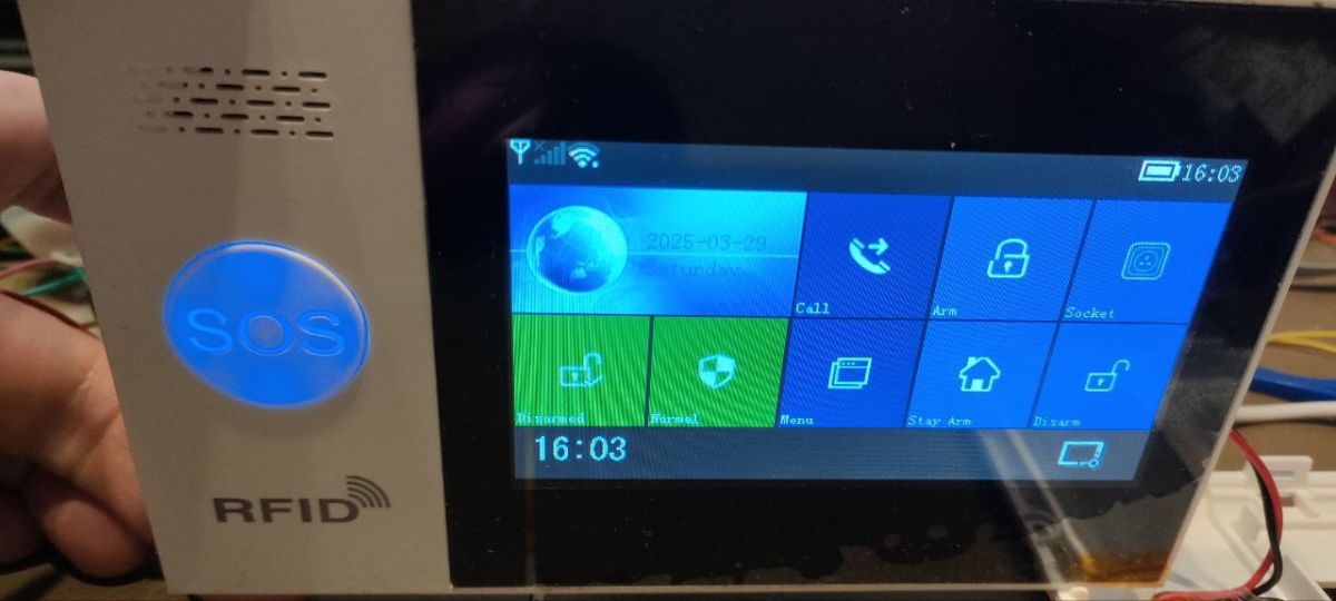

    Hello everyone! I have a pg107 alarm system with a cb3s Wi-Fi module, this module has problems connecting to Wi-Fi. I decided to replace it with an esp8266 with tasmota firmware. PG107 has an allwiner mcu with a tuya mcu protocol, I recognized all the functions and even created rules for time and Wi-Fi status, but I don't know how to coordinate the functions with Tasmota and home assistant or best variant for me its connect esp8266 with smart life. Also i read dump from cb3s.
    Link
    Electronic board with various components.
    Control panel display with SOS button and security functions.

    I know that all pg107 devices have a wifi disconnecting problem, i dont understand how recognize where the problem.
    Present settings are: configuration of module tuyamcu(54), tuya tx-gpio1 tuyarx gpio3,

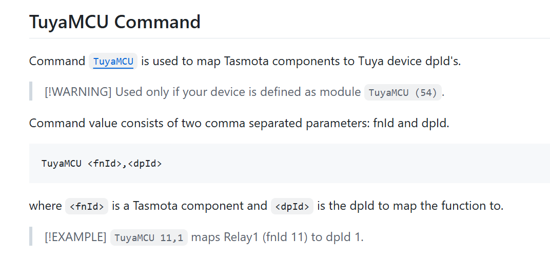

    Screenshot of documentation describing the TuyaMCU command for mapping Tasmota components to Tuya device dpId.
    Btw: Your TuyaMCU code link is invalid

    >>21520394 I want create enum function for dpid 1(arm, disarm, home, sos modes) but tasmota doesn't save map, for example tuyamcu 21,1, after changing this setting tasmota returns fnid to default! Maybe it is not necessarily, i think i can use mqtt to manage alarm system. I would like to use tuya cloud, do you have any idea how to fix cloud or wifi problems?
    I sniff messages from mcu and dont understand why a mcu request mac address even it receives mac, this could be the root of the problem.
    When cb3s was connected mcu requested weather information, with esp this does not happen.

    It would be very easy to handle dpid enumeration in OpenBeken, but if you want to use Tasmota, try creating separate rules per enum value, something like:
    Rule2 + ON TuyaReceived#Data=55AA00070005650400010075 DO Var2 sC3; ENDON
    The syntax may be wrong. I've taken it from there:
    https://gist.github.com/markus-li/ff407c891834a8e2670268ddd52b8330
    but TuyaReceived should help with triggering events on any TuyaMCU packet. What do you think?
