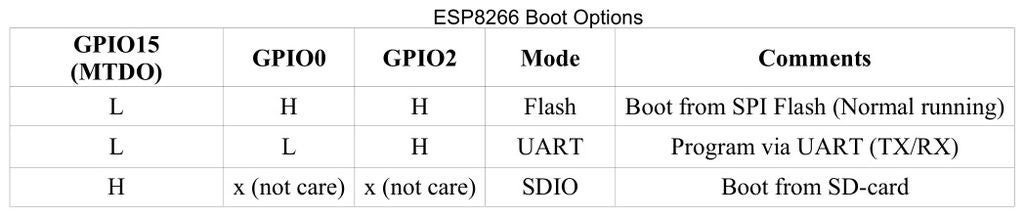

    We will boot with SPI Flash, so you can see where you will need to solder resistors for this ESP12F ...
    If we replace the unknown module in the Smart device with ESP and this ESP does not turn on, it is not worth getting discouraged, but you need to check in the catalog note whether all the requirements are met.

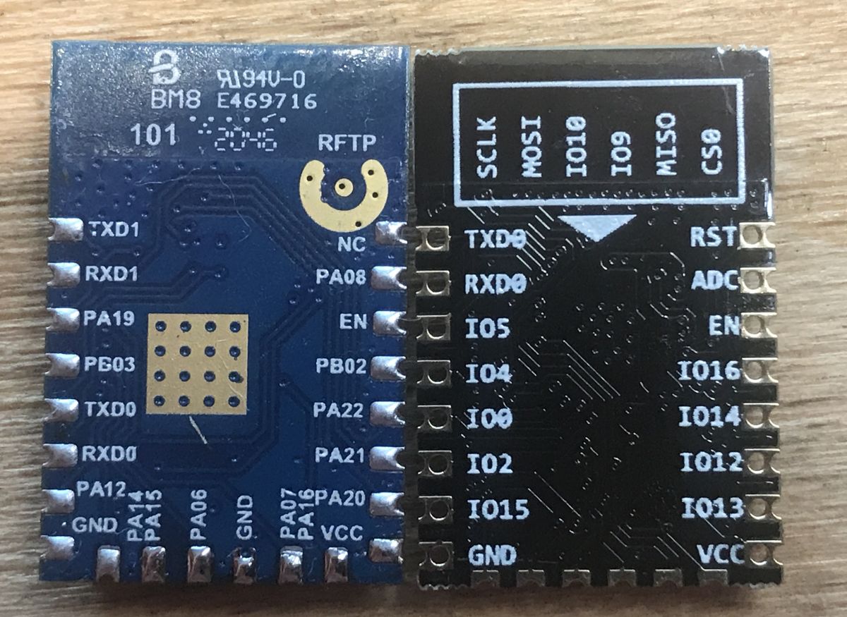

    Comparison of both modules
    We will take this opportunity and compare both modules visually. Haven't seen the XR3 from below yet. Both have signed pads. At first glance, the conclusions are compatible.
