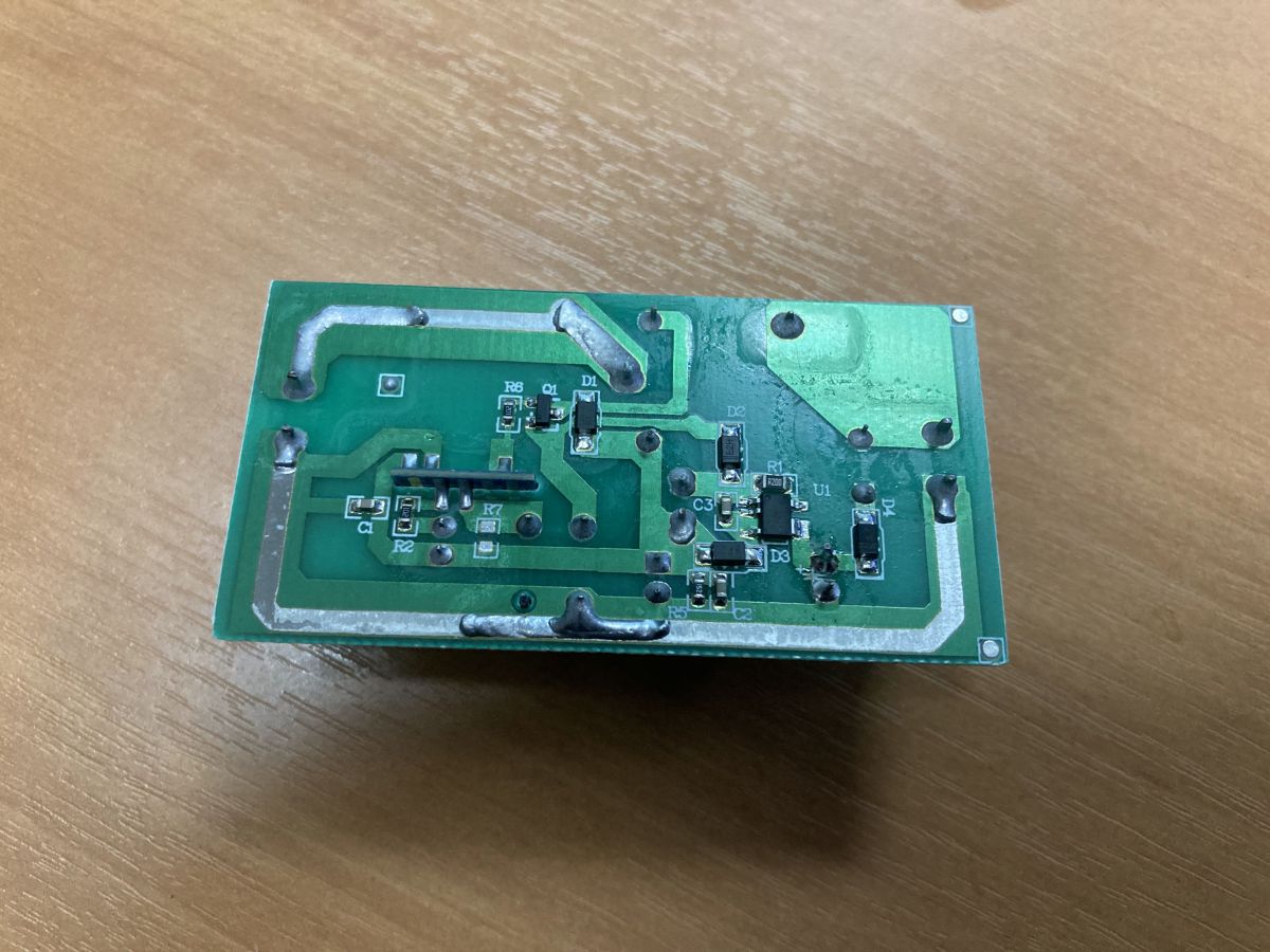

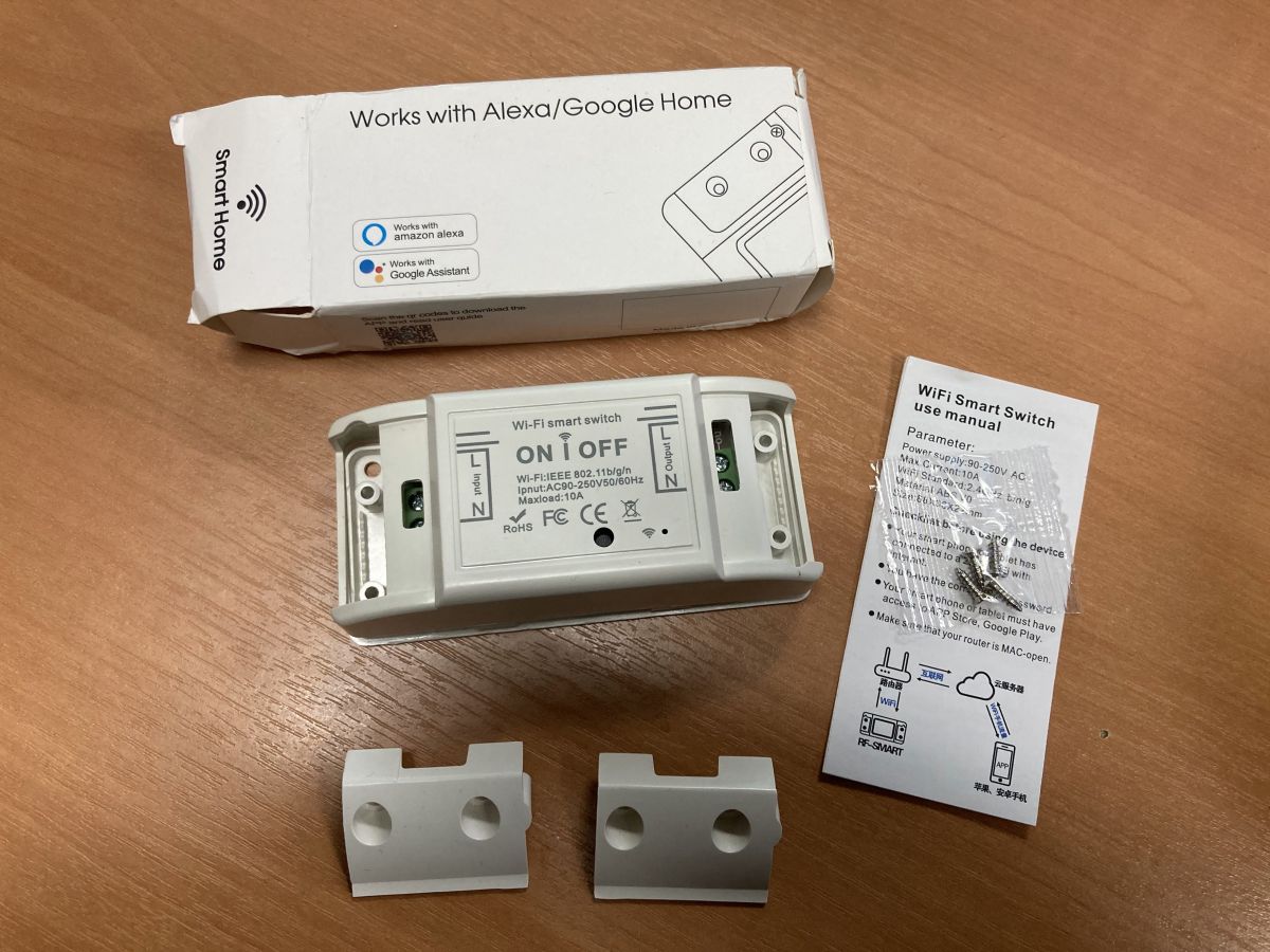

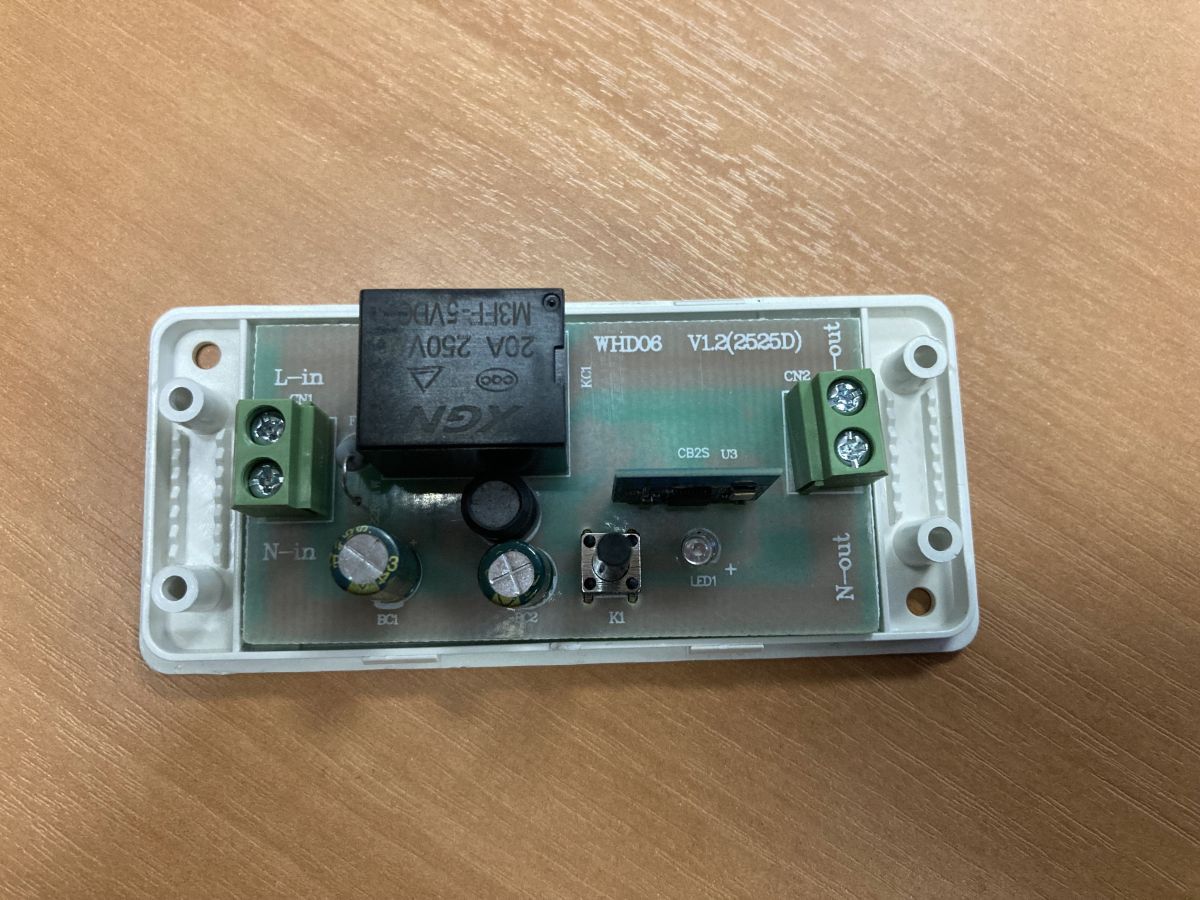

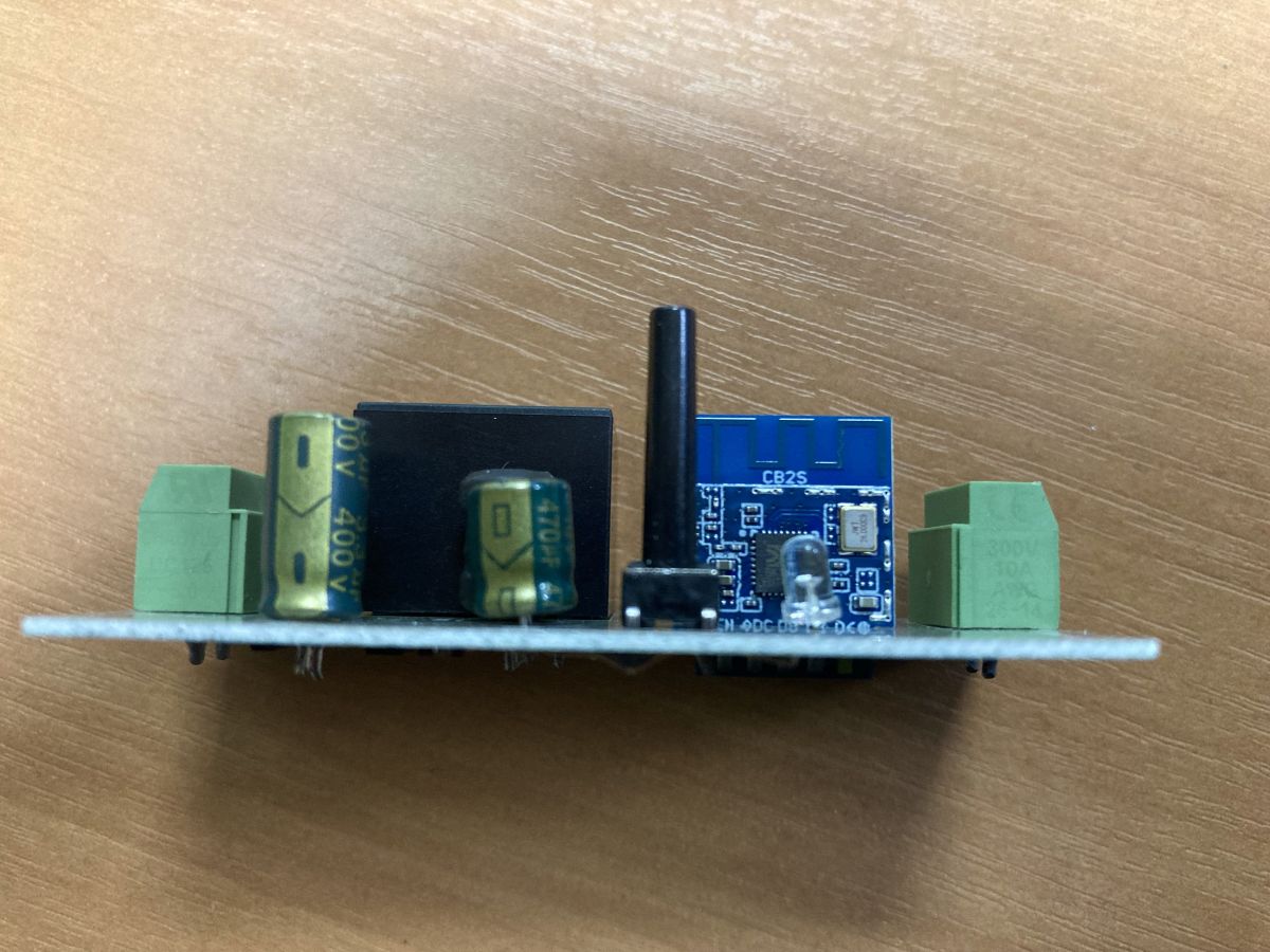

    Teardown and config for Sonoff-style WHD06 V1.2(2525D) 10A 1Channel Smart Breaker. Original firmware dump attached.

    - Pair/Toggle All Button on P8
    - WiFi LED on P7
    - TglChannelToggle (channel 1) on P23
    - Relay (channel 1) on P24
    Photos
    Spoiler:
    Sonoff WHD06 smart Wi-Fi switch set on a table.
    Open casing of Sonoff WHD06 V1.2 smart switch with visible electronic components.
    Close-up of the Sonoff WHD06 smart switch PCB.
    Close-up of the circuit board of a Sonoff WHD06 smart switch.
