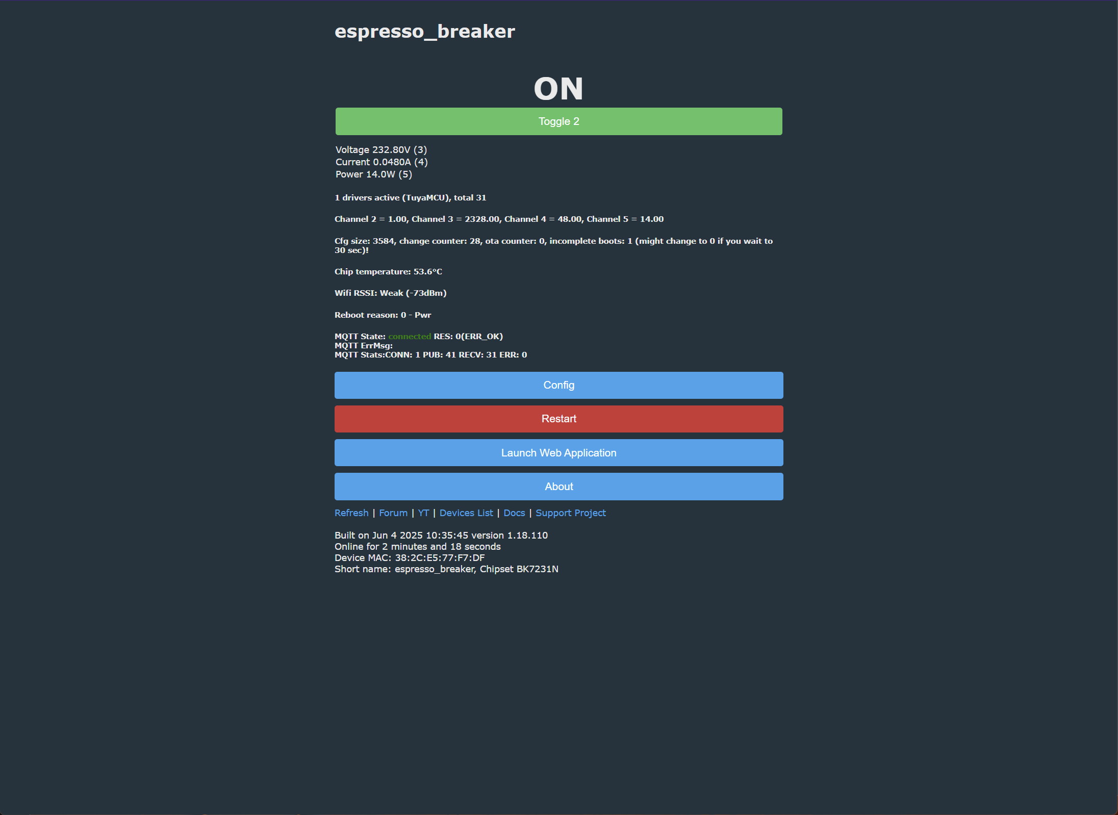

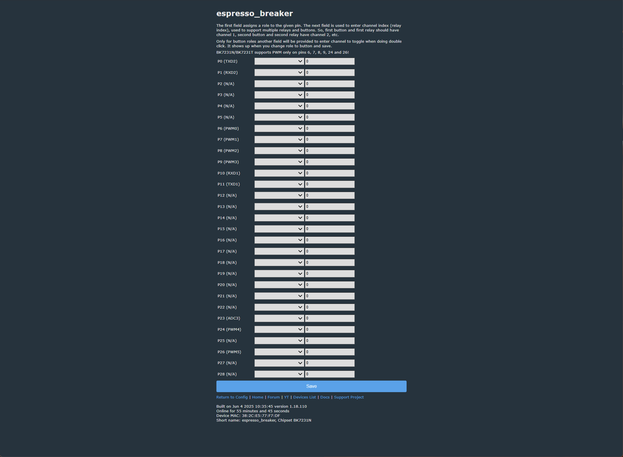

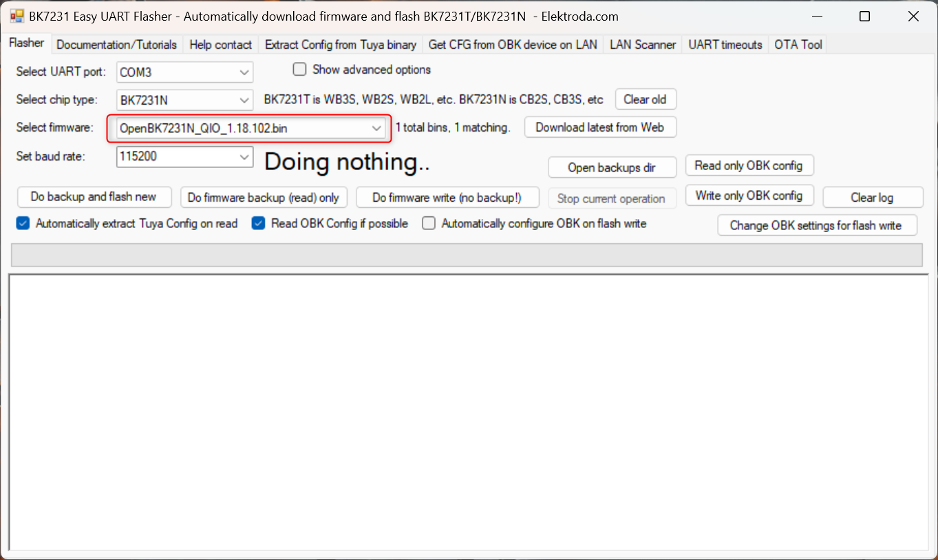

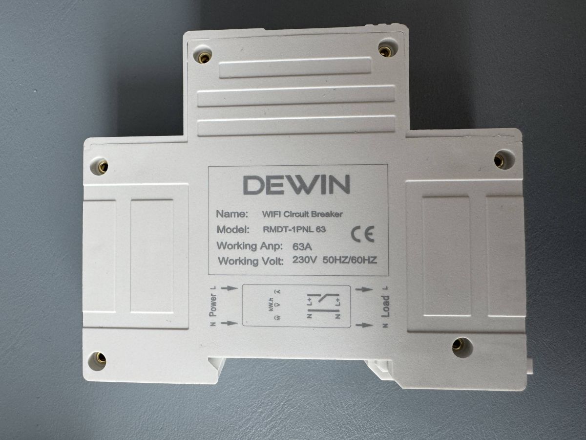

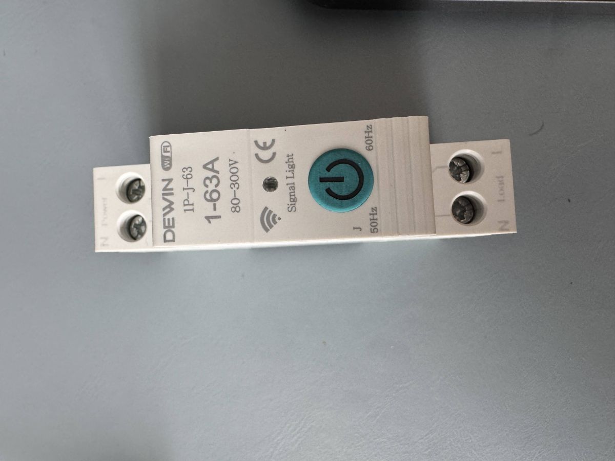

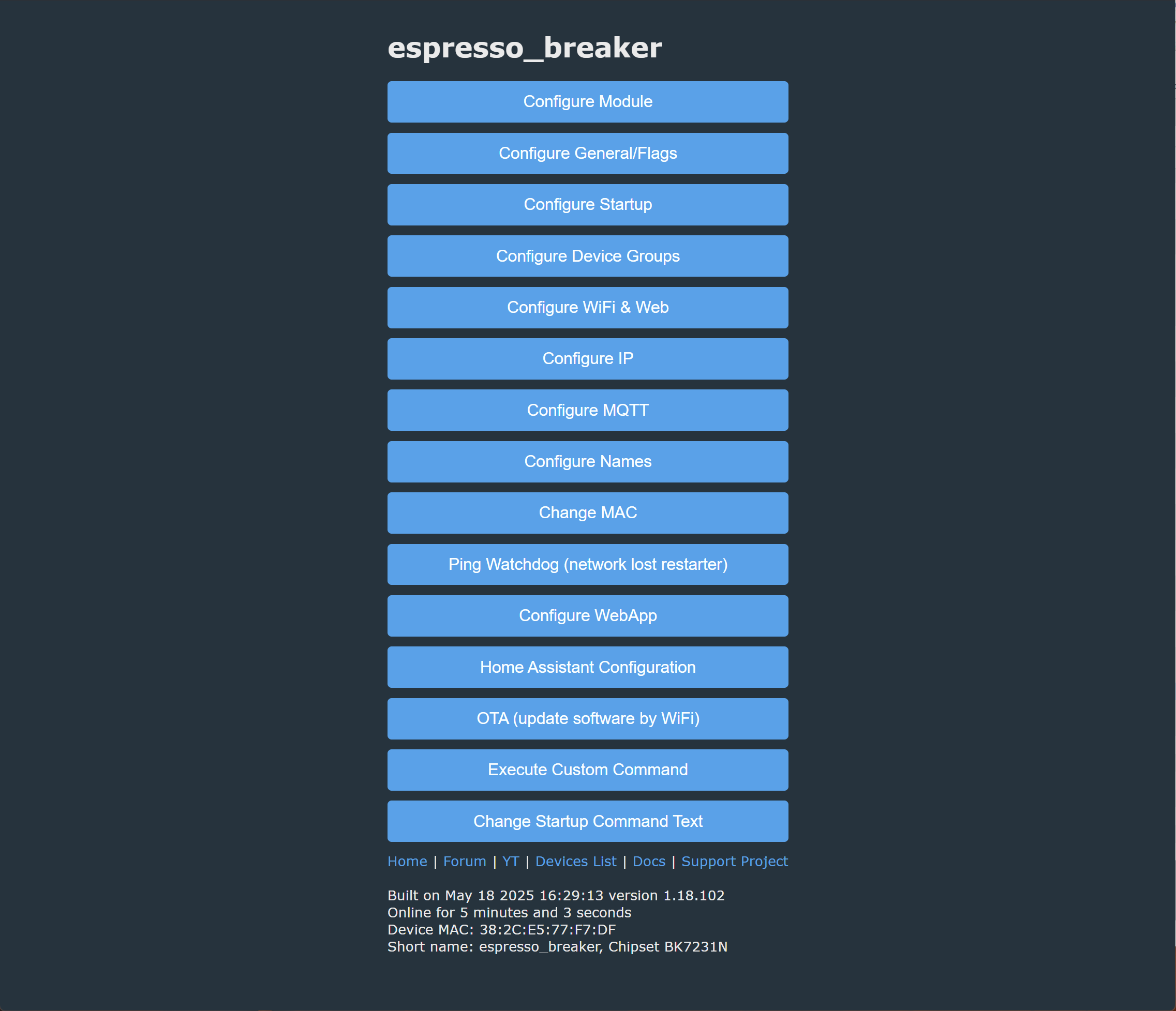

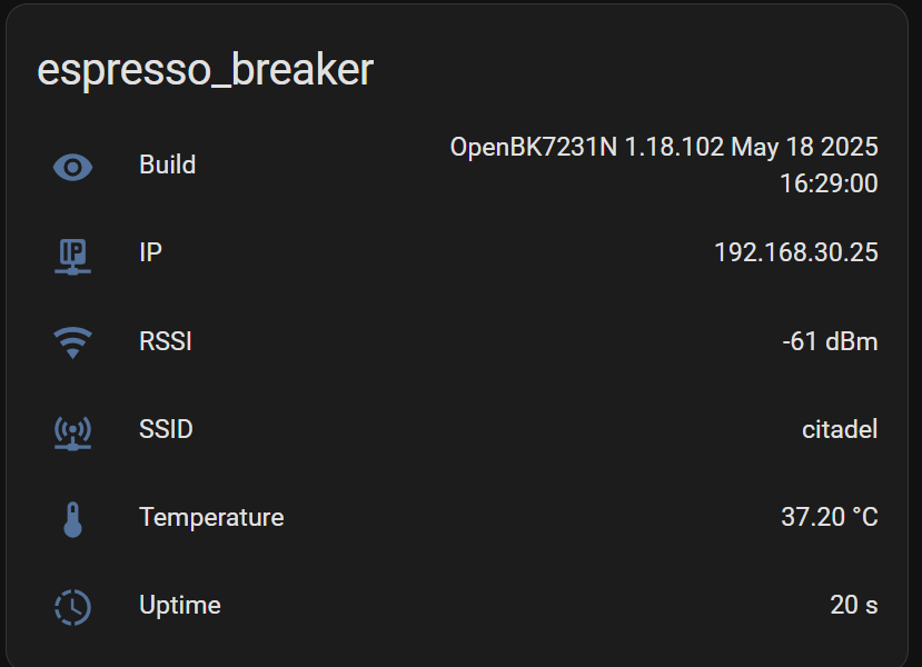

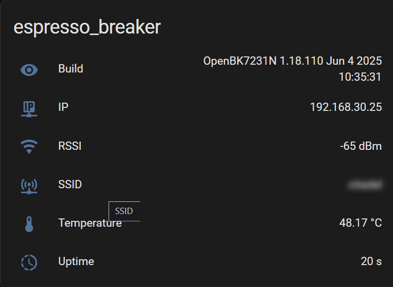

    I'm trying to make it work Dewin Smart Circuit Breaker I purchased from Amazon with my Home Assistant without Tuya cloud. I used the firmware OpenBK7231IN_QIO_1.18.102.bin suggested by BK7231 UART to flash it. After that I was able to add the device to my Home Assistant, but I only see general info and I don't see functionality related to power consumption neither ON/OFF switch in my Home Assistant Dashboard. What I'm doing wrong?
    Screenshot of BK7231 Easy UART Flasher with BK7231N board and OpenBK7231N_QIO_1.18.102.bin firmware selected, currently idle.
    Configuration panel for espresso_breaker device with a list of setup options.
    Status panel of espresso_breaker device showing firmware version, IP address, Wi-Fi signal, SSID, temperature, and uptime.
    White DEWIN WiFi relay 1P-I-63, 1-63A with a button and signal light.
    WiFi circuit breaker by DEWIN, model RMDT-1PNL 63, rated for 63A and 230V operation.

    You need to configure that device after flashing. Either manually guess or try to import the template. It will not work without this step.

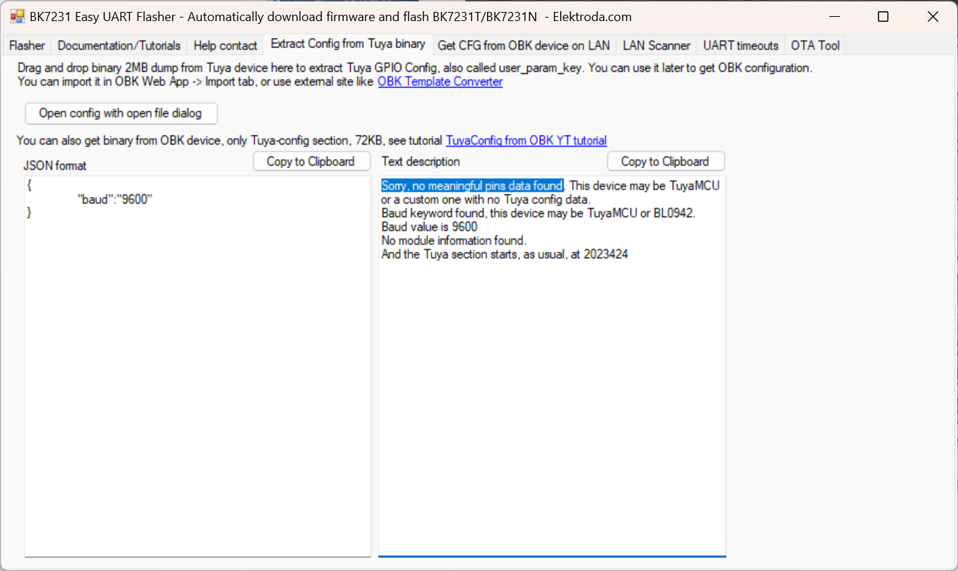

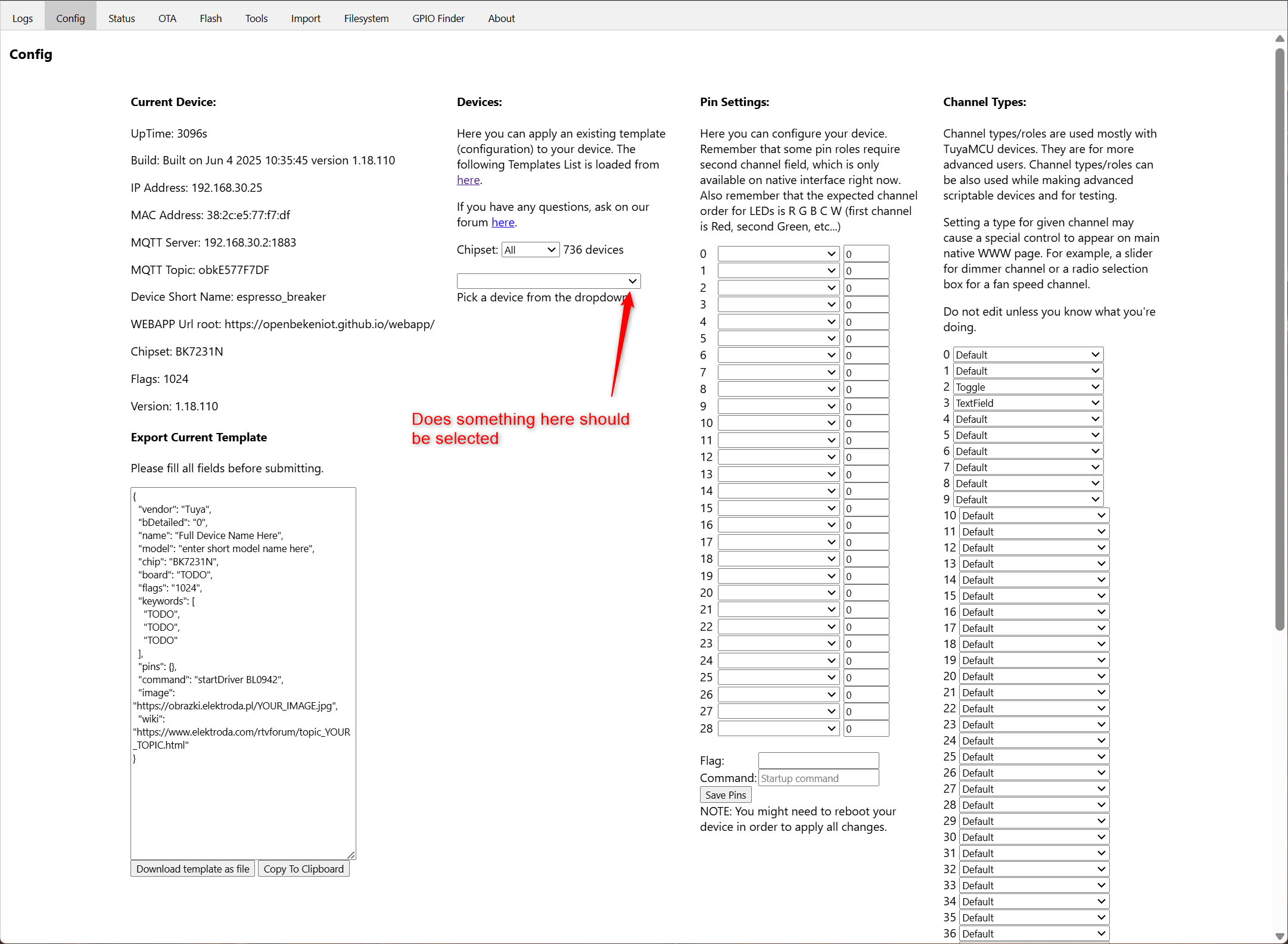

    lubopetrov
    Posts: 39
    I followed the instructions of the video but the message says Sorry, no meaningful pins data found. How to proceed?
    BK7231 Easy UART Flasher window showing no meaningful pins data found message after analyzing a Tuya device binary.
  • #4 21566334
    Posts: 14760
    Rate: 12886
    Maybe it's TuyaMCU device. How the PCB looks like?

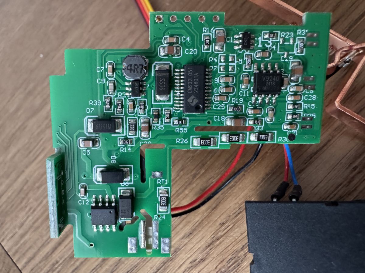

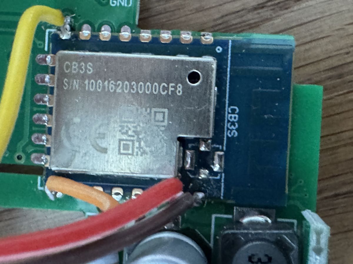

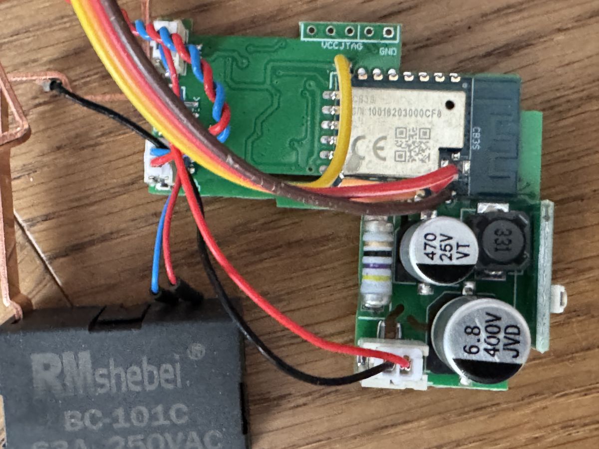

    lubopetrov
    Posts: 39
    Here are the photos of the board.
    CB3S module mounted on a circuit board with attached wires.
    Electronic module with components, capacitors, wires, and a relay.
    Printed circuit board with electronic components, visible ICs, capacitors, resistors, and an inductor.
  • #6 21566792
    Posts: 14760
    Rate: 12886

    First I would like to thank you for your help. Can you please help me to finish with this flash.
    So far I was able to achieve the following:

  • TuyaMCU baud 9600 and paired WiFi state setup
    #10 21572159
    Posts: 14760
    Rate: 12886

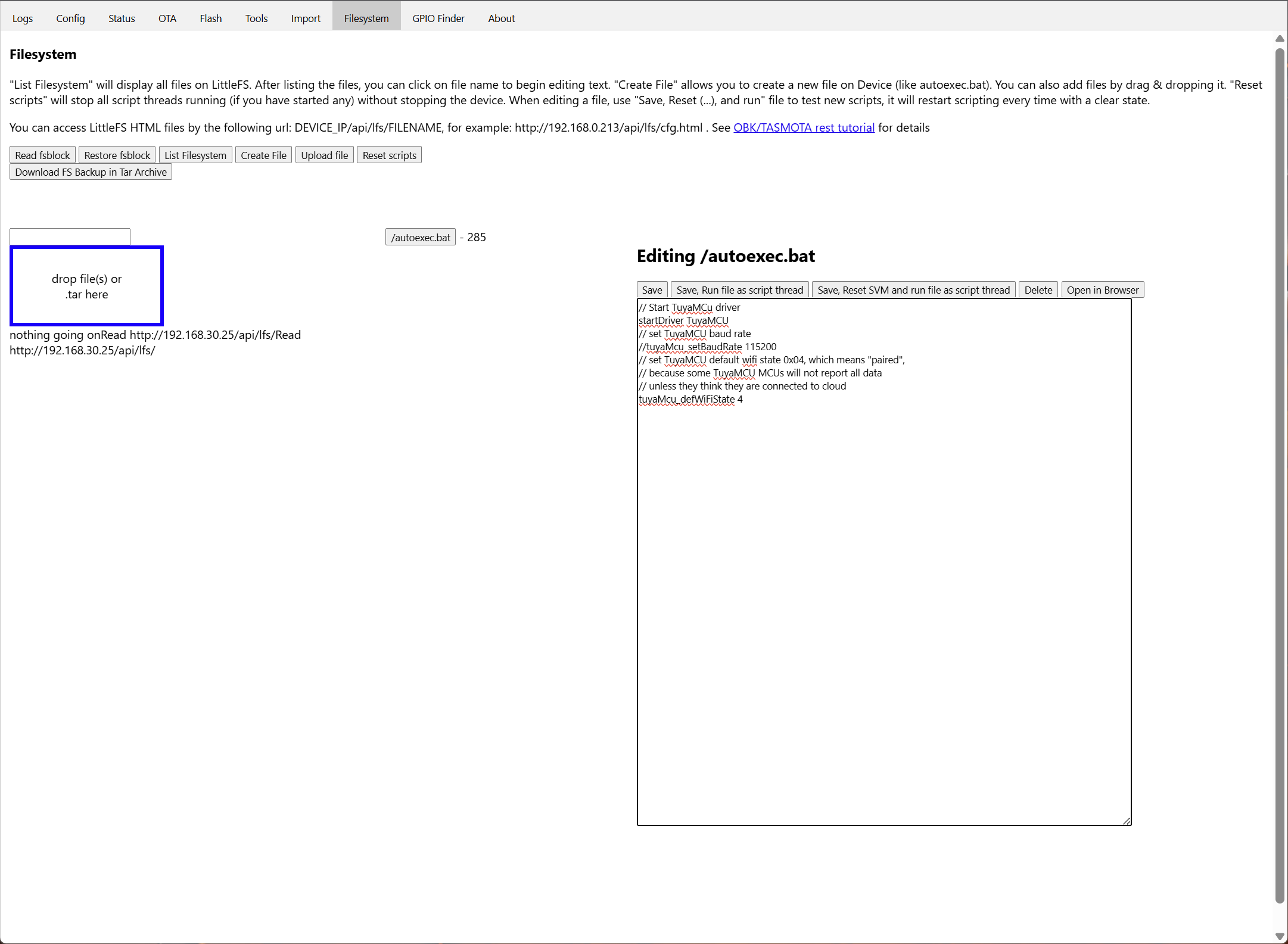

    Your screenshot on post https://www.elektroda.com/rtvforum/topic4123647.html#21566333 shows baud 9600. Let's try TuyaMCU at baud 9600.

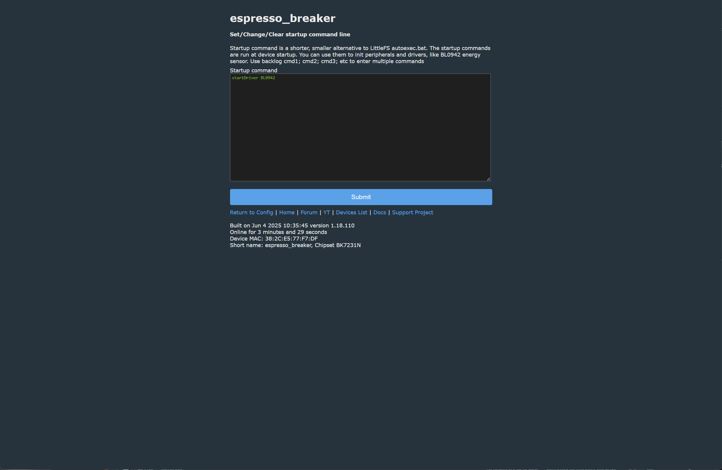

    So, let's do it step by step. I assume you have OBK flashed. So now, just like in:
    First:
    6. Start the driver and check is there a communication
    Now it's time to setup a basic autoexec.bat in OBK:
    Here is a starting config:
    // Start TuyaMCu driver
    startDriver TuyaMCU
    // set TuyaMCU baud rate
    //tuyaMcu_setBaudRate 115200
    // set TuyaMCU default wifi state 0x04, which means "paired",
    // because some TuyaMCU MCUs will not report all data
    // unless they think they are connected to cloud
    tuyaMcu_defWiFiState 4
    The tuyaMcu_setBaudRate is commented out, please remove comment if needed. This should give you basic TuyaMCU heartbeats and communication in the OpenBeken Web App Log. This should also make tuyaMcu_sendQueryState work.
    Do not forget the tuyaMcu_defWiFiState 4 line. By default, OBK sends "paired" state (0x04) only when MQTT is on, but some devices always require the WiFi state to be "paired" (0x04) before sending data. This will control the WiFi LED of the MCU and even may control buzzer. Some devices will send buzzer audio signals when not paired.
    Then save, reboot, check Web App log - copy content of Web App log here (remove SSID if present). We will check if log shows heartbeat of TuyaMCU received?
    Then try command (in web app commandline): tuyaMcu_sendQueryState and show us output.
    You can also do next step already.

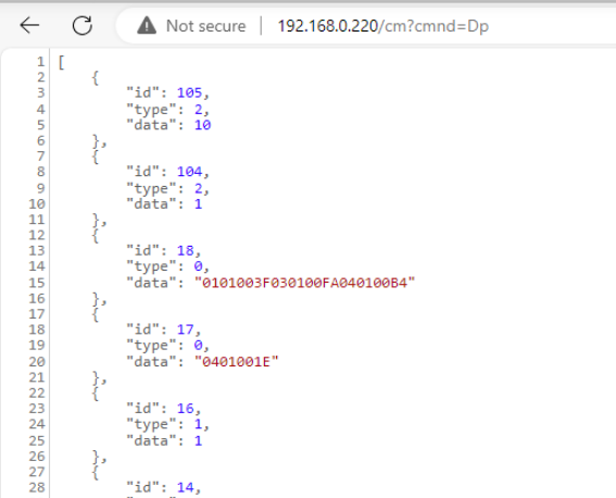

    There is command called DP.
    Screenshot of JSON with dpID data
    In order for it to work, you need to enable the following flag: flag 46.
    This will store last values of dpIDs in hex and allow you accessing them in JSON.
    After some time, maybe also do first tuyaMcu_sendQueryState again, and copy us text from DP command. Check on my screenshot how to enter it - you do it by device URL. It will show seen data points.

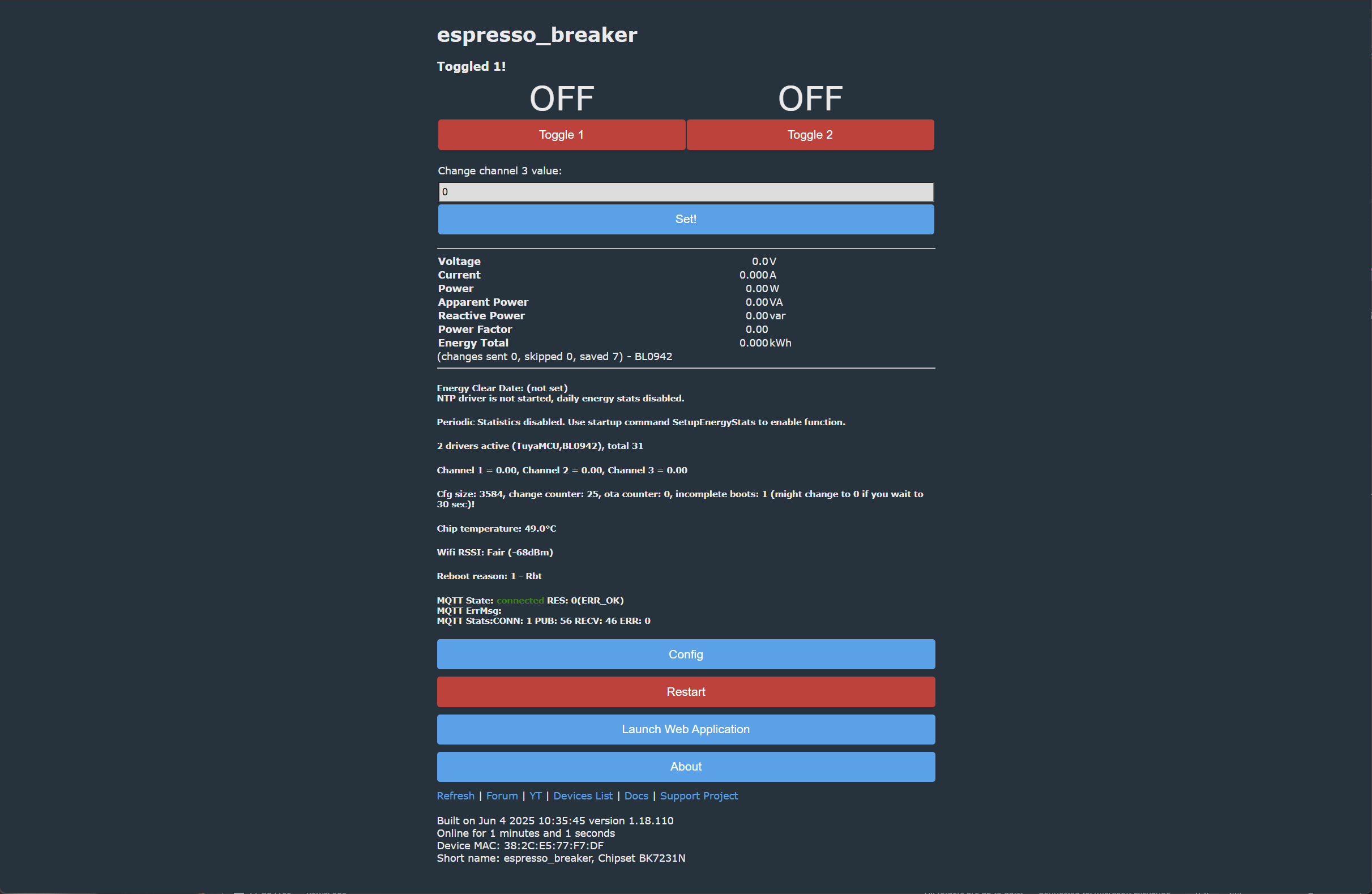

    >>21572159
    I executed tuyaMcu_sendQueryState
    Here is the log:
    Info:TuyaMCU:Consumed 30 unwanted non-header byte in Tuya MCU buffer
    Info:TuyaMCU:Skipped data (part) 28 02 60 28 01 22 00 30 14 1C 5E 23 61 08 00 00 43 28 01 A2 01 00 08 20 28 01 C0 00 00 FF
    Info:MAIN:Time 80, idle 193490/s, free 71400, MQTT 1(1), bWifi 1, secondsWithNoPing 10, socks 2/38
    Info:GEN:dhcp=0 ip=192.168.30.25 gate=192.168.30.1 mask=255.255.255.0 mac=38:2c:e5:77:f7:df
    Info:GEN:sta:rssi=-64,ssid=xxxxxxx,bssid=22:61:b4:14:a9:a8,channel=6,cipher_type:CCMP
    Info:TuyaMCU:Skipped data (part) 28 02 60 28 01 22 00 00 14 1C 5E 22 61 08 00 00 43 28 01 A2 01 00 08 20 28 01 C0 00 00 F6
    Info:MAIN:Time 81, idle 179590/s, free 71400, MQTT 1(1), bWifi 1, secondsWithNoPing 11, socks 2/38
    Info:CMD:[WebApp Cmd 'loglevel 3' Result] OK

  • Enable flag 46 and use DP to read Tuya datapoints
    #14 21572288
    Posts: 14760
    Rate: 12886
    1. In order for it to work, you need to enable the following flag: flag 46. (Config -> Configure General/Flags -> Enable flag 46, albo enable Flag 47 to get more data)
    Two checkboxes labeled Flag 46 - [TuyaMCU] Store raw data and Flag 47 - [TuyaMCU] Store ALL data, both unchecked.
    2. Use tuyaMcu_sendQueryState command in web app console once or twice to get more device state data
    3. As on screenshot, enter URL with your device IP, for example:
    http://192.168.0.163/cm?cmnd=DP
    Change 192.168.0.163 to your IP
    4. Copy results here to forum with syntax json tag

  • Need mains power for full device operation
    #17 21572342
    lubopetrov
    Posts: 39
    >>21572334
    Right now this device is connected only to the USB of the programmer. I guess this is why we don't see anything else. Should I connect it to my grid? Can I already remove the wires for the programmer?
    I don't see much in my home assistant. I'm submitting few screenshots here:
    Control panel screen for an IoT device named espresso_breaker showing firmware version, IP address, Wi-Fi signal strength, SSID, temperature, and uptime.
    Screenshot of a device configuration panel with various setting options and dropdown fields.
    LittleFS file management user interface with autoexec.bat file editor and file operation buttons.
    Configuration webpage for espresso_breaker software listing BK7231N pin setup with dropdown menus.
    Do I need to change something else?
  • #18 21572371
    Posts: 14760
    Rate: 12886
    You are correct, you won't get measurements without powering it fully. Disconnect it from programmer, desolder wires, and once it's disconnected, connect it to grid and recheck.
    Hopefully we will not have to reflash it again, so programmer wires should not be needed.
    The next step is to check full DP data and then I can start writing autoexec.bat for you.

    Here is the latest. I connected the breaker to my grid. On the other side I have light bulb. I checked the physical button works as expected, but I cannot toggle the power via web interface. Also I don't see anything related to power to appear.

    Ah, I misread, dpID 6 is PhaseA:
    Info:TuyaMCU:Received: 55 AA 03 07 00 0C 06 00 00 08 09 32 00 00 00 00 00 00 5E
    Info:TuyaMCU:ProcessIncoming[v=3]: cmd 7 (State) len 19
    Info:TuyaMCU:ParseState: id 6 type 0-raw len 8
    So it has 8 bytes payload...
    This is header, type and length: 55 AA 03 07 00 0C 06 00 00 08
    This is payload:
    09 32 00 00
    00 00 00 00
    This is checksum:
    5E
    0932 hex is 2354, which should mean 235.4 volts. Other values are 0, so 0 current...
    Are you really sure there is a bulb?
    For now, maybe try:
    startDriver TuyaMCU

    Do any of new button toggles output on or off?
    Those IDs (12 and 16) are present in your OBK log, but are missing from json with data point names...
  • Need to map toggle 1 and startup for power data
    #21 21574417
    lubopetrov
    Posts: 39
    >>21574373
    Ok. Toggle 2 is turning On/Off the bulb. But I don't understand why I see toggle 1? Do we need it? Still no power consumption related data. And yes the light is LED bulb for now.
    Screenshot of the espresso_breaker device control panel with two toggles, both set to OFF.
    Do I need to have this in startup?
    Configuration screen for the startup command of a smart home device named espresso_breaker.
    Here is the current output

  • BL0942 driver unnecessary; TuyaMCU handles metering
    #22 21574447
    Posts: 14760
    Rate: 12886
    I added two toggles because I didn't know which dpID is which.
    You don't need BL0942 driver start. It can only cause problems. The power metering is done by TuyaMCU via autoexec.bat.
    I see you posted... new dpID 6 sample.
    Let's see.

    How do I remove toggle 1? I removed setChannelType 1 toggle from autoexec.bat but it is still showing on UI. And how to set the correct output for wattage and voltage?
  • OpenBK7231 channel types and TuyaMCU mapping setup
    #24 21574681
    Posts: 14760
    Rate: 12886
    You need to open "Web App" and then in channel types dropdown change it back to default.
    startDriver TuyaMCU
    setChannelType 2 toggle
    // linkTuyaMCUOutputToChannel dpId verType tgChannel
    linkTuyaMCUOutputToChannel 16 bool  2
    // set voltage, current ,power channel types
    setChannelType 3 Voltage_div10
    setChannelType 4 Current_div1000
    setChannelType 5 Power
    // map dpID 6, which is VCP format, to first voltage, then current, then power (3, 4, 5)
    linkTuyaMCUOutputToChannel 6 RAW_V2C3P3  3
  • #25 21574876
    lubopetrov
    Posts: 39
    >>21574681
    WOW, power/current and voltage appeared. Thanks.
    Control panel for the espresso_breaker device, ON status, showing voltage, current, power, and control buttons.
    I noticed something strange too. When I rebooted the device a few times it toggled by itself. Could be something with the browser. Can you get out the consumption summary and anything else that could be useful? Do I need to leave the bulb on for a prolonged time?

    #30 21578257
    lubopetrov
    Posts: 39
    I flashed the second unit and loaded the same autoexec.bat file. It does show the readings for Volt, Power and Current, but the toggle is not functional.
    Here is the output from the log:
    Info:CMD:[WebApp Cmd 'tuyaMcu_sendQueryState' Result] OK
    Info:MAIN:Time 12345, idle 187953/s, free 70864, MQTT 0(771), bWifi 1, secondsWithNoPing 12275, socks 2/38
    Info:TuyaMCU:Received: 55 AA 03 1C 00 00 1E
    Info:TuyaMCU:ProcessIncoming[v=3]: cmd 28 (SetTime) len 7
    Info:TuyaMCU:ProcessIncoming: received TUYA_CMD_SET_TIME, so sending back time
    Info:TuyaMCU:MCU time to set: 0
    Info:TuyaMCU:ptime ->gmtime => tm_hour: 0
    Info:TuyaMCU:ptime ->gmtime => tm_min: 0
    Info:MAIN:Time 12346, idle 189166/s, free 70864, MQTT 0(771), bWifi 1, secondsWithNoPing 12276, socks 2/38
    Info:CMD:[WebApp Cmd '' Result] No command entered
    Info:MAIN:Time 12347, idle 187876/s, free 70864, MQTT 0(771), bWifi 1, secondsWithNoPing 12277, socks 2/38
    Info:MAIN:Time 12348, idle 195007/s, free 59168, MQTT 0(771), bWifi 1, secondsWithNoPing 12278, socks 3/38
    Info:TuyaMCU:Received: 55 AA 03 07 00 0C 06 00 00 08 09 3D 00 01 8B 00 00 5F 54
    Info:GEN:CHANNEL_Set channel 3 has changed to 2365 (flags 0)
    Info:TuyaMCU:OnChannelChanged: channel 3: unsupported data point type 206-error
    Info:MQTT:Channel has changed! Publishing 2365 to channel 3
    Info:GEN:No change in channel 4 (still set to 395) - ignoring
    Info:GEN:No change in channel 5 (still set to 95) - ignoring
    Info:TuyaMCU:Received: 55 AA 03 07 00 05 6F 04 00 01 01 83
    Info:TuyaMCU:ProcessIncoming[v=3]: cmd 7 (State) len 12
    Info:TuyaMCU:ParseState: id 111 type 4-enum len 1
    Info:TuyaMCU:ParseState: byte 1
    Info:MAIN:Time 12349, idle 173388/s, free 70864, MQTT 0(772), bWifi 1, secondsWithNoPing 12279, socks 2/38
    Also http://192.168.30.155/cm?cmnd=DP produces following:
        "id": 11,
        "type": 1,
        "data": 0
        "id": 13,
        "type": 2,
        "data": 0
        "id": 104,
        "type": 1,
        "data": 1
        "id": 102,
        "type": 2,
        "data": 5
        "id": 107,
        "type": 2,
        "data": 10
        "id": 18,
        "type": 0,
        "data": "01010276"
        "id": 111,
        "type": 4,
        "data": 0
        "id": 1,
        "type": 2,
        "data": 7
        "id": 6,
        "type": 206,
        "data": "0931000000000000"
        "id": 16,
        "type": 1,
        "data": 1
    I compared this code to the one I posted earlier and I can see here is more data present.

How do I configure a Dewin RMDT-1PNL 63 smart circuit breaker in OpenBK7231 after flashing so the ON/OFF switch and power readings appear in Home Assistant over MQTT?
You must configure TuyaMCU mappings after flashing. Use this 3-step setup: 1. Start TuyaMCU and force paired Wi-Fi state in autoexec.bat. 2. Map dpID 16 as the toggle. 3. Map dpID 6 as RAW_V2C3P3 to channels 3, 4, and 5, then expose MQTT or HASS discovery. The working thread config used channel 2 as toggle, channel 3 as Voltage_div10, channel 4 as Current_div1000, and channel 5 as Power. Flashing alone only showed general info, not relay or metering entities. [#21574681]
Why does OpenBK7231 say "Sorry, no meaningful pins data found" when I try to import a template on this Dewin smart breaker?
It says that because this breaker is not controlled as a normal pin-template device. The board photos led to the conclusion that it is a TuyaMCU design, so importing a GPIO-style template did not produce usable pins data. In this model, the relay and measurements come through Tuya data points instead of direct pin assignments. That is why template import failed and the fix was to follow the TuyaMCU guide instead. [#21566792]
What is a TuyaMCU device, and how can I tell if my Dewin RMDT-1PNL breaker uses TuyaMCU instead of direct GPIO control?
"TuyaMCU" is a serial control subsystem that manages relay and sensor functions through data points, instead of exposing those functions as direct GPIO pins. You can identify it here by two facts: template import failed, and the board photos were recognized as a TuyaMCU design. Later logs also showed TuyaMCU heartbeats and state packets such as 55 AA 03 07 ..., which confirmed serial communication with the MCU. [#21566792]
What is a Tuya dpID, and how do dpIDs map to relay control, voltage, current, power, and total energy in OpenBeken?
"Tuya dpID" is a numbered data point that represents one device feature, such as a switch, energy counter, or raw measurement packet, and OpenBeken maps each dpID to a channel or parser. In this breaker, dpID 16 was the breaker switch, dpID 6 was the 8-byte Phase A packet, and dpID 1 was total forward energy. The successful mapping used dpID 16 for the toggle, dpID 6 for voltage, current, and power, and dpID 1 for total energy. [#21580392]
How can I start the TuyaMCU driver in OpenBK7231 and verify communication using heartbeats, baud rate, and tuyaMcu_sendQueryState?
Start TuyaMCU in autoexec.bat, then confirm heartbeats and state replies in the log. Use this 3-step check: 1. Add startDriver TuyaMCU and tuyaMcu_defWiFiState 4. 2. If needed, set the baud rate; this thread tested 9600. 3. Run tuyaMcu_sendQueryState and look for heartbeat packets and parsed states. The thread later showed valid replies, including heartbeat cmd 0 and multiple parsed dpIDs, which proved communication was working. [#21572159]
Where do I find the DP command output in OpenBeken, and how do flags 46 and 47 help with TuyaMCU debugging?
You get DP output by calling the device URL with cm?cmnd=DP. First enable flag 46, or optionally flag 47 for more data, then run tuyaMcu_sendQueryState, and open a URL like http://DEVICE_IP/cm?cmnd=DP. Flag 46 stores the last seen dpID values so OpenBeken can present them as JSON. That JSON is what you use to confirm whether ids like 1, 6, 16, 102, and 107 are arriving. [#21572288]
How do I map Dewin breaker dpID 16 to a working toggle and dpID 6 to voltage, current, and power channels in autoexec.bat?
Use channel 2 for the switch and channels 3 to 5 for metering. The working mapping was: setChannelType 2 toggle, linkTuyaMCUOutputToChannel 16 bool 2, setChannelType 3 Voltage_div10, setChannelType 4 Current_div1000, setChannelType 5 Power, and linkTuyaMCUOutputToChannel 6 RAW_V2C3P3 3. That made the UI toggle work and exposed volts, amps, and watts. One expert summary from the thread was simple: “set voltage, current, power channel types,” then map dpID 6 to 3, 4, and 5. [#21574681]
Why does the breaker show measurements only after being connected to mains power and not when powered only from the USB programmer?

How can I remove an extra Toggle button from the OpenBK7231 web UI after testing different channel mappings?
Remove the test mapping and reset that channel’s type in the Web App. In the thread, an extra Toggle 1 appeared because channel 1 had been temporarily set as a toggle during testing. The fix was not just editing autoexec.bat; you also had to open the Web App and change that channel type back to default from the dropdown. That removes the leftover button from the UI. [#21574681]
Which is the right metering method for this Dewin smart breaker: TuyaMCU mapping or the BL0942 driver, and why?
TuyaMCU mapping is the right metering method for this breaker. The thread explicitly warned not to start the BL0942 driver because it could cause problems, and the working measurements were obtained entirely from TuyaMCU dpID 6. This breaker reports metering through the MCU’s raw data packet, not through a directly attached BL0942 energy chip interface exposed to OpenBeken. [#21574447]
