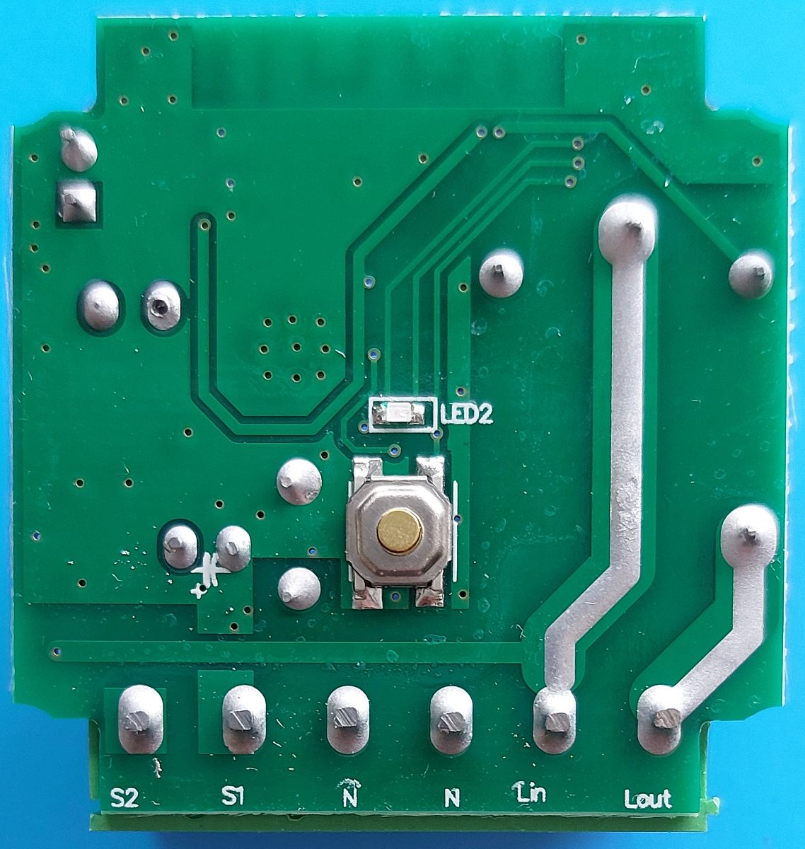

    AP-SMT-Breaker02-1CH EZB-WBZS1H16N-A - 16A Mini Smart Switch 1 Channel
    Bought from the AliExpress Choice Day sales
    Different to a similar mini smart switch I have flashed.
    BK7231N MCU is part of the main PCB
    Relay is on a daughter PCB to rotate it
    Used tuya-cloudcutter to flash OpenBK (didn't even setup in SmartLife app - just went straight to cloudcutter)
    > By manufacturer/device name
    > Aubess
    > 1.2.1 - BK7231N / oem_bk7231n_control_switch
    OpenBK7231N_UG_1.15.597.bin
    Pin settings are possibly different to other versions - these work for my device.
    LED_n 6
    Rel 15
    Btn 8
    TglChanOnTgl 14

  • 3-wire flashing at 115200 baud on BK7231N board
    #11 20557058
    karrlsson
    [BK7231N] AP-SMT-Breaker02-1CH EZB-WBZS1H16N-A - 16A Mini Smart Switch 1 Channel >>20507709
    In my experience i found out it is enough 3 wires Gnd,Tx,Rx and lower baud rate to 115200 and i had success in over 10 boards flashing. Here is image of Aubess board with BK7321N onboard, With this revision cloud cutter didnt work for me, but luckily there is easy traceable test points Yellow is RX White Tx.
    Pin 6: TglChanOnTgl on channel 1
    Pin 7: Rel on channel 1
    Pin 23: Btn on channel 1
    Pin 26: LED_n on channel 1

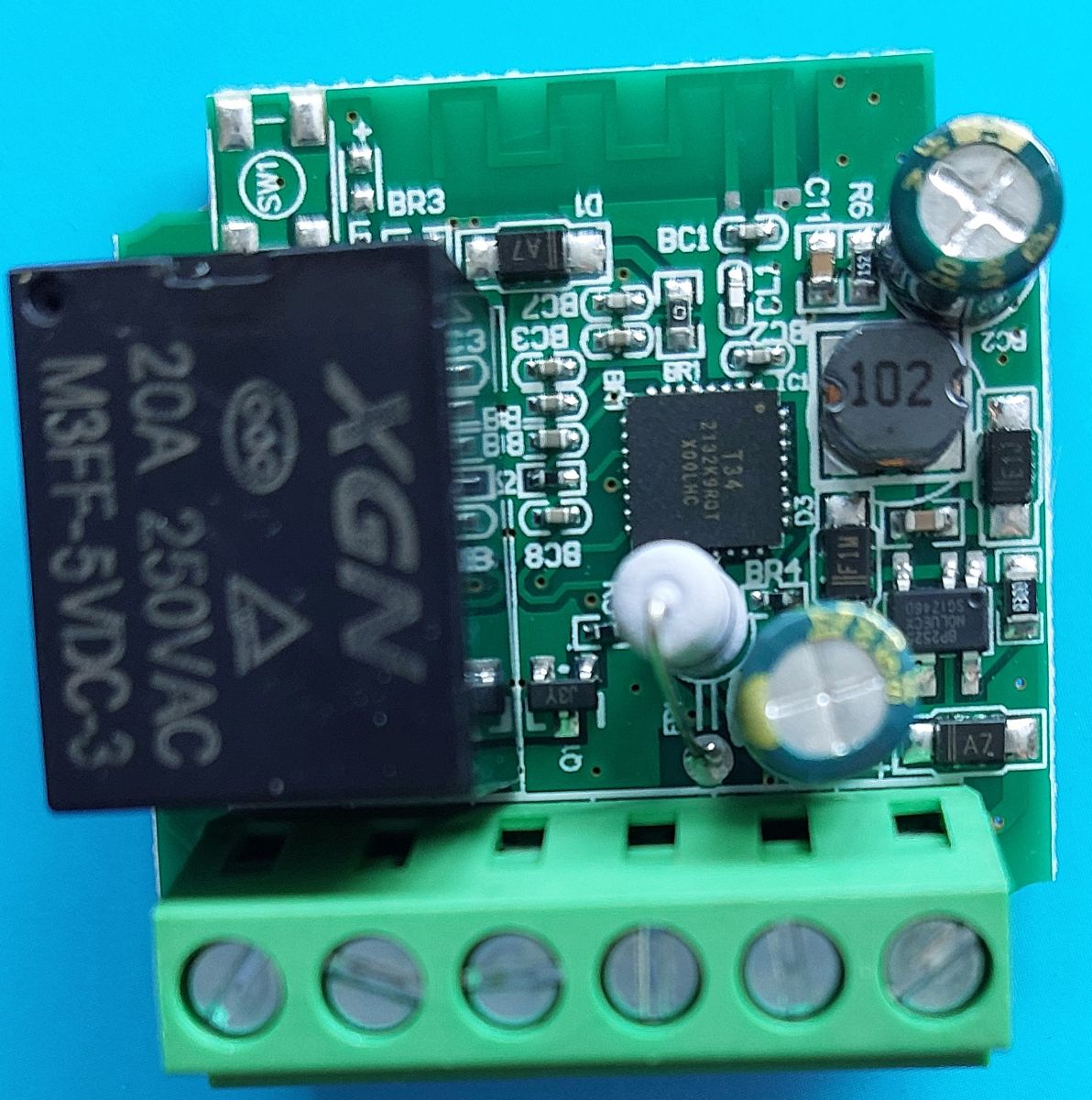

  • No pogo-pin access for T34 serial flashing
    #17 21035919
    aliexpress
    Level 4  
    Posts: 7
    Hi,
    I have just received a different version of the AP-SMT-Breaker02-1CH from our favorite Chinese vendor.
    Will not work with cloudcutter.
    Unfortunately, they mounted all components (except LED and switch) on the top side of the PCB.
    This means, the T34 chip is surrounded basically by all the components that are very high (relais, resistor, capacitor, coil).
    Unfortunately, there is not a single pad for pogo pins.
    Any idea on how to flash that? Due to the surrounding by 3D "high" components, it seems impossible to get directly to Pins 25/26 of the T34 for serial connection. I am lost!
    Gray PCB with various electronic components, including a relay, capacitor, and T34 integrated circuit. Bottom view of the AP-SMT-Breaker02-1CH PCB with a button and terminals.
  • Desoldering T34 required for OpenBeken flashing
    #18 21036043
    Posts: 14790
    Rate: 12937
    That looks like a true challenge. It's a shame that I don't get that kind of devices myself.
    Unfortunatelly the only viable solution I can see is the one described here:
    [BK7231N / T34 ] Teardown Tuya Generic Wifi Wall Light Switch 3 Gang
    CameronDev wrote:
    Close-up of a small electronic board with thin wires soldered and labeled TX/RX, Ground, and 3.3V.
    Here is how you can flash a T34-based wall switch with OpenBeken. This switch has no programming pads available, so desoldering T34 in QFN case is required.
    So you will need hot air and some basic soldering skills.
    Alternatively, you could try just removing the high components... with some flux, extra Pb solder, and solder wick it should be easy.
  • Direct pin wiring without desoldering T34 is too difficult
    #19 21036158
    aliexpress
    Level 4  
    Posts: 7
    Thanks for your suggestions! I have zero experience with soldering tiny SMD stuff - nor do I have the equipment to do any reflow soldering.
    It might be one way to de-solder all the big components and try to attach tiny wires directly to the pins, since the solder of the pins is exposed on the PCB, just like someone wrote later on the page you linked:
