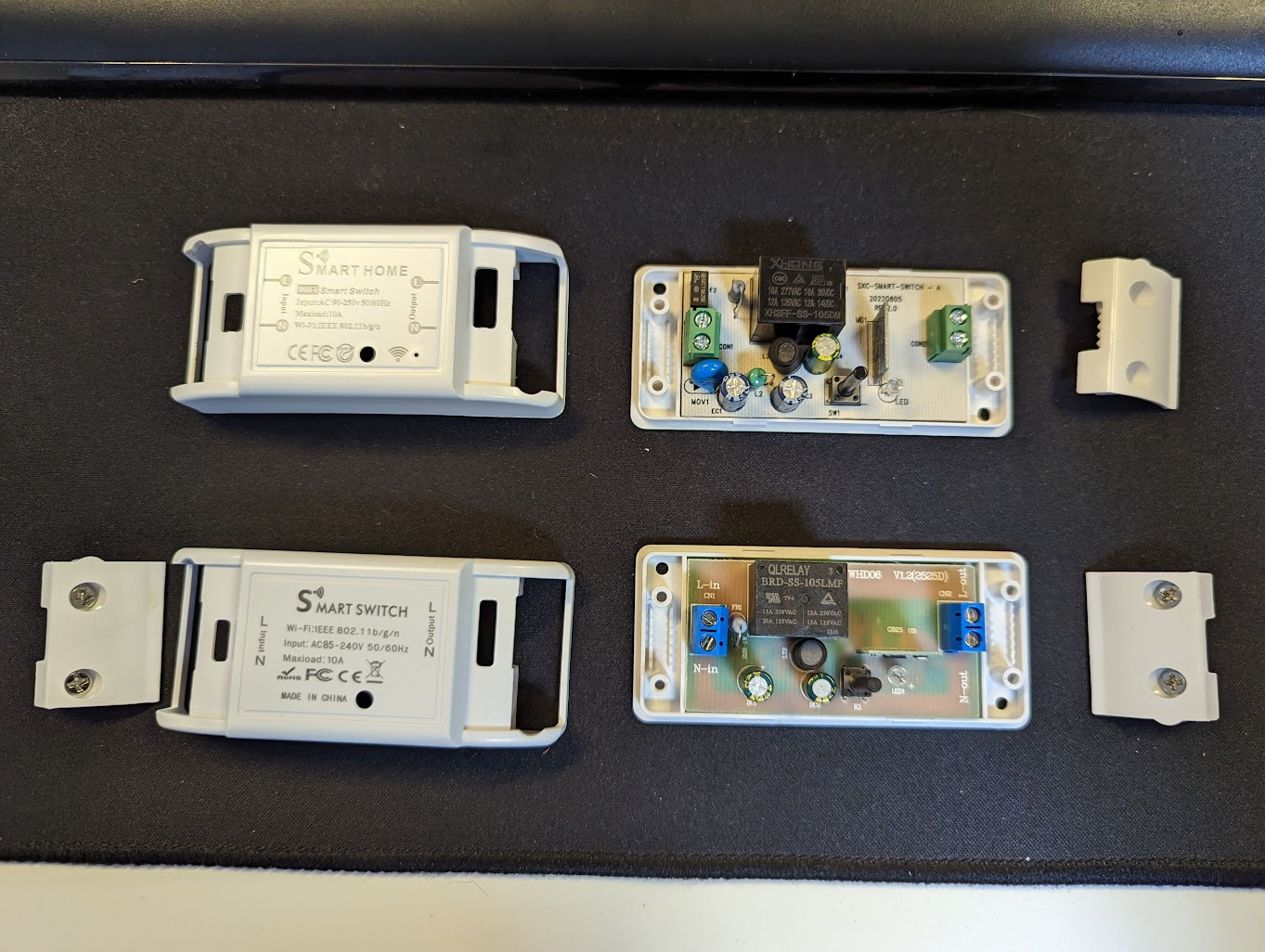

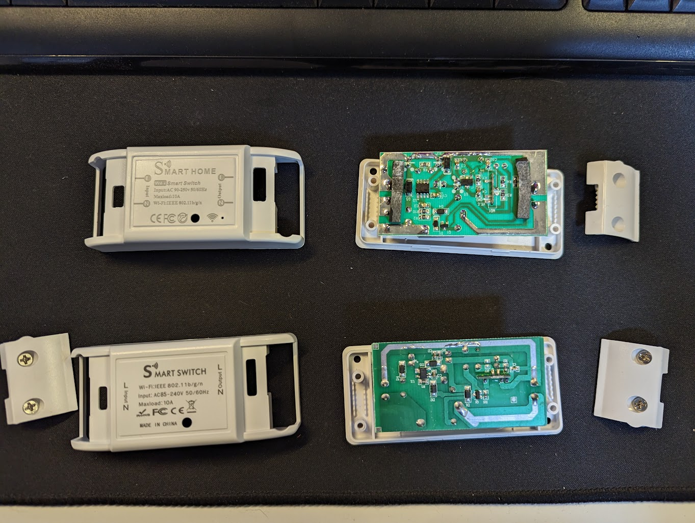

    Teardown and config for WHD06 Smart Switch Breaker 10A - 1 gang
    From recent AliExpress Choice Day sales.

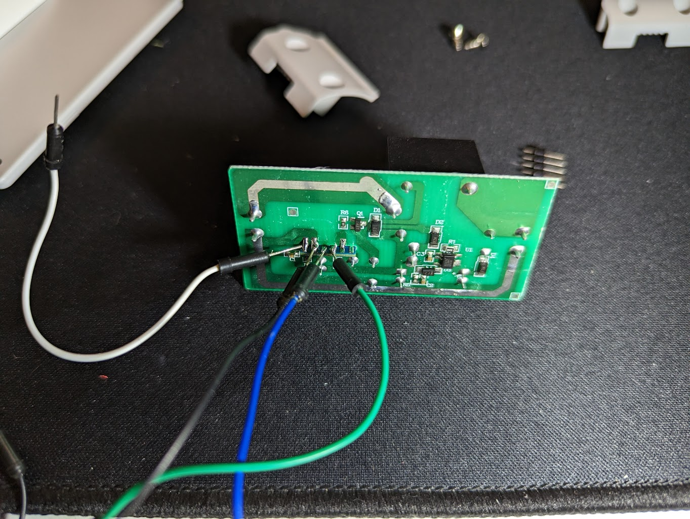

    Couldn't figure out the correct profile to use Tuya Cloudcutter so flashed over serial.
    Smart Life App firmware info
    Device - Breaker
    1.3.10
    v102
    Dump attached
    OpenBK Pin config
    LED_n - 7 - ch1
    Rel - 24 - ch1
    Btn - 8 - ch1

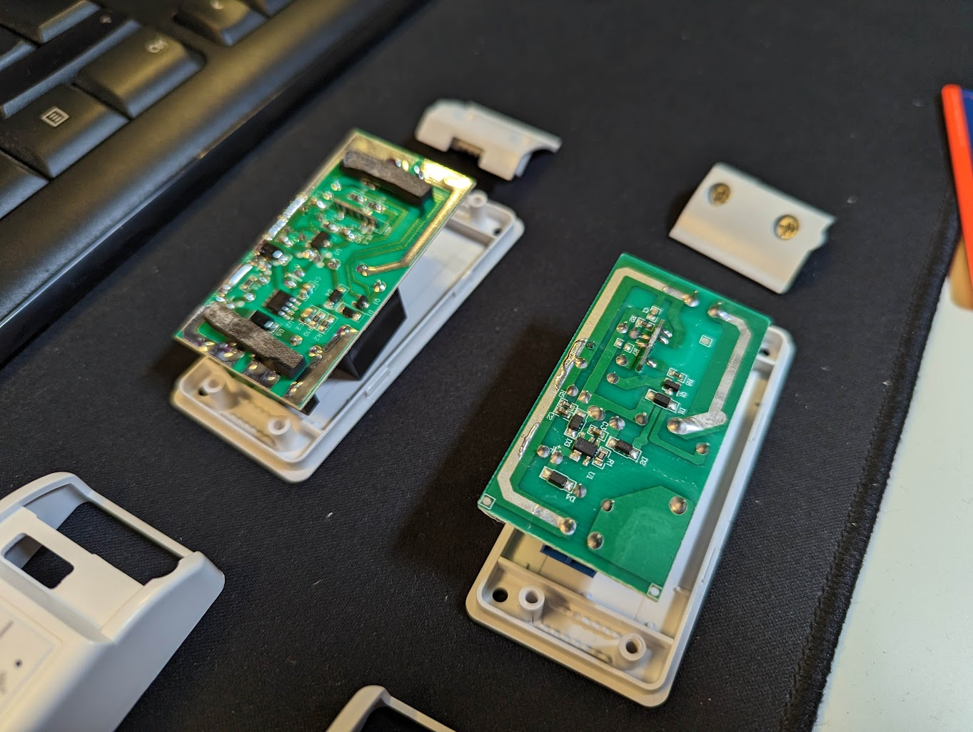

    My feeling is that this switch isn't as good as this (https://www.elektroda.com/rtvforum/topic3965564.html) switch (top one in images).
    Less components. No Class Y capacitor. Less secure board in case.
    Photos of teardown (bottom device)

    Won't allow me to upload the firmware dump

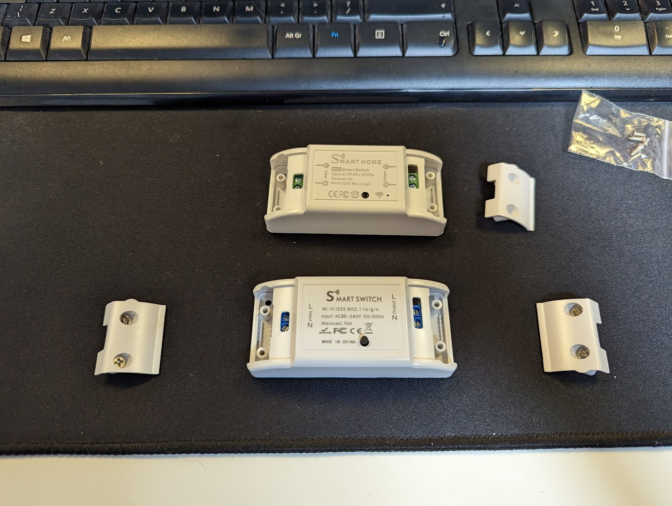

    Dump attached.
    Both are CB2S and flashed without issue.
    Top one is this model which I have posted about previously - https://www.elektroda.com/rtvforum/topic3965564.html
    Can flash using Tuya Cloudcutter
    Bottom one required a flash over serial using the OpenBK flasher GUI.

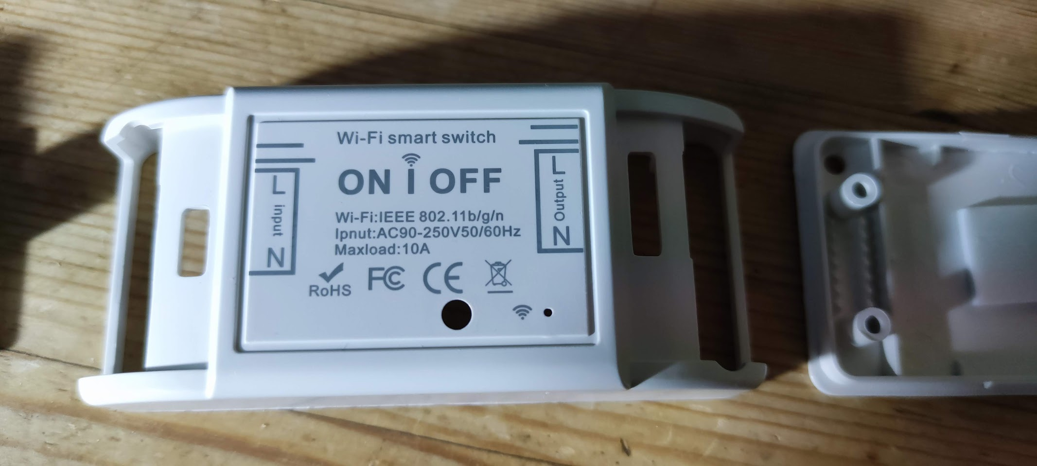

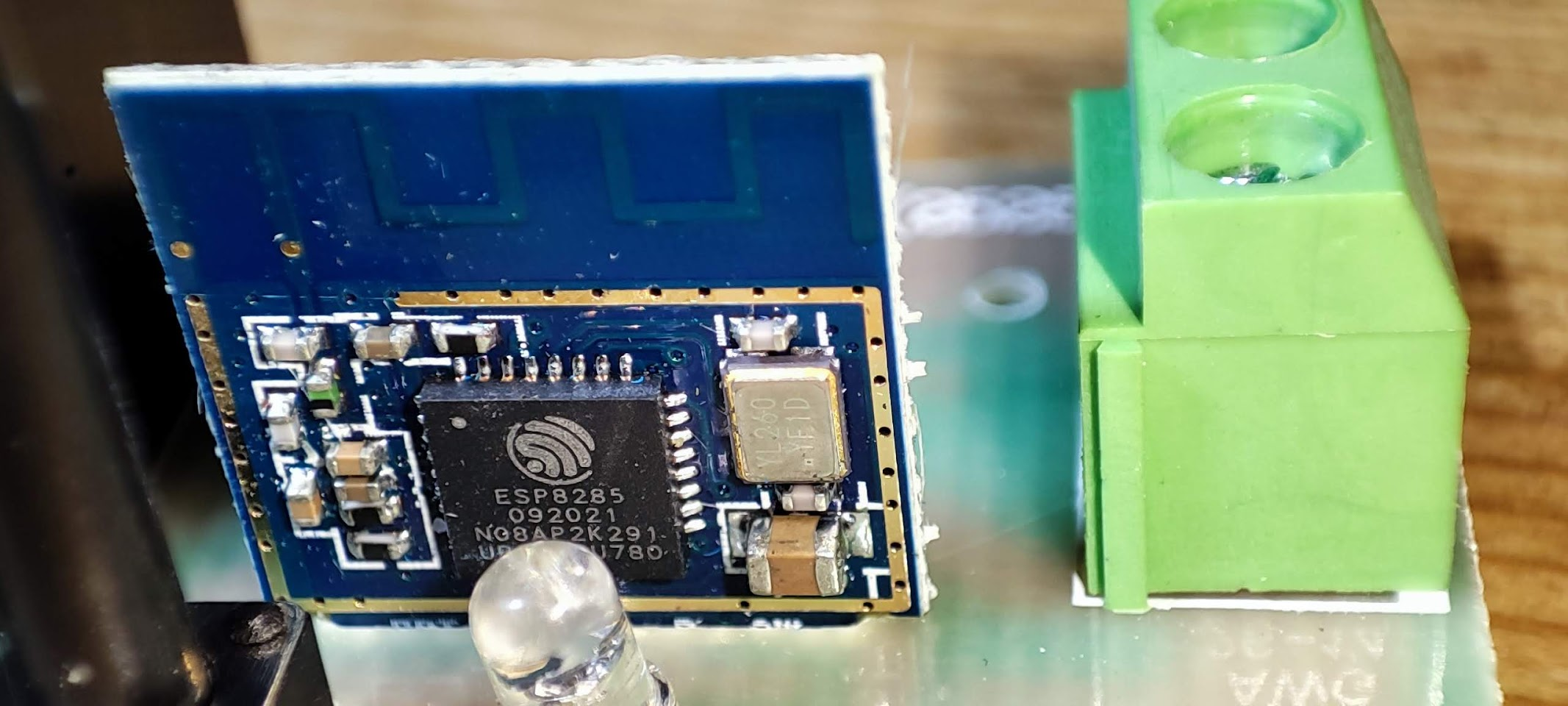

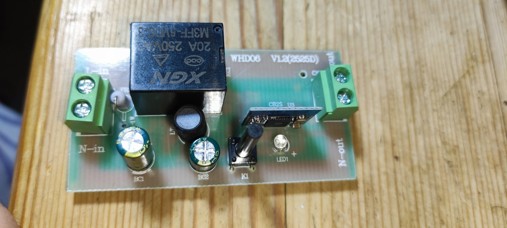

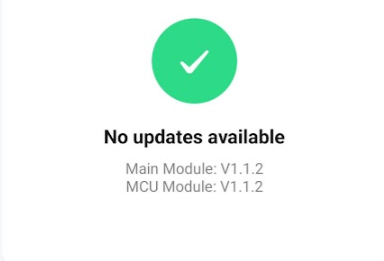

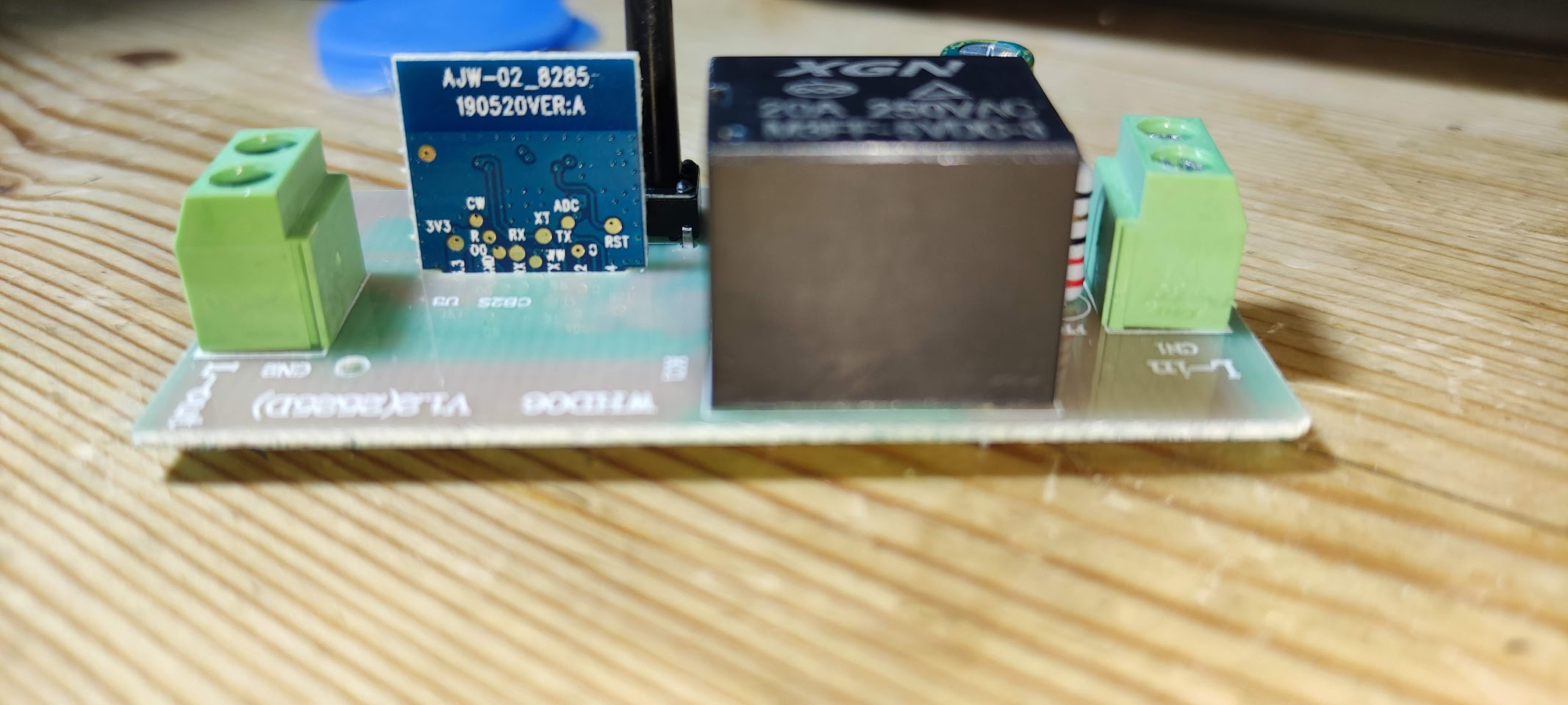

    Curious. My WHD06 is an ESP8285

  • #5 20852692
    Posts: 14622
    Help: 655
    Rate: 12638
    I have already seen many, many reports of Tuya ESP8266 devices swapping to Beken. The label on your module indicates it's may be from 2020 year, so it's before the swap.
    By the way, I also saw that they swap to Beken but keep FCC-ID indicating ESP inside, I wonder if that's legal
